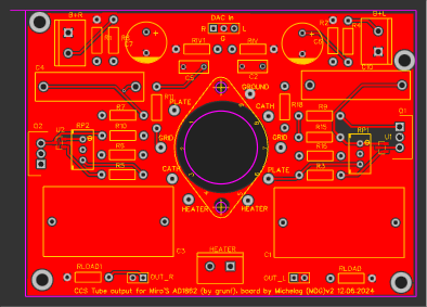

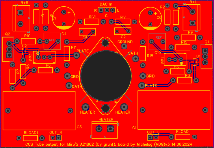

Hey Grunf, I prepared a V2 of that board, wanted to ask for your opinion, how it looks with miniaturizationSorry @Michelag, I've been a bit busy lately so I'm not on the forum (I was even in Italy for a couple of days).
You must correct your PCB, I used the same ones I made for my hybrid amplifier with some corrections. It's important that you see how they should look. You have to miniaturize the CCS traces, I made them partially in SMD to make them as small as possible.
In this case, the tube was 6S4P, but it is important that you get an impression of how the PCB should look. Otherwise, the scheme is the same, instead of 47K you put Riv and a film cap in parallel with it.

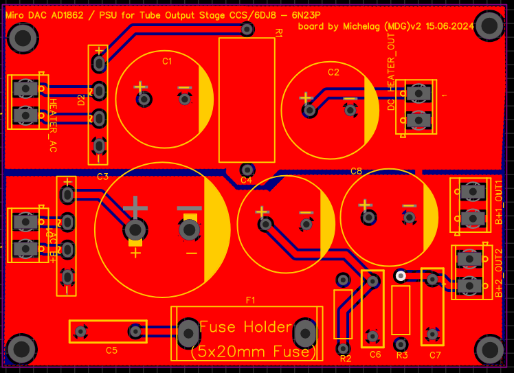

Here we go, gerbers for grunfs' CCS tube output and a quite raw PSU.
Today I'll be testing the old boards, just in case.
However these are perfected.

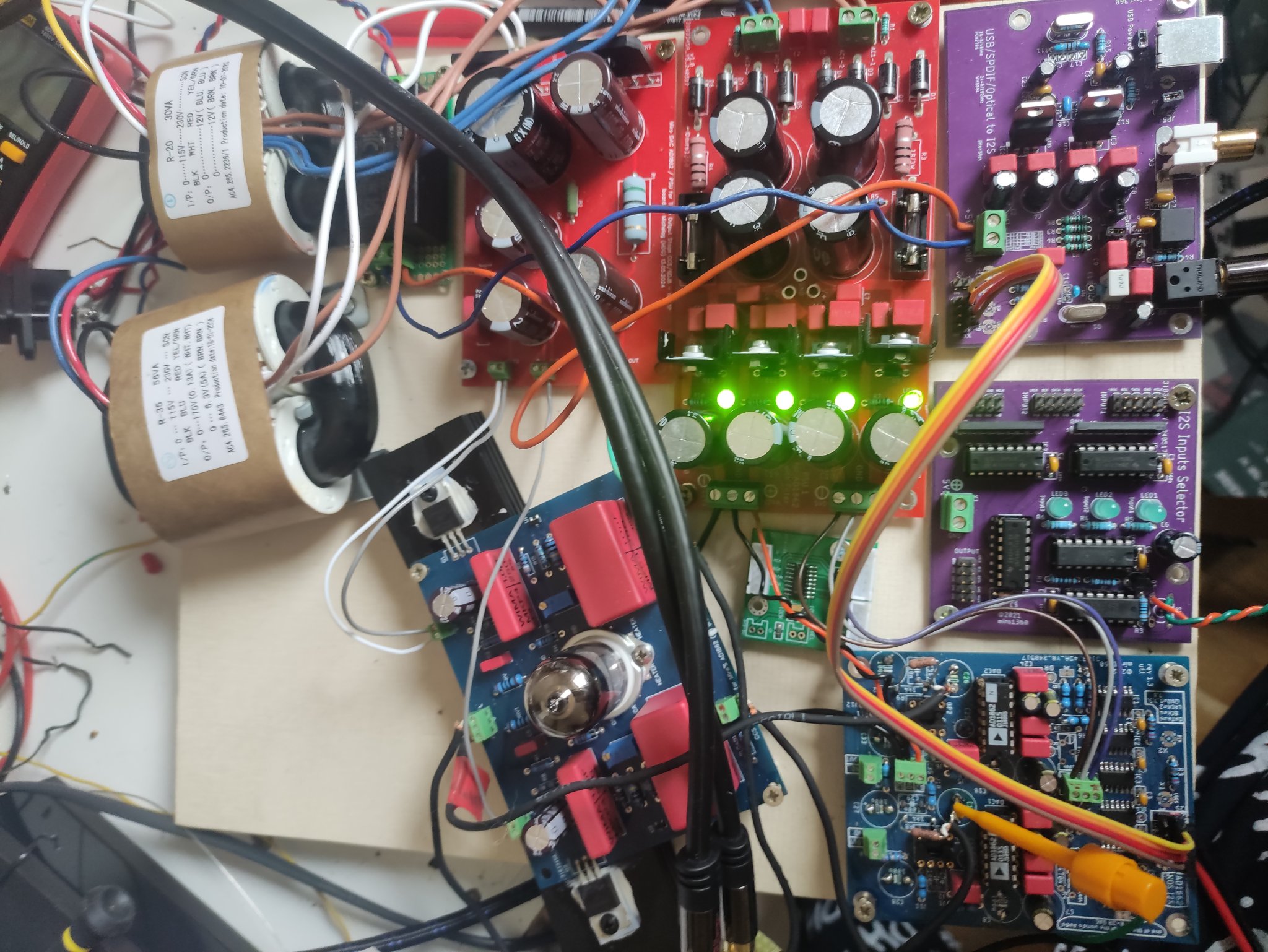

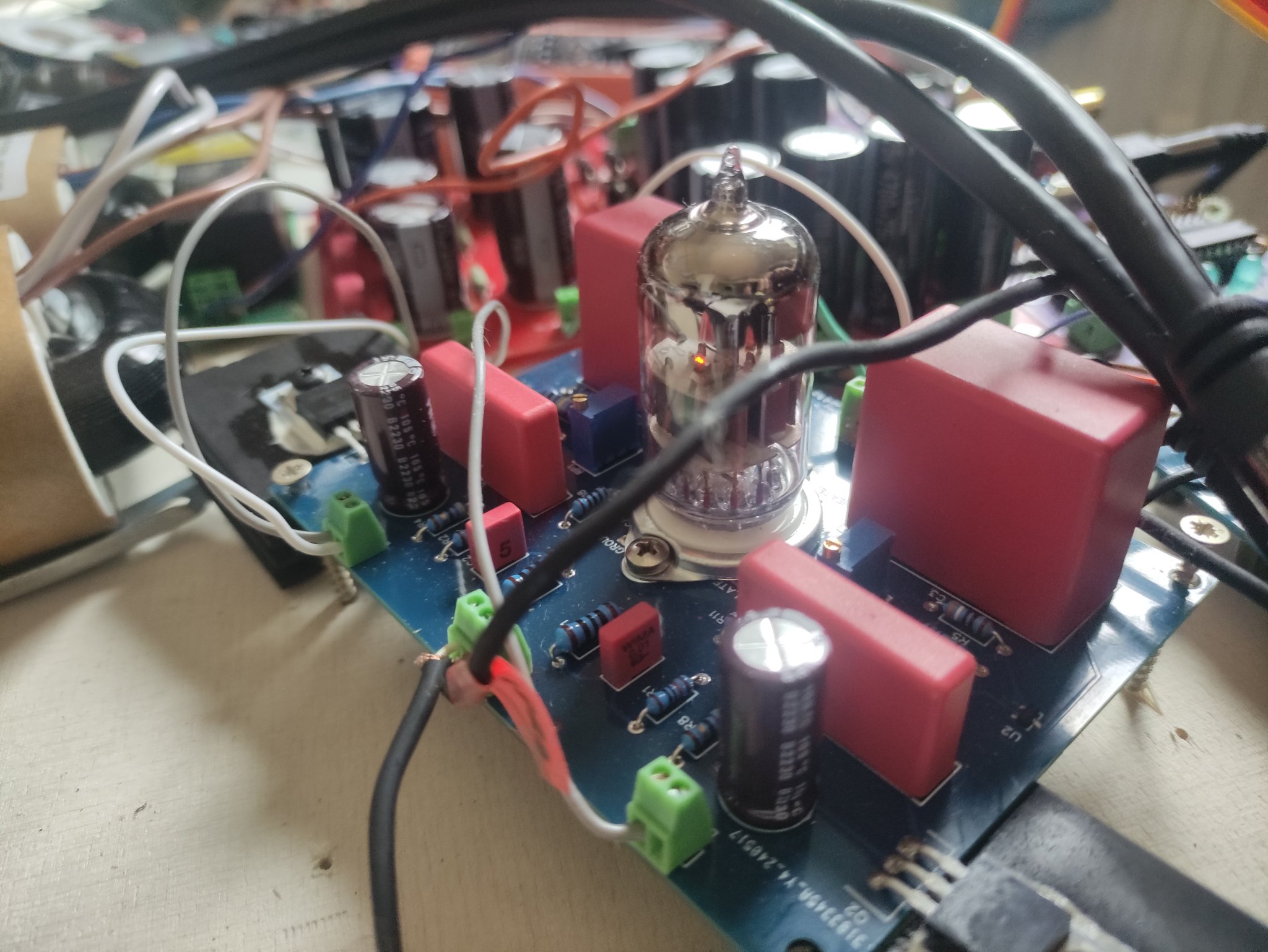

Wired, powered on...What happened with the ECC88 + CCS pcb's - did You try them ?
Asking beacuse You have them made.
It is leading me to tears 😭😭😭
Never heard my system sounding with this delicacy, finesse, depth, precision, it's something I can't describe with few words...
Miro, Grunf, you're the GOATs!!!! (Pardon Grunf, perhaps Miro a little more in this particular case)
It's moving.
È commovente, ho i brividi, non vorrei mai fermarmi di ascoltare, è una roba incredibile, tonight I could pass on football Italy -Albania to listen to this...

Tubes, this is a 6n23p-ev of sovietic Age (silver getter, to whom it may concern
At your side of the pond, a 6dj8/ecc88 would be easier to find...
The beauty of that board is that you can use different tubes (I'd like to experiment with a lower Riv and a 6n2p (12ax7 or ecc83)) just by biasing them with the ccs pot (took on purpose that trafo that spits out an higher b+), and a convenient cathode resistor, but this is for the future.
