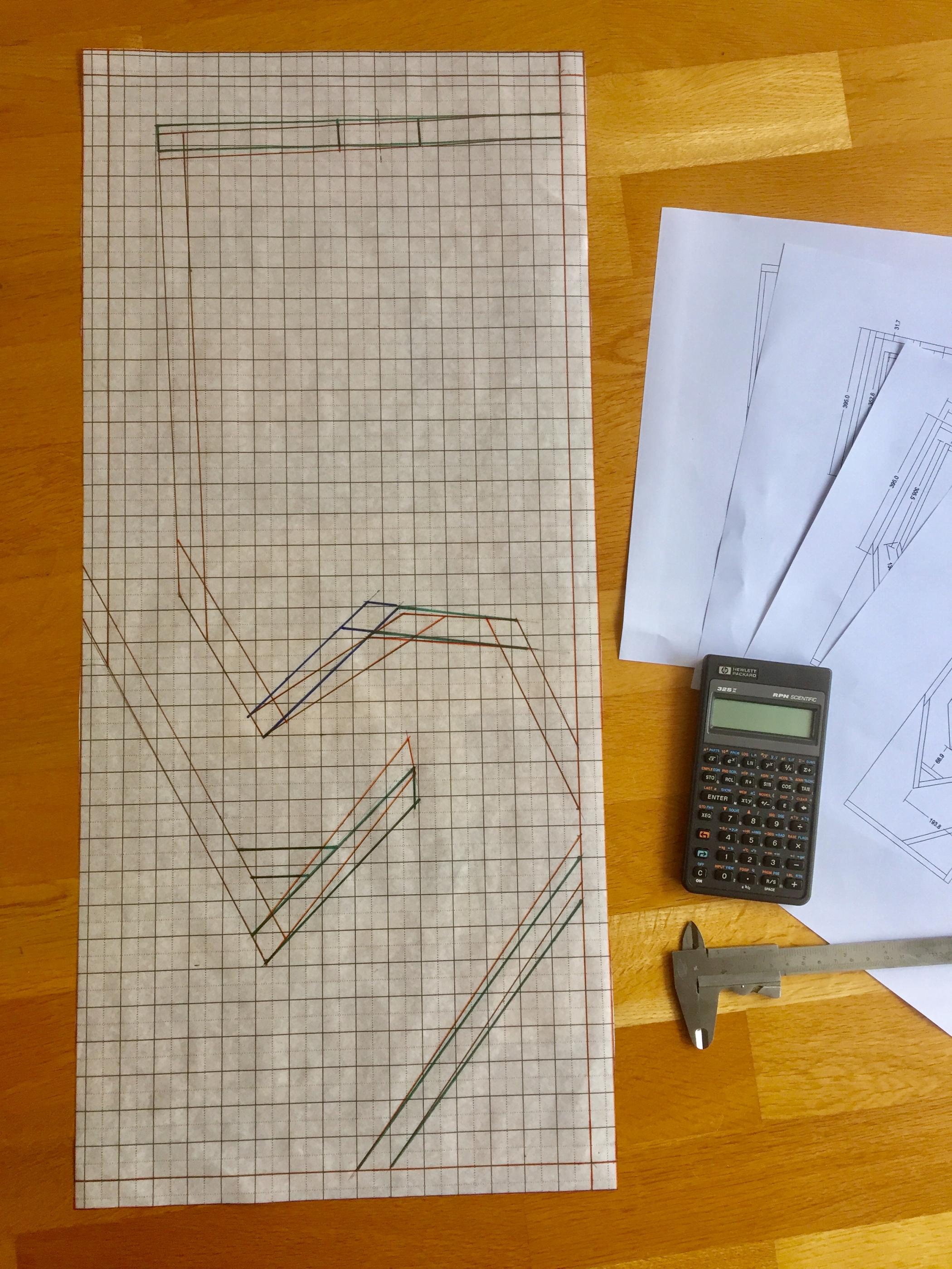

Thank's again chrisb, your drawings made it super simple to transfer it onto pattern paper that I then laminated so that it will hold up in the shop. It is a surprisingly compact design. 🙂
I ran into a couple of minor problems. I used your drawings witch seems to indicate 15.4 mm material thickness. I converted that to 16 mm and my first attempt was the orange lines. I then went over all measures again and made some correction due to my errors but also since two figures didn't add upp down in the fold. Corrections are the green lines. I then checked the horn profile and made one final alteration to make sure the horn expanded throughout the whole length and through the fold. The alteration is the blue lines.

I am reviving this thread because I am about to build a pair of DNS and took some measures on top of the drawing from post #58. It's the one to use right? Dimensions seems about right and I will try to rescale it for 16 mm (no 1/2 inch sheets in Sweden). Attached is a pdf with my overlaid measures in cm. Ballpark figures I know but hopefully good enough to base my build upon...
FYI, the measures in my pdf did not match up with the drawings from chrisb in post #239. I went with the drawings from chrisb because they seemed more accurate.
I recall Bcmbob having some difficulty in getting the plans to close on itself. You may need to juggle a few dimensions towards the middle sections and mouth to fit. The critical dimensions are near the driver entrance, the chamber volume, and the home from driver to horn. Towards last half, a few mm bigger or smaller won't change things hardly at all. So feel free to jiggle the numbers a little to get it to all fit.

I compared your drawing with the ones by chrisb again and there are quite big deviations, number wise. Yours are narrower at the beginning of the horn and wider at the end. But I have to commit to something so I am going with the drawings by chrisb. I will probably make one more alteration in the fold (based on what I see in your drawing xrk971) so I will end up somewhere in between. But this is a bit of a crapshoot anyway since I don't even got the correct drivers. I just hope the W5-2143 is close enough to make it worthwhile.
Sanity check, drawings by chrisb got 25.4 mm (1 inch) at the beginning of the horn, xrk971 got 0.58 inch (14.732 mm) for the same measure. For the next measure (where the horn bends downward) chrisb got 31.7 mm (1.248 inch) where xrk971 got 0.88 inch (22.352 mm). This seems like a quite crucial run and therefor big deviations (some 30..40% off). So what do you all think? Go with the wider or the narrower horn figures? I wish I knew where chrisb got his figures from...
I think Chrisb said his drawings were made from official plans he got from Decware. Mine were extracted with dial calipers from a web render with perspective correction. So could be off, but they simulated well. Let me run sim of my narrow channel version on 2143. If it works then the narrow dimensions are good.
That could be one way to move forward, sim it with a wider vs. a narrower. I guess you could over do it just to get an idea of how it would react either way. I also thought chrisb went of the official drawings and that is why I try to stick to them. The initial values for the horn is awfully close to 1" and 1"1/4. A few values does not add upp if you go back and forth but it could be a simple error. I will apply some common sense and hope for the best 😉

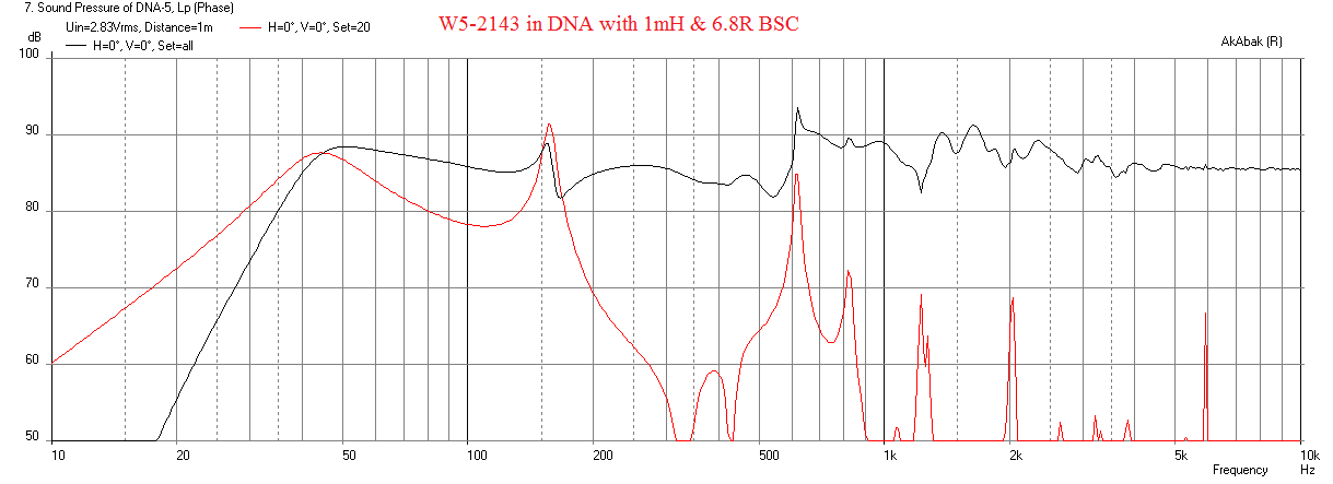

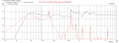

Here is sim with W5-2143 into my model. Looks pretty good - will need a BSC of 1mH and 6.8ohms to give a balanced response though. otherwise treble too high relative to bass.
Thank's a lot xrk971! Looks much better than I expected. I am currently using my W5-2143 with a pair of sealed subwoofers and I have to cross them between 80-100 Hz. I would be super happy if I could get that down to 50 Hz or even do without the subs all together. I wish I could corner loaded them but I have to put them along a wall (with openings to adjacent rooms on each side). I wonder how close to the wall you can position the DNA? That's why I was playing with the idea of flipping them 90 degrees making them side vented. I guess the design allows you to put the driver on the wider side instead of the intended front baffle, right?
Ps. The sim, did you run it with "your narrower horn"?
