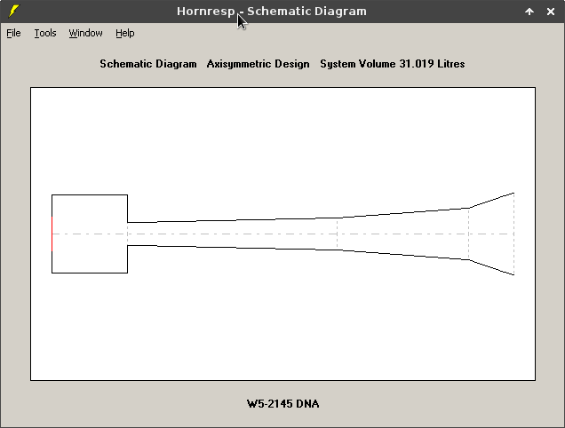

The characteristics of the DNA is a fairly large compression chamber with a back venting horn in a quite compact form factor. The size of the compression chamber is about 13.5 liters and the horn length is about 1.45 meters. The exterior dimensions in cm are ~ H: 72, D: 33, W: 20.
The exterior dimensions in cm of the Frugel-Horn Mk1 Level 0 are; H: 77.5, D: 26.7, W: 17.6. The horn length is about 1.75 meters. The compression chamber comes in three different sizes, the largest is 5.8 liters.
So the Frugel-Horn Mk1 Level 0 is a bit taller, a tad skinnier, got a bit longer horn and a compression chamber half the size compared to the DNA. I wonder how much of a difference it makes? xrk971, you don't happen to have a model of the Frugel-Horn Level 0 that you could sim (plans attached)? My guess is that it doesn't differ that much but the Frugel-Horn Mk1 Level 0 is a much easier build, the build plans are freely available and well documented. It is also quite flexibel if you want to run it with different drivers. The Frugel-Horn Mk1 Level 0 might not be as good as the Frugel-Horn Mk3 but maybe it's as good as the DNA?

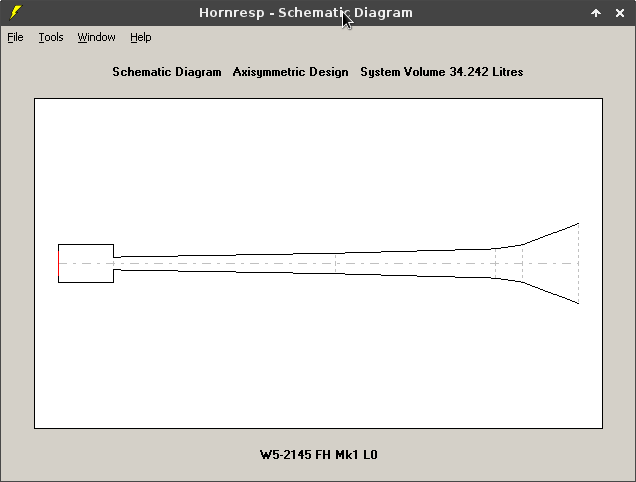

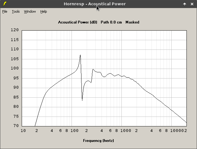

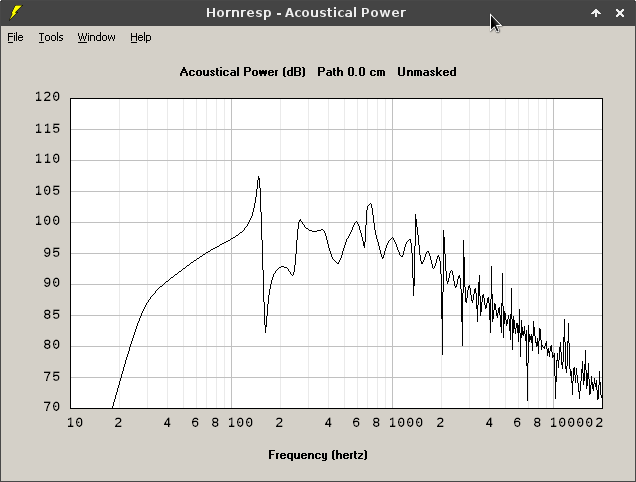

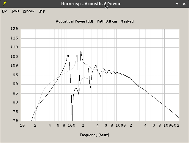

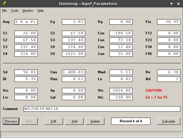

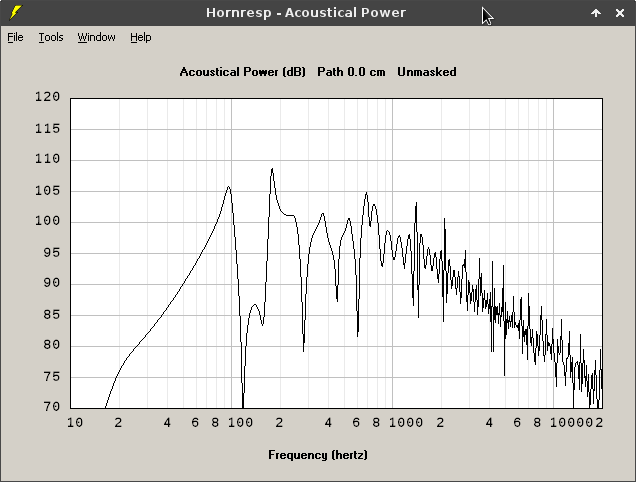

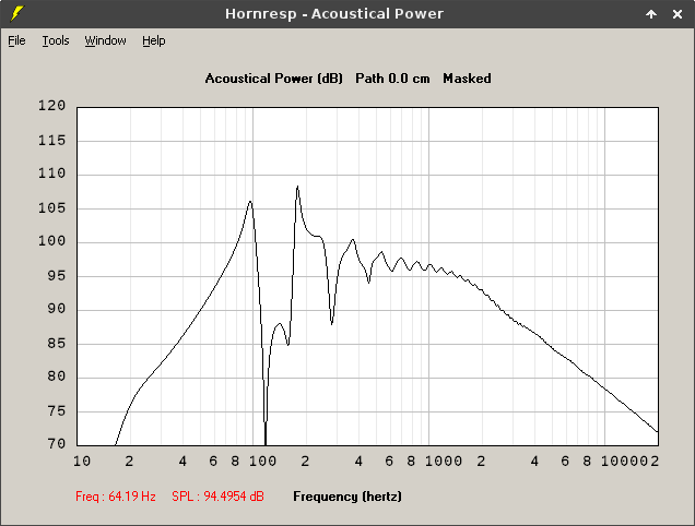

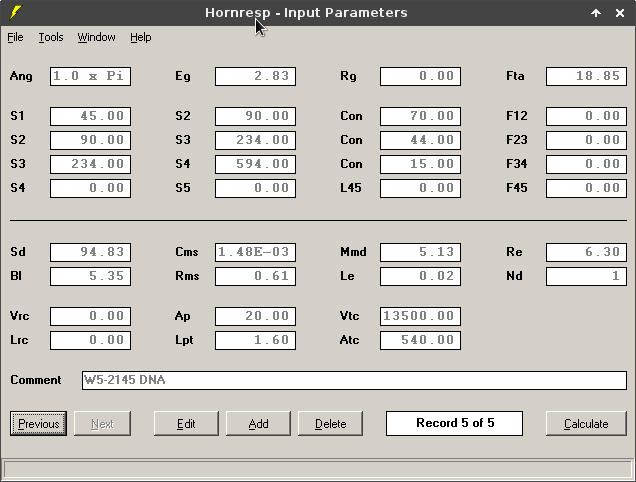

Made a rough model of the DNA and FH Mk1 L0 and ran them in HornResp with the parameters measured by X for the W5-2143, se attached files. More of a difference than I expected. It seems like the DNA is really digging deeper and is overall more controlled. The file DNA-vs-FS.png holds the comparison of masked response for the DNA vs FH Mk1 L0 (DNA in grey, previous driver).
Ps. Not easy to get but the order of the images are; DNA parameters, DNA unmasked output, DNA horn profile, DNA masked output, FH parameters, FH unmasked output, FH horn profile, FH masked output and finally DNA vs FH masked output.

so, out of curiosity, how does the FH3 with A7.3 model? - I know how both sound
I will try to make a comparison when I get the time but I am right now following Daves advice and forgetting the FH Mk1 L0. ;)
Ps. You might have noticed that I didn't corner load the speakers in my HornResp sim, but I can say that the sim of the DNA looks better corner loaded while the FH Mk1 L0 looks pretty much the same.
