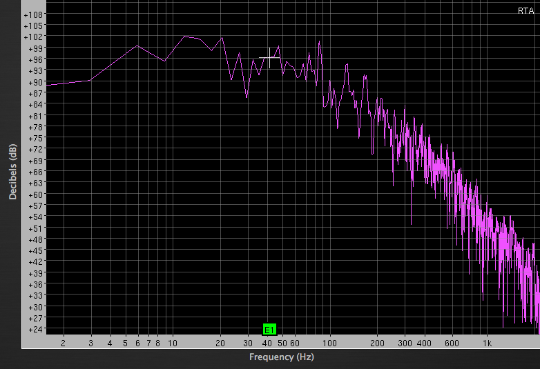

Slapped bass output can go down lower than whale song.Here I would politely bow my noob nose out and hand over the minimum requirements, statement of requirements (SOR) discussions and assertions to guys like Art, @weltersys. The only real input that I could have would start and stop at porch party levels. How about a true Bass Bin and a true Bass Monitor Art?
This real time capture of a passive magnetic pickup Yamaha 4 string (normal tuning, low E 41Hz) took me only a few attempts, 2Hz amplitude is higher than 100Hz:
If you want to "truly" reproduce that at porch party levels, your (sealed) bass bin monitor is going to be large, heavy, and use a lot of power. Without a HP, you can watch the cones flop around like a fish out of water.

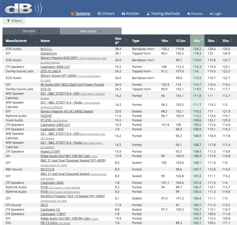

Josh Ricci has tested tons of bass bins of all sorts outdoors- the readings are at 2meters, so add +6dB to them for the usual 1meter ground plane equivalent:
Comparing your Logitech z623 to most of those bins is like comparing a breath to a wind storm.

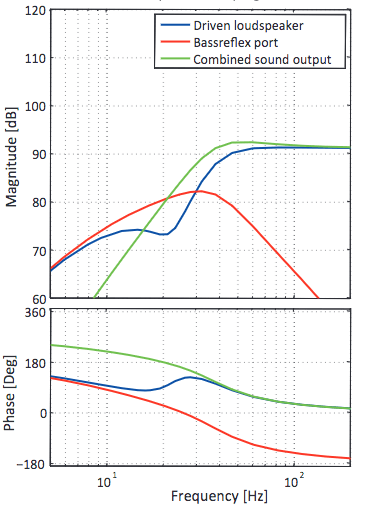

When looked at as an entire system, the bass reflex response may be considered minimum phase, but combined group delay alone does not characterize the separate arrival times of the driver and port output.
The compliance, or ”springiness" of the air inside the enclosure reacts with the air mass in the port in a similar manner as the air in a bottle resonates when a current of air is directed across the opening, exciting it’s Helmholtz resonance.
The Fb (frequency of box tuning) at which the box/port system resonates, is determined by the effective length and cross sectional area of the duct, the volume of the “air spring” in the enclosure, and the speed of sound in air.
Since the driver’s back wave is in opposite polarity with the front wave, this inversion brings the two emissions in phase, although the vent output lags by one wave period.
Above Fb, the back wave of the bass driver’s sound emission through the port is delayed by the “air spring” and inverted in polarity, the first arrival of the port output is delayed 360 degrees from the driver output.
At Fb, the first arrival of the port output is delayed 270 degrees from the driver output.
The “in phase” combination of the delayed port output and the driver’s front wave constructively reinforce each other. The constructive reinforcement produces higher output for a given driver excursion compared to a closed box, or a similar output with less excursion around Fb, which reduces driver distortion around Fb.
The drawback of the resonant reinforcement is time smearing, the vent output augments the driver’s output by adding a "resonant tail" to it.
At Fb, the port’s output is 90 degrees behind the driver’s front radiation, at frequencies below Fb, the vent polarity inversion reverts to 180 degrees, and the out of phase back wave cancels the front, reducing combined output at around 24dB per octave. Below Fb, the driver behaves as though in free air.
The bass reflex time smear drawback vs the requirement of double the sealed drivers and power for similar low frequency SPL is why neither sealed or ported cabinets have ever gone "out of fashion".

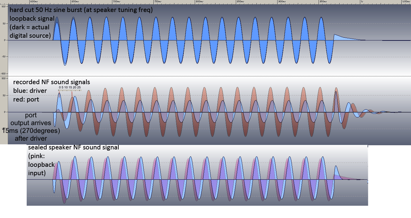

50Hz is a nice number to work with, 1000ms/50Hz=20ms being one cycle (360 degrees) duration time, each 90 degrees of phase 5ms.
At Fb (bass reflex tuning frequency) your "hard burst" test clearly shows the first arrival of the port output delayed by 15ms, (270 degrees) from the driver output:
We hear complaints about the amplitude level "ramp up" time of the port and it's decay time, seeing the ported compared to a sealed in this manner shows clearly shows what the static phase and frequency response chart above does not.

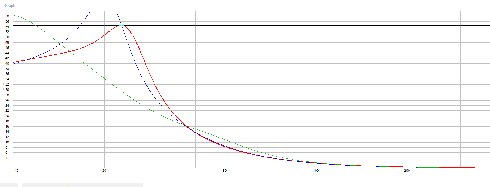

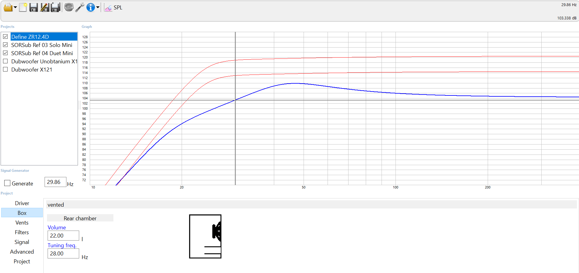

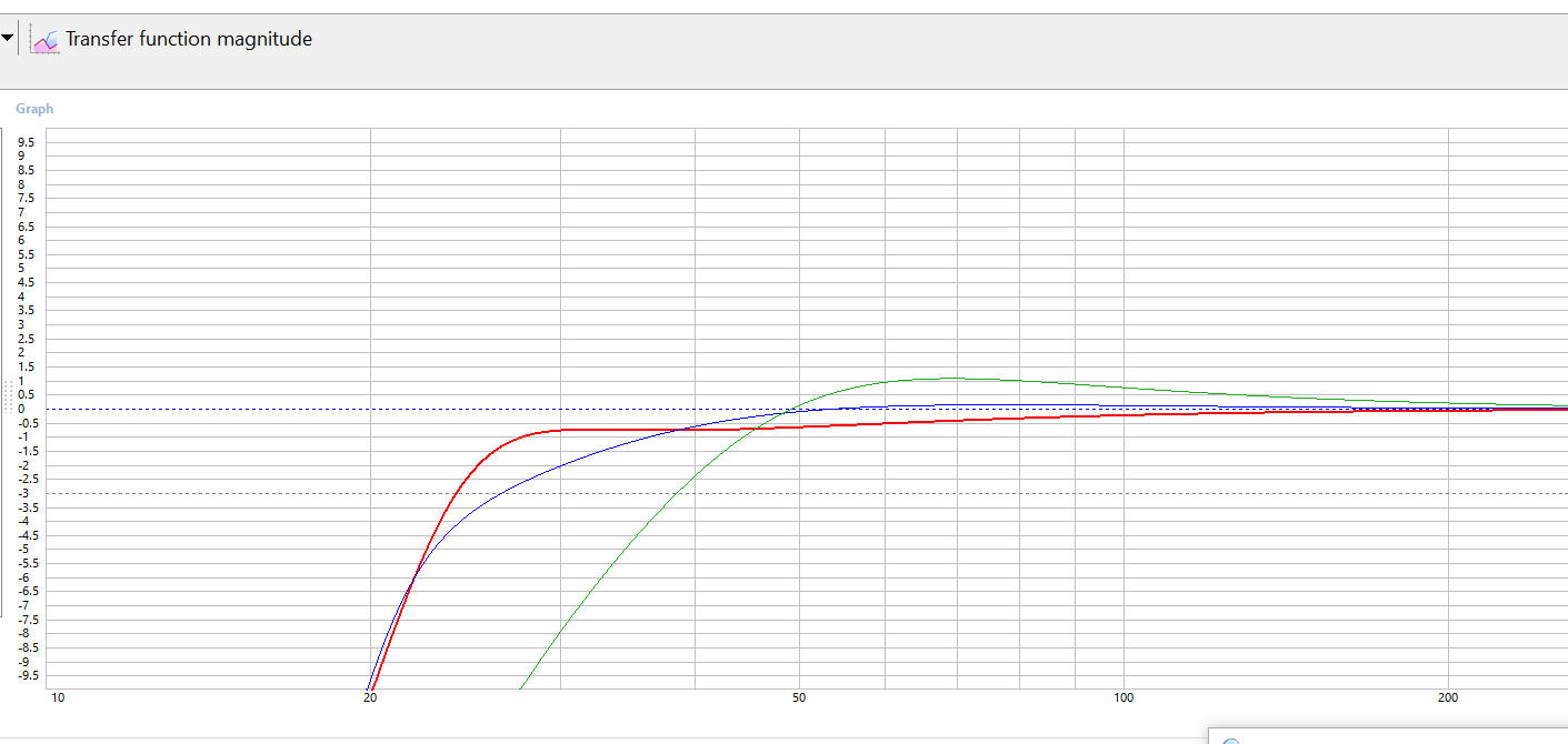

Lets add to the chaos. I haven’t yet run the Lab12 through the sims. Is this a good sub to use as a reference for comparing traces? Can it hold its own against the smaller ZXI10.4D and the quieter but lower reaching in the same box ZXI12.4D. Can the Lab12 adapt to a small box?
What other main stream drivers can beat up 30Hz and lower with 35L and exceed THX over the sub band

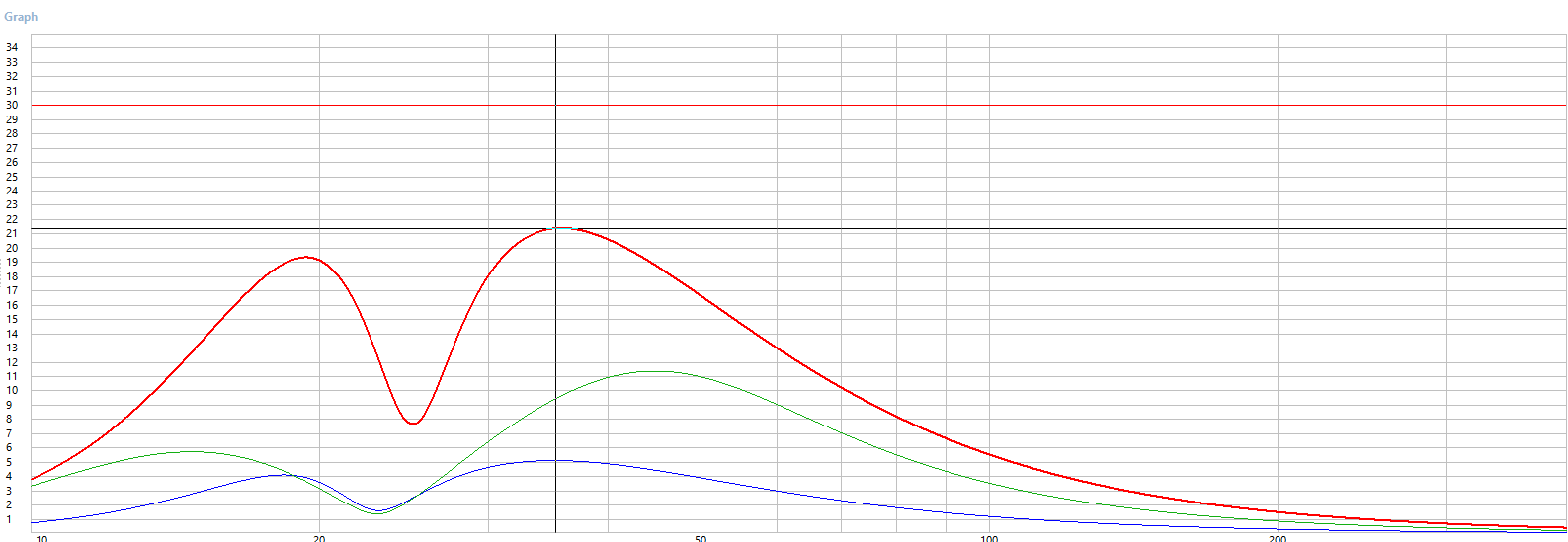

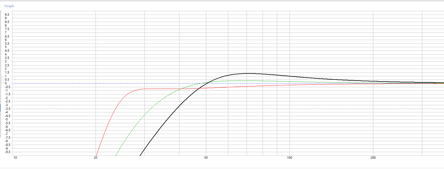

The box is 35L and 23Hz tuning. Blue is the ZXI12.4D and green is the LAB12. The red trace is the ZXI10.4D in 30L and 25Hz tuning. The sims sorta bear out my talks with DS18 about choosing one of their drivers for home HT and music, with the 10" being most highly recommended to me for low, loud and clean in a very small box. There is no boost used and the drivers are at full power. All have 20Hz high pass turned on
Lets see if I am reading this right. The LAB12 suffers a bit in the undersize box. WinISD initially places it in 100L with 22Hz Fb and it does have very awesome low reach with that volume behind it. But at 35L, the ZXIs make better use of the low volume and reach lower with a flatter response. Please pull me up if I am not reading this correctly

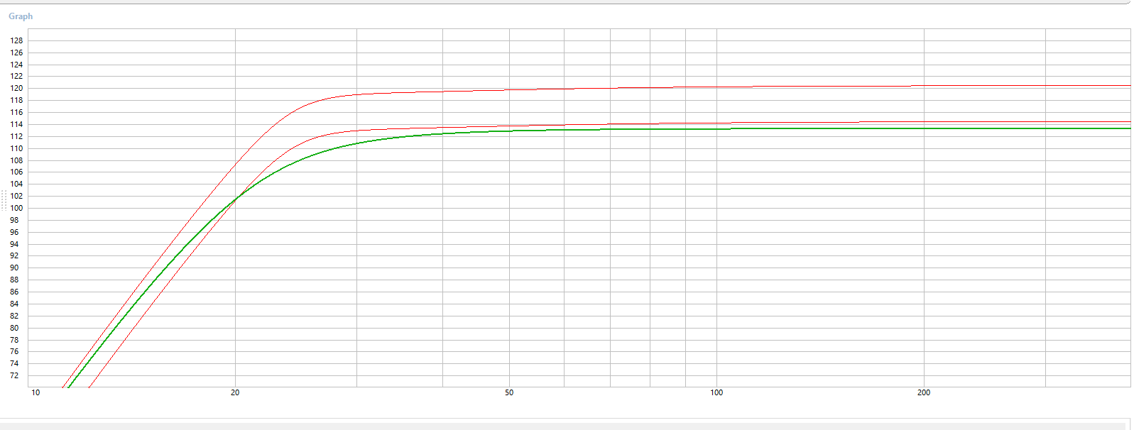

Let's see the SPL graph
The drivers are at their respective full powers. That lil 10" is impressing me. That's some serious output from 30L. Which one is subwoofing the most here?

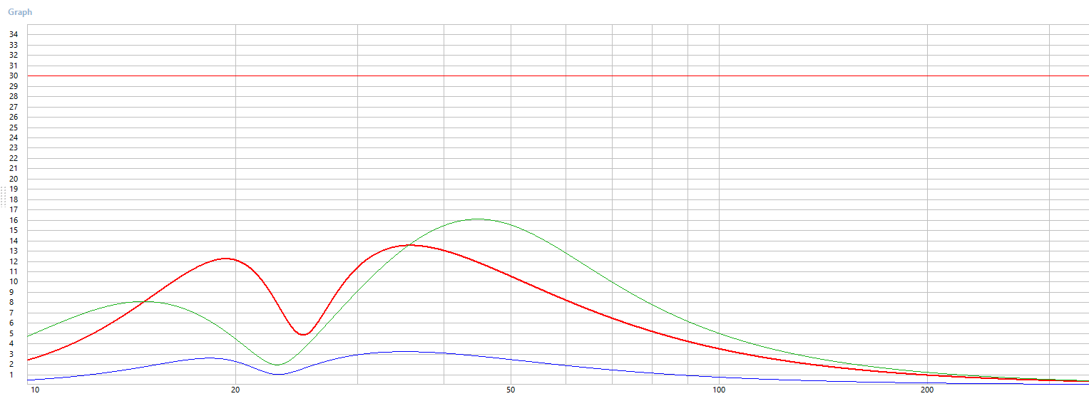

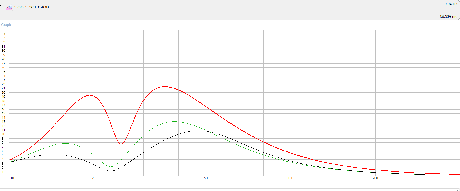

Let's see what the excursion graph says about how hard the drivers are working
The lil 10 is working hard but still well within its limits. Would I be correctly reading this if I conclude that the 10 is responding more to the input signal and converting electrical energy to mechanical therefore acoustic more efficiently?

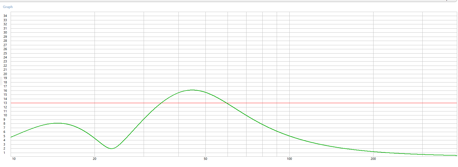

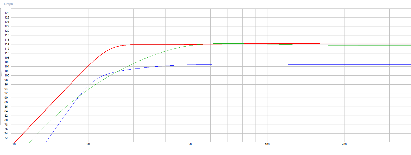

Here is another interesting one. Lets see the LAB12 with the stated 'program power' whatever that means
The LAB12 seems to exceed xmass over much of the audible low bass to band on 60Hz. This tells me that the program power is drivel. What is that supposed to be good for? I can see an enthusiastic kick just making it but adding a bass guitar note to that kick would toast the driver. Actually the driver in the pics and the response seem a lot like the dual magnet high excursion Response driver that Jaycar introduced back in the heyday of DIY when the car subs were just getting up with the JLs in v1. That driver did doof doof ok, but dub made toast out of it. A similar driver was used in the bandpass subs of the sound system in the cellar club that I once DJ'ed on. On the other had, the other drivers seem to handle peak power with much more composure and not exceeding xmax above Fb

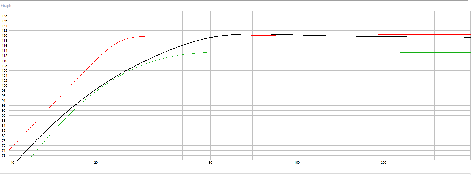

Let's give all of them the LAB12s 800w program power and see the Xmax and SPL graphs to see how efficiently they are converting electrical to mechanical
Given the same power, The LAB12 is more efficient converting higher up towards 50Hz while the 10 is a touch more efficiend towards 30Hz. The ZXI12.4D seems stubborn in comparision but makes up for it by being the least peaky of the trio or the most linear

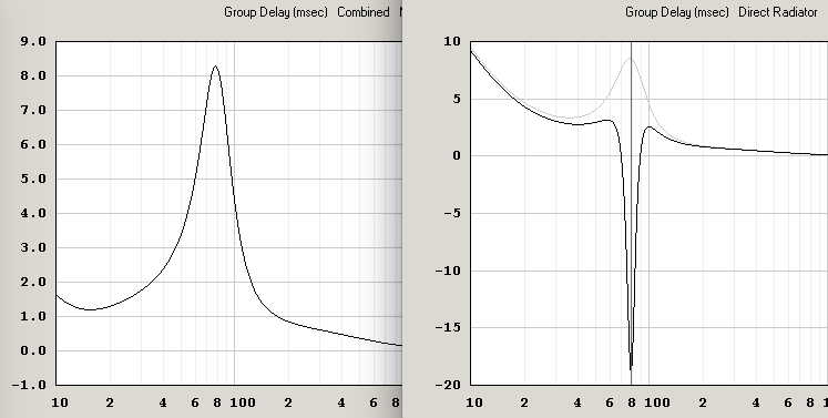

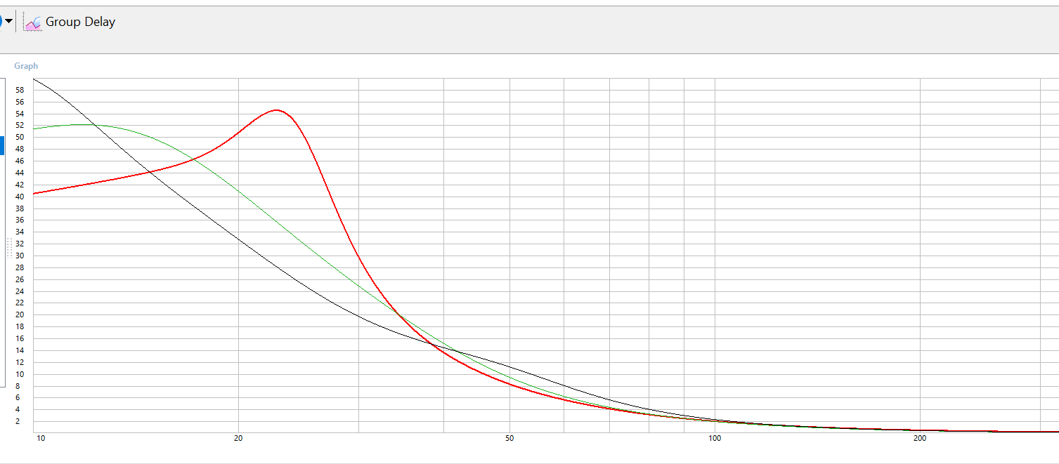

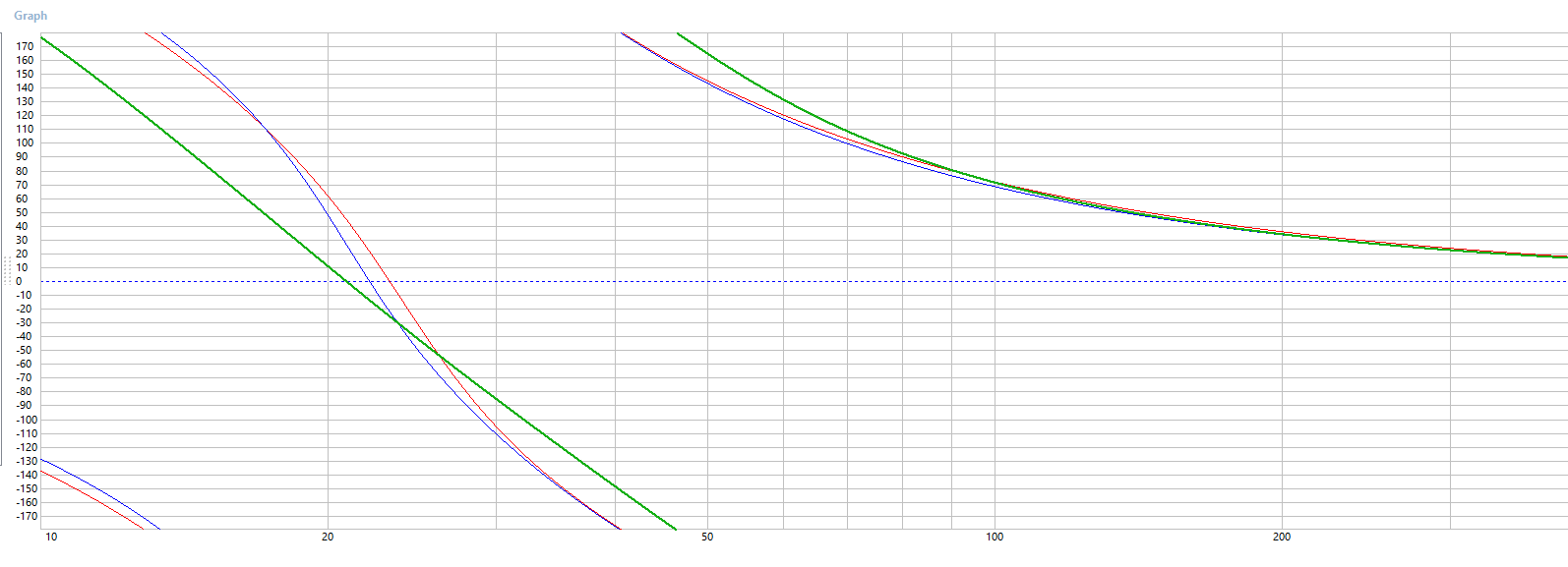

Thats the output side. Lets see how much group delay
The LAB12 appears to have a very good return here but is this due to being not able to get up in the small box? At about 30Hz and higher, all of them are doing very well
I don't know how to read phase very well. What does it mean for a bench report and what it means for music listening
