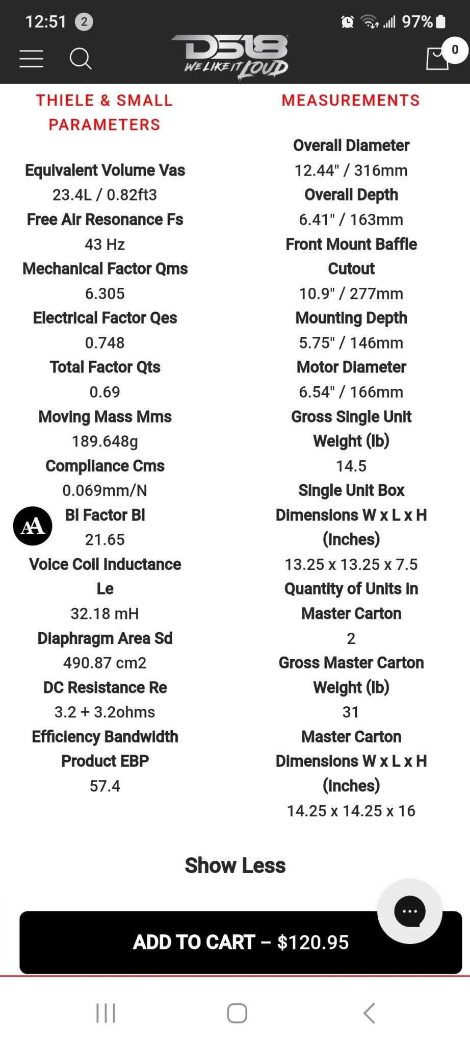

I am sort of twigging onto what is happening with the spec listings with this brand's DVC subs. Help me figure this out please
Let's take two models that appear to be identical physically and the SVC appears to be running half the coils of the DVC
The Qes change is there. So the DVC seems to list for both coils in this regard, I am guessing that halving of the value for input into HR or WinISD is not required
The Bl, what is happening here? The SVC lists 12.946 and the DVC 21.65

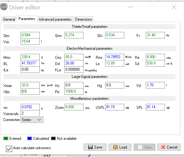

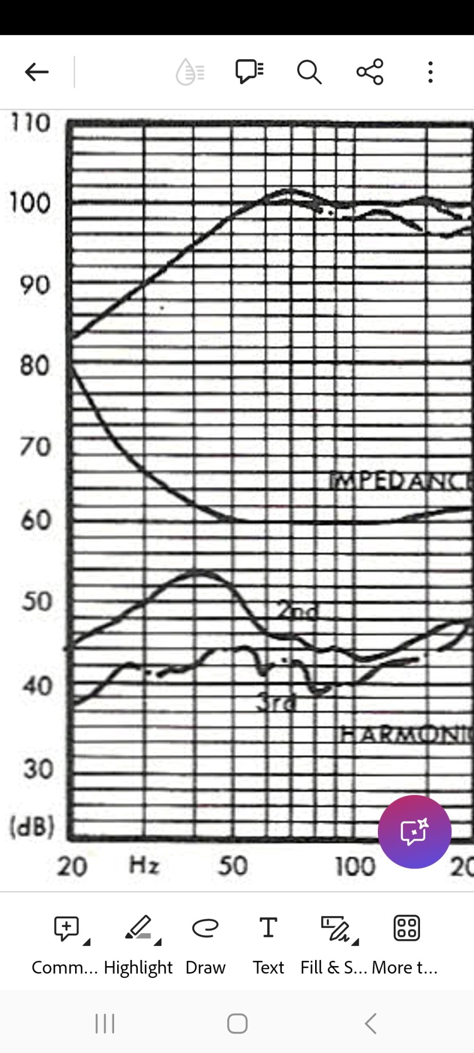

Estimating BL
Well, in this doc I posted, notice the impact BL has on Qes, Qms.@David McBean. I'll continue this issue here instead of inundating the HR thread with this

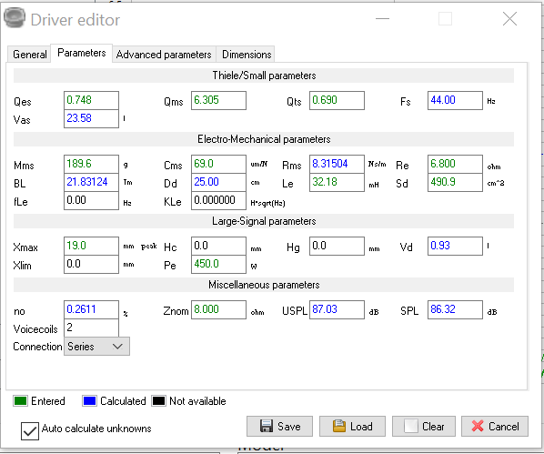

GM, I can see the relationship, but not enough to be able to resolve the problem at hand. When I assume that the GEN-X12.4D data is with coils in series, all seems well in the cells that WinISD can auto calculate. Please see this screenshot. The numbers in blue, Bl, Vas, Fs are calculated by WinISD and reflect the numbers in the datasheet. This seems to say that the coils are measured in series. When compared to the SVC version of this speaker, the datasheets seems correct under this assumption. This is the best conclusion that I can come up with, but it goes against tech support saying that the data is per coilWell, in this doc I posted, notice the impact BL has on Qes, Qms.![]()
If it can be correctly inferred that this screenshot is valid, then the GEN-X offers the performance that I am after, and I would like to secure some drivers. In other words, if the data below looks valid, then I can go ahead and follow the instructions to enter this into HR.

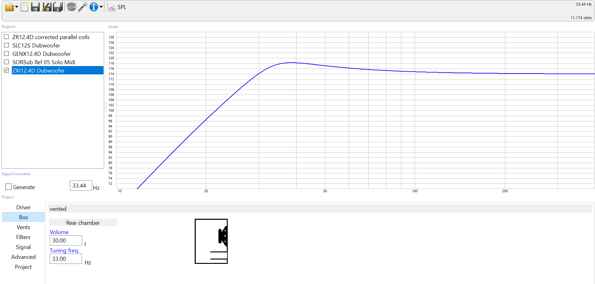

And guys, let me look at this from another perspective and leave the ambiguities of datasheet aside. I am trying to wring maximum quality performance out of minimum volume. I have been taking a look from the physical properties and have reconciled to gambling on this. Would it be a bad move to go for the largest voice coil, magnet, excursion and power in a 12"
How does the ZXI12.4D that BP1Fanatic took for a spin in HR look?
Voice coil is 3"
Quad stack magnet with each plate being 1.58kg and total 6.35kg....180mm dia
32mm Xmax
1kwrms and 2kw peak
WinISD calculates a higher Bl, and low sensitivity but returns much better graphs
I think I can live with this x4 so will start by ordering developing two units for a pair of dubwoofer cabs at around 33Hz tune and a single dual opposed true sub around 23Hz tune. These can measure and compare with the ZR12.4D in hand
Seems to me that if you study these two docs I posted earlier following tech support or measure them you can answer your own (and other newbies) Qs.GM, I can see the relationship, but not enough to be able to resolve the problem at hand.
That's the hiccup isn't it, tech advice seems unreliable and the only way to measure them is to buy them first. Will do this for the ZXI when in handfollowing tech support or measure them
An interesting WinISD discovery. In the parameter's dialogue, the SPL field is a display field only. It calculates and displays here, or I can set a number here, let's say if different from the datasheet. Why a display field only? Because changing this to anything else doesn't change the graphs. Those are calculated without needing any data in that field from the user
