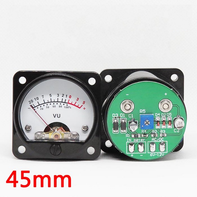

I found some information.
The popular specification of VU meter is 650 ohm/500 uA, but only can connect to the 50W output like attached photo. but the TAS3251 is 175W.
And if it is connect to the TAS3251 output, it will be distort by volume up/down.
If I want to create my own circuit with the 650ohm/500uA meter, What can i do?
have any drive IC can use for it?
