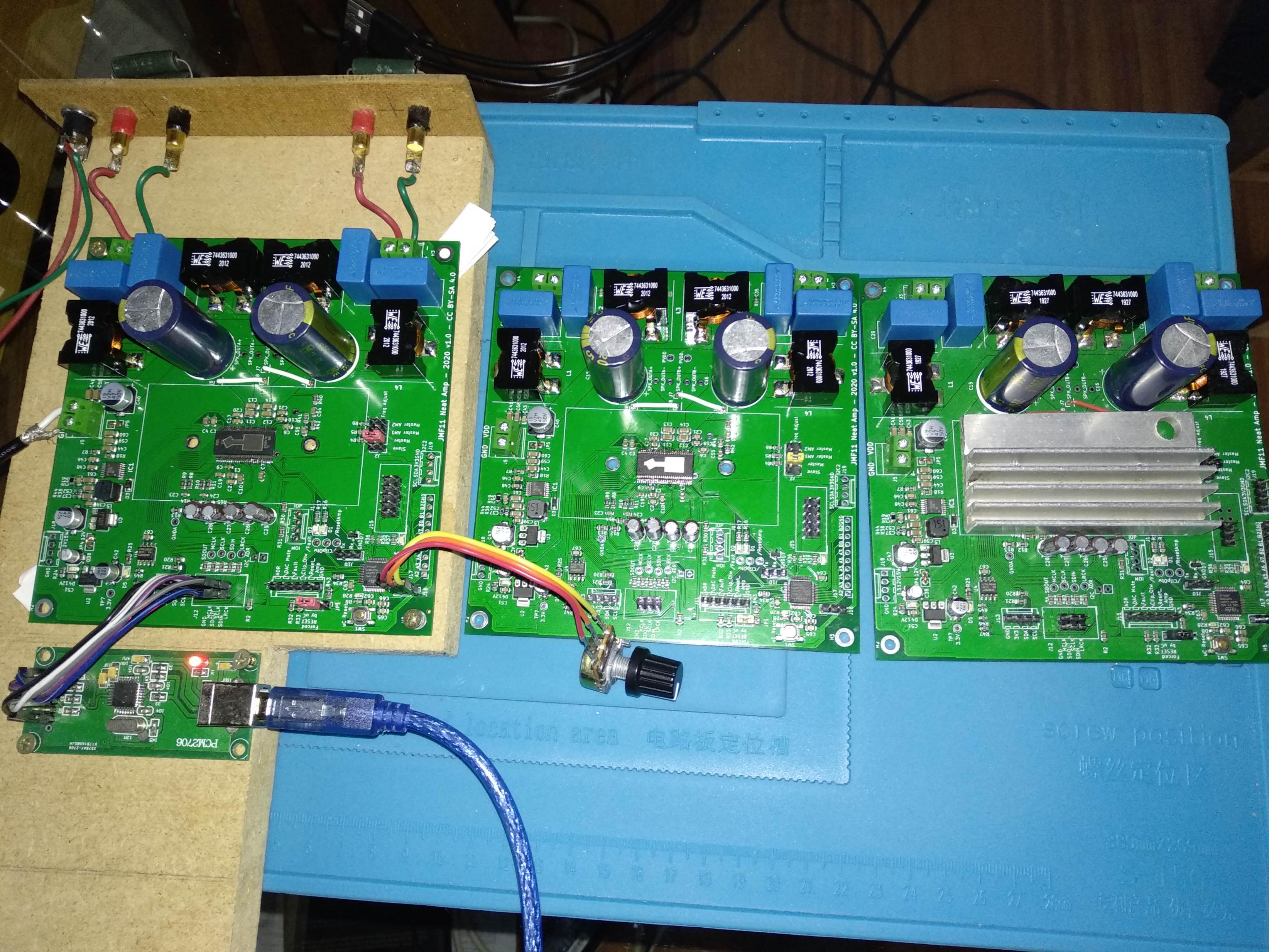

Hi all,
I took the opportunity of the Christmas leaves to build 2 more boards. It worked smoothly, even if, for me, the soldering of the TAS3251 is always sort of an achievement.
I complemented my Github site with a page on my board building sequence and power-up sequence:
Board building and powering sequence * jmf13/NeatAmpTAS3251 Wiki * GitHub

Happy new year JMF! May the NeatAmp come to live in 2021Pictures look promising.
Amp is already alive

Arduino programming is efficient. I now have:
- code for the slave board,
- code for the master board to configure and control both boards (and TAS3251) with I2C,
- both boards receive the same I2S.
For the moment, they play the same thing (same config file to both boards).
I have to think a bit about how to "differentiate" the two boards. My current idea is to have the same DSP config file for both, and to manually adjust the Input Mixer to:
- use only I2S Left for Master (associated to Left speaker),
- use only I2S Right for Slave (associated to Right speaker).
