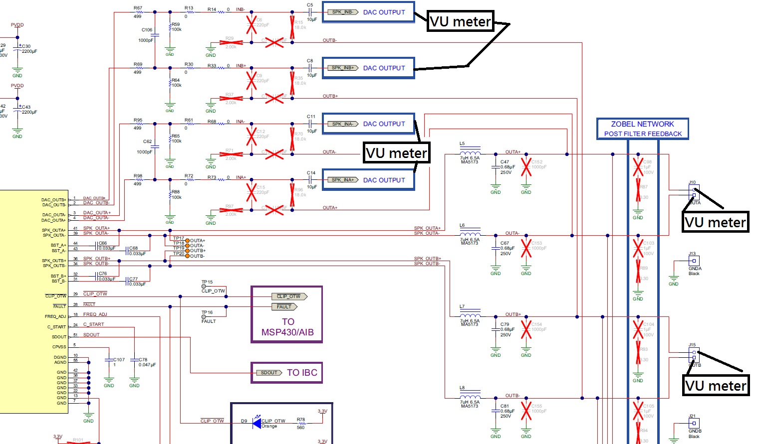

If I want to add a VU meter for L/R channel, can the VM meter be connect in parallel with the speaker out, or add to the TAS3251 DAC output?
I don't have any idea about VU meter.
Is there a VU meter driver IC available on the market?
thanks.
