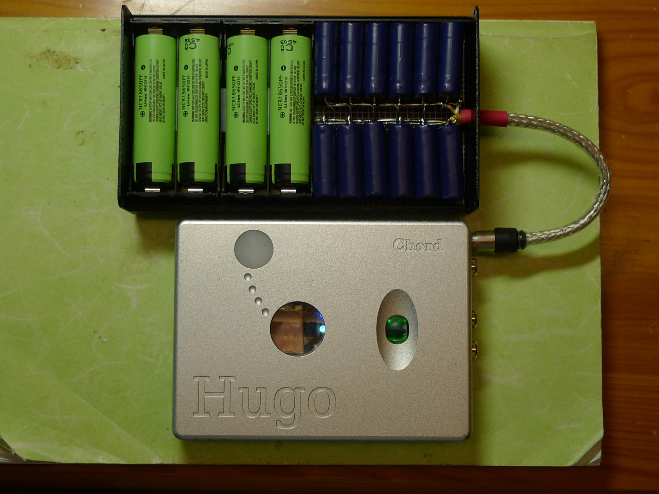

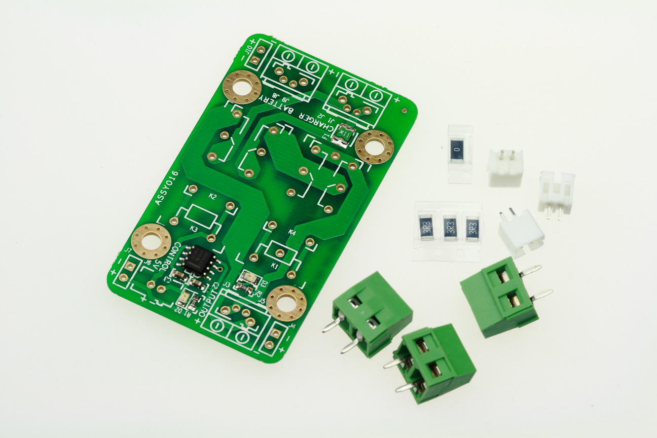

Hi Ian - I am looking forward to your progress on this. Just as a reference, I built a quick and dirty LiPO supply for my Allo isolator and Boss DAC. The Raspberry Pi is powered by a 5 volt linear supply (which also powers the battery charging module). 2 relays are used to switch the LiPOs between parallel for charging and series for powering the isolator. A third relay switches the power out to the isolator between battery and unregulated power, so that the isolator and DAC are totally galvanically isolated from the Pi.
The relays are controlled by a GPIO pin which goes high when the player is active (it is running PiCorePlayer). When the player is quiescent, the batteries are switched into charge mode. This works well enough so that the batteries always have enough charge for extended listening.
This is pretty simplistic, so for my next project, I would like to implement your idea.
Pictures (one is the custom PCB I made for this) and schematic attached for anyone who wants to duplicate.

Hi Wtnh,
Your PCB looks very good. I think you are very happy with your battery power supply and the sound quality.
I did some thing similar years ago. But this time, I have to take a lot of things into design consideration.

Using a 18650 battery to charge supercapacitor and then power it directly from the supercapacitor without LDOs. This is much simpler, anyone can DIY without the PCB.
According to experience, it is better to use multiple supercapacitors in parallel.
Supercapacitors have poor voltage endurance performance. If you use a general DC power supply, even if you use LDOs, there is still a risk of damage to the supercapacitor. If LDOs are not specifically protected, LDOs are easily destroyed by the discharge of supercapacitors. Therefore, using a stable output battery to charge supercapacitor is the most ideal method.

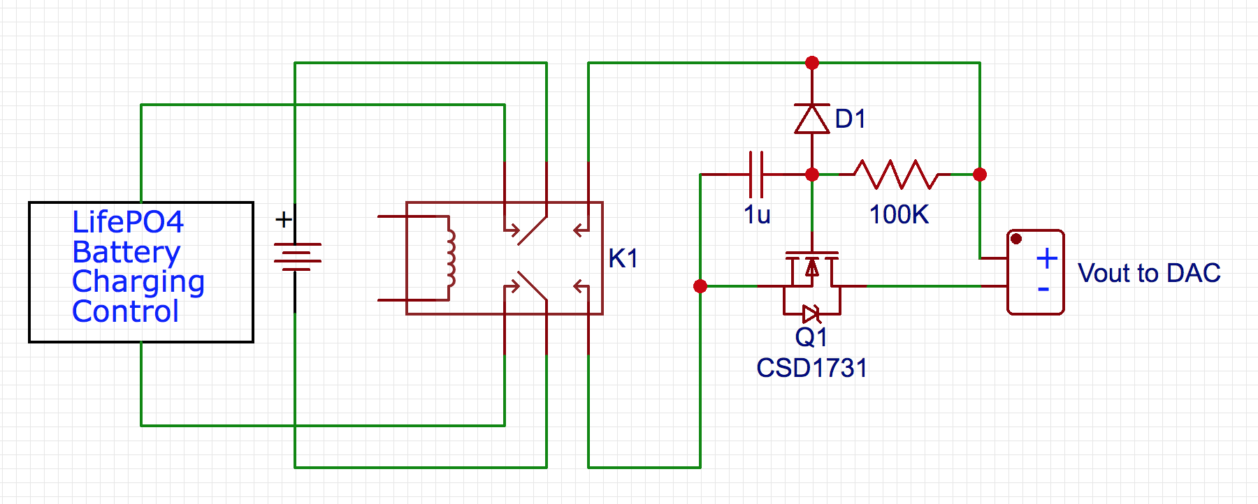

I had been thinking about the relay contact current problem also. On the charging side, using a constant current/constant voltage charging IC should limit the current through the contacts. The supply side is trickier since the downstream decoupling caps could be discharged and easily arc the contacts when they close. One solution could be a second relay in series with a low value current limiting resistor. After a suitable delay, the main relay would bypass the resistor and provide a low impedance path.
Another approach could be a low Rds-on mosfet in series with the contacts to limit the inrush. Similar to special power distribution ICs which are used in hot-swap applications (although most of these have charge pumps which would inject noise). The mosfet could provide a soft start function.

For the mosfet case, perhaps something like the attached....
Cheers
Whit
@Whit
I like your idea of the MOSFET solution. Very smart!
I would be glad to implement it in my design if I didn't have the relay array. Now, the array has delay relays included. The delay could be around 300ms to 1s. High current charger also has soft start feature.
Maybe I can implement your idea in my ultra capacitor power supply design later on.

Glad you like it. The CSD17312 seems like a good choice for this because the typical Rdson (with Vgs of 3 volts) is less than 2mOhms, a lot less than typical relay contacts. The Vgsth is only 1.1 volts and it can handle 30 amps. The datasheet is here. Also, it comes in a Q5 SMD package, so not much PCB real estate needed.
