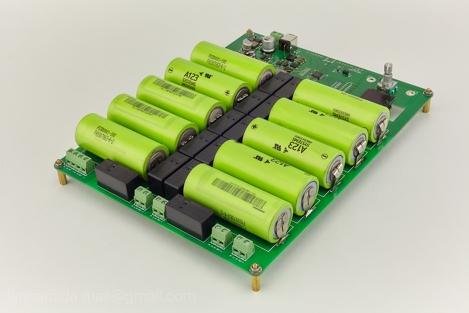

LifePO4 power supply first prototype PCB
Here is the new update of this weekend.
I assembled the first prototype PCB of my LifePO4 power supply on this weekend. The actual components are more than I estimated. Even on the bottom side of PCB. So, it took me a bit more time doing the SMT job. It becomes pretty heavy after all LifePO4 batteries are mounted.
It has all voltage rails to run a DAC. No need any more additional power supply.
Some small hardware bugs were fixed. Each section was carefully tested and works very well now. The charger can deliver up to 10A of charging current. Maybe I need to reduce it a little bit to make the batteries safer. Some new improvements will also be included and implemented in the second version PCB.
Now I'm still working on the code of the FW. Hopefully I can get it fully functional very soon.

Yes - I think it would be good. The best-case ESR for a LiFePO4 cell is about 34 mOhm, depending on state-of-charge and temperature, so the 2 mOhm contribution of the mosfet is not too bad. And if this is regarded as too high, two or more could be paralleled, I would think.
Supercaps (the best ones) are in the same ballpark as far as ESR goes.
As a reference, bear in mind that 1 foot of 24 gauge AWG stranded wire has a resistance of about 25 mOhms at room temperature and the same is true for a 2 inch-long 1mm-wide 1 oz PCB copper trace

That is a serious battery system! And I like the Lego man
So you are up to 12 relays?
Hi Ian,
Are your suggesting that 3.3Volts is sufficient for powering a Pi3 or a 5 volts piano-dac?
Hi Ian,
Maybe I should try it myself however....
Ed
@Ed
5V 2A linear rail is designed for RPi which in not isolated.
All other LifePO4 rails are isolated, and you can use them:
Two 3.3V rails for clock and DAC chip
+- 3.3V-13.2V rails for I/V and analog stages
Any LDO after battery will degrade the power supply. You need to remove them. Or you can also bypass them by feeding 3.3V directly rather than 5V.
However, if your DAC chip takes 5V internally, you have to wait for my ultra capacitor power supply which will have pure 5V output.
