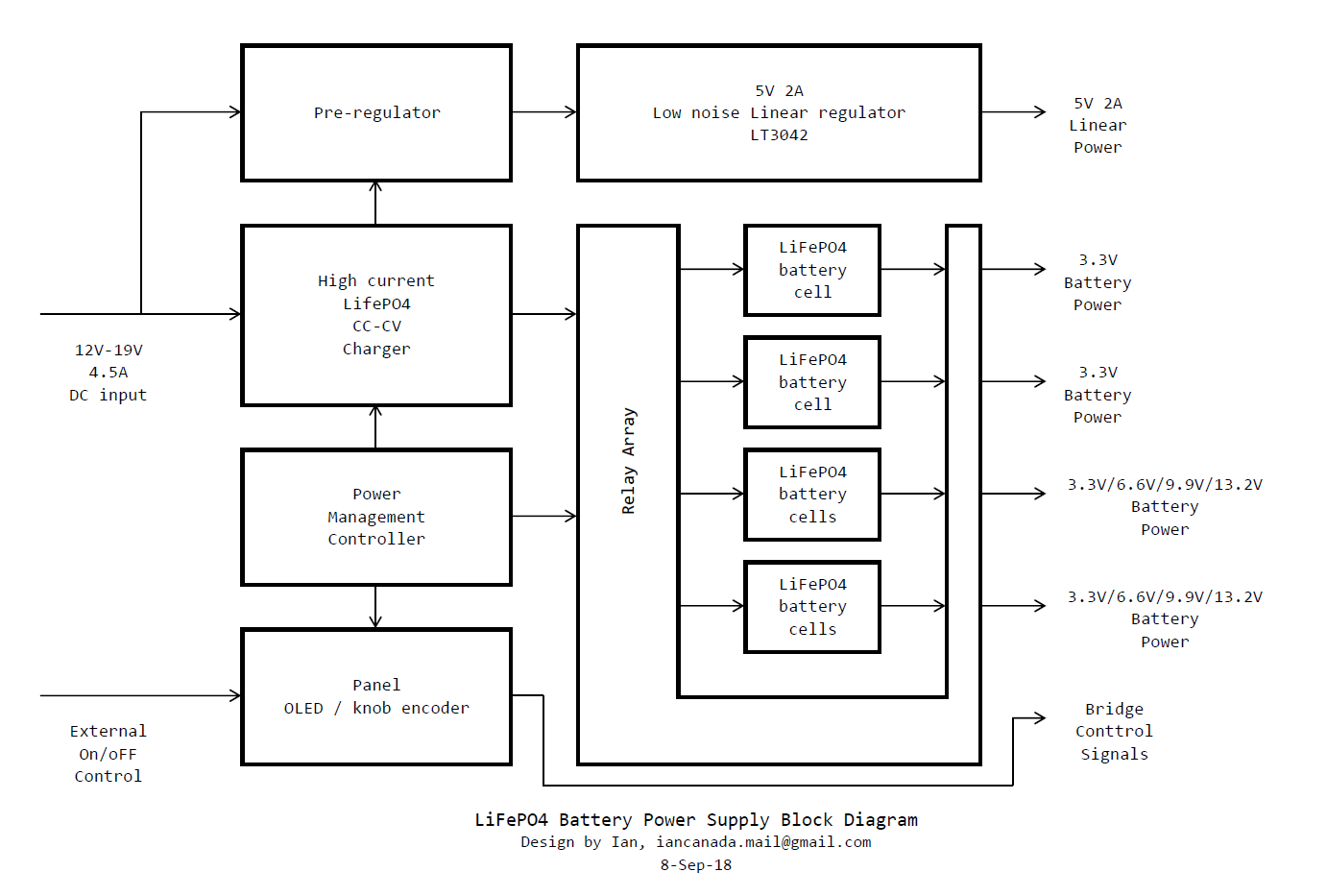

Yes - I think it would be good. The best-case ESR for a LiFePO4 cell is about 34 mOhm, depending on state-of-charge and temperature, so the 2 mOhm contribution of the mosfet is not too bad. And if this is regarded as too high, two or more could be paralleled, I would think.
Supercaps (the best ones) are in the same ballpark as far as ESR goes.
As a reference, bear in mind that 1 foot of 24 gauge AWG stranded wire has a resistance of about 25 mOhms at room temperature and the same is true for a 2 inch-long 1mm-wide 1 oz PCB copper trace.

I've noticed the PCB trace resistance issue already when I tested charging the LifePO4 cells at 10A. Exactly as what you mentioned.
I need to use 2 oz copper for PCB V2.0, as well as make copper area as big as possible. Will increase the cost a little bit but it worth it.

However, if your DAC chip takes 5V internally, you have to wait for my ultra capacitor power supply which will have pure 5V output.

Then, the down the road ultra capacitor power supply will exactly meet your application. But an ultra capacitor power supply can not be integrated as compact as a LifePO4 power supply because of the multiple banks will be included. Two or three rails per board is possible. But have to bridge them together if more voltage rails are required. Thus cost will also be increased. But any way, sound quality is the most significant thing.
BTW, according to my design idea, the LifePO4 power supply and the ultra capacitor power supply can also be bridged to work together.

Is there a reason you can't just switch on a voltage regulator when the battery or capacitor gets too low instead of using relays?
The voltage regulator can simply be disabled while the battery/capacitor is powering the DAC, then when the battery/capacitor gets too low the voltage regulator switches on and continues to power the DAC while charging the devices.
The sound may not be as good during the charging process but at least the device is not off and you get to avoid using relays or mofets.
Am I missing something?
