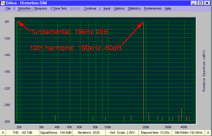

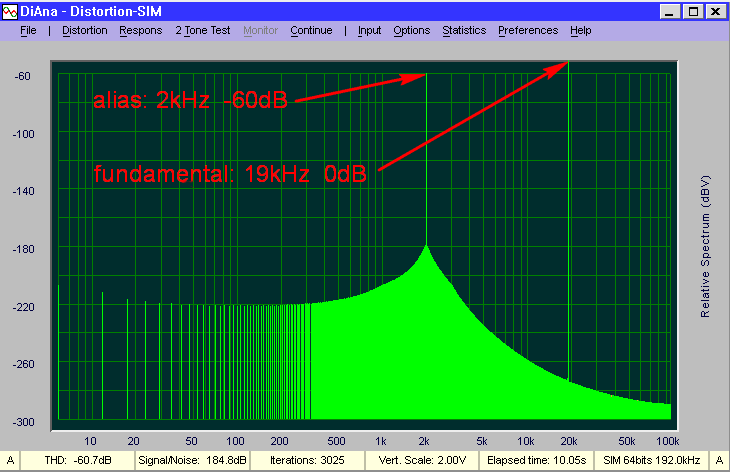

For those who have trouble understanding the principles of undersampling, have a look at the spectra below. Sampling rate 192kHz, input signal: 19kHz at 0dB plus 190kHz at -60dB. The 1st picture shows an ordinary FFT spectrum. Because no anti-alias filter has been applied, not surprisingly, an alias at 192k - 190k = 2kHz will show up.
The 2nd picture shows a spectrum that supports undersampling. That's how DiAna processes "difficult" signals. Just a clean spectrum without aliases and way less leakage. Are you guys convinced now?
E.
Excuse my ignorance, I still do not see the principle. If you have no bandpass filter, how do you know the signal at -60dB is 190kHz and not e.g. in the next mirror, e.g. 190 + 192 = 382kHz?
Your spectrum chart starts at the first harmonic - 19kHz. If it started at 0, would we see the 2kHz component there?
E.
Well, these plots look interesting. But HOW does that work? I don't see how one could reconstruct the information > fs/2 without some extra knowledge.
