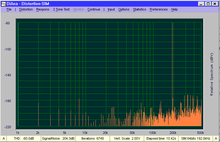

In case you take 1kHz + 190kHz test signal, (1kHz component must be clean), 192kHz sampling, no anti-aliasing filter, do you get the spectrum without 2kHz component?
Hi Edmond,
I mean 1kHz/0dB as a fundamental a 190kHz/-60dB as a second component. Thank you.
Hi Pavel,
Please have look. No 2kHz component, just one line at 190kHz.
BTW1: the ordinary spectrum does show a 2kHz component, of course.
BTW2: I've used 999.95Hz, as DiAna doesn't like 1kHz. Hope you don't mind. 😉
E.

Excuse my ignorance, I still do not see the principle. If you have no bandpass filter,
That's right.
how do you know the signal at -60dB is 190kHz and not e.g. in the next mirror, e.g. 190 + 192 = 382kHz?
It is what it is. DiAna didn't find a signal at 382kHz, simply because there's nothing at that frequency.
Your spectrum chart starts at the first harmonic - 19kHz. If it started at 0, would we see the 2kHz component there?
The first FFT bin is just DC and not shown. The next bin contains the fundamental (i.e. 19kHz). So there is no 2kHz bin at all.
E.
Remember: DiAna is an distortion analyzer in the first place and not a spectrum analyzer. :smash:

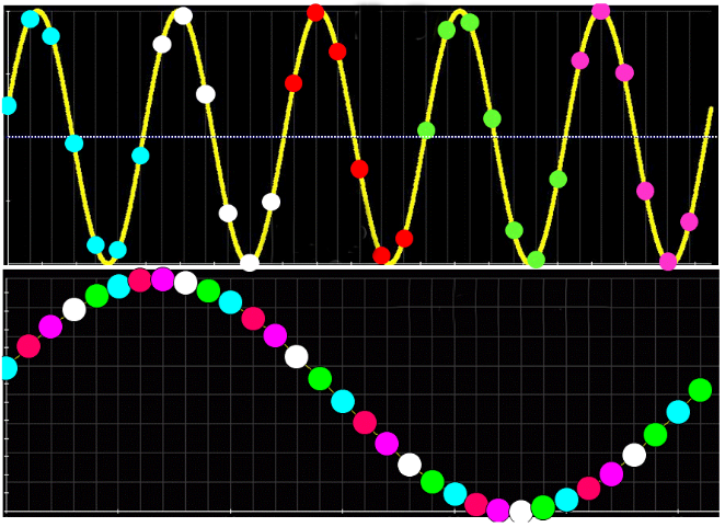

First read post #115 where I've explained how it works.
So how does it work? What are the underlying methods and procedures?
Coherent waveform reconstruction
How does DiAna recover signals that are buried in noise?
Simply by averaging out the noise.
How does DiAna reconstruct signal components from "behind the Nyquist wall"?
See picture below, showing how "coherent waveform reconstruction" works.
What do you mean by "distortion analyser, not a spectrum analyser"? (These terms seem to have a very specific meaning to you, but I believe they mean something else to me.)
A (FFT) spectrum analyzer shows a the spectrum that starts with f = fs/size up to fs/2 (where size = FFT size and fs = sampling rate), while the THD spectrum of DiAna starts at the fundamental frequency (ff) up to ff/(2*size) and thus may exceed the Nyquist frequency as well. Pretty different I would say and that's the reason I call it a distortion analyzer.
BTW, in case you are unsure, for whatever reason, about the measurement results of DiAna, you always can check or compare the results by means of the builtin simulation feature. But I don't tell you exactly (about the underlying algorithms) how I've done it. DiAna is a pretty unique program and I prefer to keep it that way.
And here's graphical presentation of "coherent waveform reconstruction" and how it "reshuffles" the input signal:

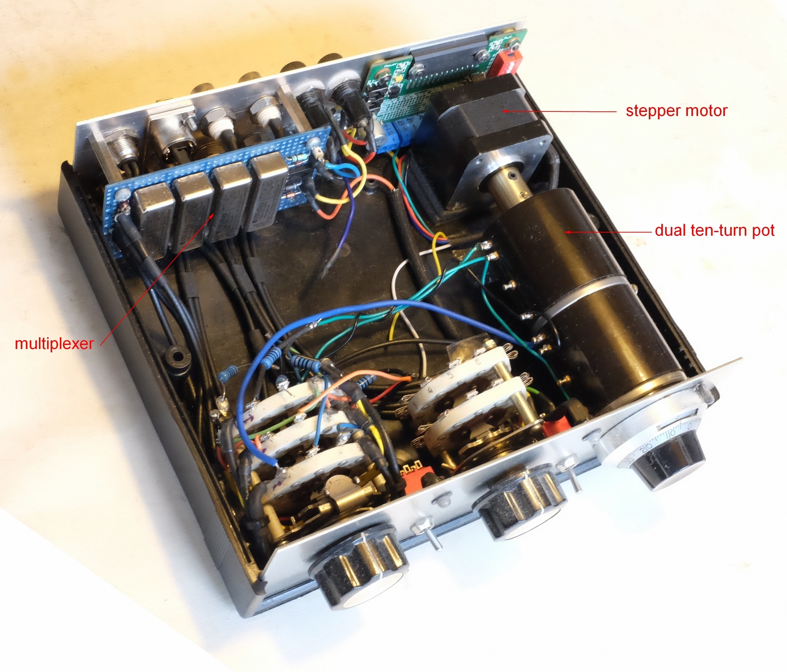

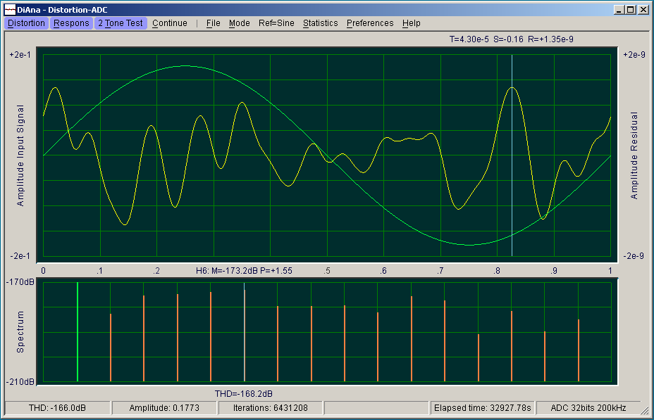

The second method is way more complex. It makes use of multiplexer in order to:
1. Interleave the reference and test measurements to eliminates drift effects as pointed out above.
2. Alternately switching the channels for reference and test measurements to compensate for imbalances between the ADC/DAC channels.
3. Measuring the phase and frequency response of DUT, which will be needed to subtract the distortion of the ADC/DAC itself in a meaningful way.
A disadvantage of this method is that one have to build a dedicated interface housing the multiplexer and other stuff like the servo to keep the ADC voltage constant. See 1st pic of an experimental prototype.
Anyhow, the measurement floor with this setup was much better: -166dB. see 2nd pic.
(Note: Only the pro version supports this method)
A third method to lower the measuring floor makes use of the ubiquitous notch and band-pass filters, way simpler than the second method, but for each frequency one needs a dedicated filter set. The next version of DiAna supports frequency and phase compensation of notch filters to reconstruct the shape of the residual.
