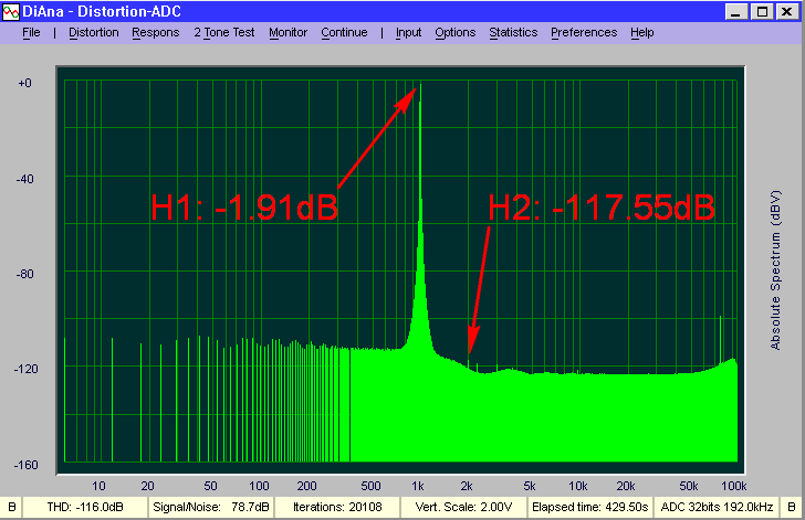

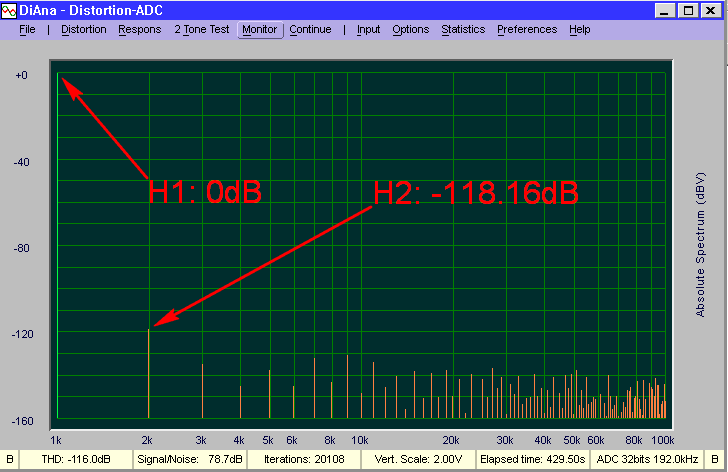

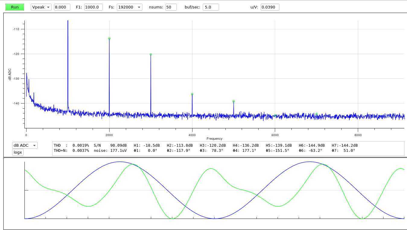

Someone ask what's better a regular/traditional FFT spectrum or a DiAna THD spectrum.
To answer that question, please have look at the pics below. The first one is a non-coherent average of regular FFT, while the second one is obtained by coherent averaging. No further data massage has been applied, i.e. no leakage compensation and no side lobe reduction, only a Hann window is used (named after Julius von Hann. So from now on be warned: any illiterate who still calls it a Hanning window, will immediately be put on my ignore list
The third pic shows a typical DiAna spectrum.
The regular spectra reveal not only a massive leakage from the fundamental, but also the magnitude of the fundamental and its harmonics are a few dB too low, all due to the (necessary!) window. Using no window at all is no option, as one will get rubbish. Only the 2nd and 3rd harmonic is hardly visible in the 1st pic (because of noise). Due to coherent averaging however, clearly visible in the 2nd pic. The 3rd spectrum is not plagued by these shortcomings: The magnitudes of the harmonic are correct (easily verified by means of simulation), no leakage or side lobes. Simply because the FFT is taken over exactly 1 period of the fundamental (or more precisely, the reconstruction of the fundamental and it harmonics). Therefore no window (Hann, Hamming, Kaiser or whatsoever) is needed.
BTW, DiAna does have provisions to enhanced the regular spectra, which are normally enabled. In these examples however, I've disabled this data massage (by setting some options in the ini file) to clearly show the differences in performance.

Not what I said, you lock the test oscillator to the A/D. I've done it, it works. You take one channel and generate a 1KHz tone to lock the oscillator to and measure with the other. I also mean exactly 1kHz using 96K FFT's, I won't use any software that does not support arbitrary N FFT's (the stone age).

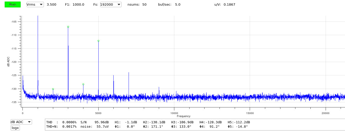

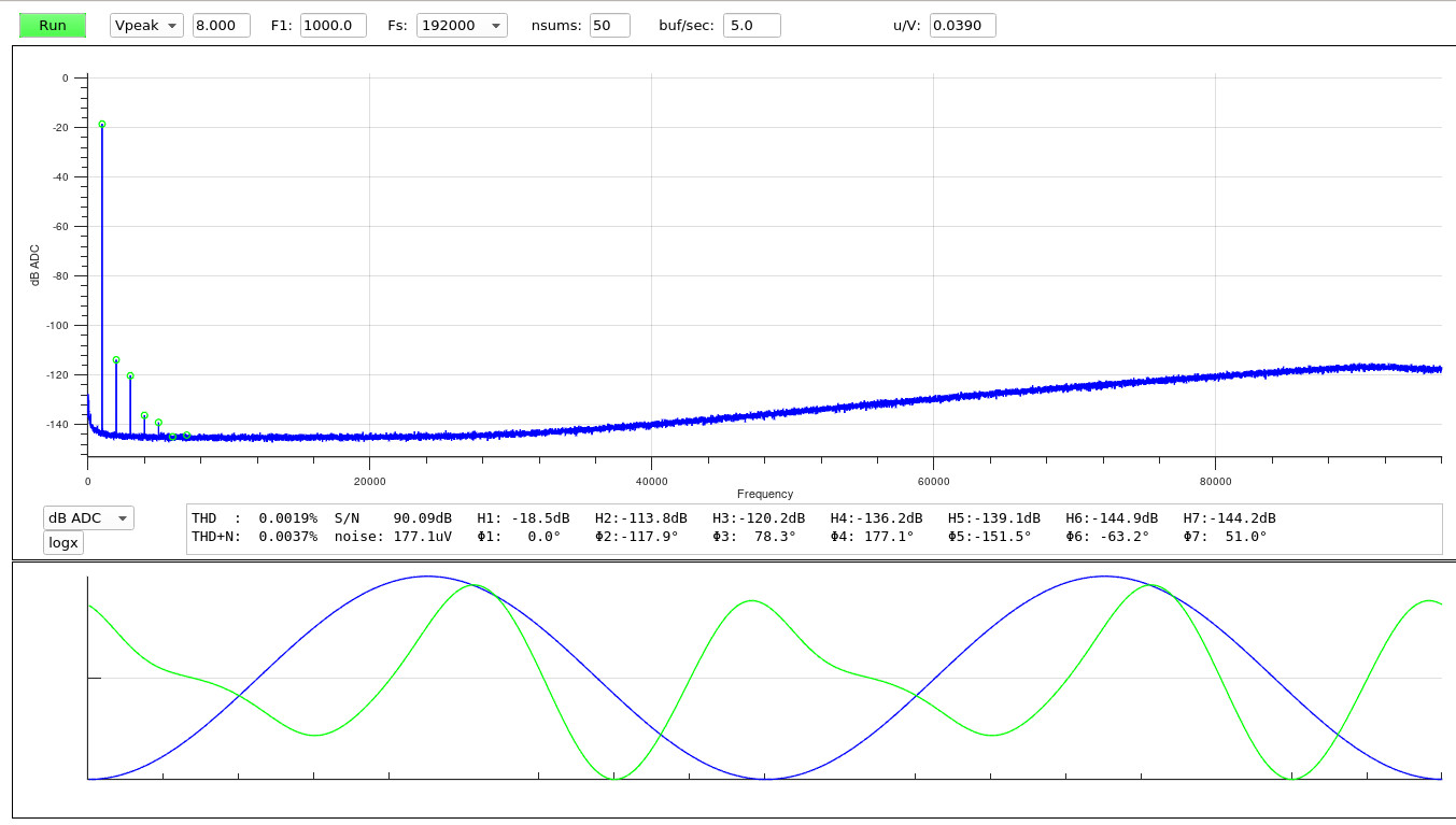

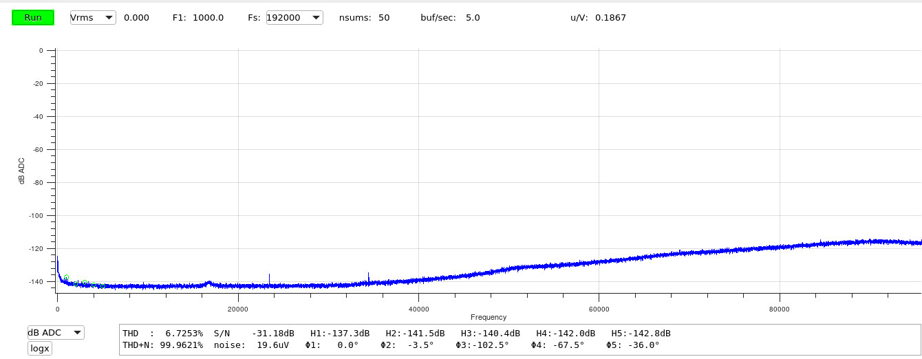

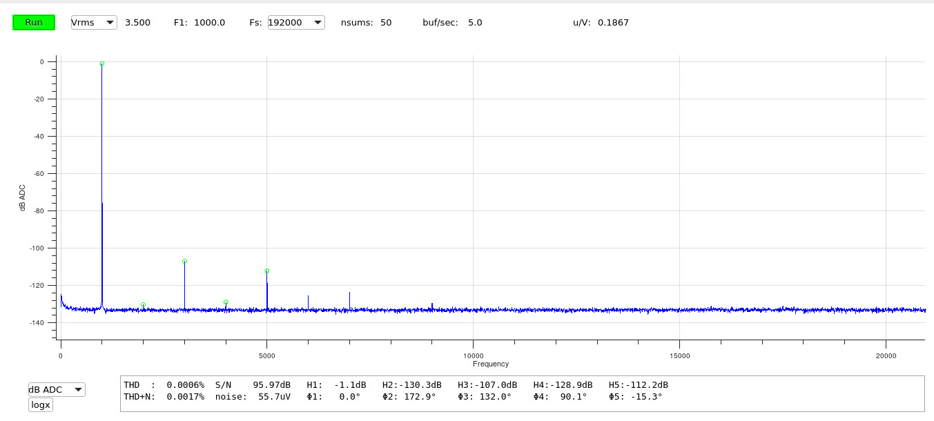

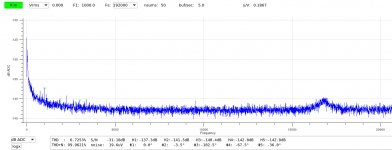

What is the noise floor of the DAC/ADC?
My previous spectral plots in post #692 were measurements of my ZD25 amplifier, which is similar to the PassLabs XA25, with the following signal path.
DAC => OPA1632 => ZD25 => 8Rload => resistor attenuator => ADC
My PCI soundcard is an M-Audio Audiophile-192.
The images below show loopback spectra as follows:
- 3.5Vrms out, 1kHz (-1db full scale)
- same as 1 but zoomed
- 0Vrms out, 1kHz
- same as 3 but zoomed
