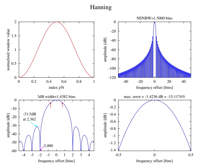

The purpose of a window is to avoid spectral leakage (and side lobes), a necessity when a whole number of (fundamental) periods doesn't exactly fit in a FFT record, i.e. when the 1ts sample of one record doesn't coincide with 1st sample of the next record. In that case the abrupt transition at the record boundaries will cause spectral leakage. A window will smooth out these unwanted transitions.

You guy are talking about two different things, all window functions have side lobes that can limit resolution (you can't get something for nothing). This is the best survey of windowing I have found (picture is from this reference). BTW Jan is talking about a method to lock the signal to exact bins needing no windowing, just another technique.
Spectrum and spectral density estimation by the Discrete Fourier
transform (DFT), including a comprehensive list of window
functions and some new flat-top windows.
G. Heinzel∗
, A. Rudiger ¨ and R. Schilling,
Max-Planck-Institut fur ¨ Gravitationsphysik
(Albert-Einstein-Institut)
Teilinstitut Hannover
February 15, 2002

Huh? Those Germans call it a Hanning window? Grrrr. A good reason to not read that stuff. 🙂
More seriously, no window at all (i.e. a rectangular window) gives also rise to leakage (depending on the continuity of the input). Applying windows is just a matter of distributing the leakage in another way over the spectrum. Some windows increase the resolution, while other windows increase the accuracy (of the magnitudes).

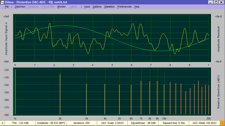

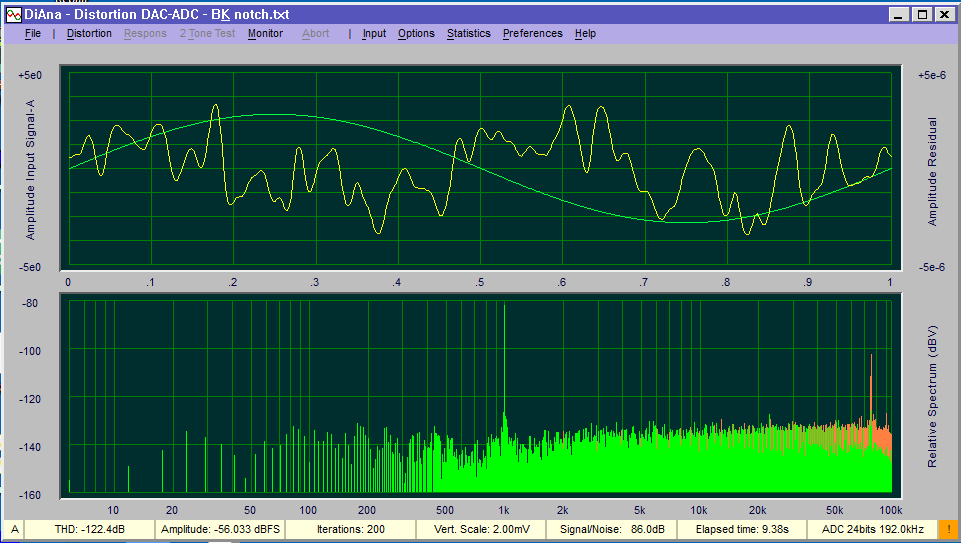

I think I'm making progress. I downloaded your latest version. Attached are two files with the notch in (in frequency mode). One is the distortion analysis and the other is the coherent spectrum. I think its saying that it measured the notch insertion as 80 dB? which could be right and a real PITA to tune manually. but that also shows all the harmonic stuff well below -140 which would be right but harmonic analysis suggest H2 is -126 which seems much higher than it should be at around -140 dB.
I don't know, but you might click on the lower left border to select one of three references options:
1. Absolute. Now you can readout the absolute magnitude of H1 in dBV and manually compute the notch attenuation.
2. Relative. Harmonics magnitudes are relative to the magnitude of H1.
3. Reference. Harmonics magnitudes and H1 are relative to amplitude of the reference signal. Now you can readout directly the notch attenuation at H1.
Didn't the option "Find notch frequency" work? If so, then it's real PITA!
Note that the notch filtered signal should be large enough, otherwise it will fail.
Sorry, I've no explanation for this discrepancy. Max. 1 dB is acceptable because these spectra are computed in two total different manners, but a difference of 14dB is way too large.
I've repeated your experiment (of course with my own notch filter) and an RTX. Then the discrepancy between the two 2nd harmonics was only 0.55dB.
What about the option "Apply notch compensation"? Does it work now?
NB: This option only applies to the THD spectrum (not the other two).

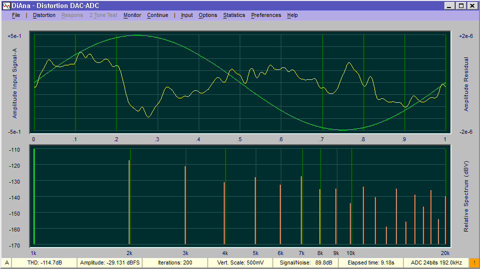

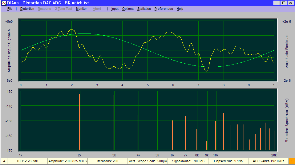

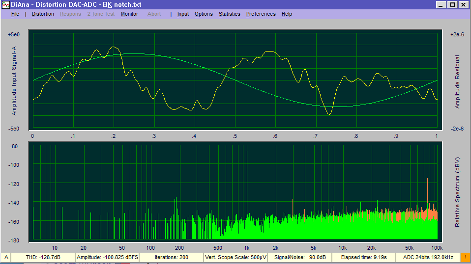

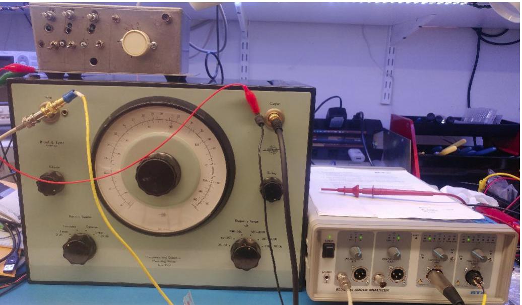

I'm guessing on how this should work and maybe some specifics would help.
This is RTX loopback. The generator is set to 2V, analyzer set to 31V going though the B&K tuned as closely to the 994 Hz the generator is set to (to match the victor I have). Ch B is reference and CH A is test. The picture may help explain the setup. The B&K is very touchy to tune.
When I switch from normal to notch compensation it does change the amplitude relationships. The pictures are with the compensation on.
Final picture is with the B&K in the "linear" or bypassed position to see what I get directly.
I believe the process for characterizing the notch is to select it in options then run a distortion test. Then engage compensation. I saved the compensation file and included it. When I measure the notch I get around 69.5 dB loss at 994 Hz and 10 dB at 1998 Hz and 6.95 dB at 2982 Hz. I think this matches the file reasonably well.
The remaining question has to do with the two plots and whether anything can be inferred about level from the coherent plot and how to do it.
If this is the right process I'll try on my Victor (the little box on top of the B&K) again. Maybe in parallel with the Shibasoku. And with a function generator with enough distortion that it should not be stressing the measurements in any way.
