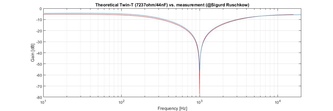

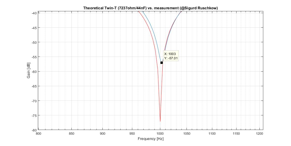

Here is a comparison of the Sigurd's measured response of the balanced Twin-T notch filter with a theoretical model of a single-ended filter.
The only correction made was lowering the gain of the simulation by 5.3dB to achieve agreement with the measurement in the range past the notch frequency because the filter in the simulation was not loaded.
The resistance and capacitance values used for the model are from the Victor's schematic.
The simulation was performed in Matlab.

I measured every cap (22nF 1% COG) and they were all within 0,5% which is the tol of the cap meter.
Resistors are 0,1% and I did not measure them.
Using Diana, I get a notch freq of 1002,8 Hz and a notch depth of -68dBFS.

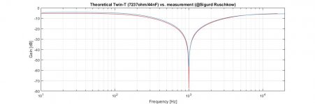

Well, the frequency difference is 0.2%, so you're well within the tolerance limits
As a possible Twin-T filter definition input, the model needs only three coefficients and the filter insertion loss in order to calculate the gain and phase values at any frequency.
In the case of a Hall topology filter, the number of coefficients would be six (it is a third order filter).
The insertion loss can be determined with LtSpice (I compared it with measurements, and it was good), or measured with REW or a similar software.
As already remarked, it would need complex number arithmetic in the software, but I don't think this is a problem.

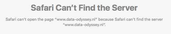

Hi Pio,thank you, seems the site is down
best regards
Pio
No, that site is not down. Maybe it is blocked by your browser.
