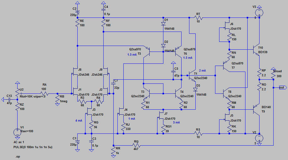

My take on discrete AD797 opamp😉
Onvinyl said:
Hi Nelson,
I'd like to see how you'd make an cfp input pair here. Whenever I tried it in Spice, it simmed worse than a FET alone.
Rüdiger
Me too! I haven't put much effort in it yet. I tried it once in a messy unity gain AD829 clone, but it oscillated. I'm going to give it a try again later on.
Adding CFP or cascoding the input doesn't alter the simulations to the better. Most often there's no change at all and somtimes it simulates worse, but those tweaks do alter the sound. In other amps, I've found the use of CFP with the combination JFET/bipolar to be an improvement.

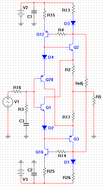

jcarr said:
Nelson: you may want to try moving the base of T1 from the gain node to the output (or a derivative). This will reduce loading on the gain node, and probably give lower distortion as a result. But whether you move the base of T1 or leave it where it is presently at, you probably want to add a bit of level-shifting to give T4 room to operate.
Personally, I would also try feeding C7 from the collector junction of T4/T5 (rather than from the output), and create a local nested feedback loop. IME, stability and RFI immunity frequently go up when you do this.
If you must use resistors RE and RF instead of active current sources, you may want to exchange D1/D2 for a precision voltage reference. The Vf of a normal diode is too easily affected by a variety of factors, and this may result in unwanted current fluctuation (which will degrade the overall performance of the circuit).
You can also improve the distortion of the output stage if you drop the two current sources and instead run a current mirror on either voltage rail, so that the input of the current mirror is fed from the collector of the output device and the output of the current mirror forms the active load for the junction of the drive transistor's emittor and the output transistor's base. To keep the current mirror going, add one of the active current sources that you removed back across the collector of T10 to the collector of T9.
No need for DC offset control?
regards and hth, jonathan carr

Referring to the post quoted i have a question:
speaking of the shunt transistor T1. Is it possible to run the circuit without it (i.e. by properly and precising setting the CCS)?
I was thinking that this would give then plenty of room to T4 that otherwise would only work with a Vce of about 0.65V
I found this 3d very interesting.
You mean something like the attached schematic? At light loads you may not see much difference in distortion, but the extra circuitry is a benefit with heavier loads.
Of course. However if you do this, distortion will go up due to T4's VCE fluctuations and forward Early voltage. Also if you do this, keeping the current source J7 & RG1 will make the amplifier more difficult to set up, since T4 will no longer be available to absorb deviations in the currents through RE+RF, J3, and J7. IJ3 + IJ7 need to equal IRE + IRF, and with operational temperature fluctuations that may prove difficult. Ergo, if you get rid of T1, also dumping J7 & RG1 will make life easier.
As I stated originally, if you instead add some level shift (voltage) to T1's emitter, you can give T4 more room while still retaining the AD797-ness of Nelson's circuit.
rgds, jonathan carr

1) level shift: you suggested to shif the level of either the base T1 or the emitter.
Which one would be the best accordingly to your experience?
IMHO setting the base voltage at lets say 1V should also help DC stability, is it correct?
2) for the folded cascode, instead of having 2 separates current sources for the LTP of the front end and for the folded cascode, would a nice evolution of a current mirror improve the overall stability and performence of it?
Nevertheless i remember you somewhere mentioning that, for folded cascode where the CCS are very critical, you prefere to use separate current sources cascoded with fixed voltage regulator, am I recalling wrong?

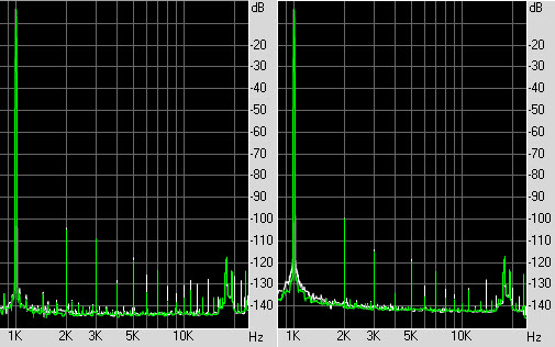

Yes, it's quite possible. I went from an AD829 clone to this AD797 clone in steps, and having the floating CM changed it towards better details and brightness, and by adding the shunt transistor the amp sounds smoother. I'm not sure the decompensation cap improved things, as it does with the monolithic AD797.
I've lend it to a fellow Head-Fi:er, but when I get it back I'll look in to some of Jonathan's suggestions. The guy I lend it to thinks the amp sounds dark and congested, but I find it very neutral. If I add it to the signal chain it's very hard to hear it's there at all, and like you can see it's "invisible" driving a 33R dummy load on the RMAA tests with a decent soundcard (E-mu 0404). Driving a 10R dummy load, it still looks OK.

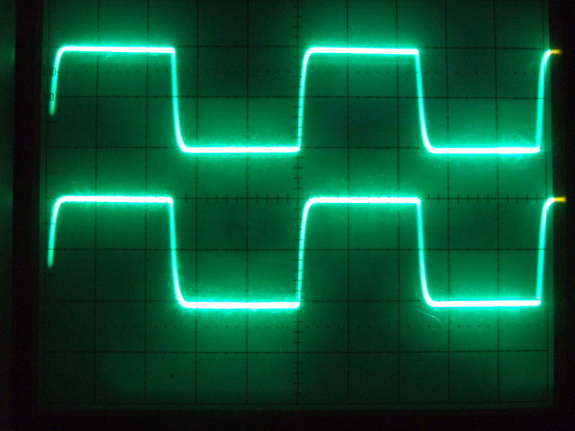

After a long wait I have finally tried a cascoded input stage with the "AD797" curcuit. I've also added some voltage drop to T1 like suggested before. With the added voltage drop there's no longer any problems using this amp at lower supply. I run it from 8 AAA batteries.
I'm not sure if I like the sound of the cascoded input stage better. I have to give it some time. It measures very well and looks good on the scope. The picture shows a 100 kHz square at 2 V (slightly over compensated). The RMAA measurements show to the left E-mu 1212M loopback and right this amp with a 330R load. The 2nd harmonic is slightly raised and the 3rd slightly lowered.
I still have the amp with the standard JFET input stage so I can easily compare them. I also have some other versions. I can say for sure that AD797-izing the standard JFET input amp improves the sound. The sound is cleaner and the spatial information is better. I don't think there are any drawbacks.
