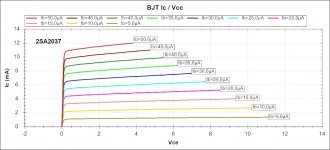

They are not output devices for 200-300W amps, but excellent for line level circuits and headphone amps: Sanyo 2SA2037/2SC5694
Very reliable USA Ebay seller, < US$ 5 for 20 pcs (10 pcs each).

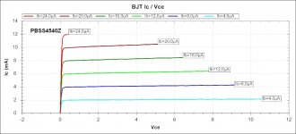

Joachim, PBSS4540Z/5540Z, I am using them in SMD power supply regulators. Decent performers, very robust & reliable.

Great -- some part numbers. I'll look for some and test them for noise and linearity.
I have a few weeks left.... anyone else favorite they are curious about?

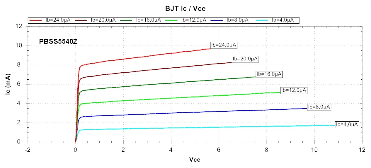

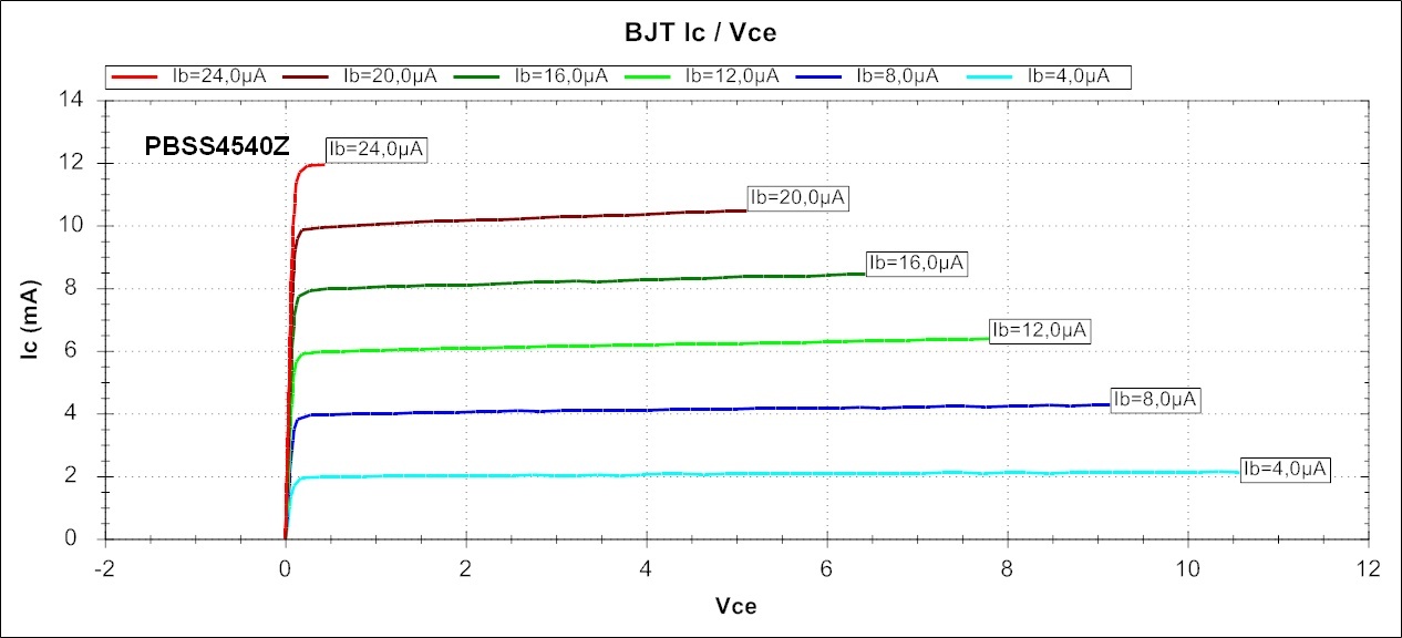

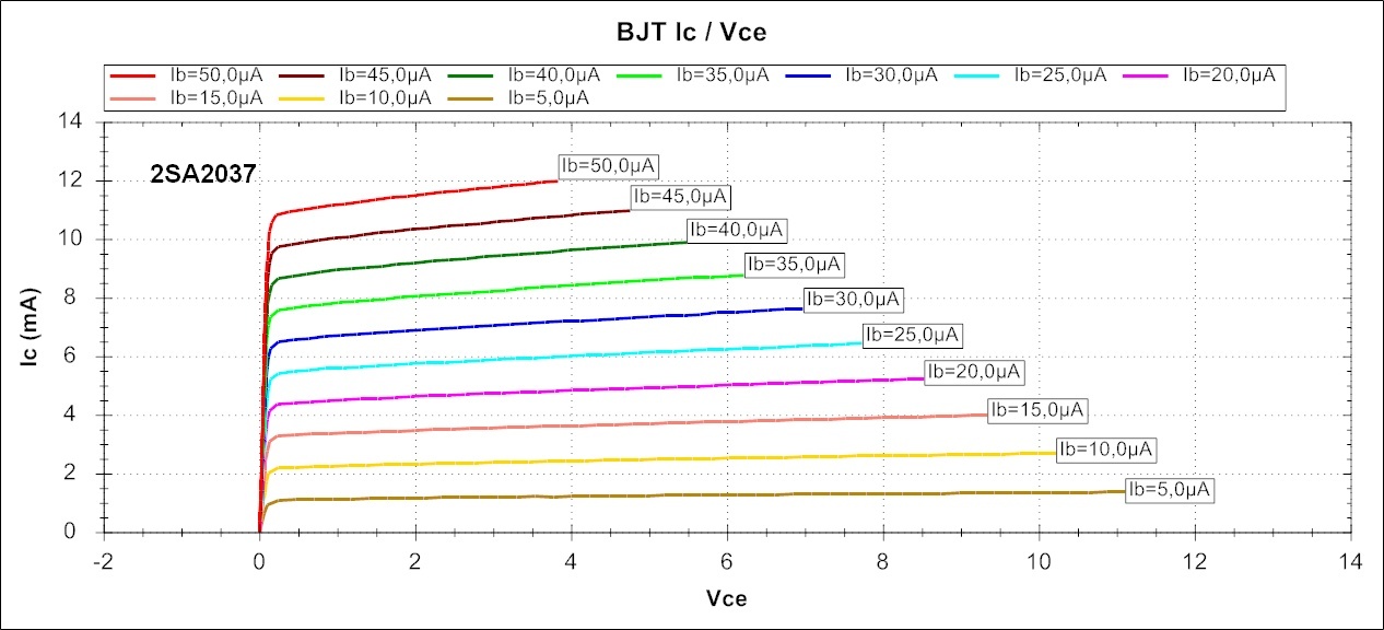

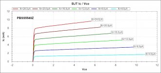

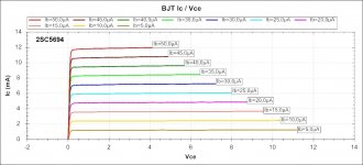

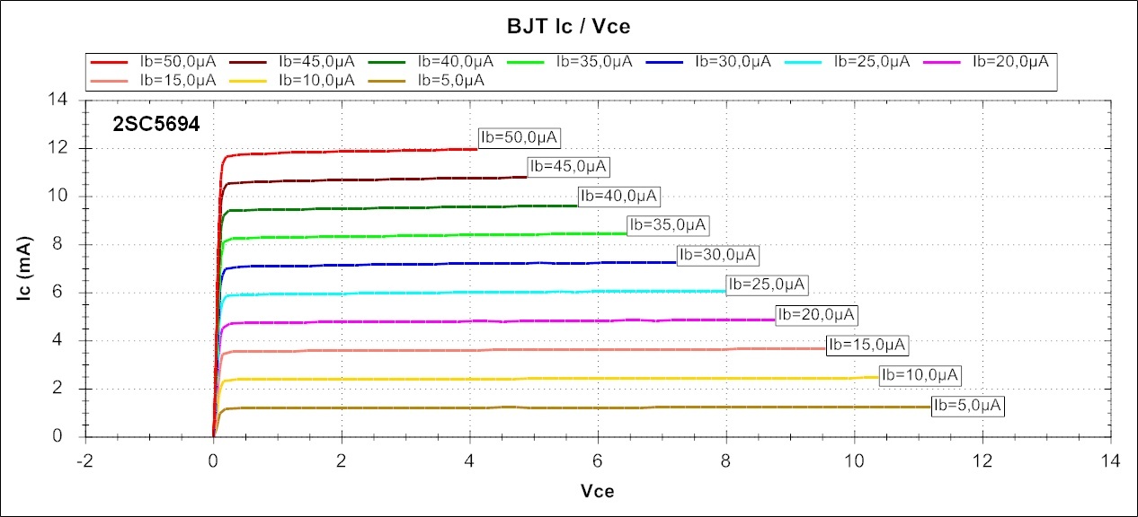

Yes, it was E A Faulkner was the guy who first published in 'Electronics Letters' in 1966 (I'm pretty sure). However, I did not get a patent from paralleling the devices, but the unusual topology that I used, that was push pull for distortion cancellation, but noise parallel for efficient low noise design.
Measured with Atlas DCAPro 75
Mr. Marsh, thank you again.
Still surprised by BC327/337 performance compared to low noise 2SA970.
@AndrewT
Yes, PBSS4540/5540 are NPN/PNP in SOT223 package. Early effect is more noticeable in PNP's. You should see some other transistor measurements, they are much worse. Ideal devices exists only in textbooks.
