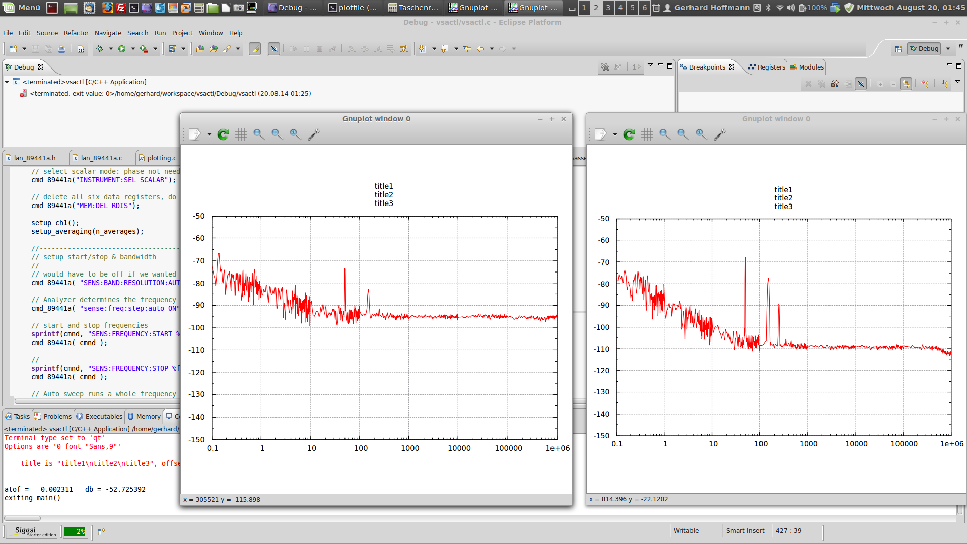

With the right devices, it is possible to get within 1dB of http://www.hoffmann-hochfrequenz.de/downloads/lono.pdf with very simple circuits for a 5R source.
What do you use Iono for?
Do you mean me? "Joachim Gerhard" and "Gerhard" are different entities 🙂
I got bitten by an oscillator having unexpected phase noise peaks quite far off
the carrier and that could be traced to an exotic radiation hardened voltage regulator
for space applications, and I wanted an easy setup to check that.
Last week, I persuaded an Agilent 89441A to do 1Hz, 10Hz, 100Hz...1MHz FFTs
and combined those spectra to a single plot from 0.1 Hz to 1 MHz.
I think I'm ready to get get noise results from batteries, references and regulators
in a few working days now.
This is lono from 0.1Hz to 1 MHz. 15 dB below 1 nV/sqrt Hz outside 1/f.
(left trace noise of 60 Ohms=1nV/sqrtHz, right side = input shorted=amp voltage noise only.)
The 89441A can do cross correlation. That could bring another 25 dB or so, but requires 2 such preamplifiers.
regards, Gerhard

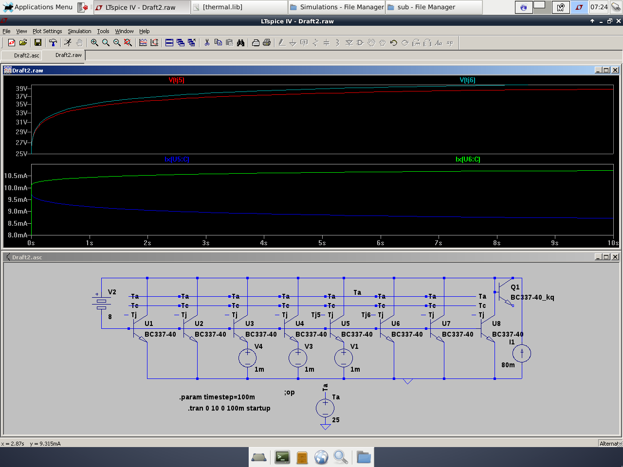

We usually use ballast resistors, like 10 ohms in series with each emitter. 5 ohms would probably work OK.
Depending on Ic and Pd, you might not need any at all. BC3x7 are linear down to very low voltages so if you make Vce small you may not even need the resistors.
I made a thermal simulation to get an idea. Based on this you only get thermal instability beyond 20% if you violate Ic*Pd<860u for the TO92 package where the transistors are thermally coupled.
But I see no need to operate the BC3x7 at more than 1Vce so I don't think we actually need any ballast resistors at all.
Top traces are junction temperature, bottom traces are Ic for transistors 5 and 6.

Depending on Ic and Pd, you might not need any [emitter ballast resistors] at all. BC3x7 are linear down to very low voltages so if you make Vce small you may not even need the resistors.
I think JC may use ballast resistors, not to prevent thermal runaway, but rather to provide negative feedback when the parallel devices have slightly different VBEon voltages. If (Rballast x Iemitter) >> delta_VBEon, the collector currents match very well.
D.Self refers to this as "series feedback" and suggests a rule-of-thumb for selecting Rballast.
