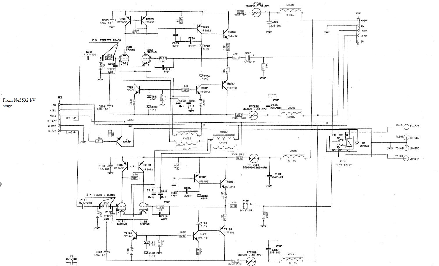

See if you guys can guess where this dac's output stage/buffer is from. With these transistor it could drive horns with a couple of mods.
Cheers George
Joined 2004
I guess adding a DC servo or offset trim was not stable enough. During warmup there will be a lot of DC shift with tubes. Anyone watching a Tek 547 warming up would be familiar with the problems. The NE5534 I/V converter is the real limitation. I presume its an older design.
Not sure where it's from, but I'm not crazy about the 10uF caps on the outputs of the buffers.
Probably Luxman.
It's the MF trivista dac,
Yes I think the caps can be eliminated by carefull adjustment of the dc offset, but it still had a small switch on bump.
I've shown how to do this on the same/ different model which has the same output stage, the MF A3-24 a few years back in another thread, with circuit diagram. But then this one has tube input so it may not be successful
Cheers George

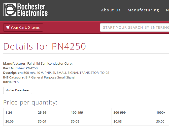

Mr. Marsh,
If you have a 2N4250 in you stock, please show noise results. The reason I ask is because years ago I was looking for that transistor and found it in the Central Semiconductor catalog. Central Semiconductor told me the 2N4250 part number was obsolete and to use 2N5087 instead. I'm interested in a comparison.
Now Richard, try the 2N2222 at 100uA and a 10K source. Then try a 2N5087, or 2N5089 and compare.
2N5087 is PNP, the original complement was the 2N5089 but the 2N5210 became a better choice. So those would be the righ ones to compare to a 2N2222
