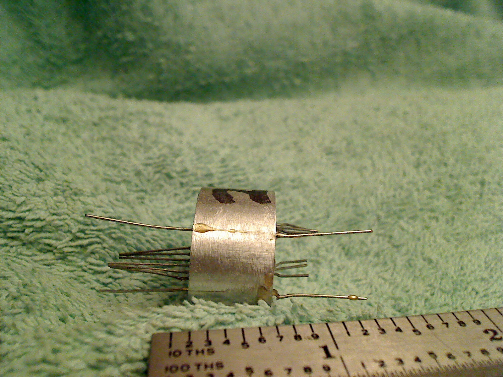

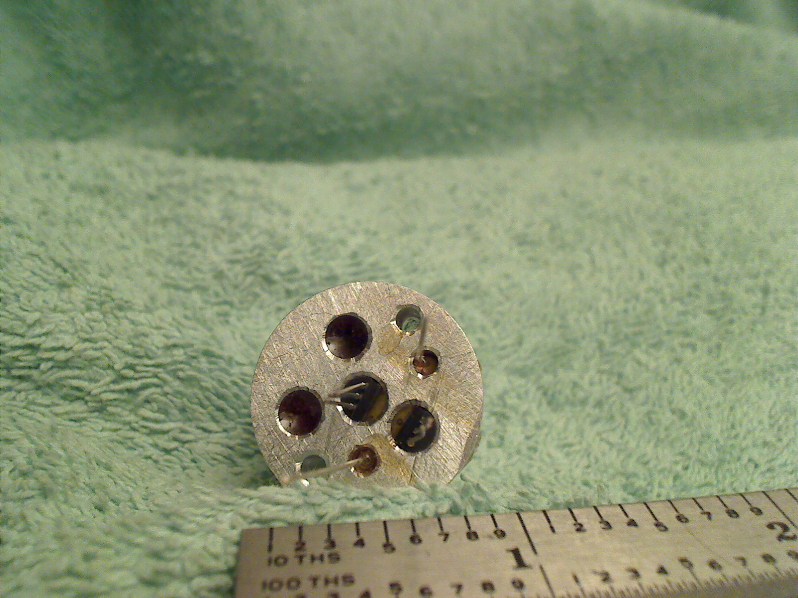

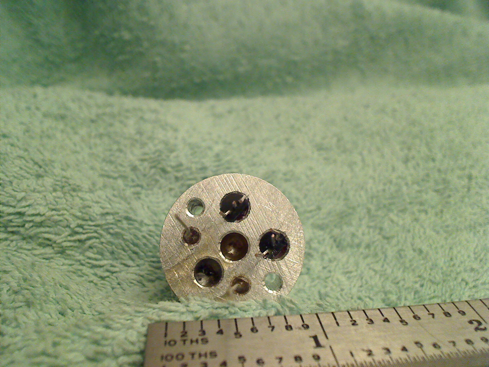

Attached are photos fore, aft, and side views of a subassembly done in the early phase of development of a computer-controlled attentuator for Harman International R&D, to implement predetermined level matching for the subjective evaluation lab with the speaker mover. That initial design was never completed as it got too expensive, and I've inherited some of the parts. The AES preprint paper about it only describes the scaled-down system, which got as far as initial circuit boards but was also never completed, again due to high costs.
The aluminum disc carries two matched 2SK170BL whose leads come out one side. As well there are two heater resistors, an LM35, and a 2N7000, the latter two with leads coming out the other side. The JFETs were characterized for threshold voltage and Idss, and about 500 of them were sorted in two stages, in a jig which brought each device to the operating temperature. The crazy thing was, I didn't know about the duals at that time, which were then readily available.
The idea was to stabilize the temperature to slightly above ambient, so as to allow d.c. coupling throughout the various buffers of an eight-channel system.

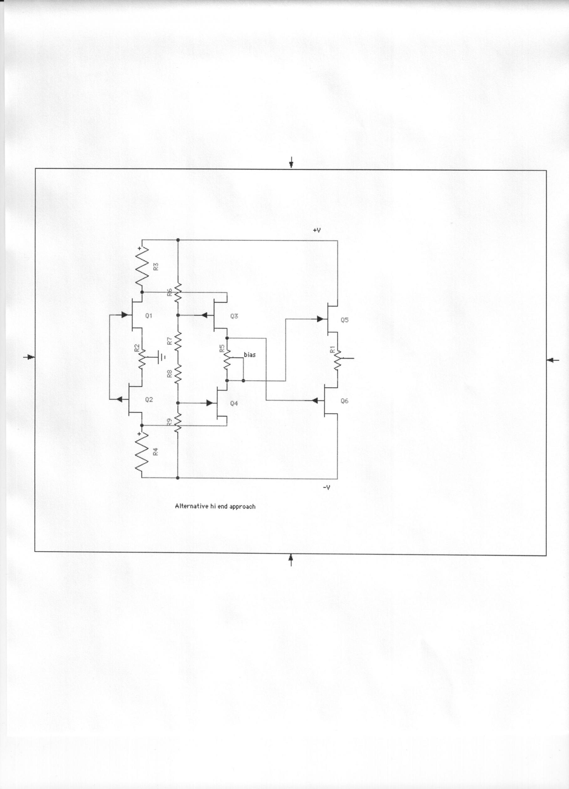

It is exactly what I proposed for JC's unstable FET drawing: to add diode sensors of temperature of output MOSFETs and control reference voltage for current source in the tail of an input differential pair. If you want "all FET" design you can use JFETs instead of diodes. And additional opamp in this "thermal servo" loop.
EUVL asked for a diff in diff out thing, I designed this one today using p and n jfets. (use your favourite jfets, BJT's and output buffer and you are up and running, pretty low THD+N)
I'll design another one using only BF862 in the ips.
