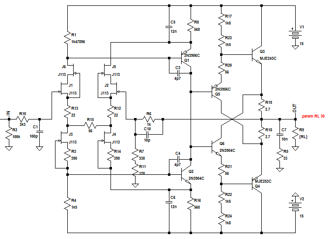

Following suggestions by Bonsai and JC, and inspiration by SW: 0.0008% THD @ 100 mW into 30 ohm, 1 kHz; loop gain ~ 53 dB up to 30 kHz, Zout < 20 mohm. 10 devices (ignoring fet ccs) - now I have only to find those damned J113s... :D
Ciao,
L.

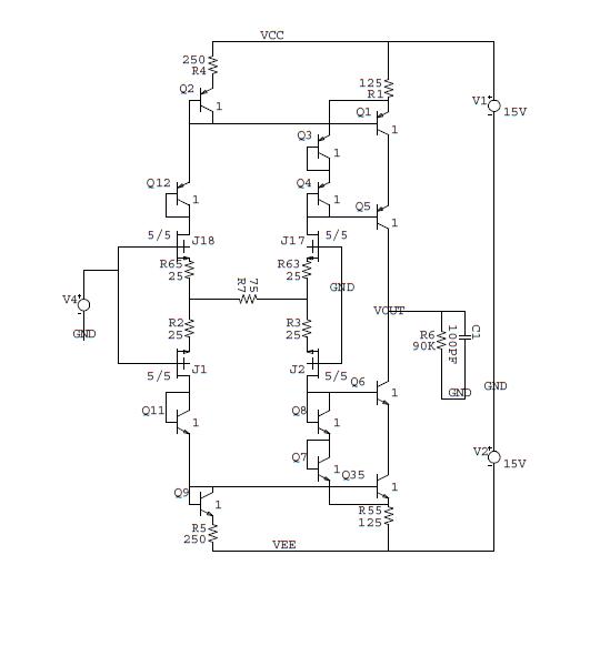

If for the moment we allow complimentary JFET’s there is complimentary symmetry on the circuit I posted. Here for those that are interested. Load the output with 90k and the open-loop BW is 20k while the OPEN-loop distortion is -70dB. I thought these things were good folk medicine for the sound. The triple-darlington is virtually no load to this and can be biased to drive a heavy load too. At 20k the base current re-capture lowers the open-loop distortion by 30dB.

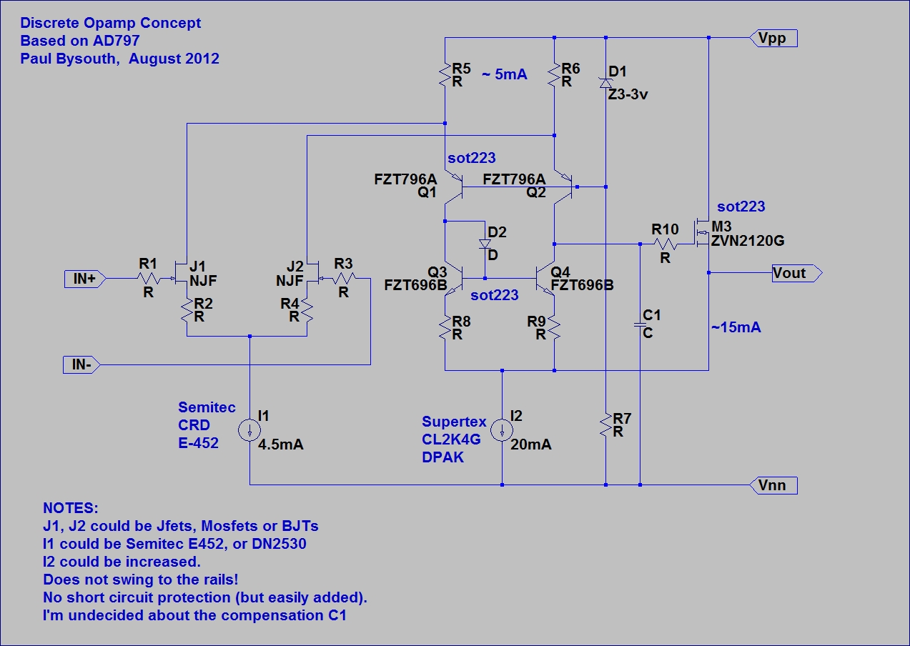

Here is yet another circuit for a discrete opamp. It has the front end of the AD797 opamp, but with a single ended Class A Mosfet output stage. This circuit can be varied considerably. The input devices can be Jfets, Mosfets or BJTs. The output could have a short circuit protection added if required. Offset correction could be added to vary the current through R5, R6.
It has been a year or so since I've modeled this circuit in detail, but it seems to work very well. THD is very low, and H2 dominant. Note that I haven't built one to actually test (and don't plan to). I've suggested suitable sot223 surface mount devices, but almost anything can be used. No unobtainable P channel Jfets are required! The compensation probably needs some work!
Paul Bysouth, August 2012
