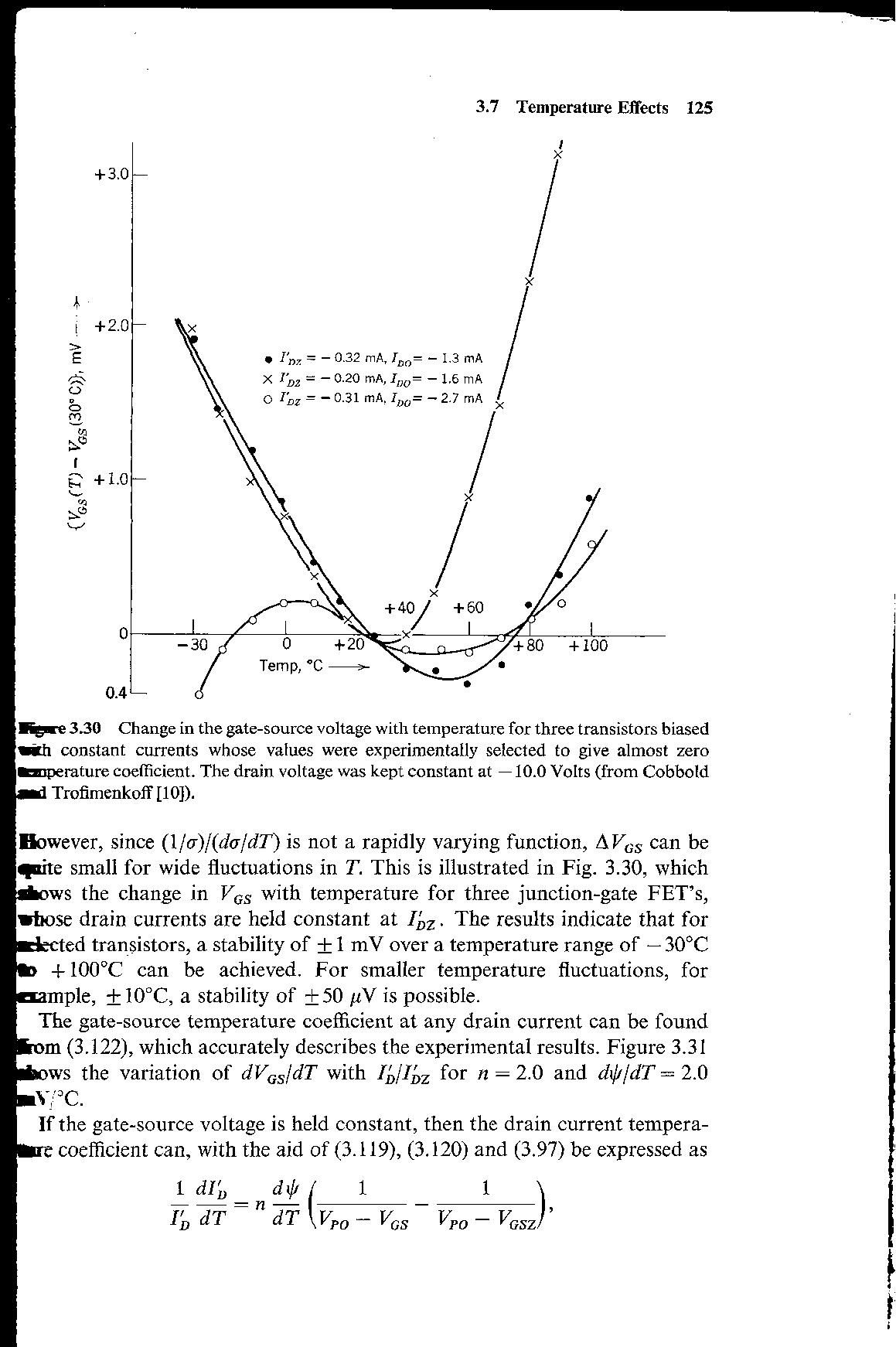

Another thing: there is a bias point for JFETs which allows almost zero drift in offset voltage. For long-channel devices it occurs about 626mV more turn-on voltage than the threshold voltage. For shorter-channel devices it shifts, and if the threshold voltage is low enough (like in our friends the BF862, 2SK170, 2SK389) it may even occur for a small forward bias on the gate, hence when biased at more than Idss.
Attached is a page from Richard S. C. Cobbold's book Theory and Applications of Field-Effect Transistors, showing three devices with drain current adjusted to give best results. One of them in particular is very good indeed, but the worst is only about 3mV shift over a wide temperature range.
If one is lucky enough to have a nice dual to begin with, it can further enhance the drift performance to operate both devices near this zero-tempco point.
When used for current generators, a similar enhancement of temperature stability can be had, and if the current be used as a reference in a regulator, some very-low-noise regulators/references result.
