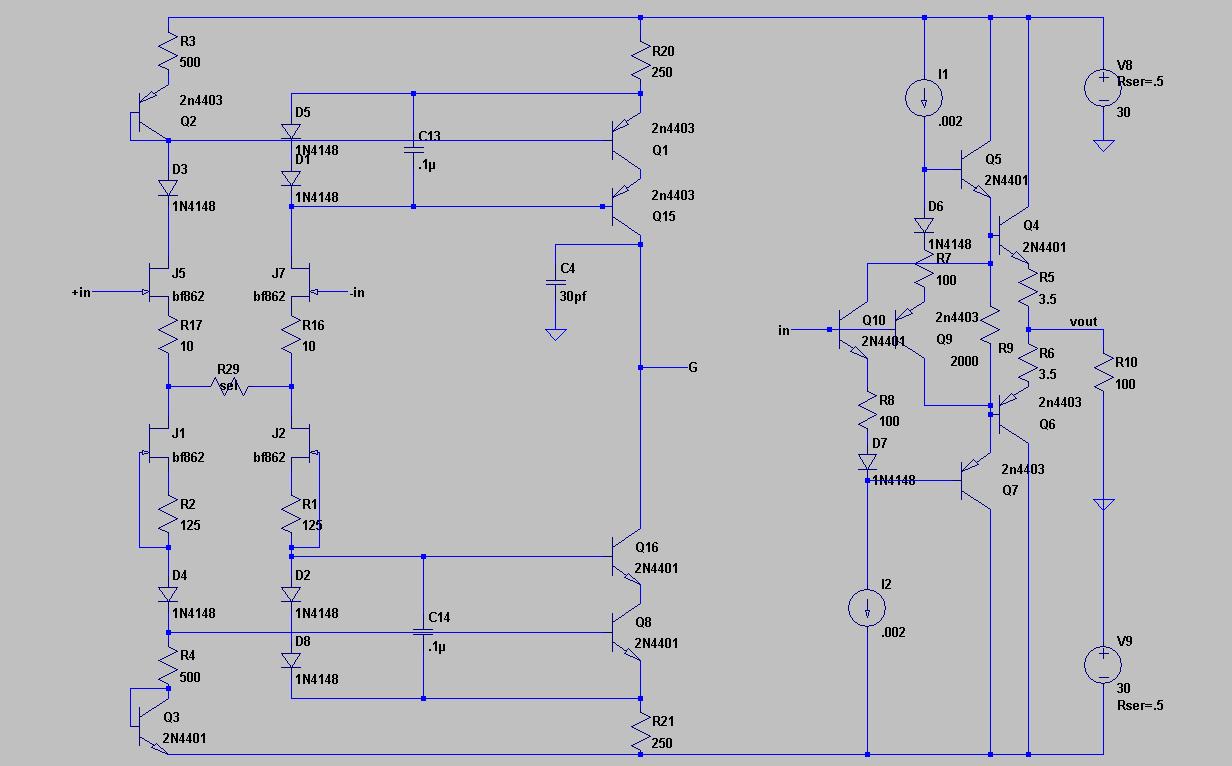

First off this is for fun and exchanging some ideas. I make no claim to inventing anything here it has all been somewhere before.
Classic op-amps input gm, Vas, and output buffer all end up relying on a linear input voltage to current stage (gm) feeding current to a high impedance node whose voltage is buffered to create a low output impedance. There are lots of embellishments around to increase the DC gain but the AC performance is usually limited by the linearity of the gm, the linearity of the gain node impedance (at AC frequencies the compensation capacitance plus any parasitics), and both the current needed to drive the output buffer and the voltage error across the output buffer. The last is problematic in that it (usually the crossover distortion) is differentiated before it can be expressed as an input current error, hence the rapid increase as frequency increases.
Before I go on I would like to say that a one size fits all op-amp is simply an unnecessary restriction. A simple enough signal path can give the user a couple of foolproof component substitutions that can optimize it for each application.
This being said I want to present a very ordinary signal path with a couple of additions to preserve simplicity and linearity. This circuit is not new but there are some differences to previous versions that I have seen (I don’t see everything posted). The signal path on the non-inverting side has been arranged more like a current mirror and on the other a folded cascade. The cascodes on the gain stage have their base current recaptured to keep the collector impedance very high and eliminate non-linear capacitive currents. The bootstrapped triple darling presents a very light load to the gain node and can be independently customized to easily drive low impedances. Though as I have previously stated there is no reason for every op-amp in your signal path to drive something like 50 Ohms.
The circuit here is just an outline and the devices are place holders but even with these fairly ordinary devices Aol is > 100k and more importantly the gain at 20K is 75dB. J1 and J2’s currents are set for bias and to set up the lower half of the input stage to also recapture the base current of the cascodes. Originally I had planned on a completely symmetric circuit with PFET’s. That is a fairly easy exercise for the reader.
I would like some suggestions for transistors, as far as I can tell I can get better than -100dB distortions at 20K, etc. with nothing more than this. As I said the degeneration resistors and comp cap would need to be changed for gain of one operation.

Not really. The opamp apps today needs to drive more than just other amp/hardware inputs. -RNM
I think this particular one (LEDs in current sources) is Walt Jung's creation:
http://waltjung.org/PDFs/WTnT_Op_Amp_Audio_2.pdf
Yes, this is the usual method of bringing the opposing collectors of the input to the rail... Was Walt Jung first or?? But, the variation of bringing them to the output stage, between the emitter resistor and the output device is an improvement. Incremental. But incremental counts?
how is it different from IC?
can you tell us in which ways this is different from an IC packaged circuit? What parameters can be bettered with discrete (besides output current)? Thx RNM
Not really. They don't need to be opamps, no matter what they drive.
I have to admit, I like Scott's exercise. Quite elegant.
He says right in the article that a version of it was first used in the LH0002 buffer, which I assume was a chip.
