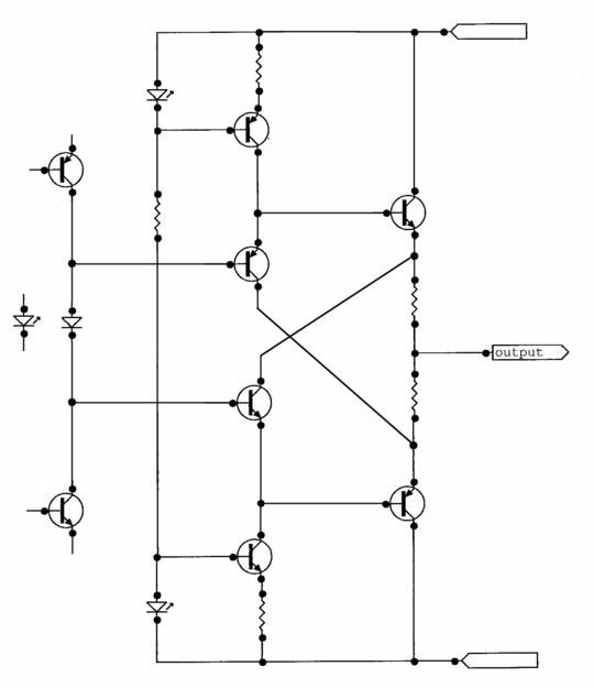

Yes, this is the usual method of bringing the opposing collectors of the input to the rail... Was Walt Jung first or?? But, the variation of bringing them to the output stage, between the emitter resistor and the output device is an improvement. Incremental. But incremental counts?
I believe HP used the diamond buffer pretty early on, according to Rich May, who then did some discrete buffers for a crossover he did at Harman for Greg Timbers. But who knows --- as Scott pointed out in connection with Jensen's input inductor(s), these things often are proprietary within a company for a while, and thus the USPTO doesn't necessarily know about them when they review claims.
Rich also bootstrapped the collectors of the input devices for his circuit, but did so with big caps and resistors to the rail, rather than running them from the output device emitters. This has advantages (smaller Ccb to begin with), but requires some bulky caps.
Both bootstrapping approaches help reduce the effects of the voltage-variable collector-base capacitances, as well as Early effects on beta and Vbe. The capacitance variation is a distortion mechanism that is proportional to the source impedance and the frequency. Another advantage is reduction in dissipation shifts with voltage.

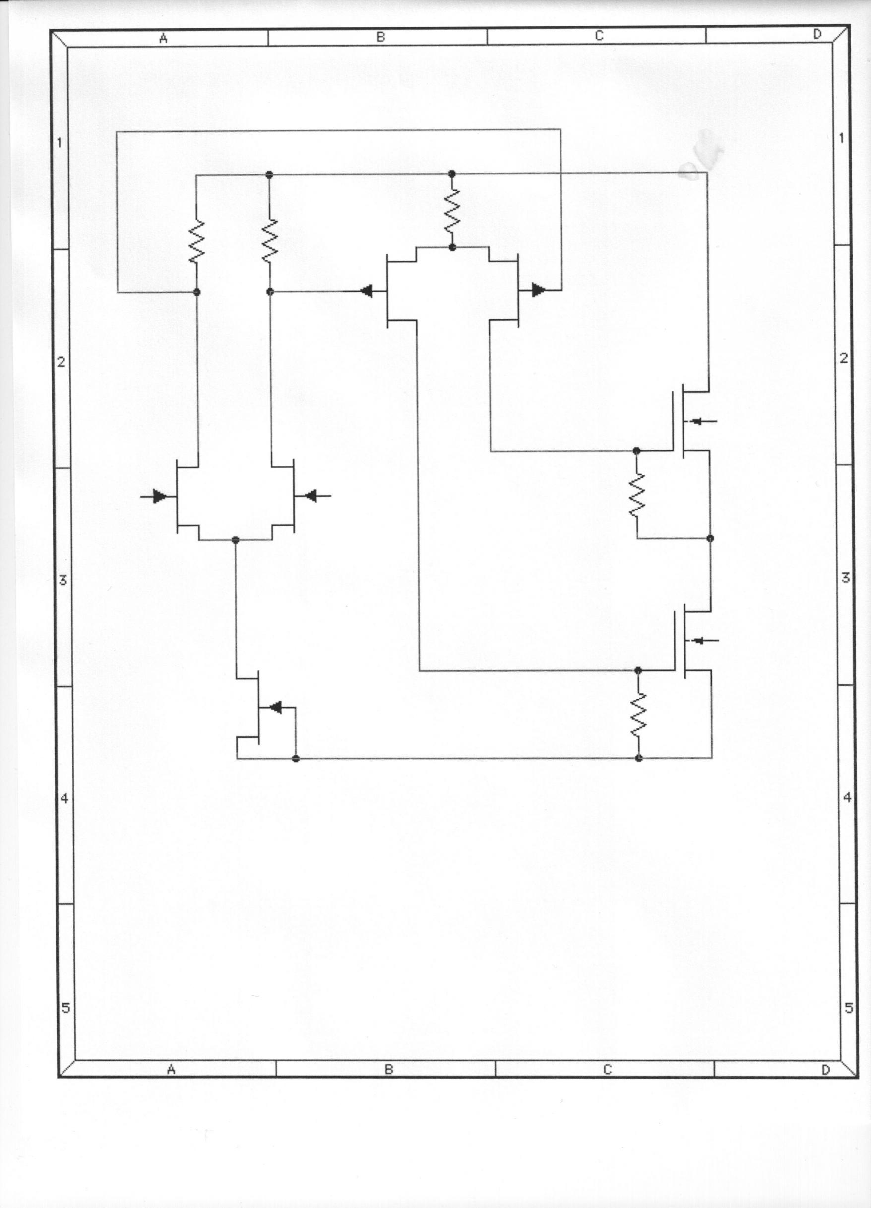

Let me offer an example of a simple, elegant, balanced circuit that can be made into the highest quality amplifier, preamplifier, or whatever, with a minimum number of parts.
This is NOT my circuit, and it is at least 40 years old, but Constellation makes world class amps with it, today. I give the credit to Bascom King, but it might go back earlier, I don't know.

I thought P Channel JFET's were out for this exercise. I can also see why you worry about clean supplies.

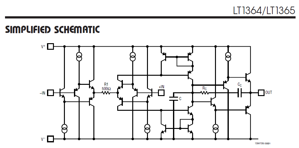

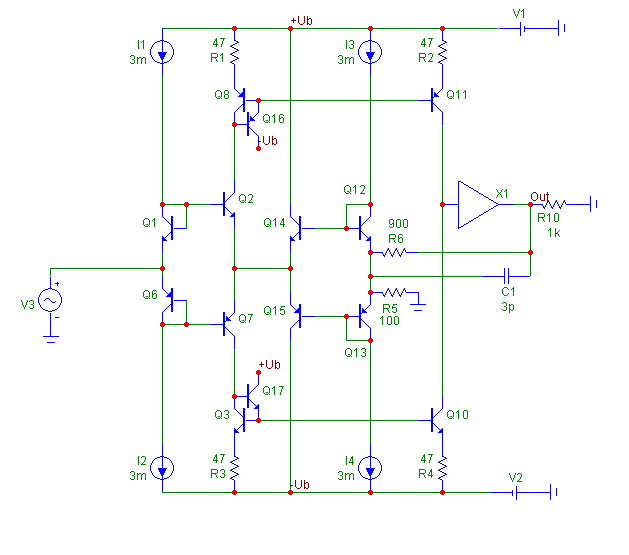

One more.

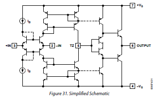

Like it. Kinda mix between +input stage of AD844 and diff amp of LT1364
No Wilson mirror though.
PMA's circuit looks like two CFA inputs looking at eachother, it lends itself very well to full differential connection.
For that matter that simplified 844 made with discrete duals could be tuned up nicely for several applications. I think there are cheap SMT dual's in the BXXXX series. That's 8 SOT6's and an output pair and you have access to all nodes so you play with Charles Hansen's ideas.
