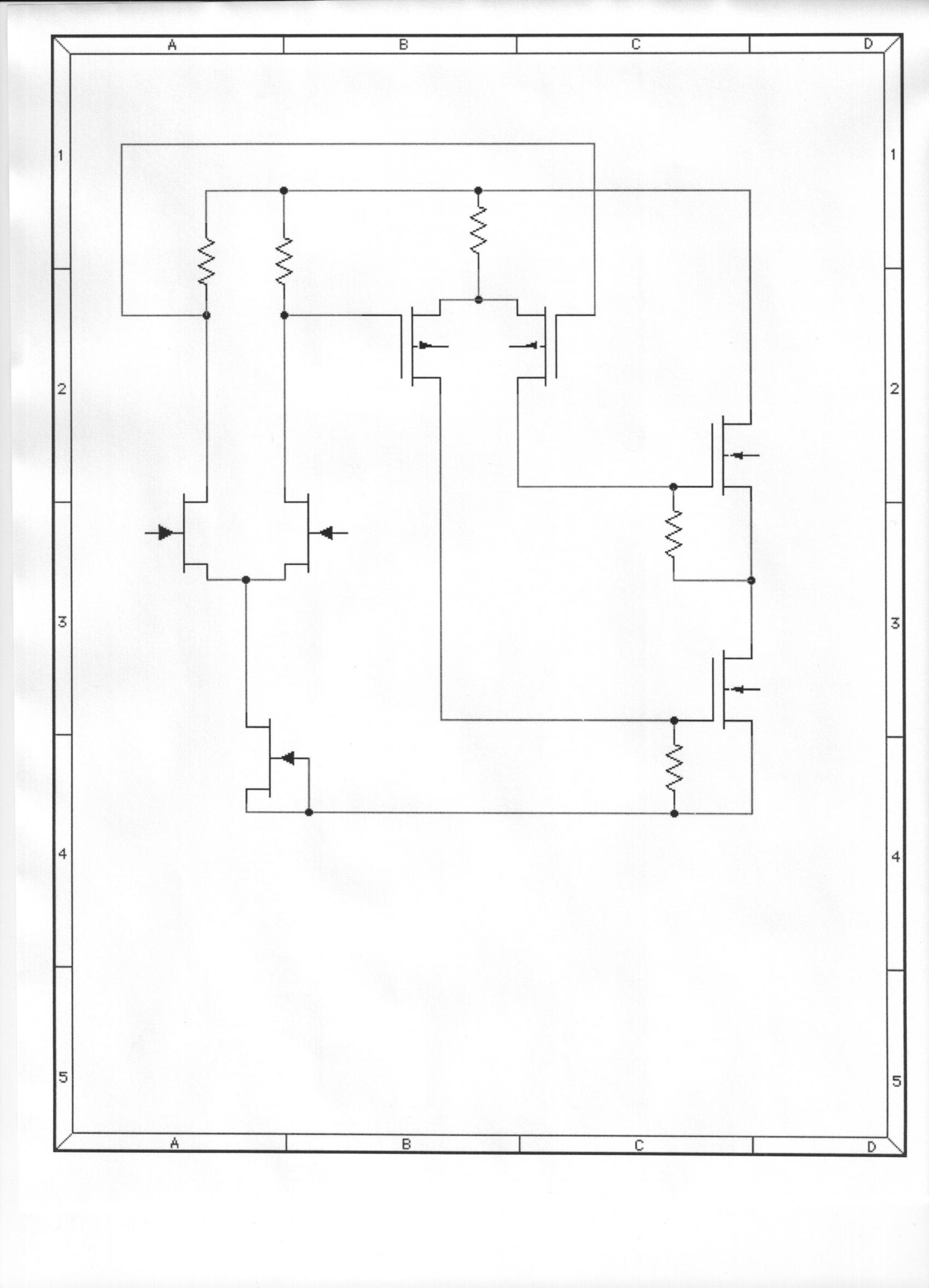

PMA's circuit looks like two CFA inputs looking at eachother, it lends itself very well to full differential connection.
Yes, but its a pity that with BJT you need lots of biasing stuff: I1, 2, 3, 4 and Q1, 6, 12, 13, wich you would not if P and N Channel JFET's were allowed.....

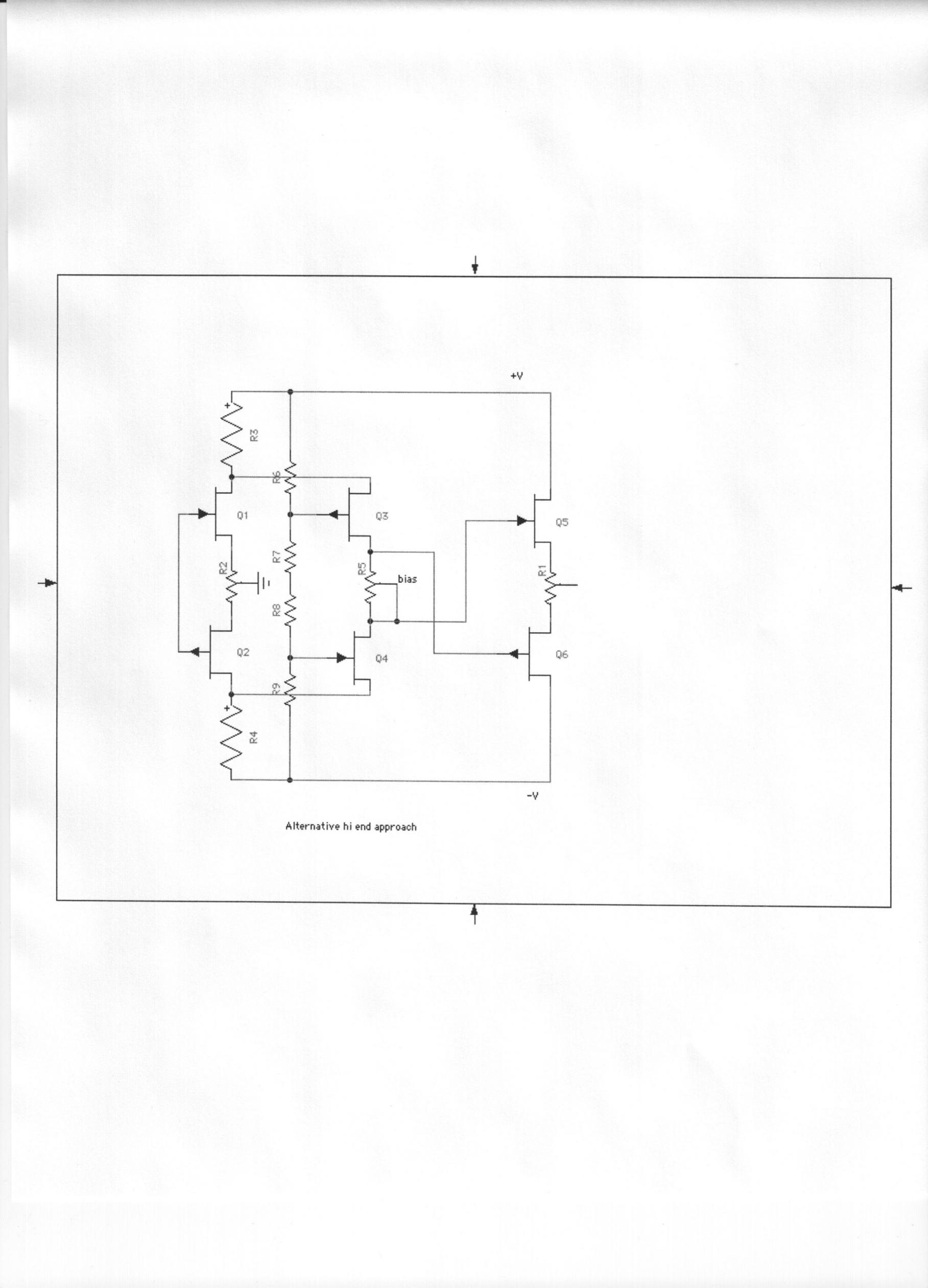

the second stage is loaded on very different resistances: one to ground, another bootstrapped. One output device works with common source, another with common drain. As the result, highly modulated current through output devices and awful distortions, starting from the 2'nd order. Extremely poor thermal stability, both of output voltage and idle current.
