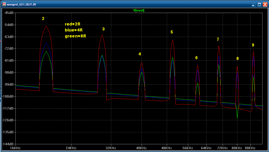

My second point in the last post is best illustrated below in the attachment.
The AX , while I will build it and it is proven .. a VERY good amp , will not do anywhere as well into a 2R load , standard single pair OP -EF2. It is will degrade substantially at the H7 and 9.

No doubt, but any amp will experiment a high increase in THD
with a 2R load...
You can increase the bias to reduce the switching distorsion
with those low value loads.
8R was the load value because almost all hifi speakers
are rated at this impedance.
Sure that there s some impedance dips, but they are
restricted to a narrow bandwith, and as, won t influence
significantly the real power output...

For a truly fair test of a voltage stage , one would drive multiple pairs with a triple OP stage, assuring the least possible load on the Voltage amp. Considering the added stability issues and complexity of the triple ,most DIY'er 'shy" away from it and go the EF2 route. I am in that camp and want to give my EF2 the best voltage stage.
As far as a 2R load , some 4R bass drivers will demand this at certain frequencies. Not always , but occasionally.
OS

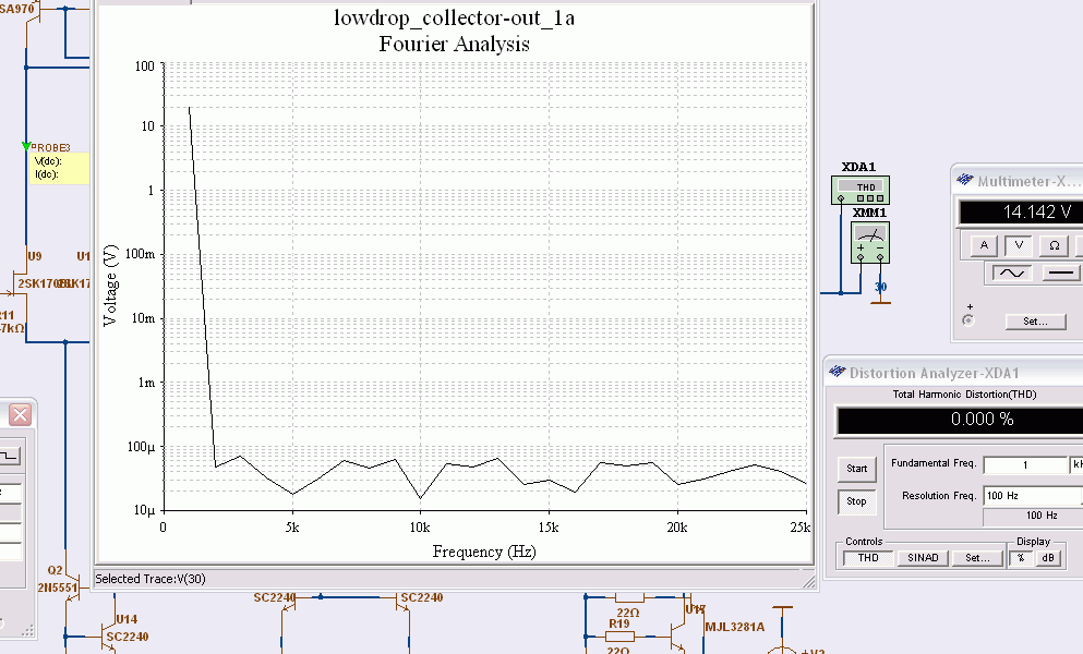

M. Leach amplifiers are really good.
By a guy that knows what he is doing (A Professor should know)
He has taken care of most things that can effect outcome.
About your sims.
What is the highest harmonics. Looks like 240kHz or more ....
In my MultiSim SPICE I can not do exactly those curves.
But I can do Fourier with any number of harmonics, usually 9
and use any fundamental frequency, usually 1 kHz
and present result in different ways.
I usually use bar graphs + decibel.
The closest to your way would to use Logaritmic scale without normalize graphs.
I really think you should NORMALIZE. Maybe there is some benefit not do?
Here is a test, which shows reesult for a +/-24 Volt Lowdrop Poweramp with JFET input.
Puts out 23.84 Vp into 8 Ohm .... 23.68 Vp into 4 Ohm
The output in diagram is at 20.0 Vp at 1 kHz and 8 Ohm.
Same as you have used.
This is quite high for a Powersupply +/-24 Volt
About your sims.
The maximum frequency is way higher than 240KHZ, i just
did make a zoom of the relevant part, as it s useless to
go to femto volts values.
Using a logarithmic scale allow to magnify the low order
harmonics which are proeminent unless the amp is unstable..
Extending the bandwith of fourier analysis require to
reduce the step of analysis, i.e, the resolution.
In your picture, it seems that it s 100HZ, that is 10mS.
I used 50nS (20MHZ) step for 10KHZ THD and 2uS (500KHZ)
for 1KHZ THD analysis..
Also, a significant number of sine cycles must be used to compute
accurately those numbers.
I used 20 cycles for 20KHZ and 10 for 1KHZ THD, as that seems
enough for my simulator, i.e Simetrix..
