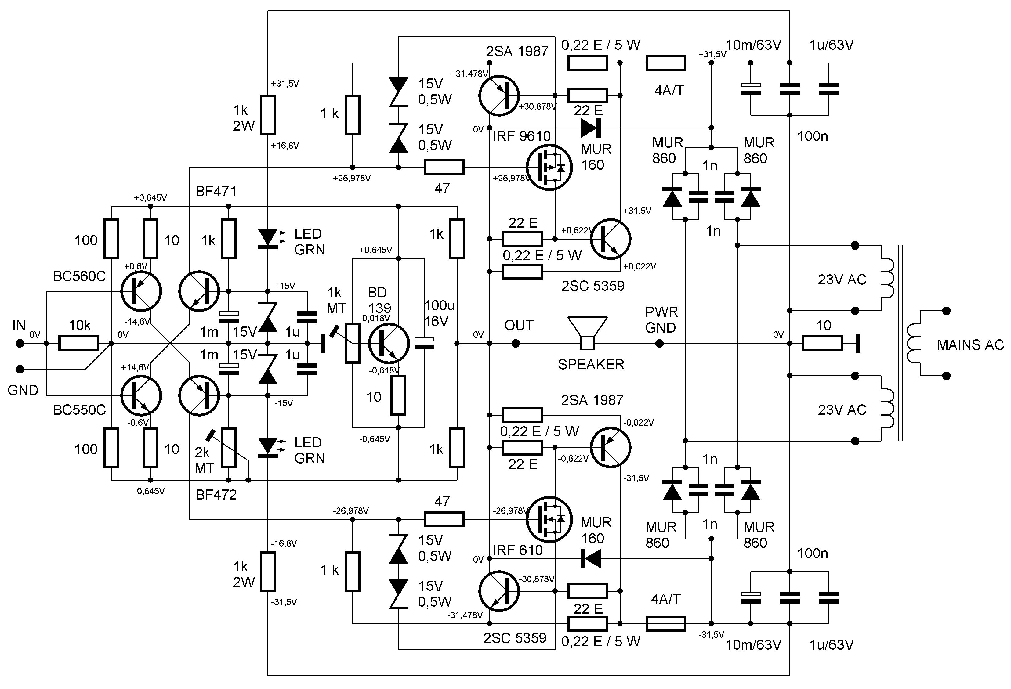

By losing 10dB NFB will it do well still? How many Volt on 8R it can do now? 10 or 18? I see some specs in the pdf but I don't know German. Yes, if it can do over 50W with first 10W class A decently and being DC, why not, send. I have a friend with 20W tubes that needs double and more for his 88dB speakers but will cost much weight and expense to go 60W. Maybe he can try something logical SS and decide.
Losing 10db of GNFB doesn t hurt the perfs, but 10W in classA from
a 20W amp is not the same as 10W classA from a 50W amp..
Since the iddle current must be the same, the latter one will
have way more thermal dissipation, ruining the whole idea
of economical class A...
Anyway, here two versions which can deliver about 45W/8R..
You will notice that going output DC coupled increase complexity
by a wide margin..
And the schematic doesn t include the mandatory DC output protection.
Myself, i use a symetrical differential that is relatively high
THD but display a Tube like harmonic content.
I will make a thread about this one in some times..

Hi , Padamiecki
Both schematics have issues.
The Symef is not stable and should be re designed i think ,
while this version of Lazycat s amp is marginally stable only ,
with quiescent current highly variable with temperature.
Also THD is relatively high.
I will post later some pics after further sims..
