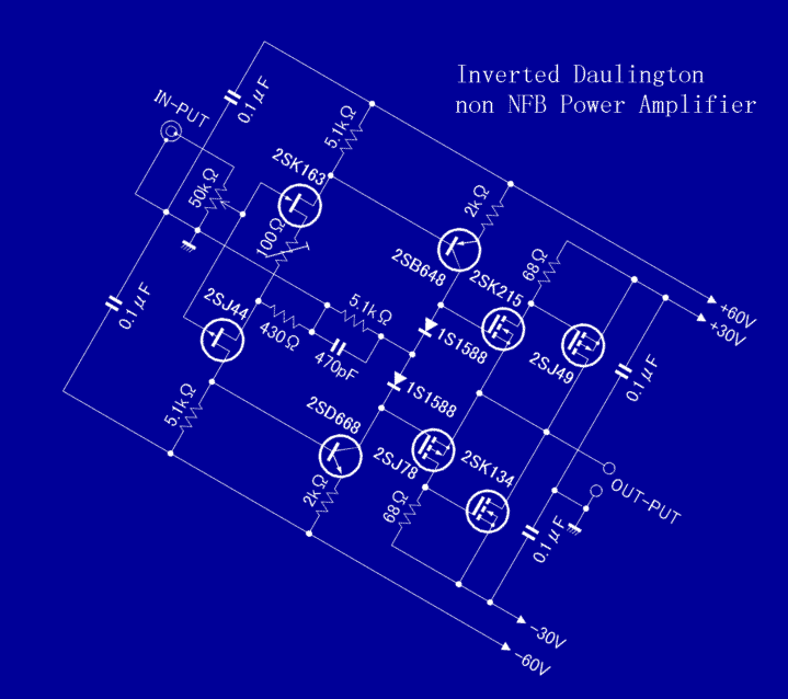

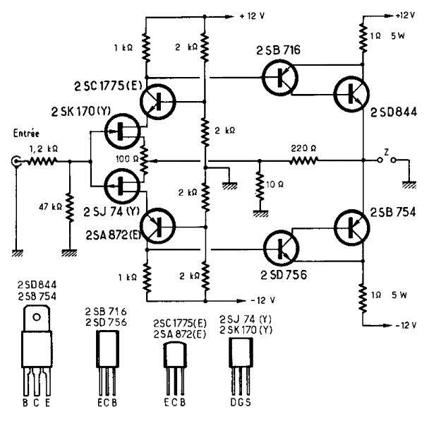

Wahab, would you simulate a couple of F5 like circuits? One is a popular classic and another is an unknown next of kin. So we can see the distortion profiles in comparison to JLH and F5. I hope you have time and some same or alike models at a point.

Hi, Salas
The one on the right is Hiraga s Monster..
Its sims can be found here :
http://www.diyaudio.com/forums/soli...-popular-amps-simulations-15.html#post2311257
The other one has GNFB restricted to the two first stages,
the output stage being open loop, although with a local NFB loop..
This kind of arrangement produce high Thd ratio, moreover
with lateral fets.
To add insult to injury, the complementary OPS will inevitably
cancel even order harmonics and let the odd ones as dominant,
particularly H3.
Unfortunately , i have not the models for the mos drivers..
I will check if i ve got some equivalents.

Hi, Edmond
Well, i ve got about 300ppb with unloaded non ideal OPS at 20V pk
using TMC and 150ppb with TPC in the same conditions..
Since i have not ideal transistors models, i proceeded this way.
Also, i retained TMC since its impulse response please me more....
cheers,
Next is an old CFB design with excellent results for who
is in search of Hiraga/Pass/JLH thd contents , but with
better perfs..
Original can be found in Motorola AN483 or in a german
publication, i don t know who is the first publisher..
I adapted a mosfet OPS that give better results than
the original EF2.
Quiescent current is 0.65A wich is low compared
to most classA designs.
You can adapt this one, increase PS to about 50V
and add a second pair of mosfets.
Iq can be kept the same, with 350ma/pair..
Of course, gain can be increased, as it s currently 20db;
Also, the bias voltage divider must be slightly readjusted.
I can send you an output DC coupled version using a
DC servo if you are interested.
