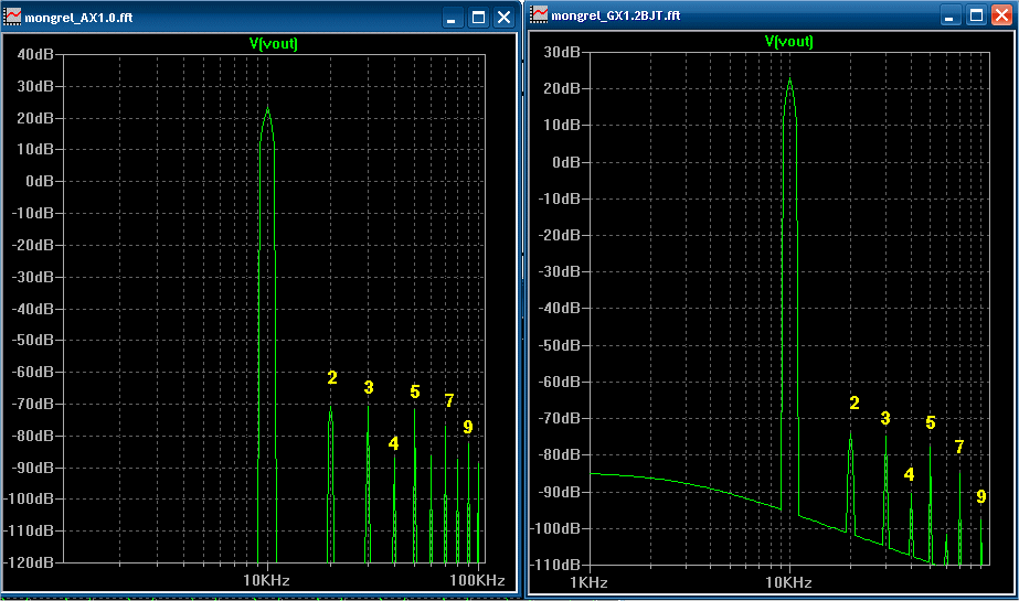

Looks like the AX is truly "blameless" !
You have to do the GX (below) I have it beating the AX where it counts (high order components). I see the symasym beats the AX in 7/9th... those are baddies
If you need current GX1.2 its in its .asc/ schema (It is both below and on my WS).

Hi , Ostripper
Hmm..That s right on the THD front, i still didn t simulate
some other equally important parameters.
Thank you for the definitive schematic of your mongrel/gx ,
i will test it soon with a(nother) die hard variation of the blameless..

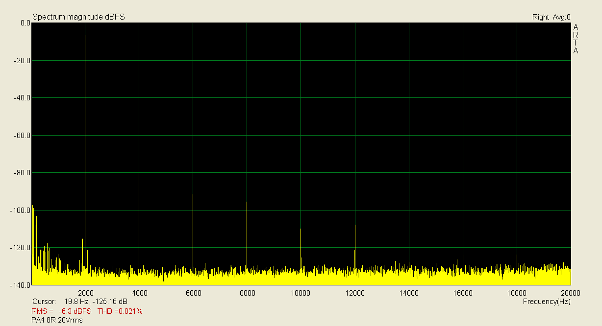

I would like to contribute with a real-life measurement, as I have many times found that simulations did not fit. This is a symmetric design. Loopback measurement (thus some 50Hz multiples).
