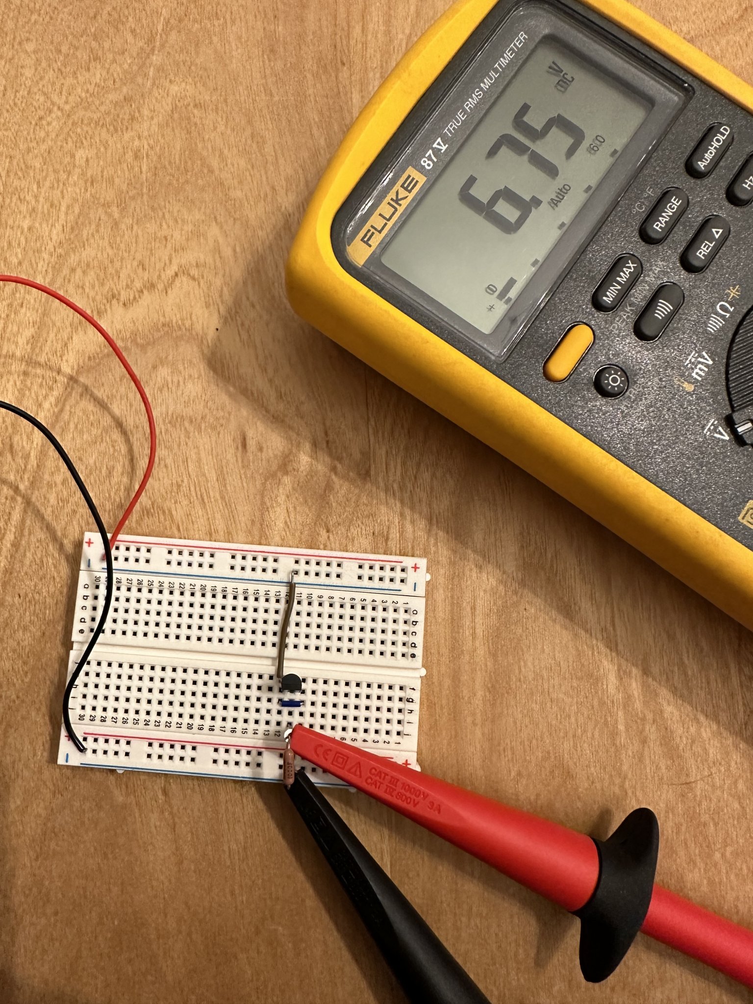

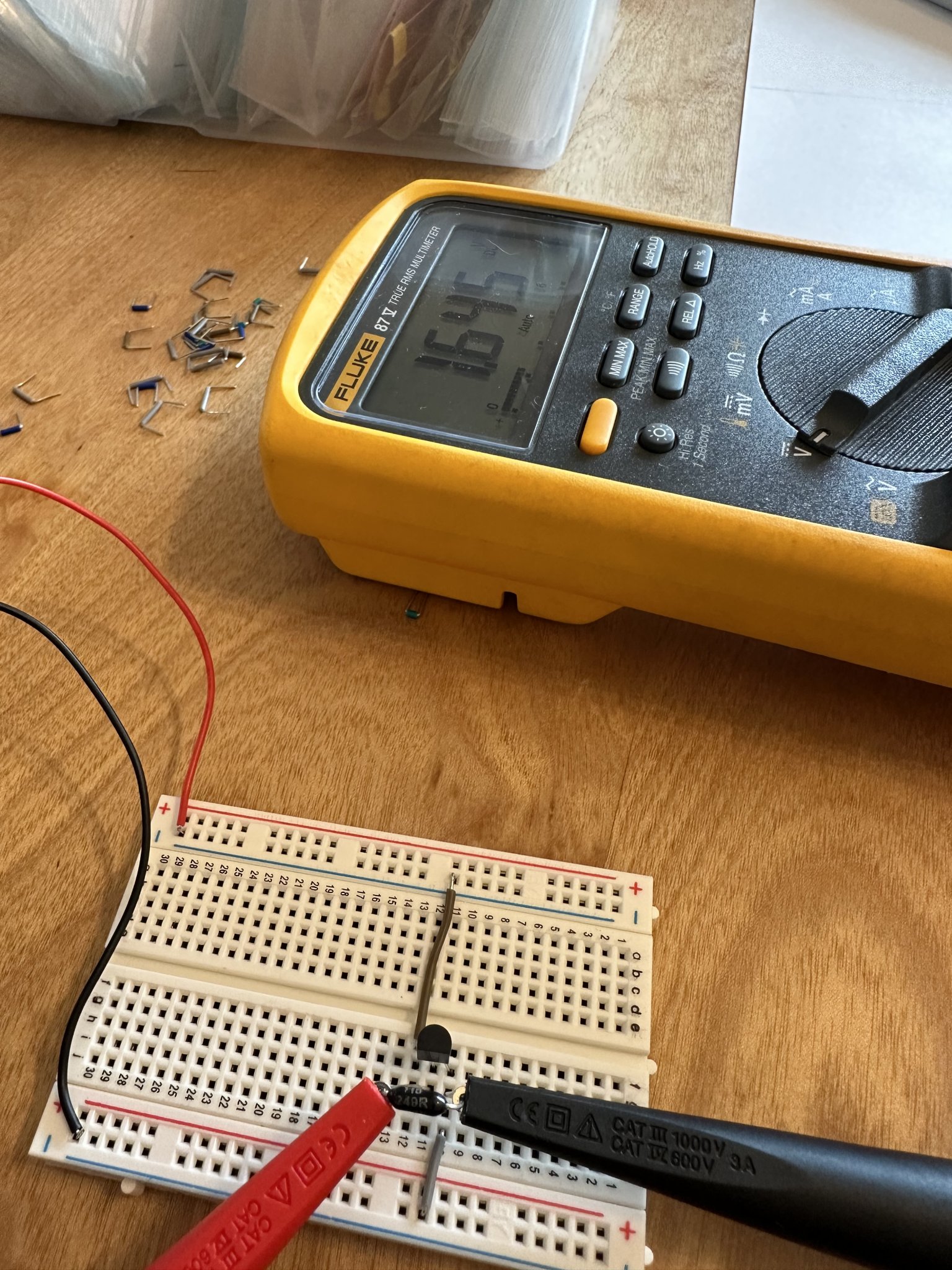

@ Dennis, I have a feeling I’m not connecting this correctly but wanted to share.
1. +V Drain
2. Connect Drain and Source w/ jumper
3. Connect 1 end of 100R to source and the other end of resistor to ground.
4. Result = 6.75vdc
Is this connected correctly?

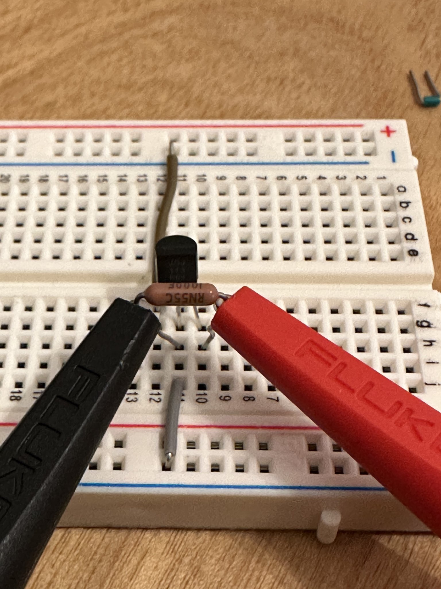

1. +V Drain
4. Result = 6.75vdc

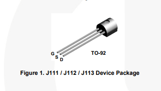

This is not correct. First of all, your jumper is actually connecting the gate to drain. I have attached the pinout for j113.
There is no jumper in the setup so you need to remove it. The resistor goes between the gate and source pins so in your photo #2, the two ends of the resistor should be on Row #10 and #11. The source pin is on Row #11 and that has to be connected to ground.
I suggest you take out the resistor and measure its resistance since it ran at almost half a watt (6.75V across 100 ohms) . The RN55C is likely fine but I still recommed first giving it a quick check. The jfet had about 0.2W but it should be ok since it's rated at 0.6W.

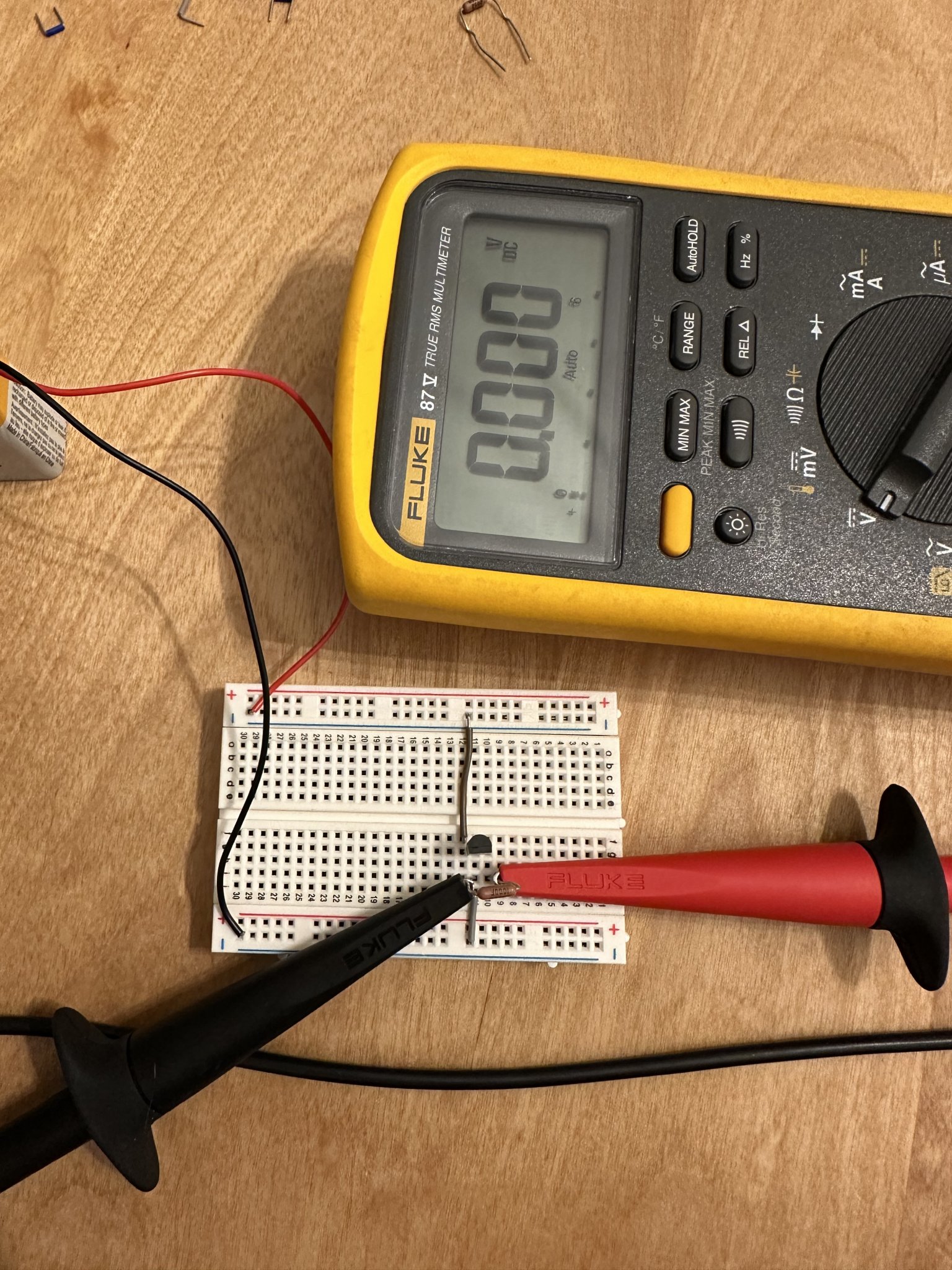

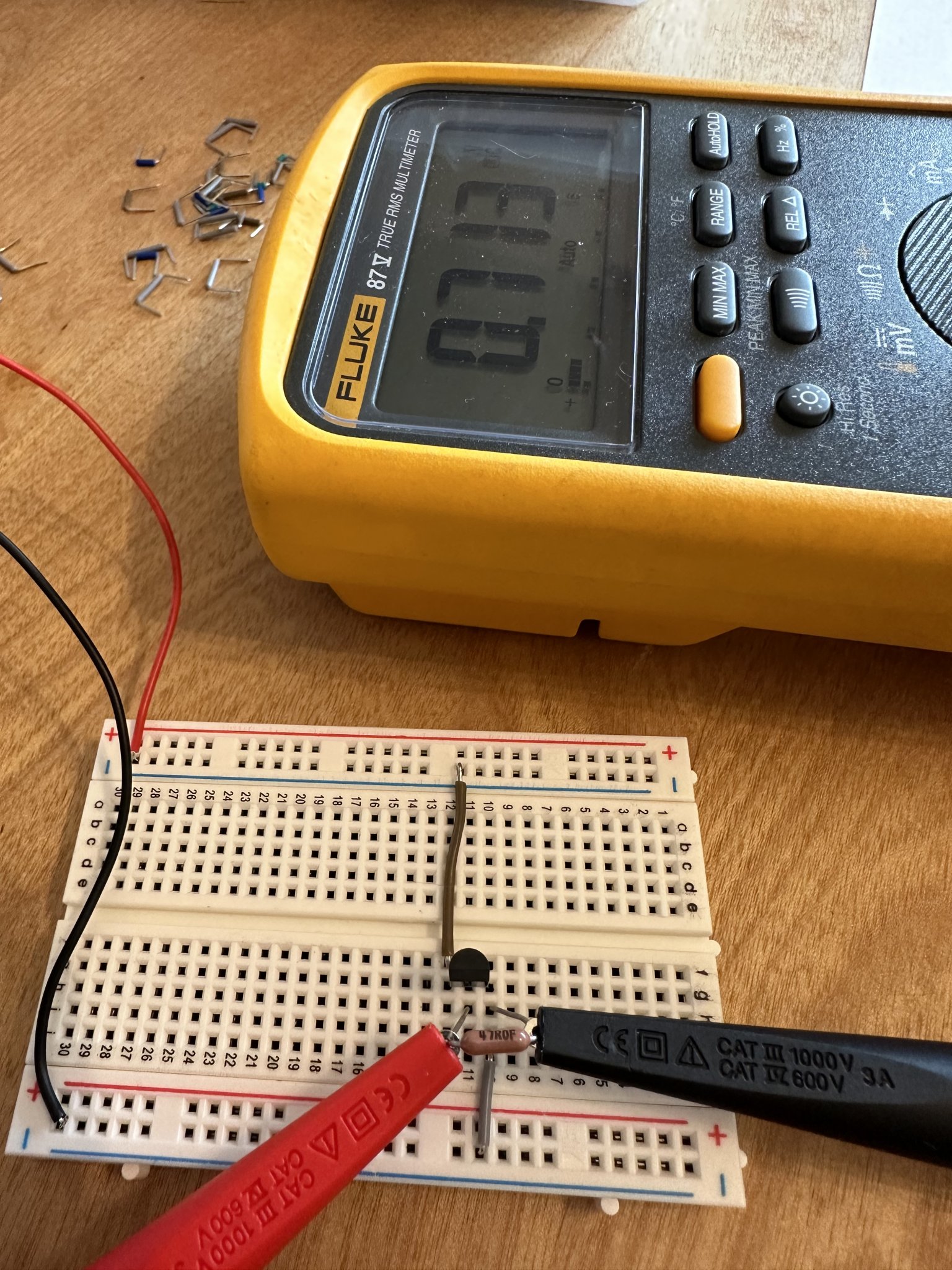

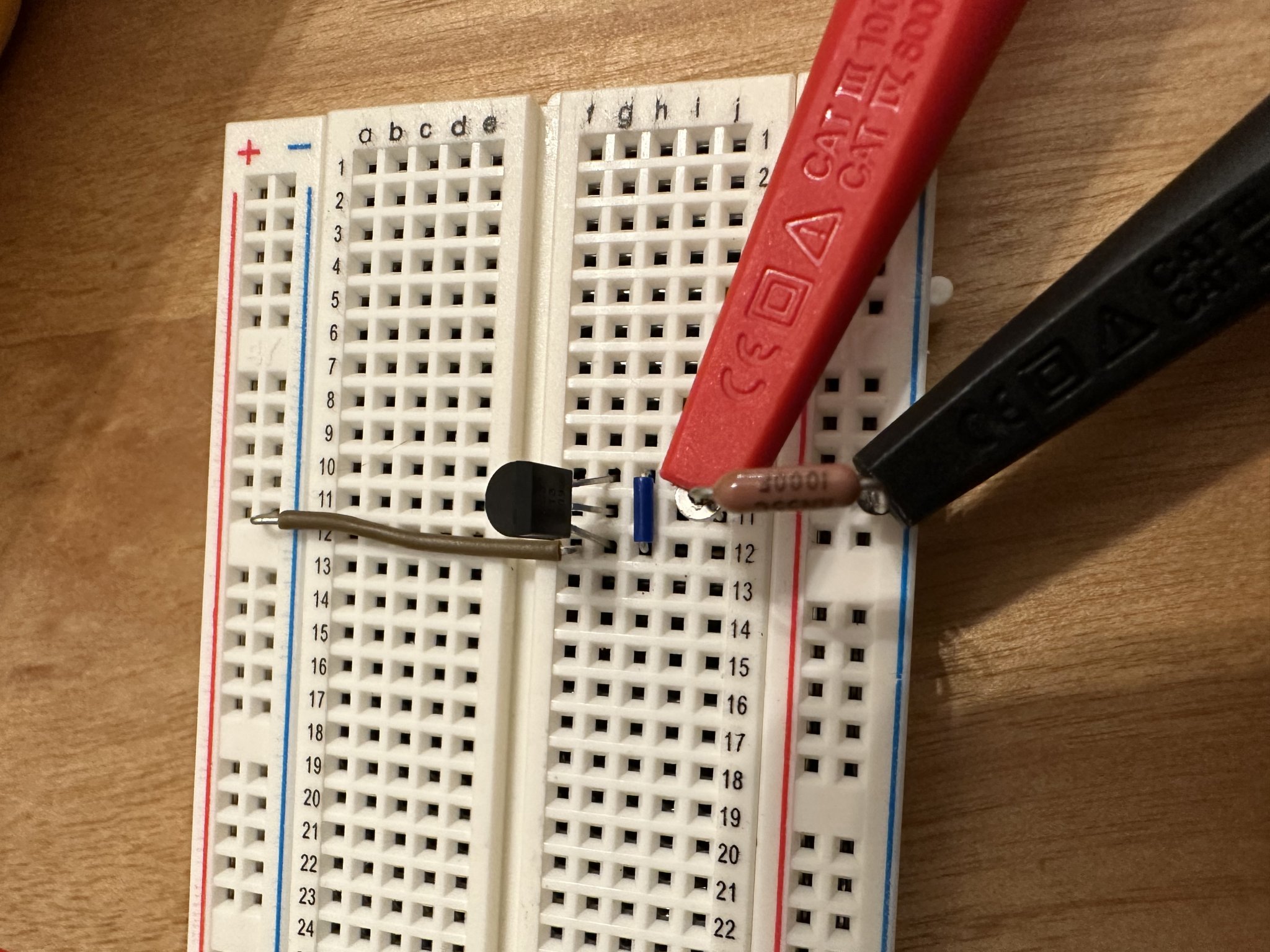

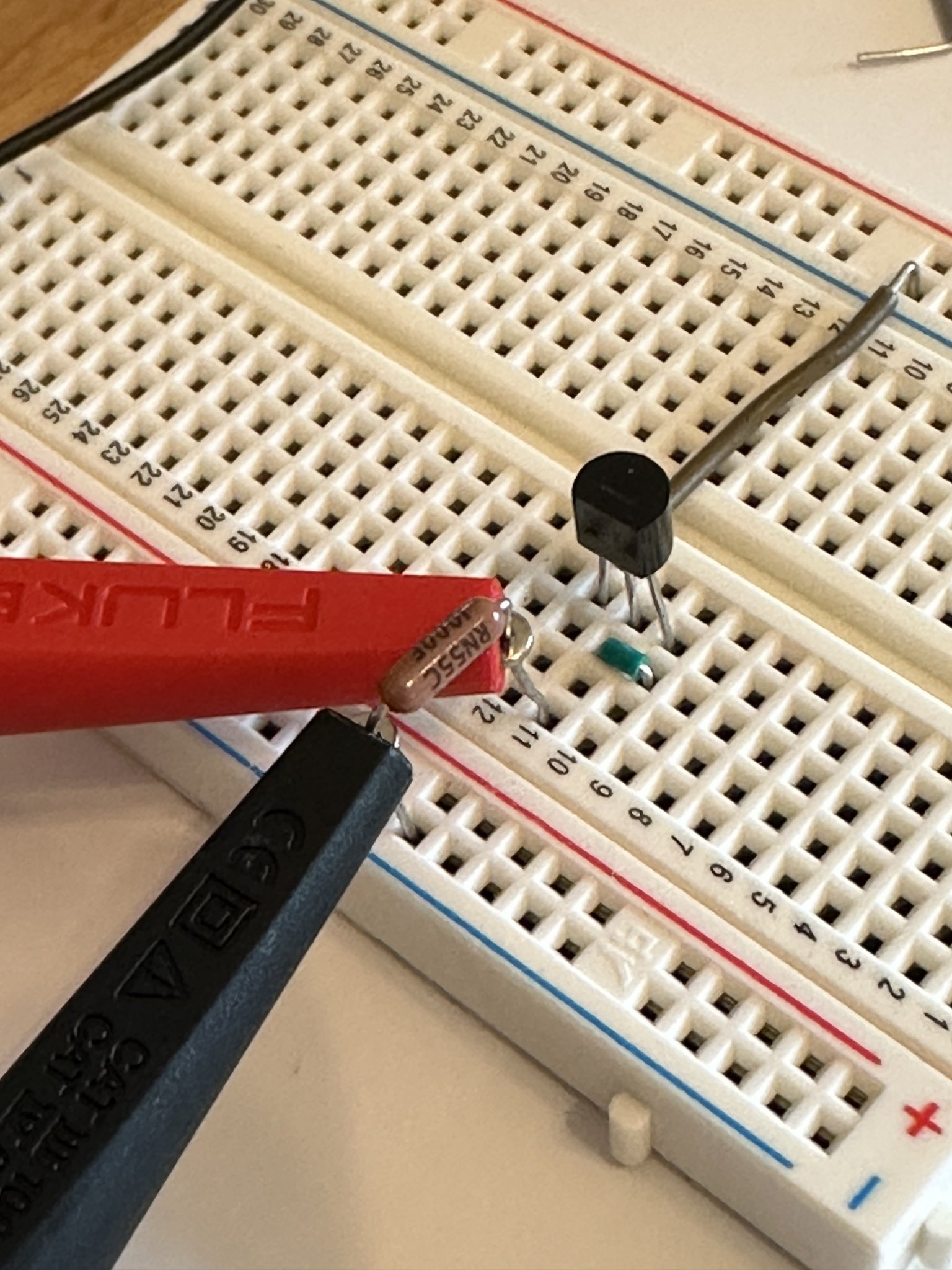

@Dennis, thanks for catching that…I had a late night.
I reshuffled the breadboard per your guidance. I tested the resistor and it was measuring at 100R but I swapped the J113 to be safe.
When I connect the DMM to the resistors it’s 0vdc. Do I need to connecting it differently or select a different setting on the DMM?
My apologies; the ground connection should be where the gate pin connnects to the resistor, so it should be at Row 10 and not Row 11.
Hopefully that didn't kill you j113.
https://www.diyaudio.com/community/attachments/1672358205837-png.1124354/

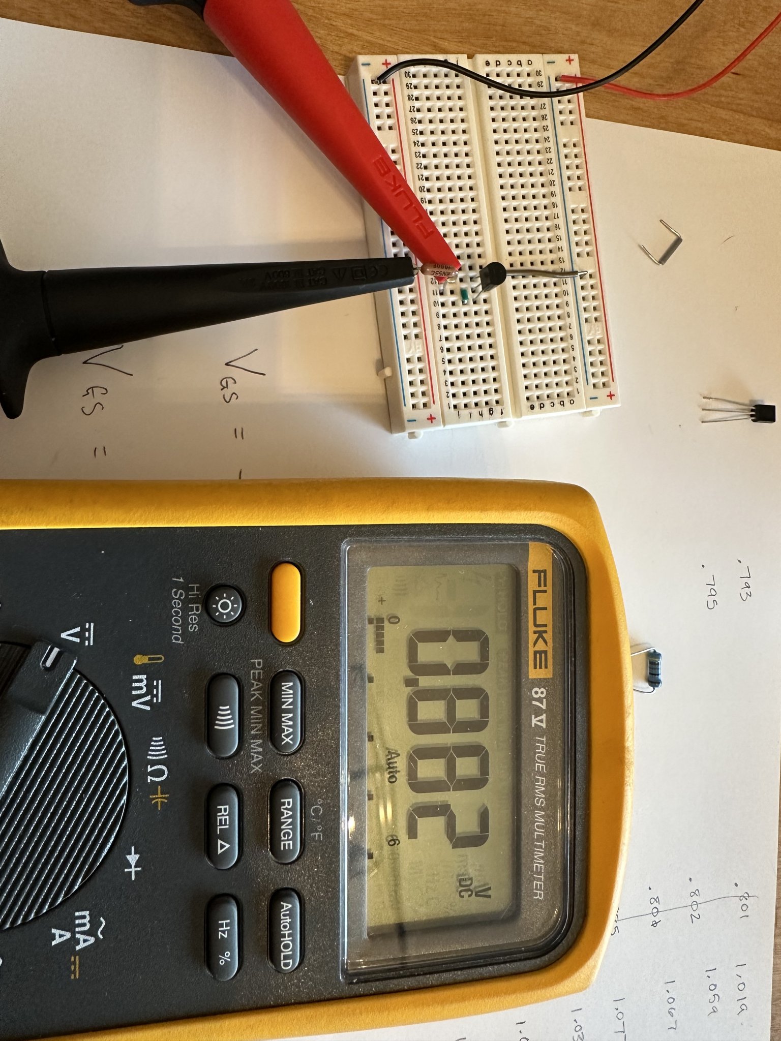

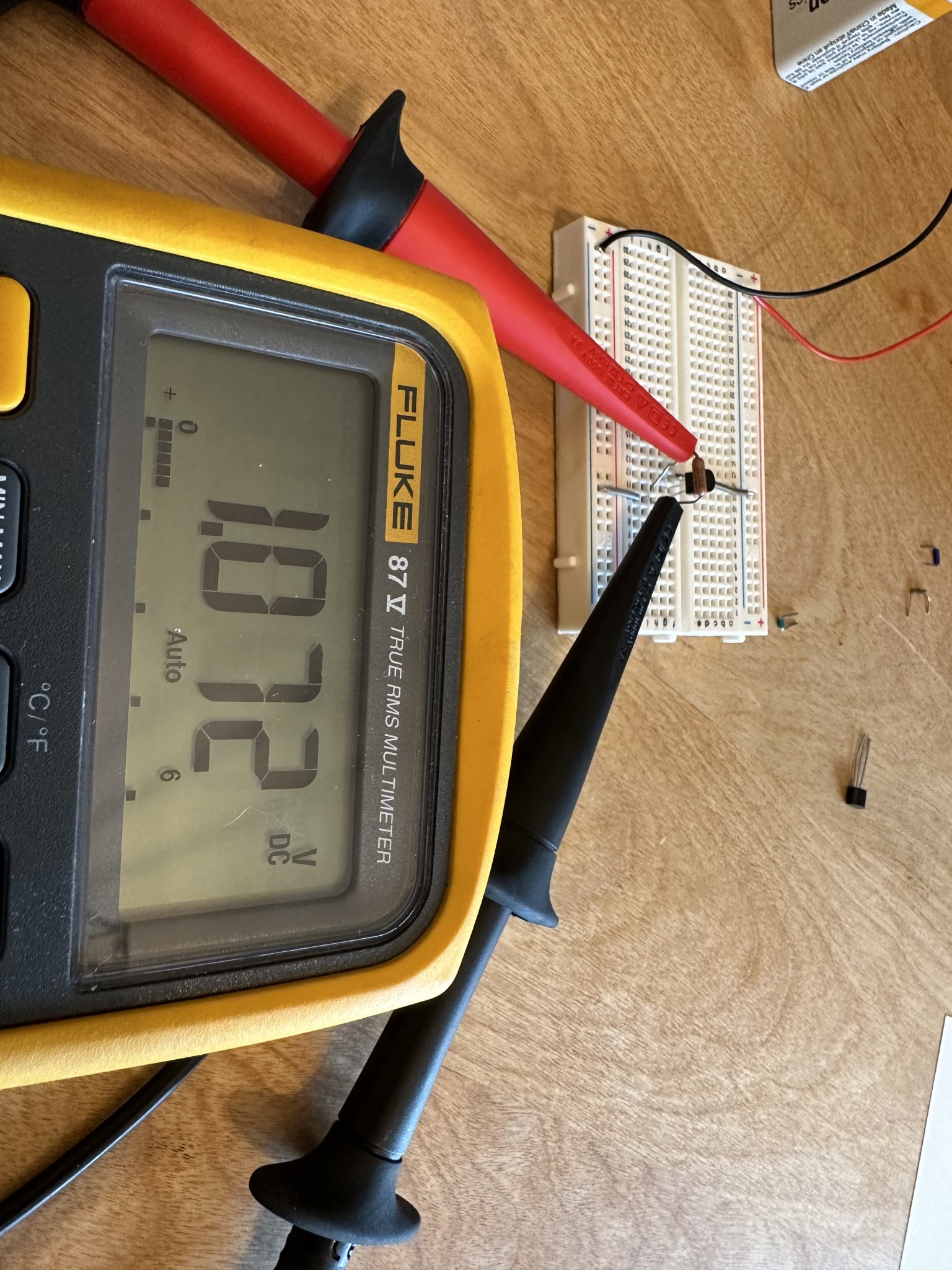

Got it. It now seems to be measuring reasonably.
You mentioned earlier that increasing resistance lowers current but it seems to do the opposite.
https://www.diyaudio.com/community/threads/diy-biamp-6-24-crossover.357657/post-7217439
100R=~1vDC
47R=~0.713vDC
249R=~1.6vDC
Am I measuring this incorrectly?

@Dennis Hui, I went back to your post #1258:
"The current flowing through the jfet is the voltage across R1 divided by R1."
I added a 475R between the gate and the source and measured ~1.822vDC. Therefore, 1.822/475 = 0.00383579 * 1000 = 3.84 mA?
That is correct.
Similarly, for your three earlier measurements:
100R: ~1/100 = 10mA
47R: 0.713/47 ~ 15mA
249R: 1.6/249 ~ 6.4mA
This illustrates that the current decreases when you increase the resistor value.
Your measurements were correct, but your hadn't calculated the currents, so your came to the wrong conclusion.

Much appreciated. Just to triple check that I’m measuring the 2sk170’s correctly, since I had so much trouble with J113, would you mind confirming my connections in the pic are correct?That is correct.

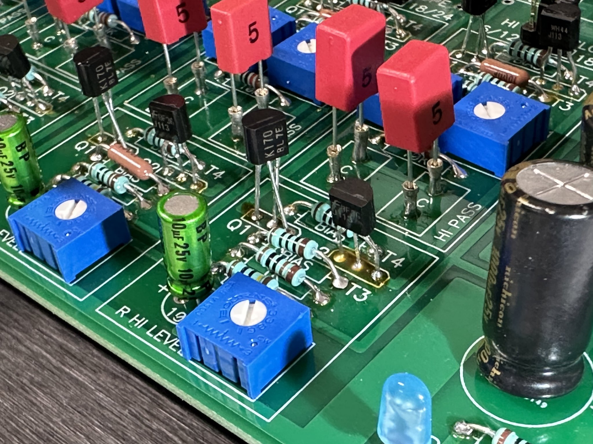

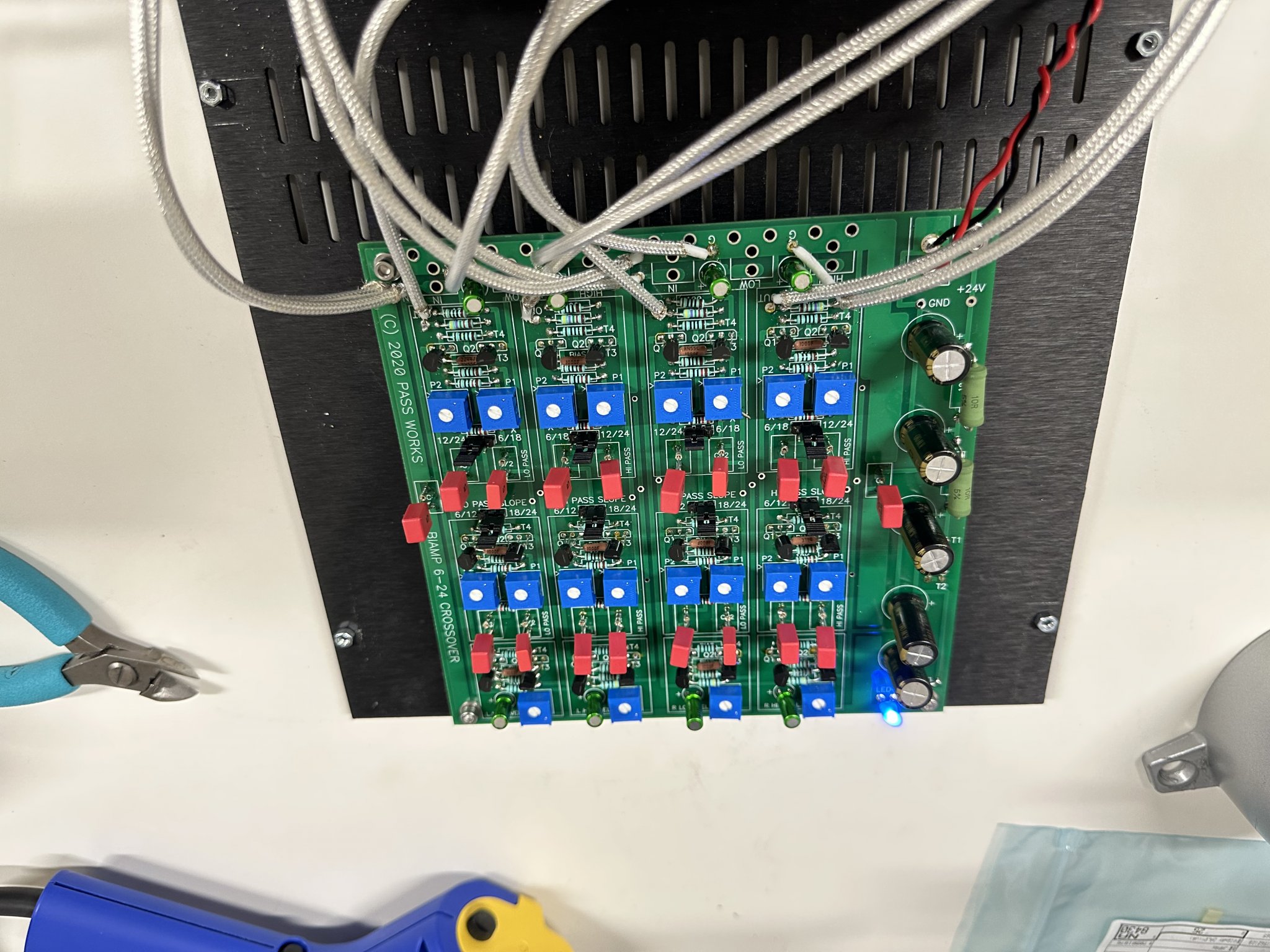

Well I bit the bullet and moved forward with the upgrade. Swapped all the Q1’s, making sure to cross the legs ensuring they didn’t touch. I re-tested the current of the original Q2 fets and all were measuring ~7.5mA using a 100ohm resistor. This allowed me to use my Q1’s measuring ~8mA and not hassle with tinkering/biasing Q2 anymore…it was already set using the fets and resistors included in the kit. No smoke after initial power up so I hooked it into my rig. Equipment has been off for a couple days; however, initial impressions (using cold equipment) are that is sounds pretty damn good. Looking forward to listening in the morning once everything’s warmed up overnight. Thanks everyone for the help.
