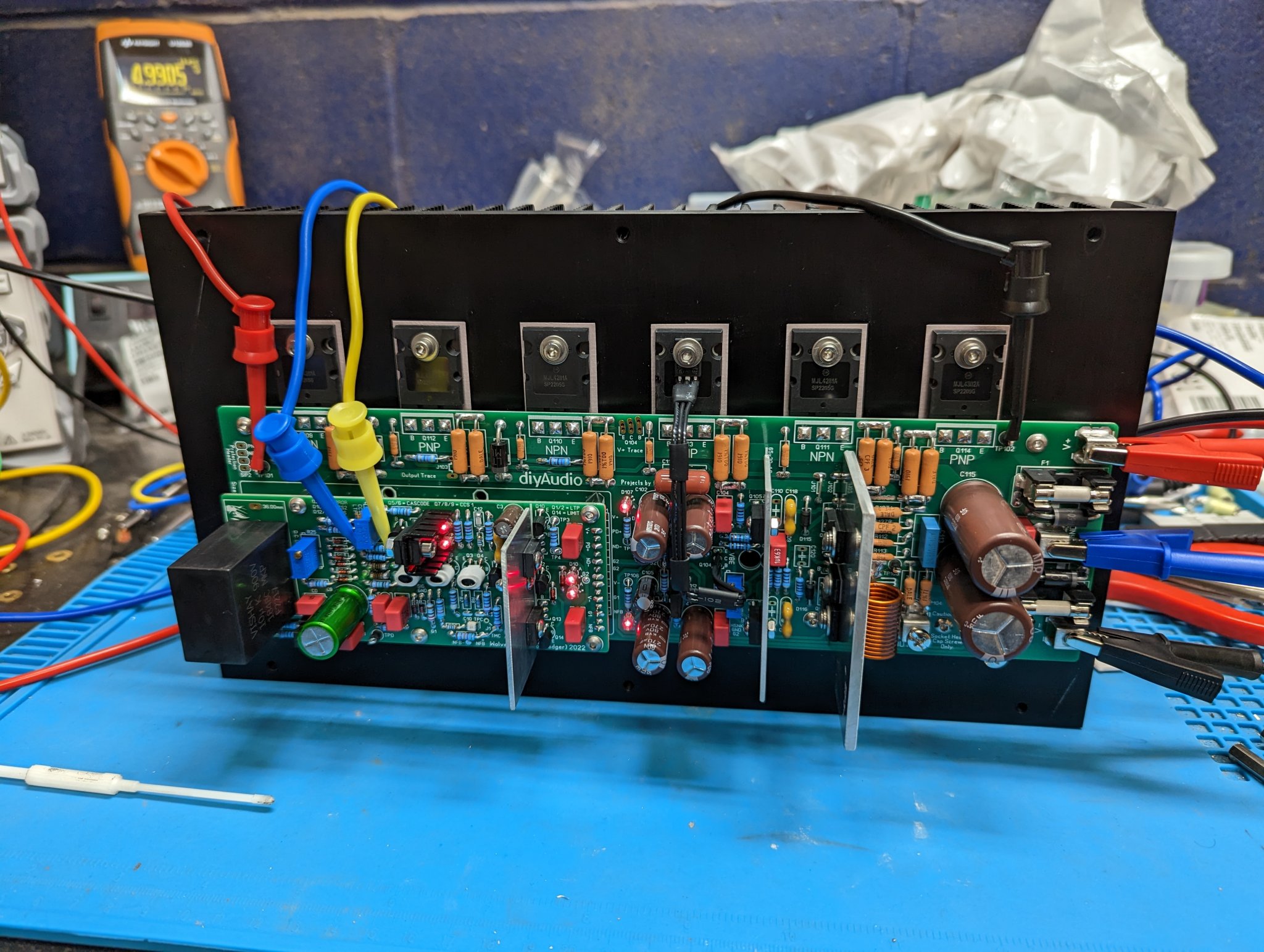

You could need to furtherly adjust DC offset and bias once the amp is closed. It could heat up differently from boards laying down on the bench... But nevertheless, I did as you're doing when built the Honey Badger and it has been working flawlessly for more than one year.You are right. One bord will be facing down. But we make adjustments whilst boards&heatsinks on the bench?

Just a recommendation but when you guys are setting the bias dc offset etc on the bench before installing in a case do not lie them down flat, stand the heatsink upright, it makes a huge difference.
I wonder if you have tried seeing the response of the amplifier to offset and maintaining the temperature and quiescent current in the heatsink with the transistors up and then down. I believe that would be of interest to many here as far as placing the boards inside the box.

I have. I've set them up on the bench and noticed no real change if they are inverted or not. Also the completed chassis I have show no issues in either orientation. There is nothing to worry about. The heatsink is such a large mass it does a great job of dispersing the heat.I wonder if you have tried seeing the response of the amplifier to offset and maintaining the temperature and quiescent current in the heatsink with the transistors up and then down. I believe that would be of interest to many here as far as placing the boards inside the box.

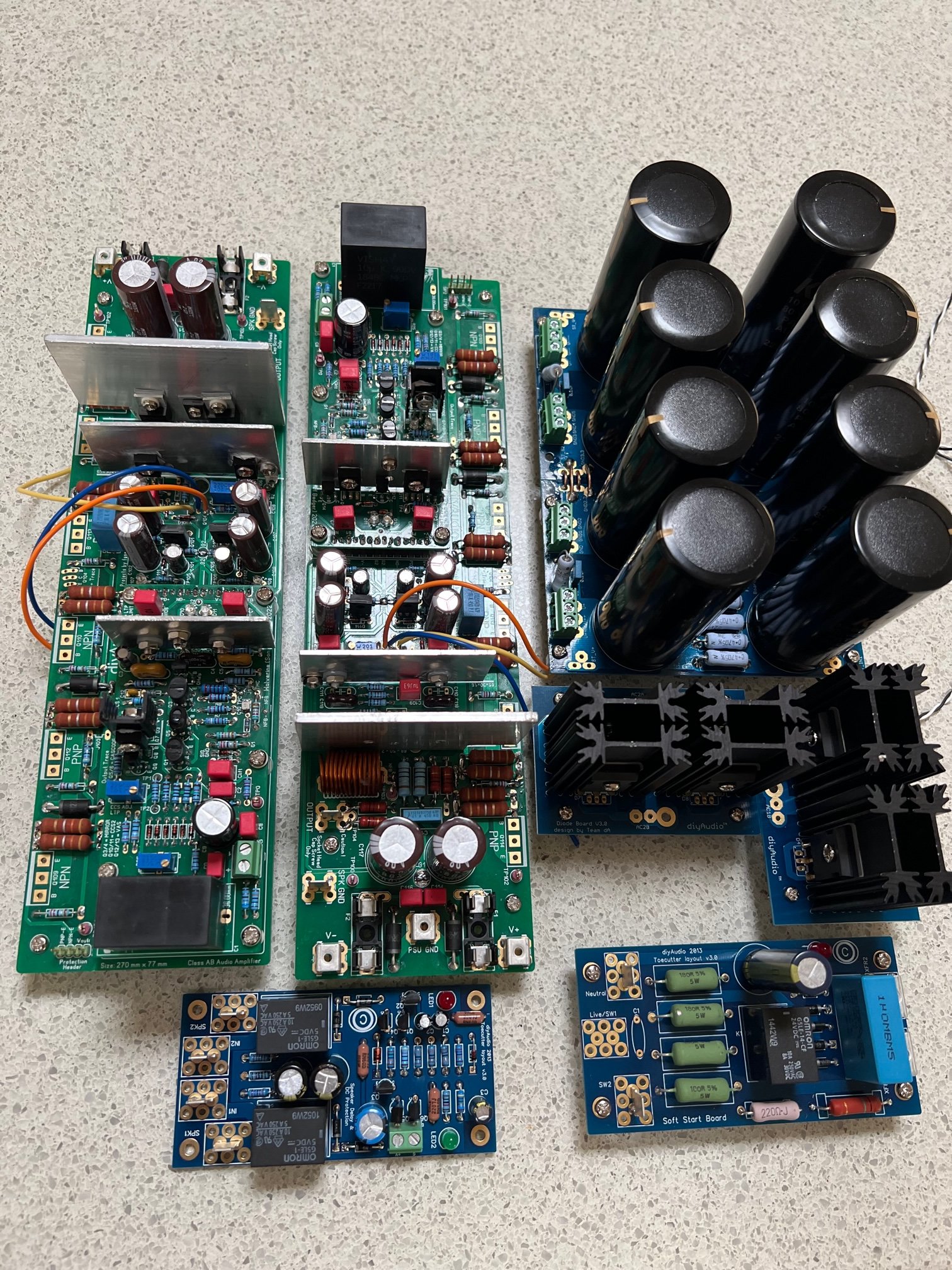

All dressed-up and ready but nowhere to go......
EF3-3 boards (build in tandem with the EF3-4), Power Supply, Soft Start and Speaker Protection boards all done and just needs to be tested and fitted to a chassis.
Will be ordering a 4U chassis soon (work pressure has slowed my amp building down to a trickle now)
The EF3-4 amp (as per my photo's in previous posts) has been playing non-stop throughout the holidays. Room temp goes up to about 30deg C at times and the heatsink temps has not exceeded 43/44deg C (one board is fitted "upside down" to ensure that both IPS boards are close to the input connectors). I've been using both the DiyAudio Soft Start and Speaker protection boards which has worked flawlessly.
Using the Whammy pre-amp and all in all, I'm extremely happy with the amps' sound and performance. Open and clear at all volumes, tight bass and no listening fatigue.....and ….it has power!
