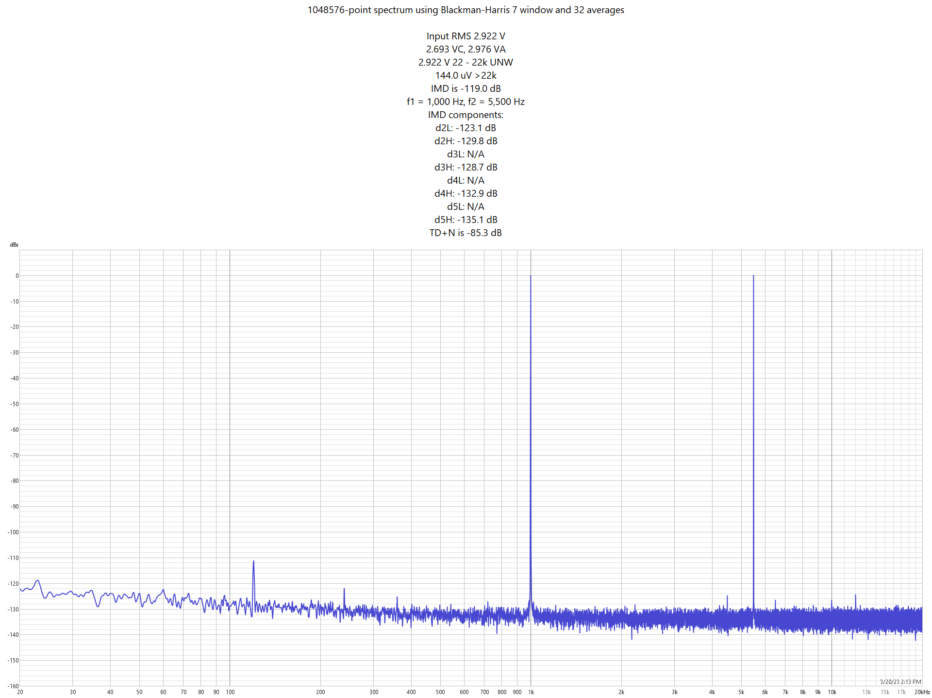

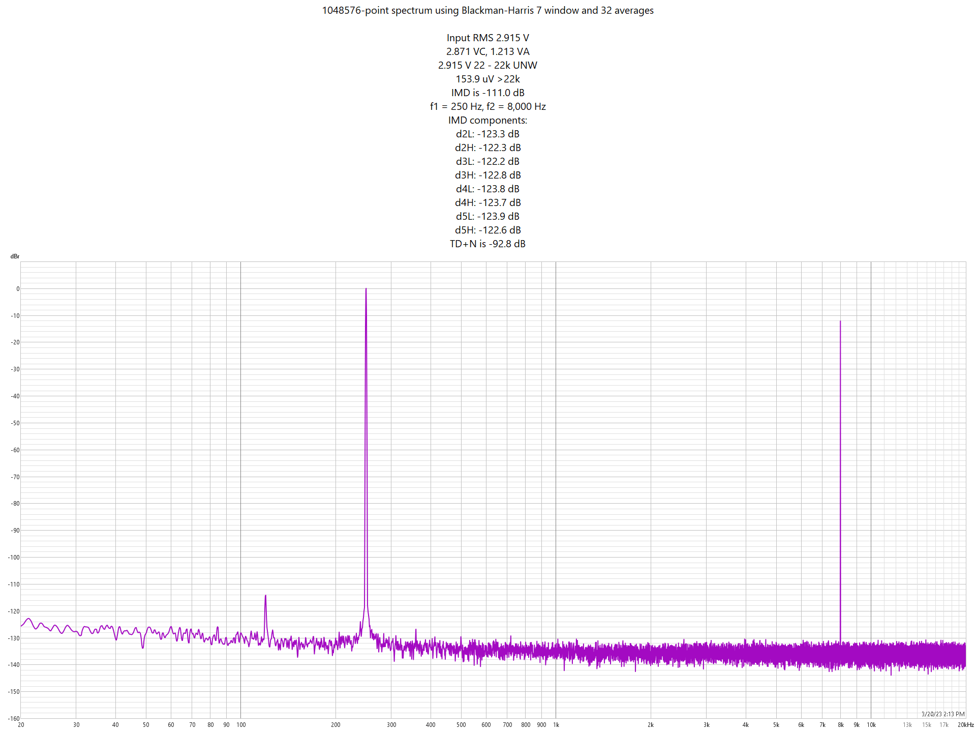

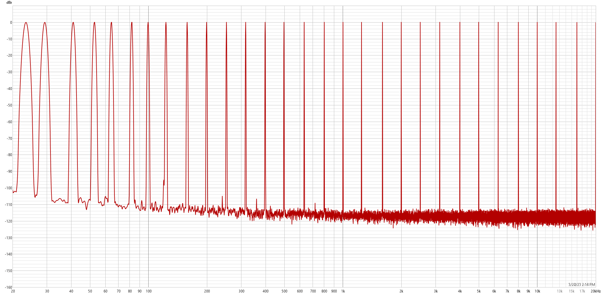

Here are some IMD measurements for you guys who were interested. I also took a 31 tone multitone, spikes just above the noise floor is mains harmonics in the measurement chain, amplifier is clean.

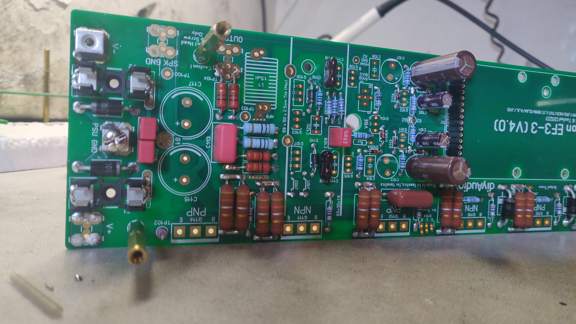

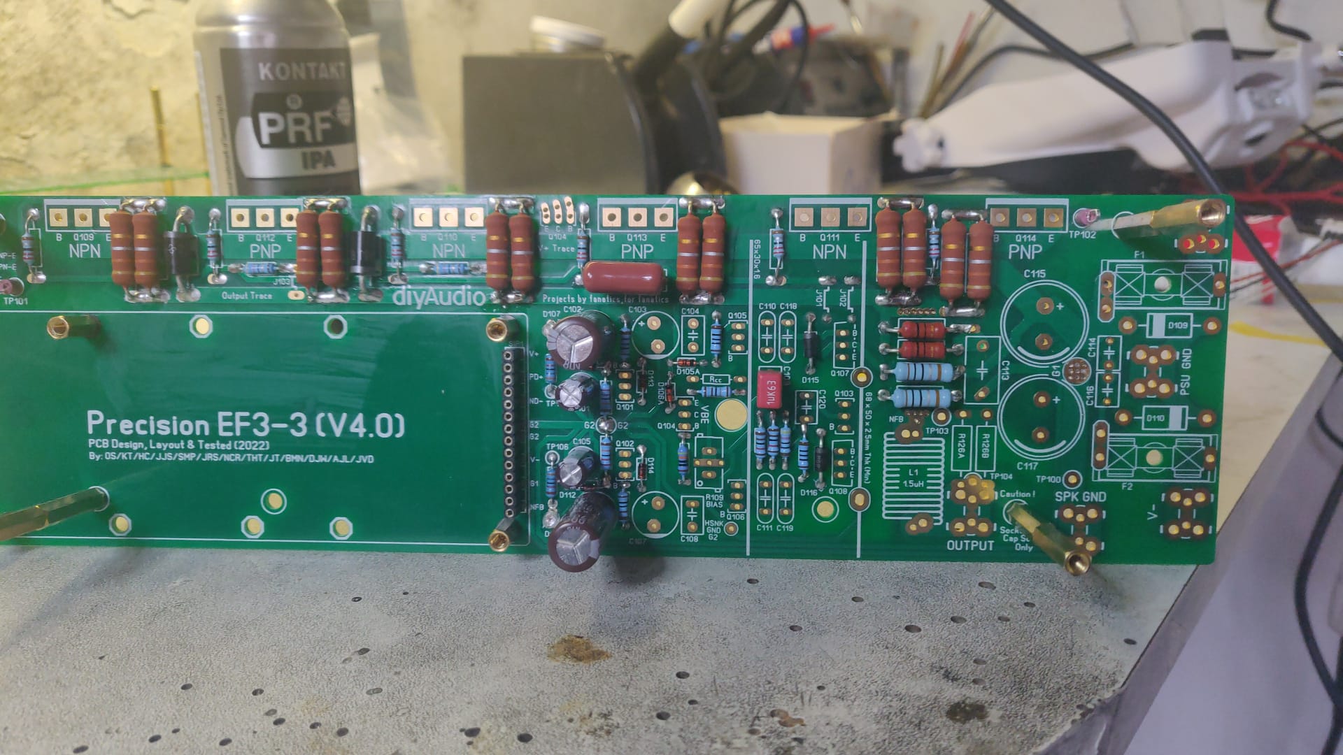

Hi Guy's, for anyone who is new to this thread I just want to let you all know that there are still some 2nd Group Buy boards available.
@jjs is servicing the USA and Canada regions.
@stuartmp is servicing the other regions.
Please also don't forget that @fireanimal is offering to build and test completed amplifier modules for those who wish to take advantage of this service. PM him if your interested.

I believe , the first Wolverine 6 years ago was <5ppm. In fact , the whole "Slewmaster" collection all tested under .001%/ 20k.
With this one we got "anal" with the layout. This layout seems to work well to cancel out what (was) left. Halcro, Nikko , Para sound and Pass
layouts were "observed" to get this one. I could get any of my slewmaster designs to easily outperform ANY OEM , with ease.
OS
PS - the real amp preforms better than the simulation. ??? Even without parasitic L/C and other LT tricks (ideal) ? Let the simulation "deniers" chew on that.

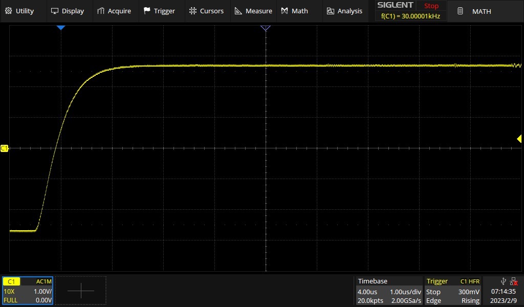

Dear Volverine Team,
I've been following this discussion for a long time and despite all the team's efforts, I still don't feel confident with the project.

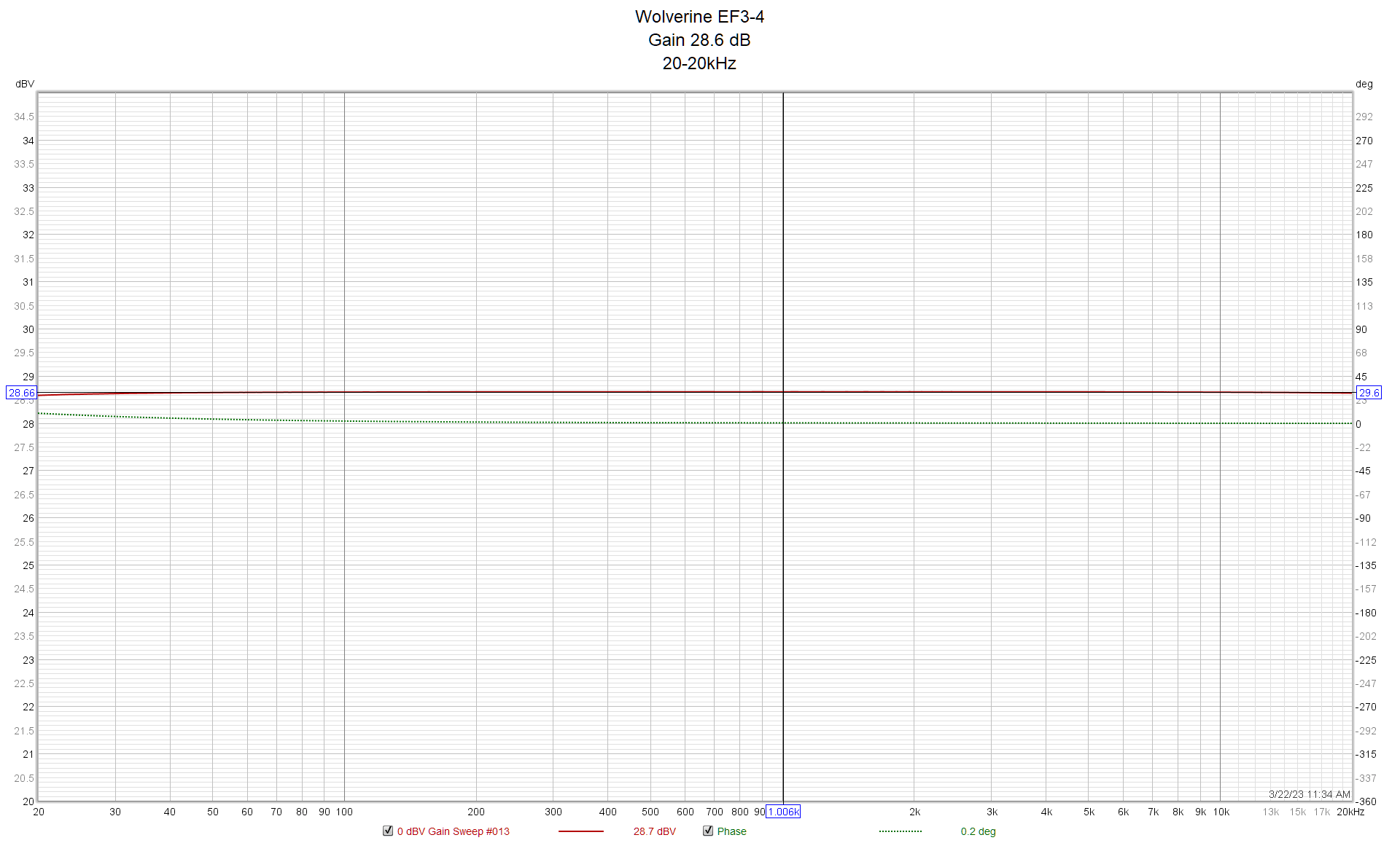

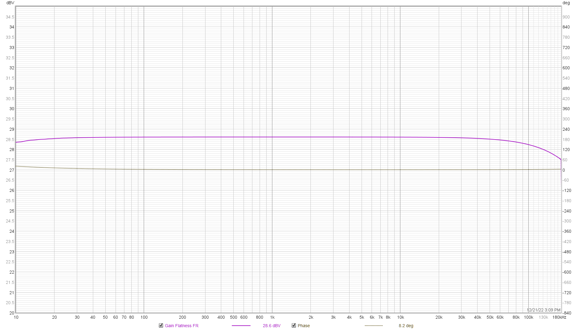

I kindly ask you to do square wave tests (step response) and frequency response (-3dB) at 0.3 0.5 and 0.75 Vout max. with non-inductive dummy load. I saw you have all tools to do the job.
Thank you and I hope the result become motivating for me and other interested like me.

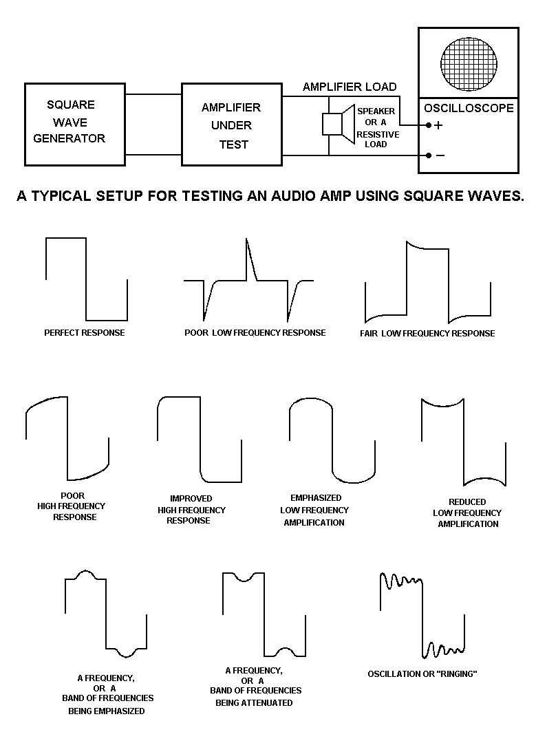

Dear,
This is a simple and effective test to show the amplifier and its compensation behaviour. It was well explained by Dr. Bora forum user in the past.
By the way, 10KHz is a good frequency to the imput square wave with very fast rise and fall times with no ringing (use correct impedance cable and termination in the generator output).

I do not know if the user 'fireanimal' tryed to answer my question.
Frequency Response showns the -3dB point were the gain start to fall down. This curve must have a phase curve folloing the gain curve. The -3dB point normally changes with the output level. Lower level means highier frequency 3dB point.
Just remenber SACD has 100KHz of bandwith in its specs and some old good quality amplifier used to go near to 500KHz.
it is always useful to show how the test was done by describing applied equipment and the output load.
I cant measure the upper -3dB point of the wolverine. It is out past 192kHz. Lower -3dB point is 2.5Hz.
I was showing the flatness of the gain curve between 20 and 20k.
Another point to remember:
When you listem music you have lots of signal, one over the other, and this sum makes the stage details and create the correct audition (you depend of your speaker to get good result). So static tests done with continuos signal must go to highier frequencies in good amplifier.
The square test shows how is the amplifier and feedback behaviour and it is the most revelating test without audition.
Regards
In the atached picture you can find some details generated by Dr. Borah long time ago.
Now there are some changes in the best spected square response.
You got a good square answer with your low distoction profile and is like the SIM result I got with the limited information from your schematics.
There are some product review that show what is the best answer by now. I could not find the review to show you as a reference.
Thank you for your time.
