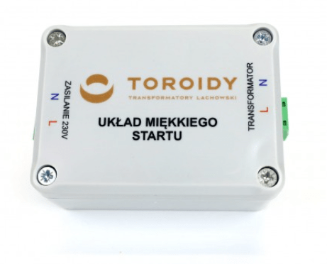

@wkloppen The toroidy inrush limiter is not ideal for an amplifier, you probable want one that can be activated from a small signal switch.

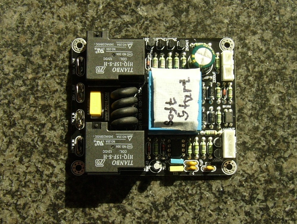

As mentioned above Audiophonics sells several models. China import by the looks of them. I have one lying around, it works, but the standby power consumption is to high to my liking's. Also the weight of the 5VA pcb transformer makes the printed circuit board vulnerable in case of mechanical impact. A safety issue.

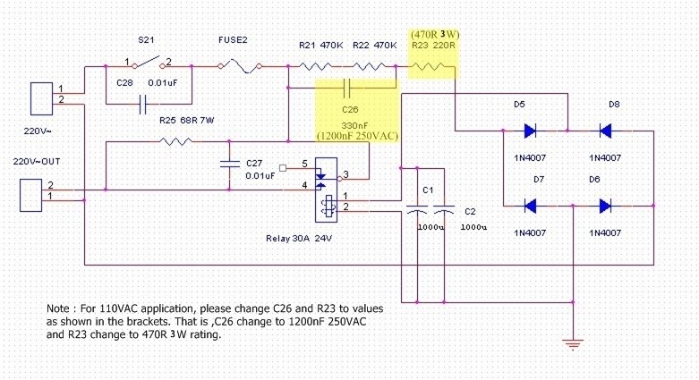

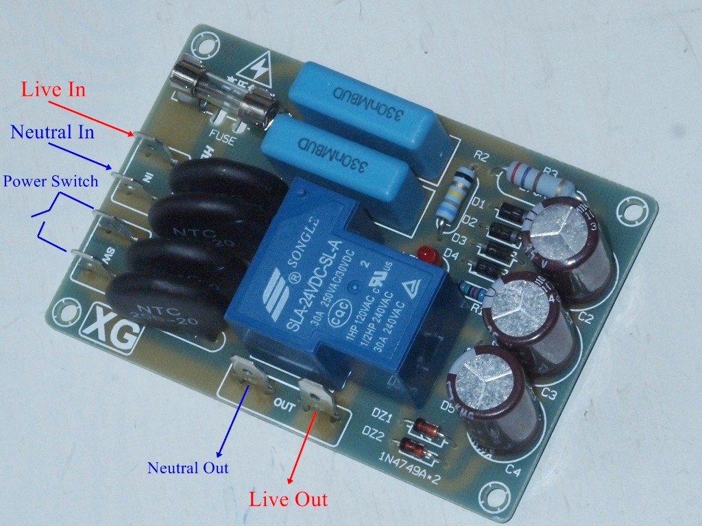

There are a few soft start kits available on EBay or from Aliexpress (the soft stsrt class A1 may not be available any more, recently I saw ony a simpler version of it). Attachments show the ones I'm using. Two of these use also thermistors: NTC 20d-20 or NTC 16d15. Alternatively to make things very simple one can use just Inrush current limiters in line with power switch. May not be ideal but it works, I tried it. Schematics show the simplest 30A soft start with a resistor.

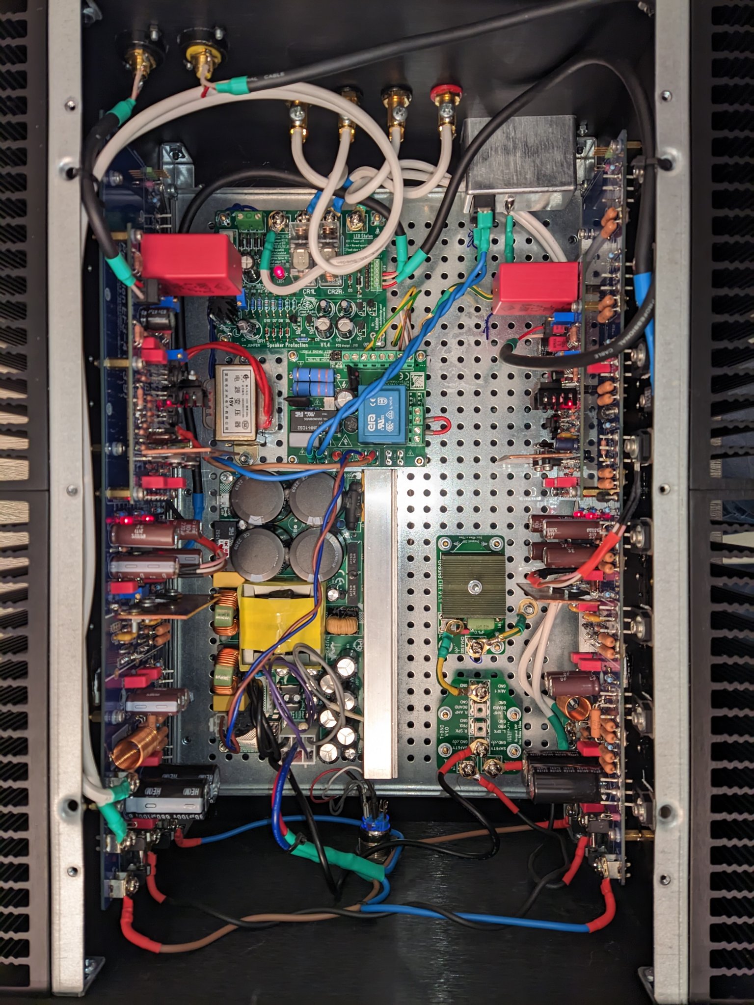

@ghitusHi wkloppen, you did a good choice. These are my implementations of the Hypex softstart. As I told you it works pretty well.
Gaetano.
Thank you for posting the pictures. Very nice implementation of Stuart’s T-GND and G-Lift boards! Also, you show how much space is available in the Modushop 4U/400 monoblock chassis which are more narrow (smaller width) than regular 4U/400 chassis. 3D skyscraper planning is important here! You are showing one build using conventional linear power supply and other showing SMPS. Nice work.

Thank you for your kind words, @Anand. I had to choose Mini Dissipante, 33 cm wide, for space constrainst imposed by my furniture (and my wife). The linear PSU one is the Honey Badger, which many of you already know, the one with SMPS is of course our beloved Wolverine. Have to say that both of them are truly good sounding amps.

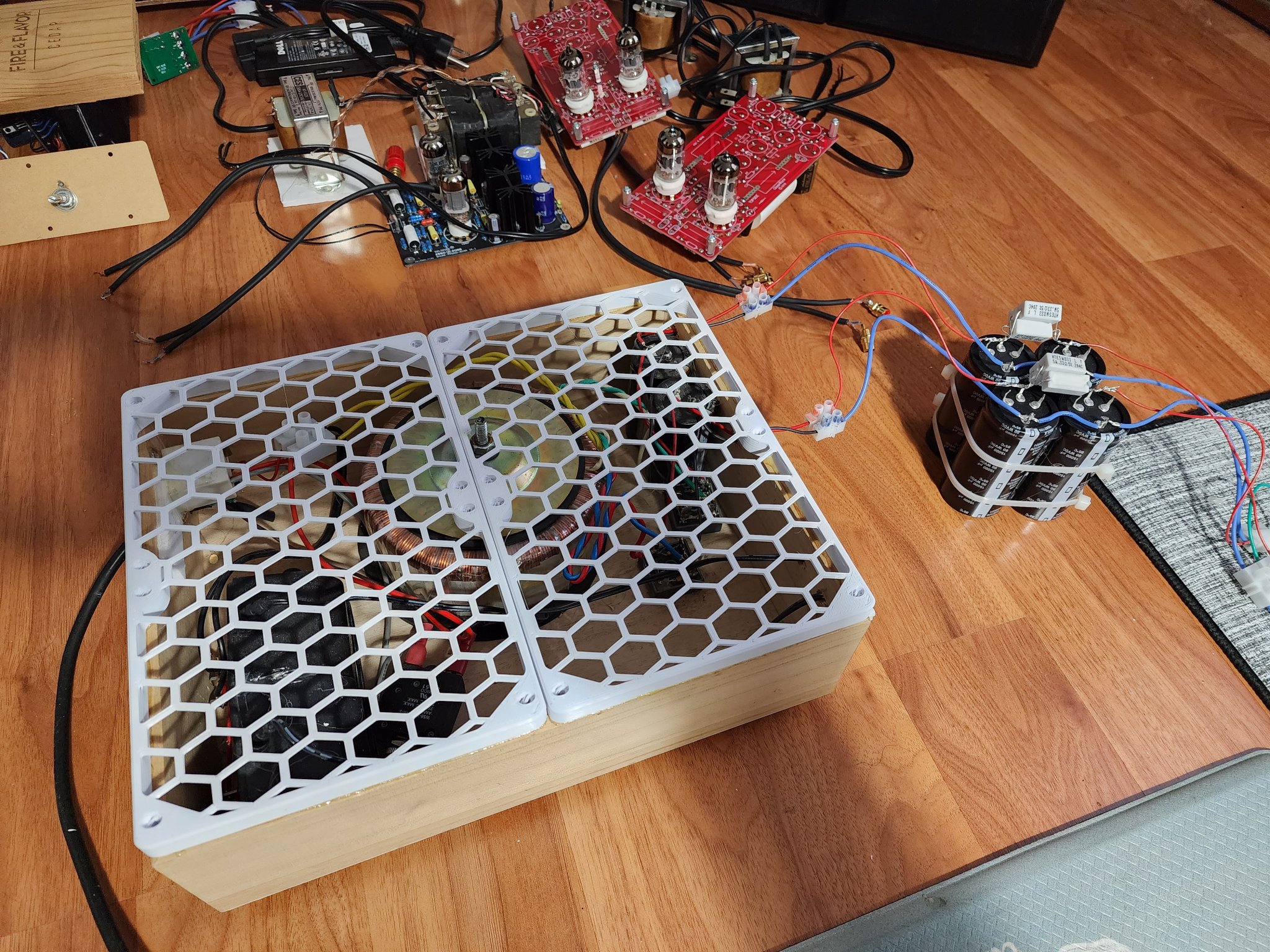

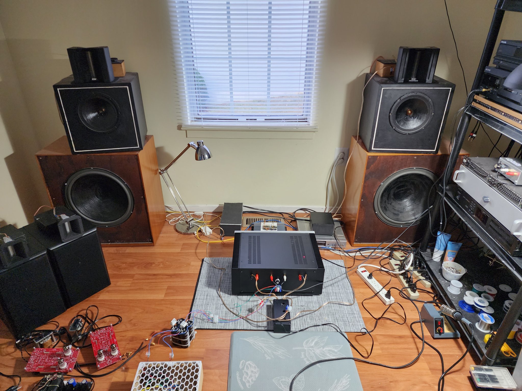

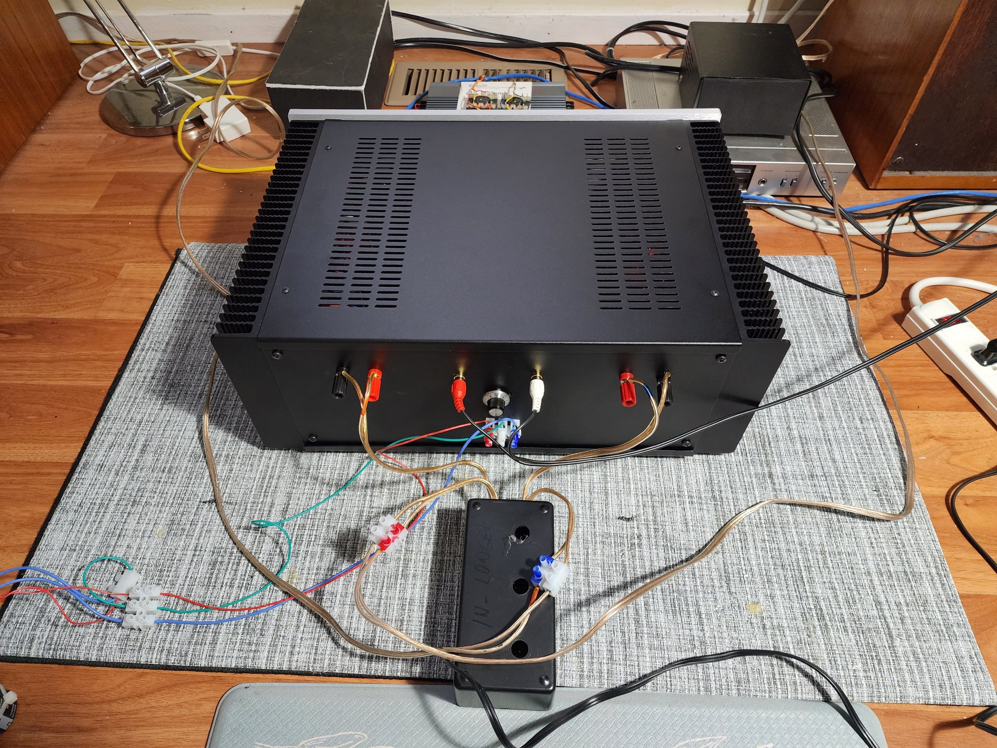

Hi all, i have got working boards from Andy (fireanimal), mainly because i am lazy, and due to move all my diy stuff is somewhere in boxes.
So all the credit goes to Andy.
I placed boards in box, and used power supply from my dartzeel (+/_68.9VDC) with some extra caps (4×15000uF/80VDC).
During testing, i used external speaker protection, later not used.
For testing, i used 3way speakers based on 15" Jamo, Betsy wow as mid and big ESS Heil.
Source was sony xa20es, no pre.
The sound i would describe as 'sublime'.
