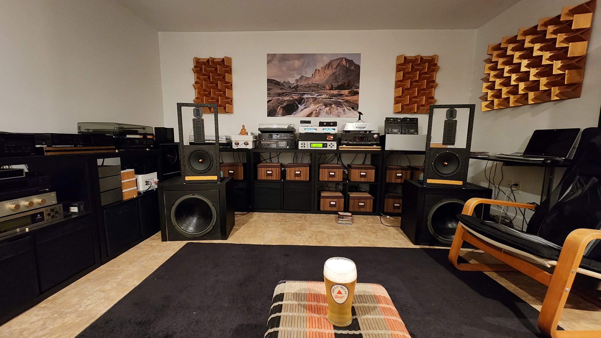

Later, after the move and lots of house rebuilding, my man cave if almost finished, i installed wolverine in the main system and had few friends for listen.
All agreed this is the most transparent amp i own. I do have about 50 amplifiers (somewhere).
My main system is more complex and contains active crossover and pre. I like lush sound, and tube pre is a must.
As said before wolverine amp sounds sublime. Each instrument can be easily followed with no effort, even in very complex music. Top is the cleanest i heard. Chimes are spooky real. Like in the room.
Amp is never boring, never dry, never fatiguing. Have been listening for a month now, and it still is amazing.

Your system looks amazing job well done! Glad to hear that you are really enjoying the Wolverine, guess it's really hard not too, to be honest.Later, after the move and lots of house rebuilding, my man cave if almost finished, i installed wolverine in the main system and had few friends for listen.

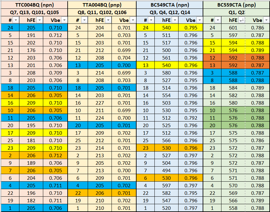

Semi matching...need a bit a guidance as I did soem semi measurments using a DCA-55. I know about Q1, Q2 and Q3, Q4 as the need to be matched as much as possible. How about the pre-drivers Q105 and its complementary Q106? I reckon they need to have the same hFE as much as possible. Any other advice?
thx in advance
thx in advance

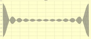

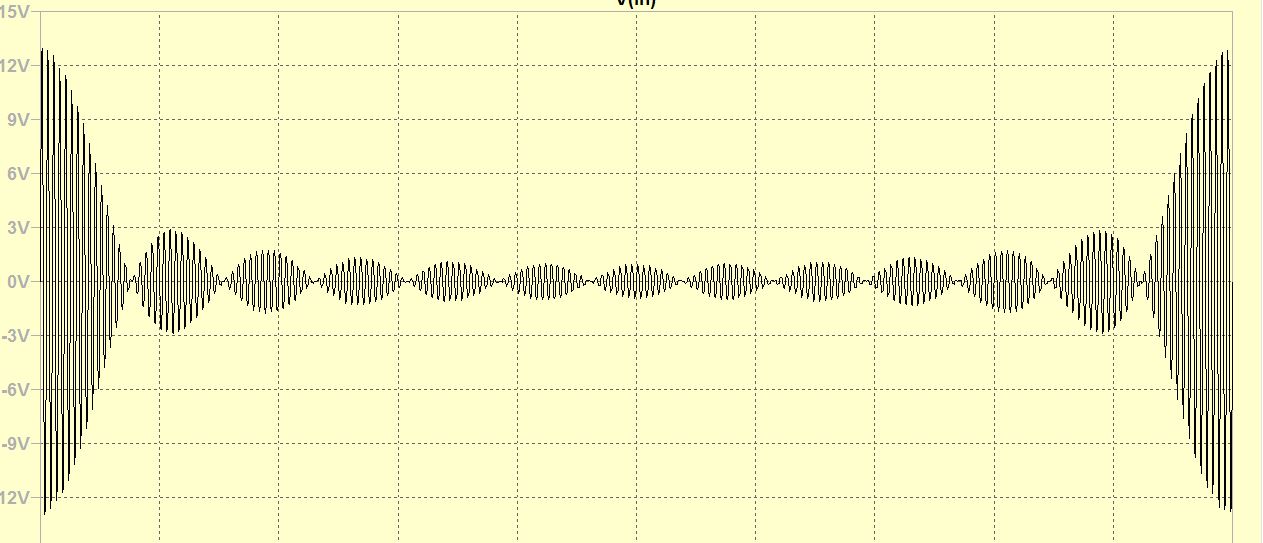

Bellow are two wave files ripped from CD. Test first the refrain of Turtles, Happy together. Are voices screaming or clear? The Frank's voice has a metallic grain, is it brass like or garbage?I will never have the opportunity to listen to a zero distorting amp. So please if someone can describe me what kind of sound you get with the bellow short extract of Mozart's requiem.
Dirty, clean, celestial.

Now that is a proper man-cave!Later, after the move and lots of house rebuilding, my man cave if almost finished, i installed wolverine in the main system and had few friends for listen.
I hope soon i will have time to build second one by myself.
If I want to know how a zero distortion sound like with the files I posted, because of feedback theory. Grand masters St Bob, St Bruno etc, preconize either no feedback or very high NFB feedback. Why? Because of the open loop phase rotation in the audio band. Only the NFB is the parameter that can bring the 90° phase shift to near zero in time. St Bob in his evangel decides to design a MOSFET amp with 40khz open loop bandwidth with about 30db NFB only.
What goes wrong? When a single voice note is played, nothing is wrong, but with multiple voices with the same note but different frequencies from flat to sharp, the low NFB feedback provokes data loss on the beat after which the ear can no more reconstruct back each voice individually and you hear distorted sound. see bellow 13 voices of 1khz note equally ranged from flat to sharp. What I wondered if the nonlinearity is also taking part. I saw the loop gain on the first early version which is about 24db NFB at 20khz, this is same what chip amps do. You need 40db @20khz NFB to get the 16 voice of Happy together right, and 70db to get the Requiems of Verdi , 300 voices +70 instruments, and of Mozart sound celestial.
As was confirmed, The Requiem of Mozart can not be reproduced by your amp, but how about the Frank's voice, is this amp can be qualified as Audio or just in lab use for chemistry or Physics experiments.
Ha ha.... "phase rotation" ? in yer crossover network ? Wolverine actually is 32db OL gain over 26db actual - 6db "extra" NFB @ 20Khz. <1 degree phase shift
from 20-20Khz. I'm sure Mozart would be pleased. Xover and driver alignment would be much more of a factor.
"Franks voice" ? just think of the valve amps that created the master .... and then all the re-mastering since. phase shifts galore.
Frank would have to sing into my 200$ mic and be recorded at 32 bits (DSP) to get it right. Too bad we can't time travel. he he....

@wkloppen Theoretically, the more closely the transistors in each complementary pair match, the better. As the transistor size/operating current increases, it is more difficult to find a match over the entire operating conditions, so that any match will be a compromise. You might try matching at the bias current - ~5.5 mA pre-driver and ~15 mA for the drivers.
I'm not sure of the collector current controls on the tester you have. Generally, the base current is regulated to determine Hfe and Vbe at the base current operating point. If you can match the Vbes, then the emitter resistors compensate for modest differences in beta.
