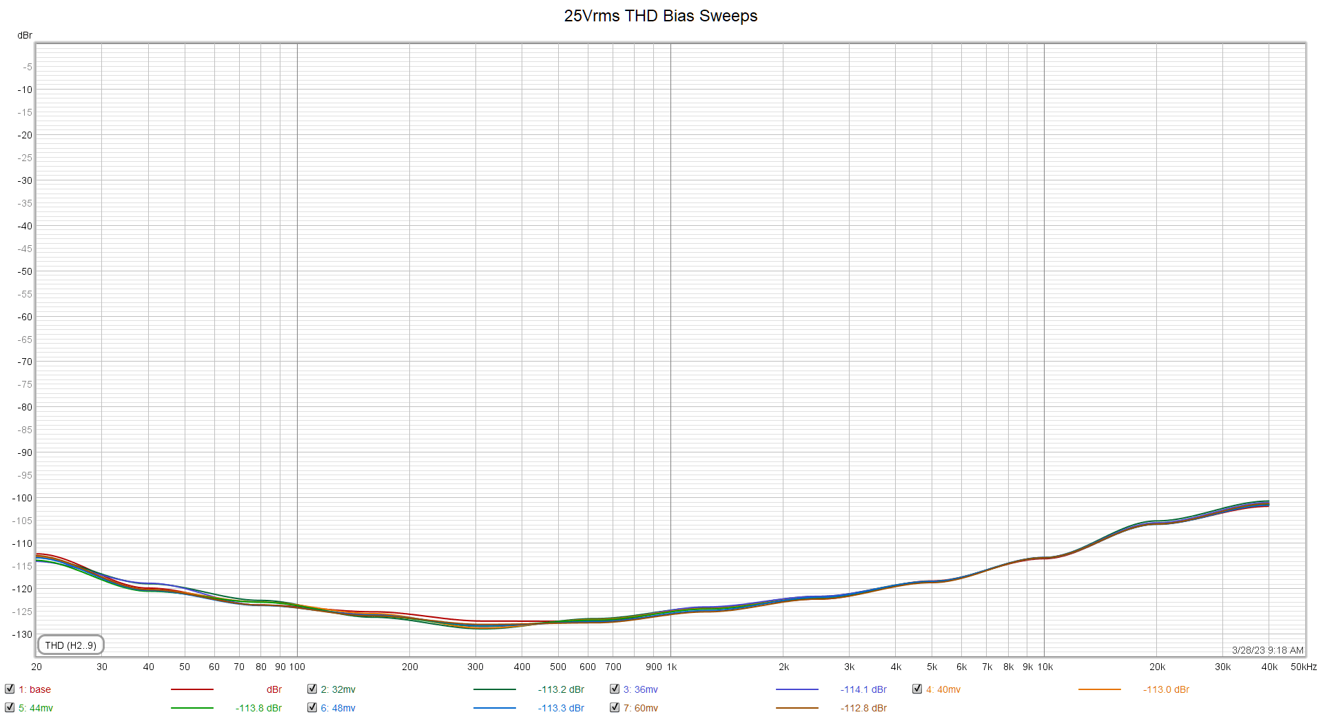

The Wolverine is pretty forgiving to bias change. See attached, there is very little change. So nothing to worry about!mhuth1776 - I learned something from your measurements. Checking the schematics, I see that the Wolverine is thermally overcompensated. This is okay provided that the bias does not collapse under load. The bias has to be set high enough.
I use thermal undercompensation which means that the bias is optimal when idle, and heads towards the maximum under load. This requires sufficient margin to avoid runaway (I rely on simulation). The distortion is lowest at idle.
Ed
Your graph does not show the effects of temperature.The Wolverine is pretty forgiving to bias change. See attached, there is very little change. So nothing to worry about!
mhuth1776 saw the bias go from 43mV at 35C to 23mV at 45C. What happens at 55C? 65C? The bias needs to be checked under worst-case dissipation because it is heading towards zero.
Ed
I understand the bias drops the hotter it gets. My graph all measurements were taken at idle temp to see what effect the bias change has on distortion. So what I am saying is as the sinks heat up and the bias drops, the overall distortion profile does not change and remains consistent with bias changes over temperature. I have pounded this amp and it does not matter if the heatsinks are 30 40 or 60 deg C the distortion stays very close to idle temp.
Okay, that implies the bias is sufficient.I have pounded this amp and it does not matter if the heatsinks are 30 40 or 60 deg C the distortion stays very close to idle temp.
Ed

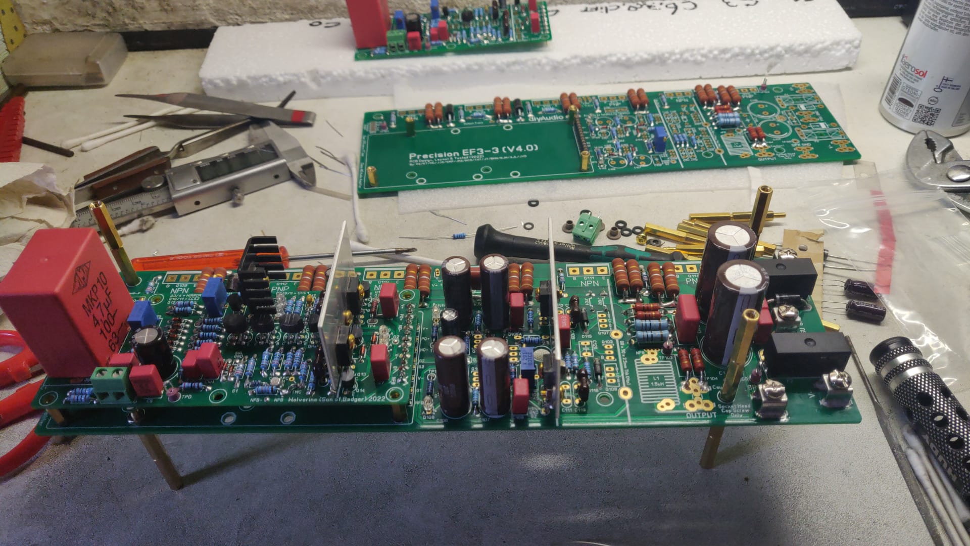

Nice!Some progress on the boards. Going into the right direction. I'm using Isopropanol for cleaning but right after cleaning a sort of sticky residu remains on the board. Is that a comon problem or do I just need to use more Isopropanol?
Use isopropanol next a brush next some toilet paper or cotton before isopropanol dry.Use more isopropanol.
Repeat this many times.
These Kimwipes work well for the Iso/flux cleanup task. Less lint left behind.

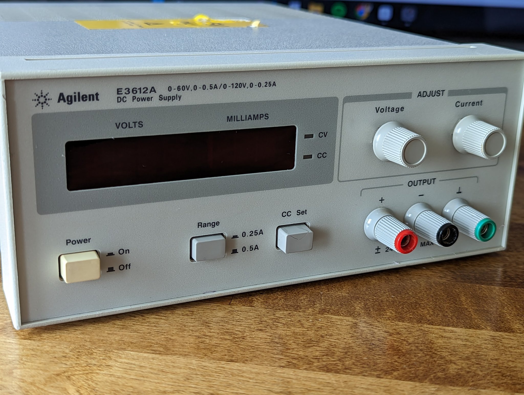

Finally bit the bullet and picked up an Agilent E3612A off eBay for $250. I've managed to get this far in my DIY Audio journey without a DC PSU, but this project convinced me it's time to invest in one.
Hopefully, $250 is a fair price for one of these little guys.

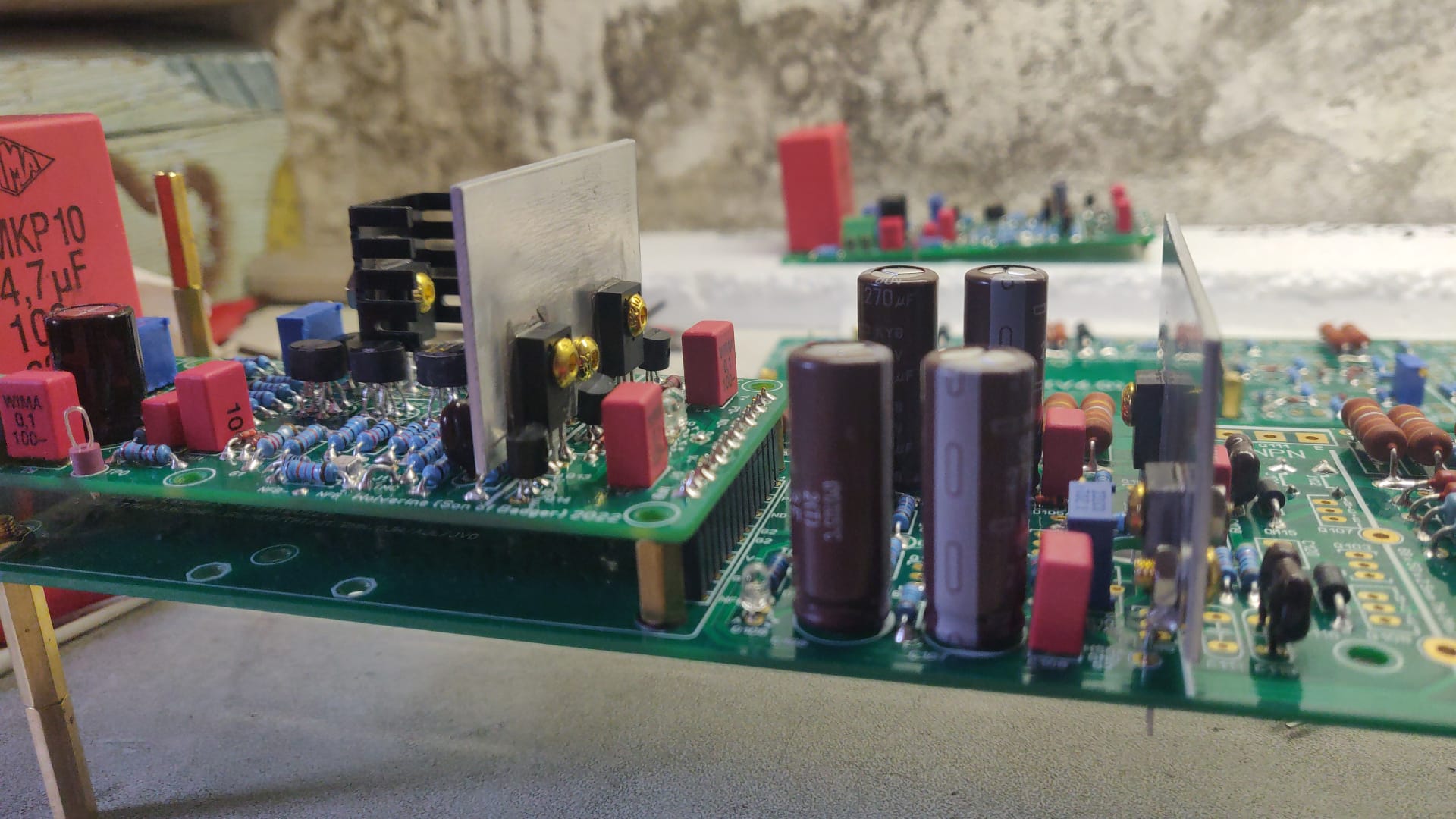

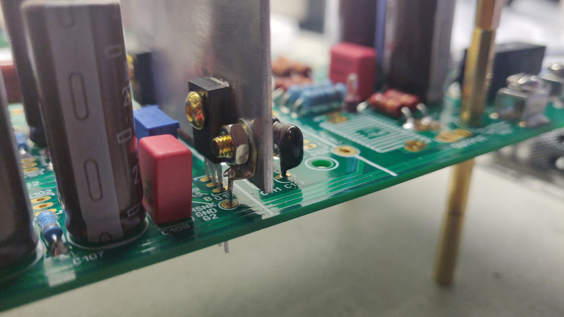

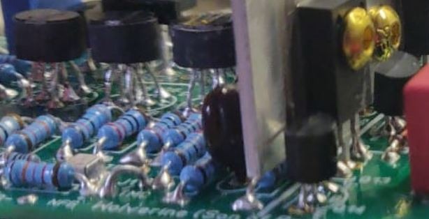

@wkloppen
Nice work so far, you might want to lighten up on the solder a bit, especially where those transistors are concerned. The topside there has some heavy looking flow. More is not always better.
It's a little hard to see, so I may be wrong, but it looks like a possible cold solder and then I pointed out a few, "I consider," a bit heavy. Please don't take this wrong, I have some brutal friends who tell me when they think something could be better and it helps me to improve. If anyone thinks, I'm wrong please chime in and tell me/him too.
JT
JT
thx JT for noticing...will have a close look. I solder resistors topside first then bottom. Transistors first bottom then topside. I might have overdone it a bit on the topside. Soldering iron is 370 degrees and I ttry to hold it and see the through-hole flow happening. Will check on the ones you mention
You might want to bring that temp up. People get hung up on a hot iron doing damage to components. It's true that can happen for sure, but it's more likely to happen from a iron which is to big/and, or on the component too long. The correct way, is hot, and get on, and off in a hurry. With the right temp, solder and flux, there is rarely a need to heat from both sides. An exception is, if you have a board with very small pad holes. This is not the case with the Wolverine, the team left you with more than enough hole diameter.
They did this, so you have choices of parts with larger leads, but this also makes it easier to flow smaller lead components, and to prevent the possibility to overheat, even if flowed from the bottom. Higher heat, for less time, is better than low heat, for a much longer time.
You got this, your work looks great, have a look at what Fireanimal did on his boards... the guy is a machine.
