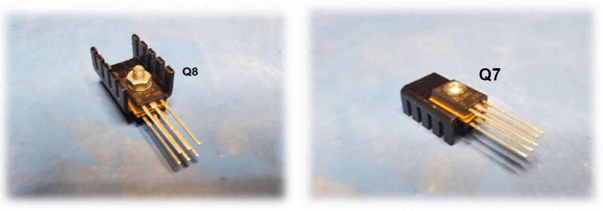

@STUART...been reading the new guide a lot last couple of days......quite an improvement I must say. I did find something which might put somebody on the wrong foot.
Q7 and Q8 markings on the pics should be swapped If I assume the silkscreen and the direction of the heatsink is leading on the PCB......

Correct, well spotted @wkloppen I'll update that later today. 🙏@STUART...been reading the new guide a lot last couple of days......quite an improvement I must say. I did find something which might put somebody on the wrong foot.

Hi Guy's,Q7 and Q8 markings on the pics should be swapped
The build guide is now updated.

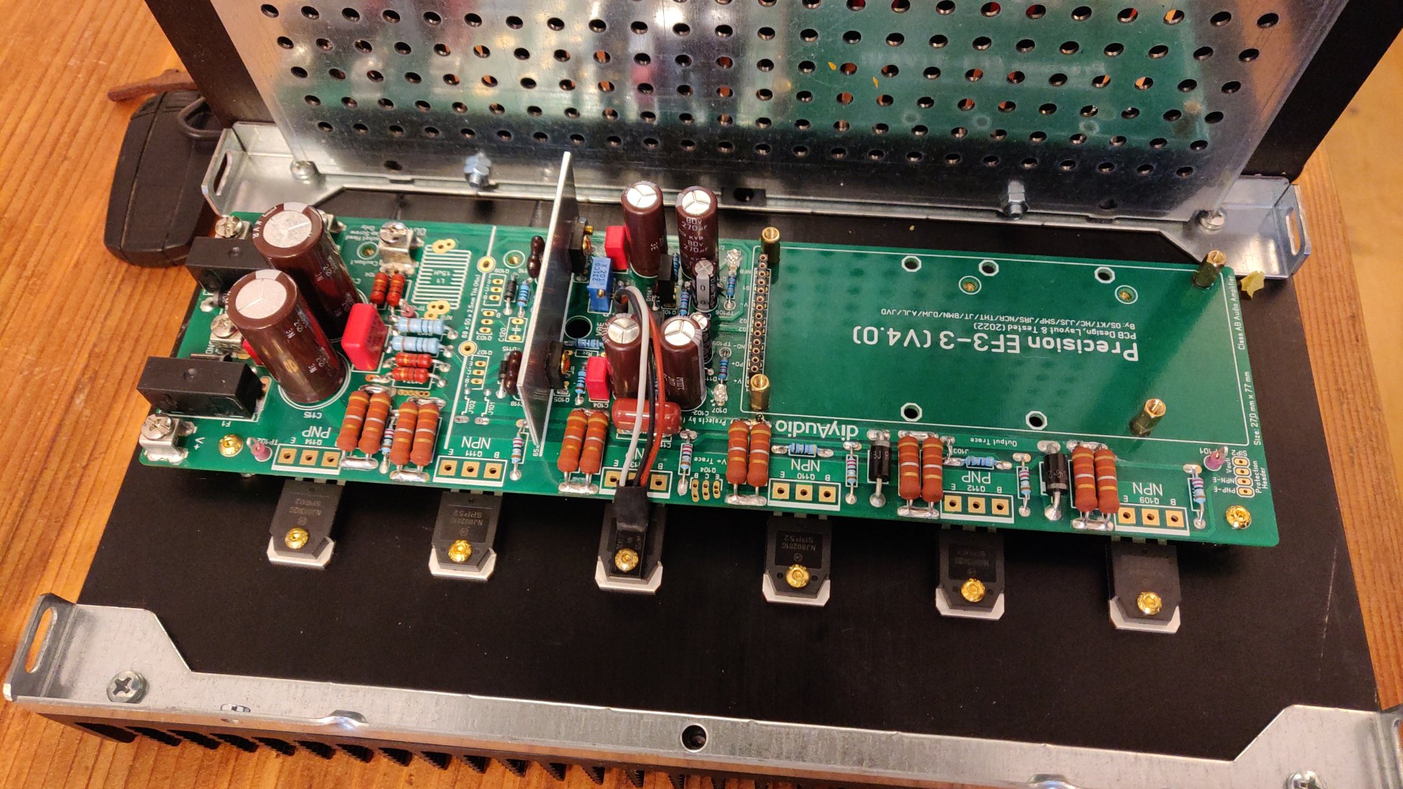

On the EF3-3 board, why do the jumpers J101 and J102 have to be installed on the underside (solder side) of the board ? Is it due to proximity of the drivers heatsink ?
