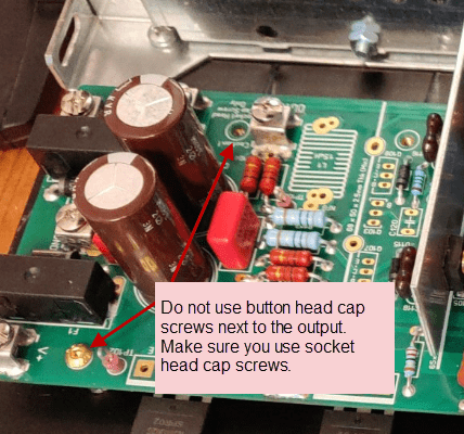

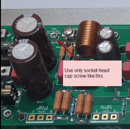

Yes. That's why the note is there on the silkscreen.Is that because of the proximity
"Caution, Socket Head Cap Screw Only"
You don't want the output shorting to ground.

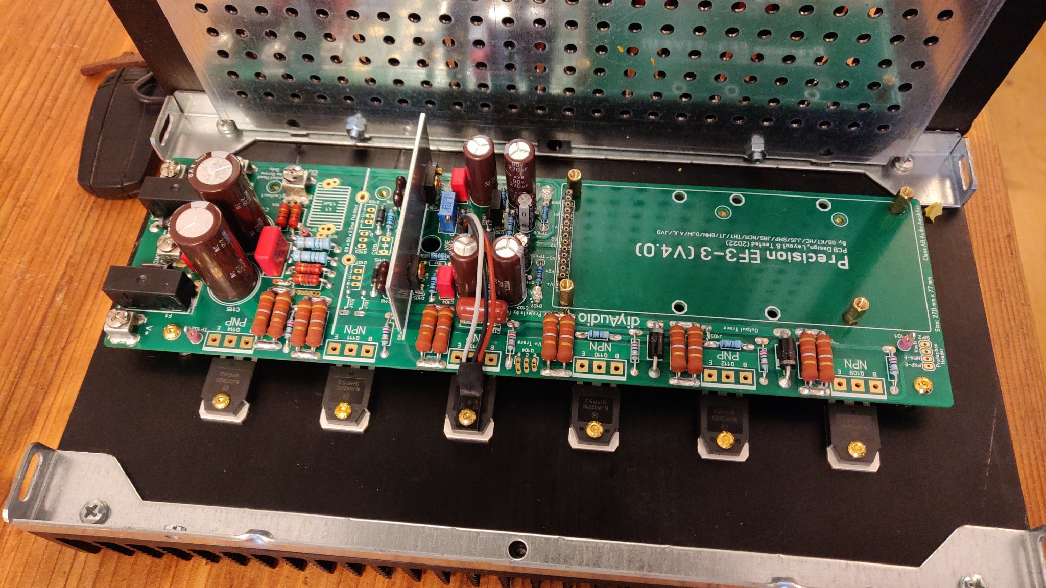

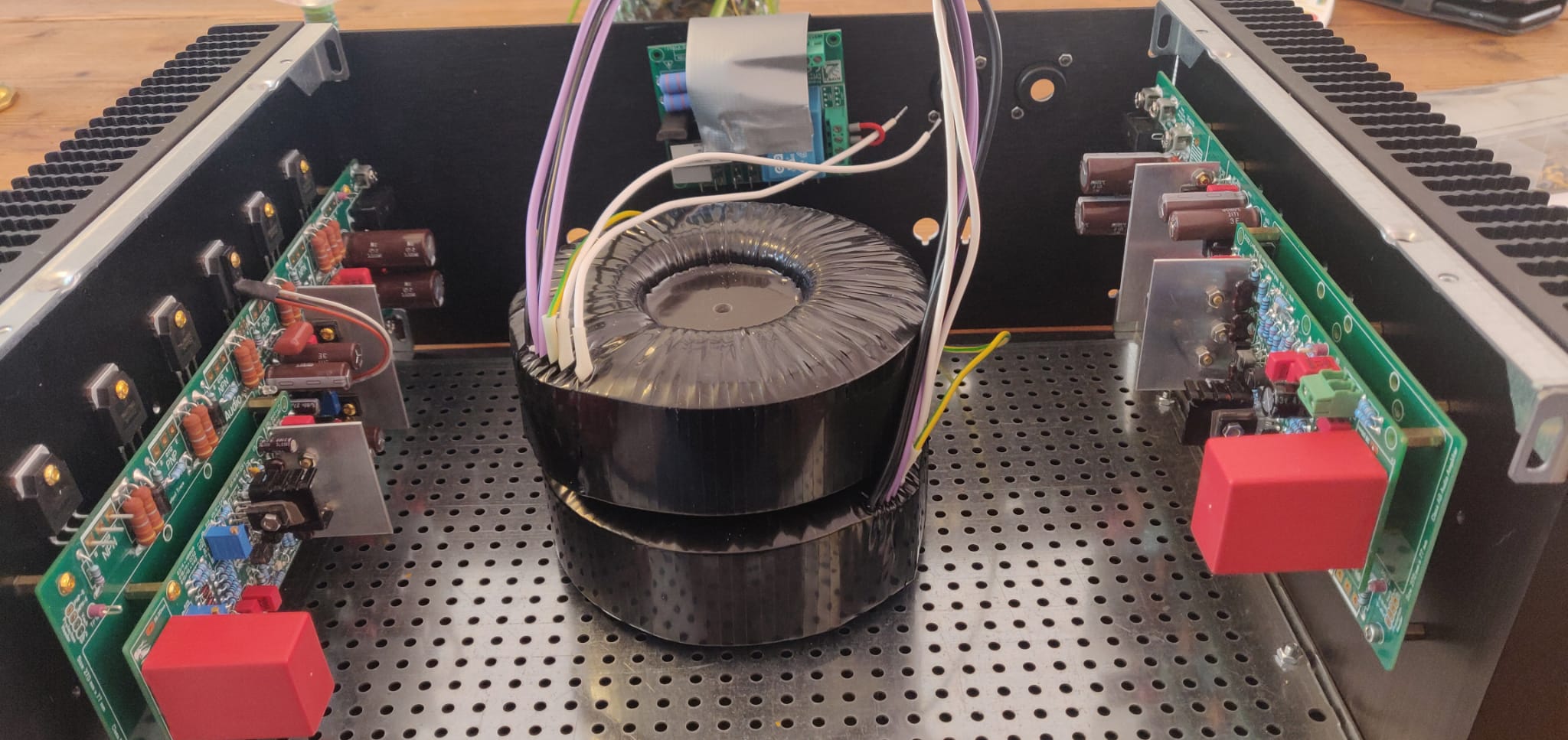

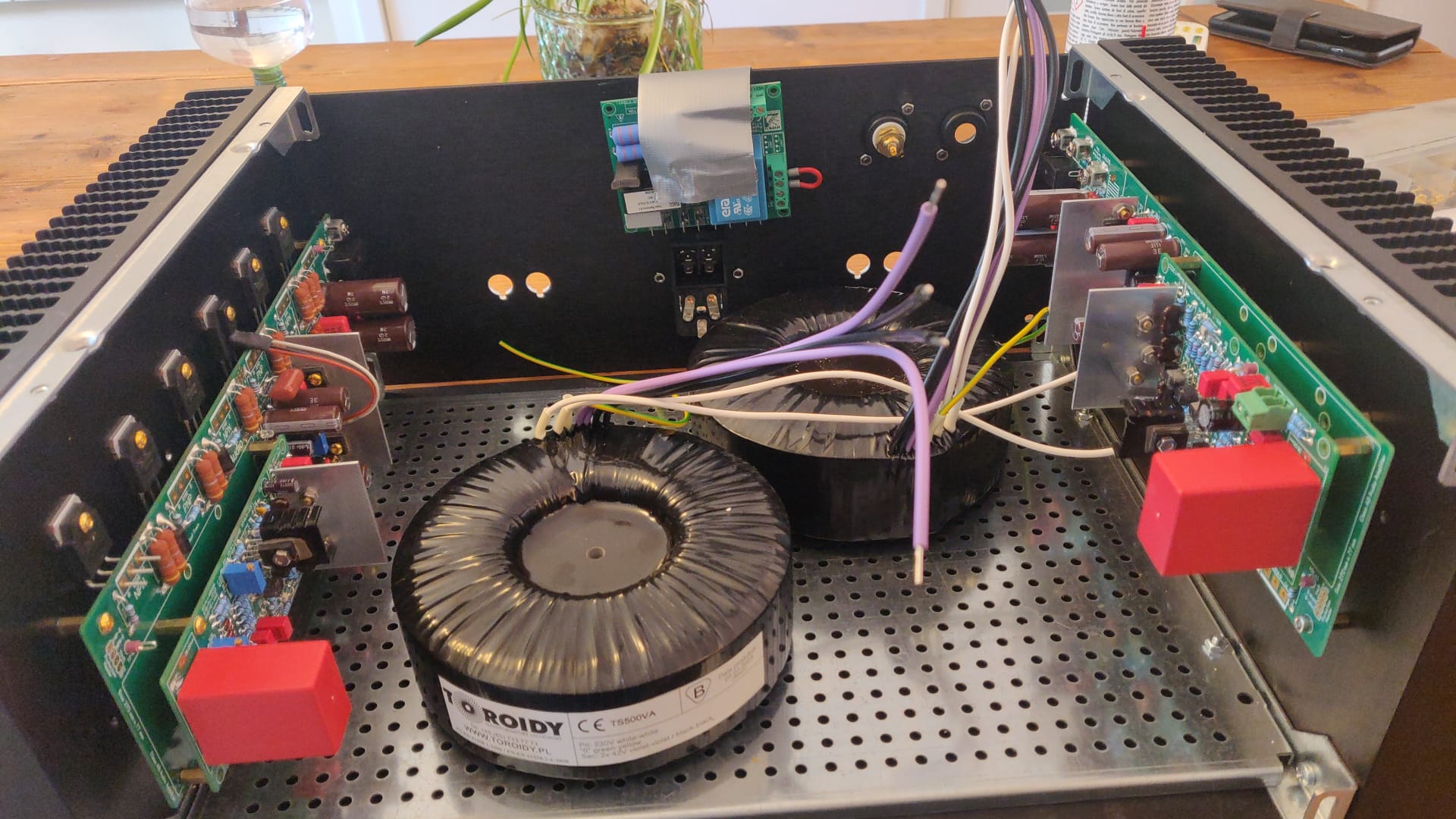

Hello Gents,
Soem chassis component placement question(s). i've read various posts including the docs in the Wolverine package and I'm not sure how to position the boards and transformers ideally.
I've got 4U 40x30 chassis and my first question is about boards. Do I place left and right upside down like on the pic or frontward backward? Second is the 2 transformers. Can't place them next to eachother as the width doesn't allow me to. Would ontop of eachother the best option or slightly sideways as on the picture?
thx in advance

Only problem with that configuration is that heat dissipation will be a little bit less efficient with the output transistors on the upper part of the heat sink. But I understood that with these large heat sinks there is no risk of overheating anyway.
I don't remember having seen anyone doing a build with all output transistors facing down. Somebody has pictures and feedback on how that works out?
This topic has been discussed in detail previously. I don't see the outcome of those discussions changing. Please review and follow those instructions to achieve the best outcome.Some chassis component placement question(s)
Yeah...you are right ofcourse Stuart and I did read a lot of them if not all. Its just my let say unsureness (if thats even english) that drives me to ask these questions.
