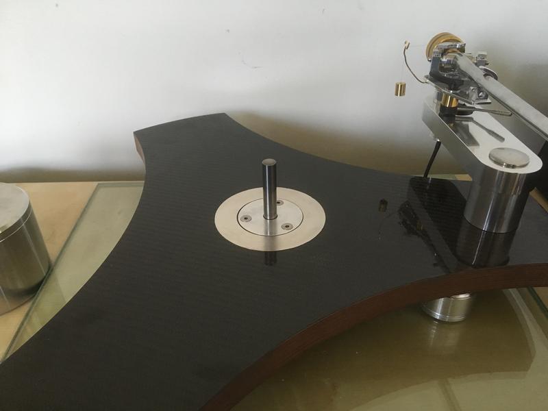

This is my present plinth.
It is just Panzerholz veneered with a very thing piece of carbon fibre which is added for cosmetic reasons only.
I chose to go with the single piece of Panzerholz after reading endless amounts on CLD and the damping factor of nearly every material under the sun.
Lots of other peoples choices seemed to ere towards aesthetic and not scientific in the end .

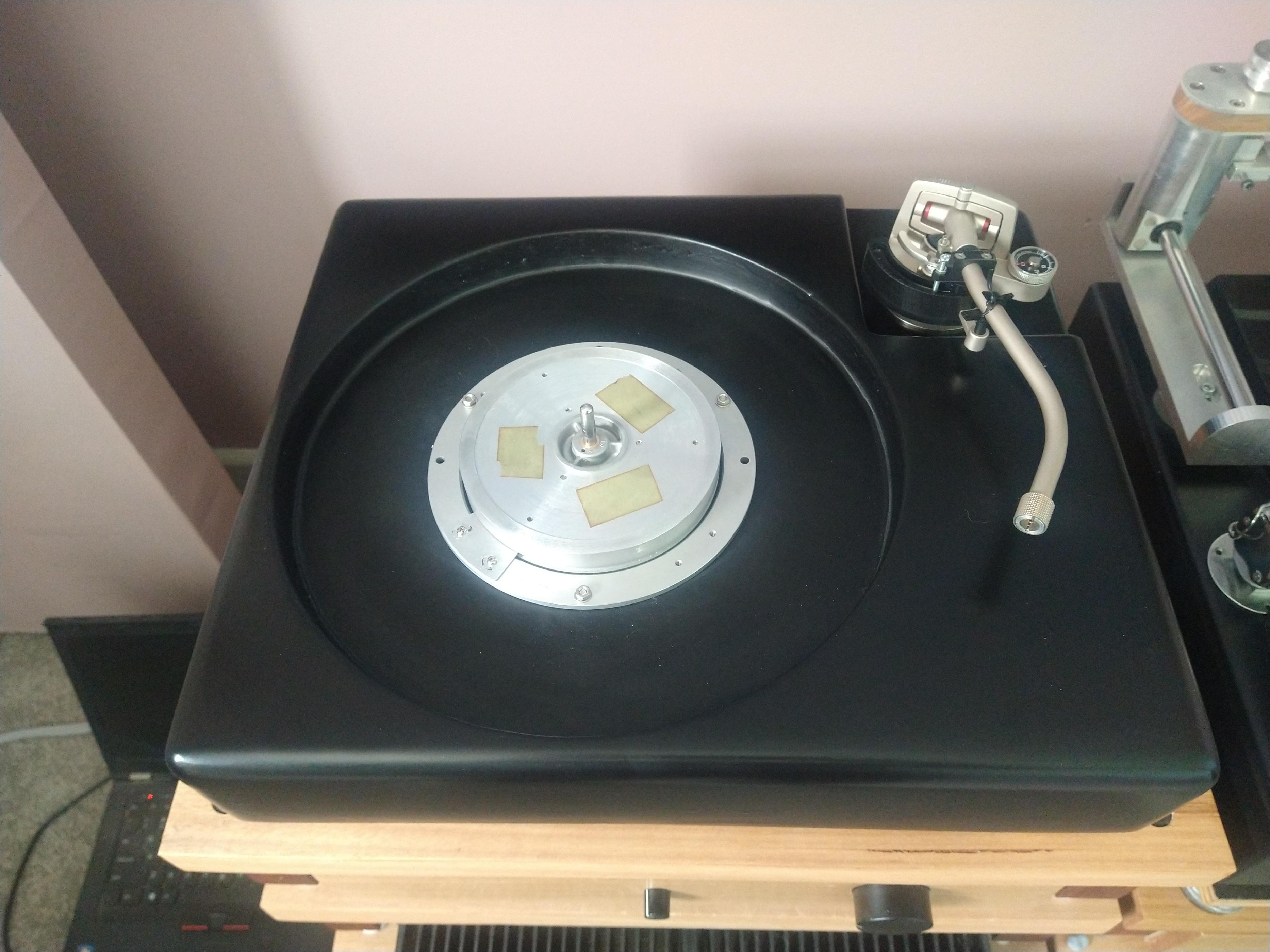

My SP10 is currently in a resin bentonite plinth and I'm in the process of building a tonearm for another SP10 and am thinking of building a plinth from MDF and filling with sand or more specifically garnet as used for sand blasting.
Forget Panzerholtz it's not available in Aus and Permalli is way over my budget at $2000 a sheet.
Wondering is anyone has tried a sand filled plinth?
If you don’t mind paying shipping from the UK I can sell you a plinth size piece of Panzerholz.
Thank you for the offer but a single sheet will not do the job I need.
A little background. The SP10 is highly modified, the motor is removed from the chassis and mounted directly in the plinth. In order to stiffen up the bearing/motor housing and have the platter recessed the plinth needs to be 80mm thick.

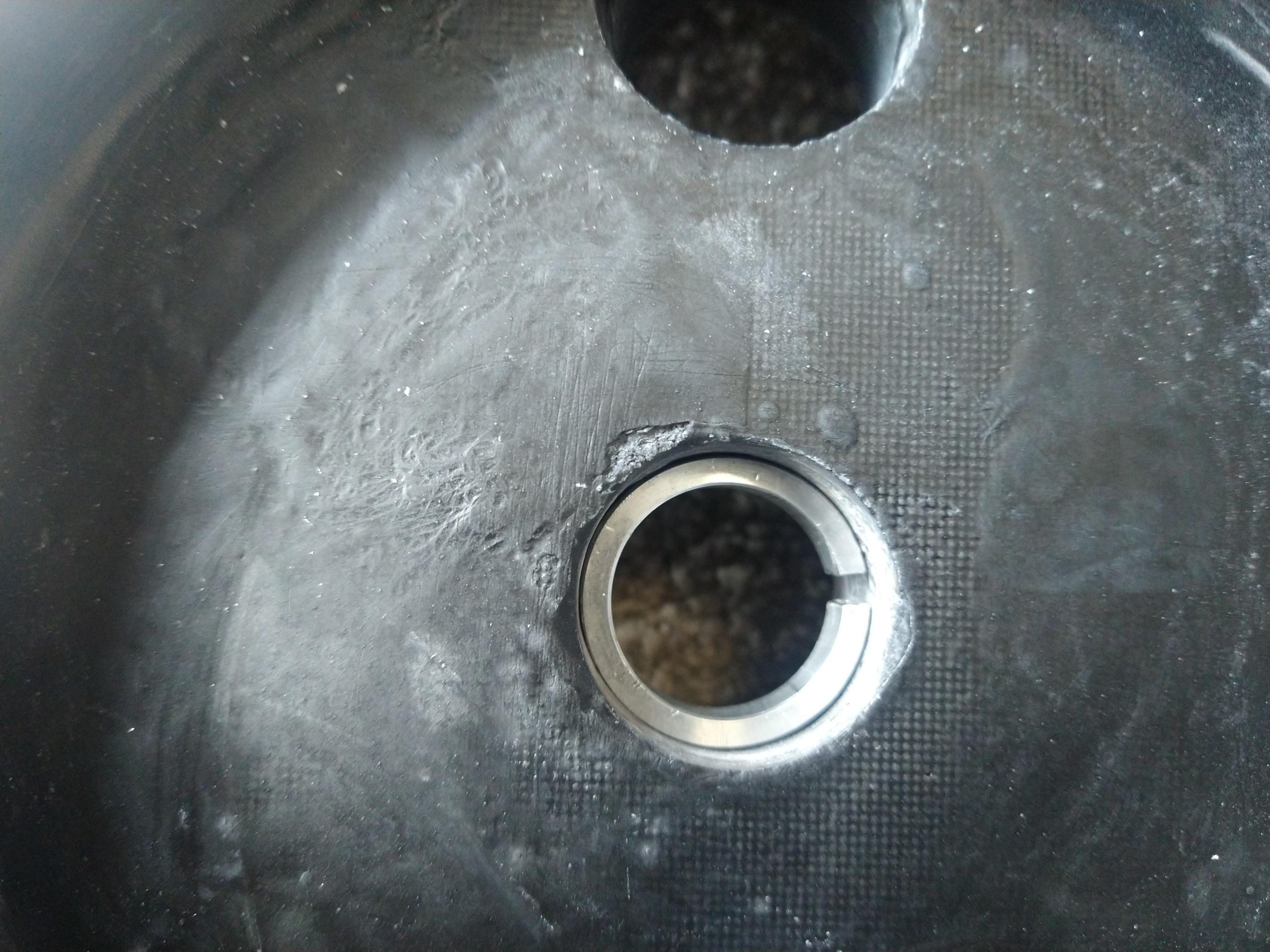

The second pic shows the collar and bearing recess. As the motor is bolted down the collar locks the bearing rigidly to the plinth. The bearing housing in this plinth is less than 10mm above the bottom of the 80mm plinth. There are other modifications inside the motor but they are not in the scope of this post.
I have built a couple of resin/bento plinths now and both of them warped requiring milling the top, bottom and mounting surfaces flat.
My thought was to build a plinth with acrylic/mdf/acrylic top and bottom plates. Machine an aluminium housing to hold the motor and arm pod fixed to the top plate then fill the entire plinth with sand. The theory is the aluminium housings with little to no damping would pass vibration to the sand to be damped.
I have searched for information on the damping properties of sand in TT plinths but can only find anecdotal evidence on it's usefulness.

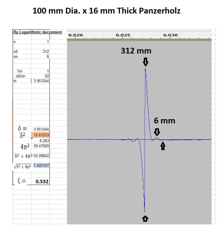

Maybe we should check that all is working by looking at something which has little damping, like a thin metal sheet or low damping wood or plastic. Here is one of ebony (much loved by audiophiles as it 'has damping qualities'). Really? Here's one I prepared earlier.
https://flic.kr/p/2kYHEjWEbony © cats squirrel
Note the exponential decay. Experiment with low damping materials until you are getting something like the ebony trace.
I'll say again, it is much easier to look at low damping factor materials than high ones!

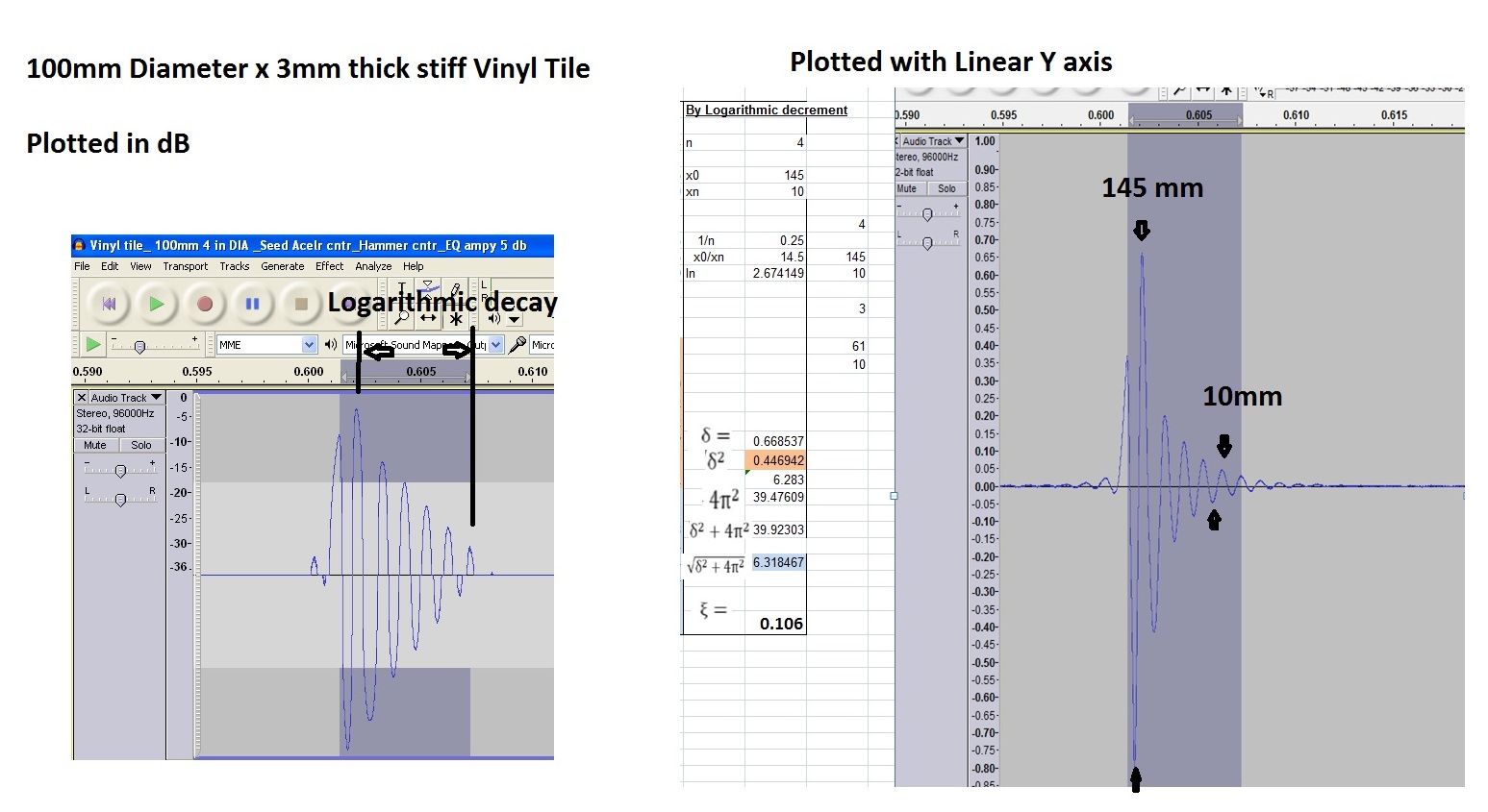

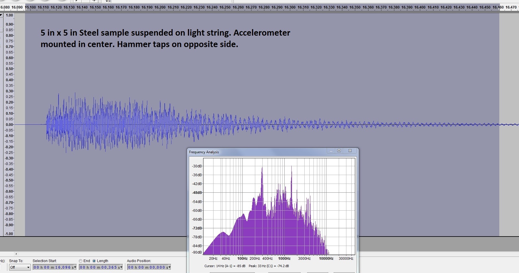

I found that one of the headaches is coping with all the harmonics and modulation. One of the screen grabs is a piece of 5 inch square steel. I also tried a round one (not shown here) and found it was much easier to interpret.
I've also attached a test on a stiff piece of Vinyl flooring 100 mm in diameter. Practically textbook waveform. Do you agree with the DF of 0.1 ?
The last shot is a 100mm Diameter x 16mm thick piece of Panzerholz. Is this the waveform I should be looking for? If so, does DF of 0.5 look right?
