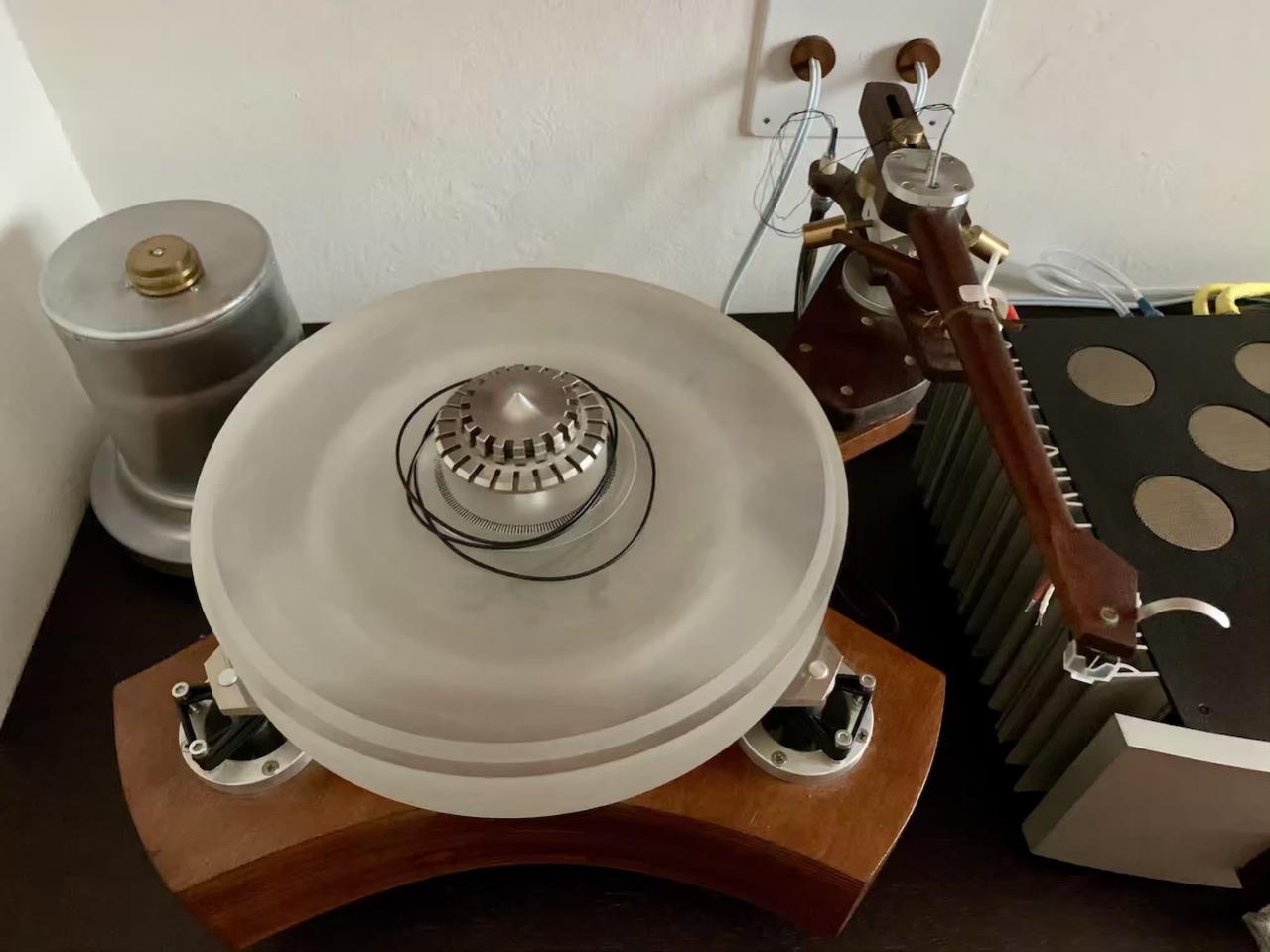

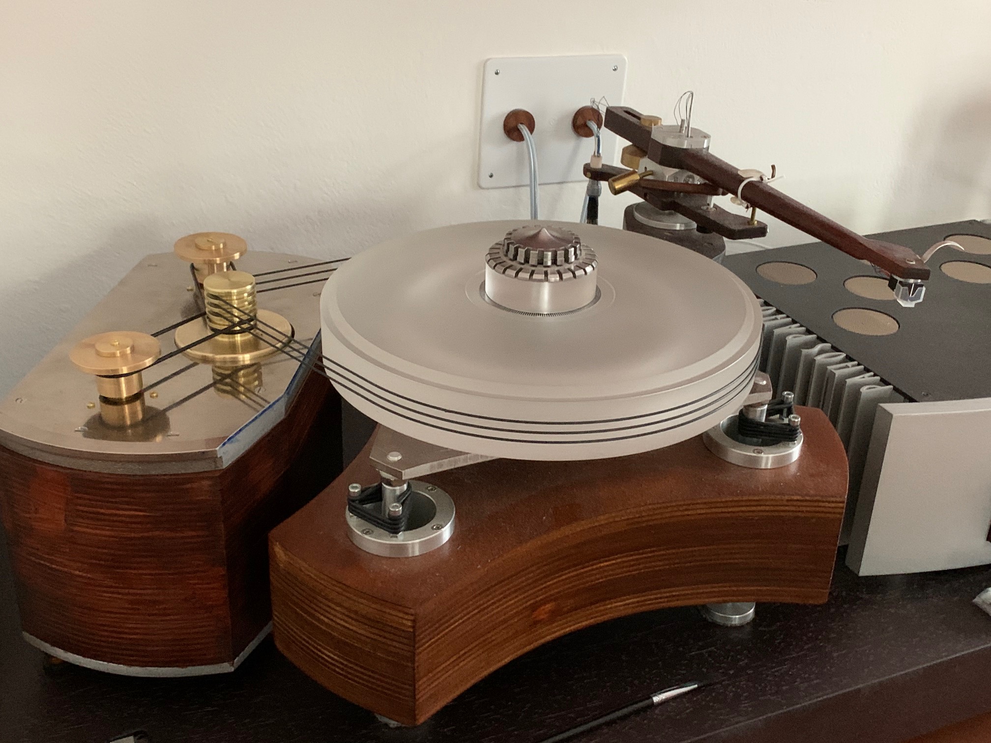

I know it is an old post, but I am somehow new on this forum.....
Unipivot Tonearm are very sensitive to any vibration may come from the TT, bearing, or motor as well. If there are some of these issue in my opinion better not to use unipivot TA.
I do not have long experience as had only 4 TT of which one is a Lenco still in its original state. I sold the other 2, one Thorens and one Pioneer.
However the TT I am using most is a floating type as the Lenco need some tweaks. The floating system was achieved by Mag Lev and there is not any metal to metal contact. If I knock in the plinth while playing LP I cannot hear anything and the unipivot TA track well. The Mag Lev system take care of the knocking. Despite the magnets shift their center, my construction was able to use a platter with 4.3 Kg, a puc 0.5Kg plus other parts weigh and the mag keep well centered.
I also have a a Jelco 750 L 12 inch and honestly speaking using my Denon DL 103 it sounds better with the higher mass DIY unipivot wood tonearm. But according to my listening in case in the TT there are some serious frequency problem or vibration problem the Jelco perform better than my unipivot. I personally would not use a unipivot in a Rim or idler TT.
Motor pod it is separated from the plinth.
I have 2 motor pods:
One with single motor spinning at 360 RPM, therefore the motor pulley is around 30mm ( similar to the VPI I think ) Next test shall be to use Mylar tape belt or 3 rubber belts.
One with 2 motors spinning at 360 Rpm and a fly wheel, the platter in this case is driven by 3 belts. For this motor unit I am still ion the way to improve, but I can definitely hear the sound difference when the TT is not spinning att he correct RPM, for example 33.1 Rpm or 33.2 Rpm. May be is due to the 4.5 Kg fly wheel and the 3 belts. To test it I use a laser tachometer on while playing LP.
Material of the plinth: I think that having a floating mag lev, the motor pod separated from the plinth, the plinth s material in my modest opinion and in my case is less important. However I used 5 layers of Birtch ply, 3 hard ply and 2 softer ( in the middle ) I also used leads glued in the softer ply part.
Bearing have the shaft 13mm highly polished, 5 mm sphere and thrust plate, House of the bearing is made by one piece solid bronze with oil lubrication, tolerance pretty tight, when I change the oil the bearing takes long time to lower. The floor noise I consider very low ( by listening ) , I do not say is not there as I believe every bearing with thrust plate have some.
Platter is a 47 mm thick acrylic purchased from Scheuanalogue long time ago, outer diameter 320mm so better inertia compared to other platter that have smaller outer diam. What I like of this platter material is that either heavy LP ( 180Gr ) or lighter LP they both sound very good provided the tone arm hight is set well. The short coming is that with this platter material it is needed a puc, mine is 500 Gr.
For the tonearm decoupling from the aluminium plate I used Mahogany wood as I think this wood has good sonic characteristic and sound not too bad. Easy to work and to purchase. I treat it with some oil and wax.
Could I change something in this TT?. Perhaps the aluminium plate that have a sound proof treatment at the bottom where the bearing is fixed, but I do not have floor noise or vibration from the bearing so I am not planning to do anything to it. I forgot, I use thin bearing oil and I added Cera Tec 6%. I know is for cars, but I am testing it and since my bushes are not sintered type I think I can use the additive. My fly wheel using Cera Tec has increased the RPM 1% when bearing was cold ( I believe the Brinkmann concept to heat the bearing therefore keep a steady bearing s temperature and be able to use tighter tolerance ) Loosen bearing loose record informations....
Anyhow I see that lately most of the TT are not floating type and seems such type of TT are slowly disappearing. Pity I think.
Tks n rgds
Adelmo
one thing to bear in mind (remember). When one isolates a structure (such as a turntable) if there is any energy (vibrations) reaching the turntable, as it is isolated, it must deal with the vibrations itself. For example, a Linn LP12 type of construction uses springs to isolate the turntable from the plinth/support. But what is left is a platter/bearing connected to thin metal, to which a thin piece of mdf is connected. No wonder it has a 100 Hz hump! Same thing with a Lenco, unless measures are taken to damp the top plate, one is no further forward!
So if one isolates, one must take measures to damp that which has been isolated. After-market parts go a little way to solving the problem (i.e. thicker metal!)
The bearing fitted in a 10 and 20mm triangular aluminum, in the bottom of it sound proof treatment.
Tonearm support fitted with 3 brass bolts to the aluminium, made of 2 layer of solid wood decoupled by 4 tiny brass post.
Floor noise very low I hardly can hear.

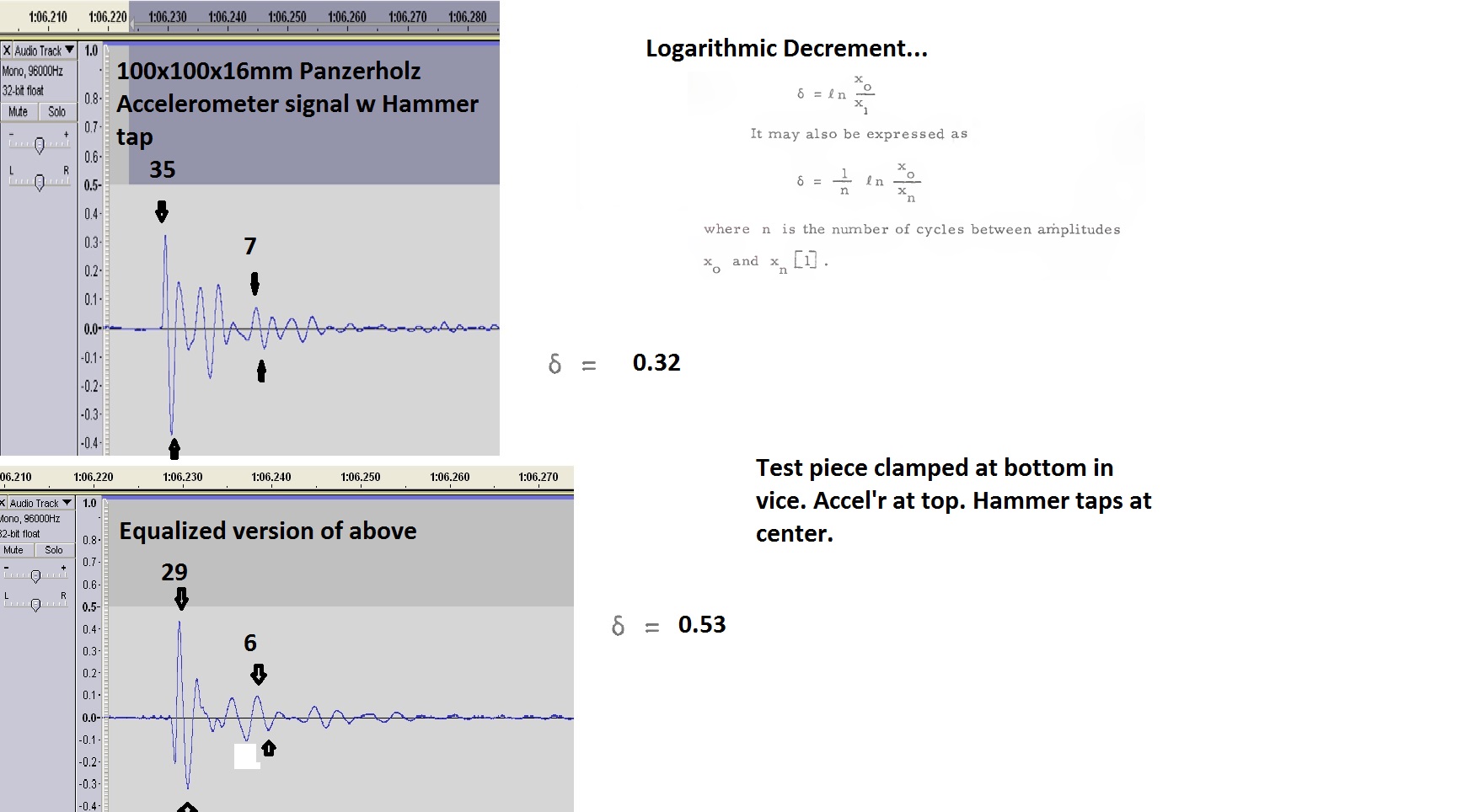

Test method or Lively Panzerholz?
decay rate, for a particular material, should be independent of size of test piece. Something which may make a difference is how the test piece is mounted, and what is at the boundaries (edges). Common boundary conditions include clamped (C), free (F) and simply support (SS), although others exist. For plinth duty, either C or SS are common. Each edge is considered, so that a panel (plate) may be only one of these, or a combination of two or all three. The results for C and SS will be very similar, FF will not.
Hi Cats Squirrel,
I think you're right. My test method is lacking. Here's another where I clamped the sample and gave it lots of little shots with the Jewelers Hammer.
It's a 100x100x16mm piece of Panzerholz. How do these pulses compare to the ones when you tested?
Thanks,
Hugh

remember, I'm trying to help 🙂...
your biggest problem is that you have clamped two edges. This will change the results. Stick a sturdy pin in one end, and suspend the test piece (do not hold the test piece!) Attach the accelerometer to the centre of the test piece with tape, and tap the other side to the accelerometer (also in the centre). Do this about 8 times, and discard the ones that do not look good (because the hammer hit the test piece at an angle, for example).
Look at the waveforms, and choose those which present an exponential decay of amplitudes if using a linear scale, or a straight line decay for dB scale. The latter is useful to check on exponential decay, but use linear scale for calculations.
HTH

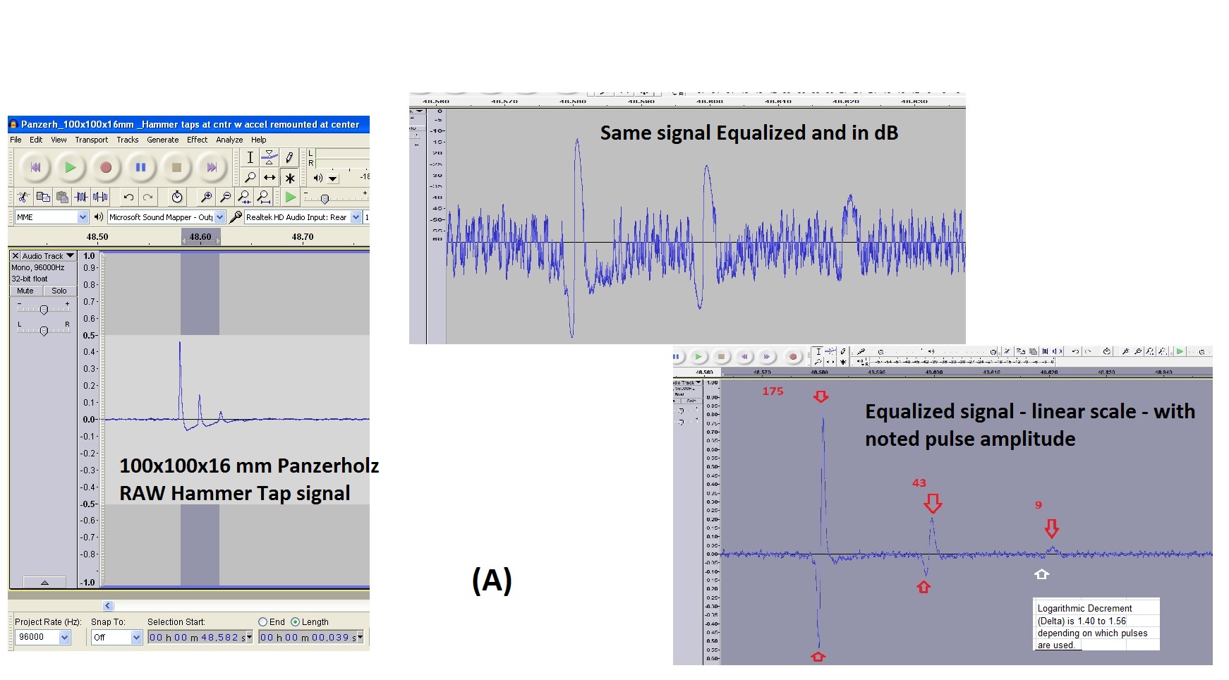

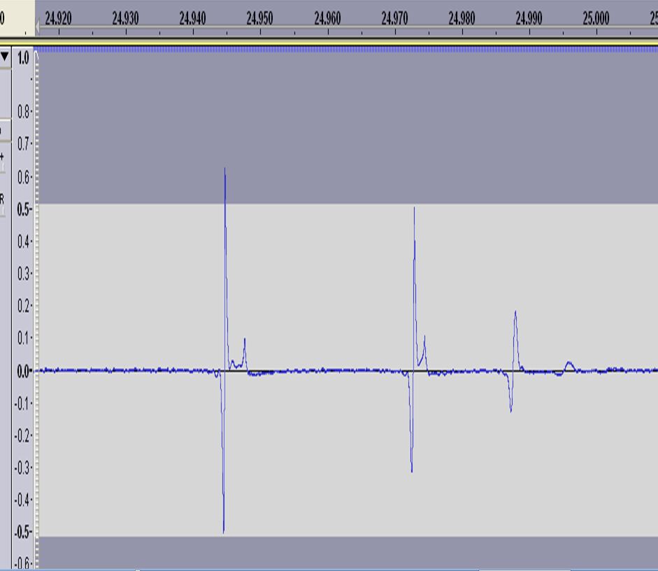

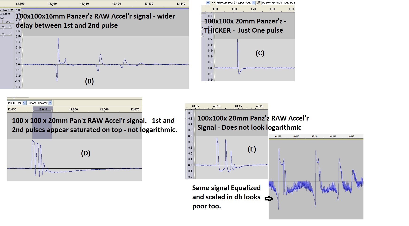

Hi Cats Squirrel,
I have to confess that I'm puzzled by what I see in these shots.
(A) in the attached is what I thought might be a good one. When I Equalize and display in dB, each pulse seems to decay by a steady amount.
Is this what I need? Are we looking at acoustic echoes of the initial pulse? Or did I just capture the Hammer bouncing repeatedly on the surface?
In the second jpg (B through E), I added screen grabs of other pulses that seemed to have problems.
Hugh
I reiterate, I am here to help you!😉
Those scans do not look good. I would expect something like this:
damping ©wiki
I expect something like it, but maybe not quite so perfect.
Maybe we should check that all is working by looking at something which has little damping, like a thin metal sheet or low damping wood or plastic. Here is one of ebony (much loved by audiophiles as it 'has damping qualities'). Really? Here's one I prepared earlier.
Ebony © cats squirrel
Note the exponential decay. Experiment with low damping materials until you are getting something like the ebony trace.
I'll say again, it is much easier to look at low damping factor materials than high ones!
