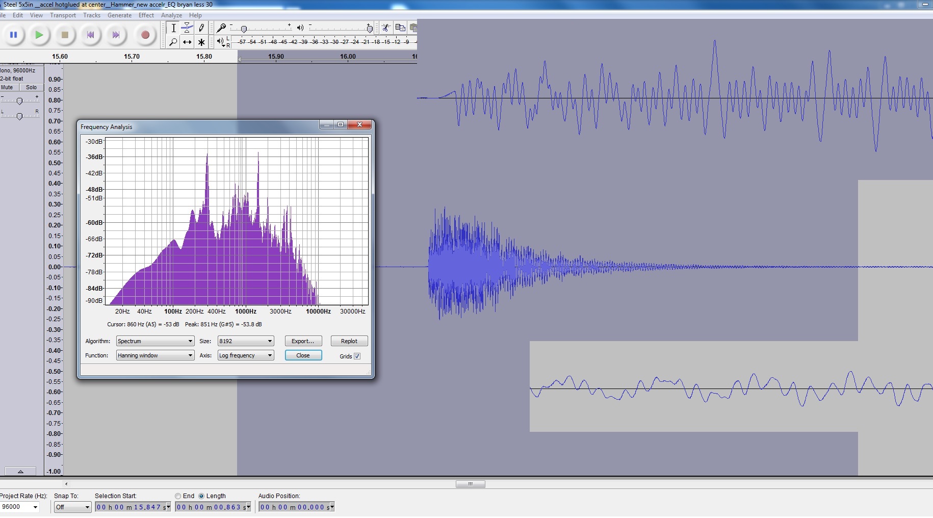

I found that one of the headaches is coping with all the harmonics and modulation. One of the screen grabs is a piece of 5 inch square steel. I also tried a round one (not shown here) and found it was much easier to interpret.

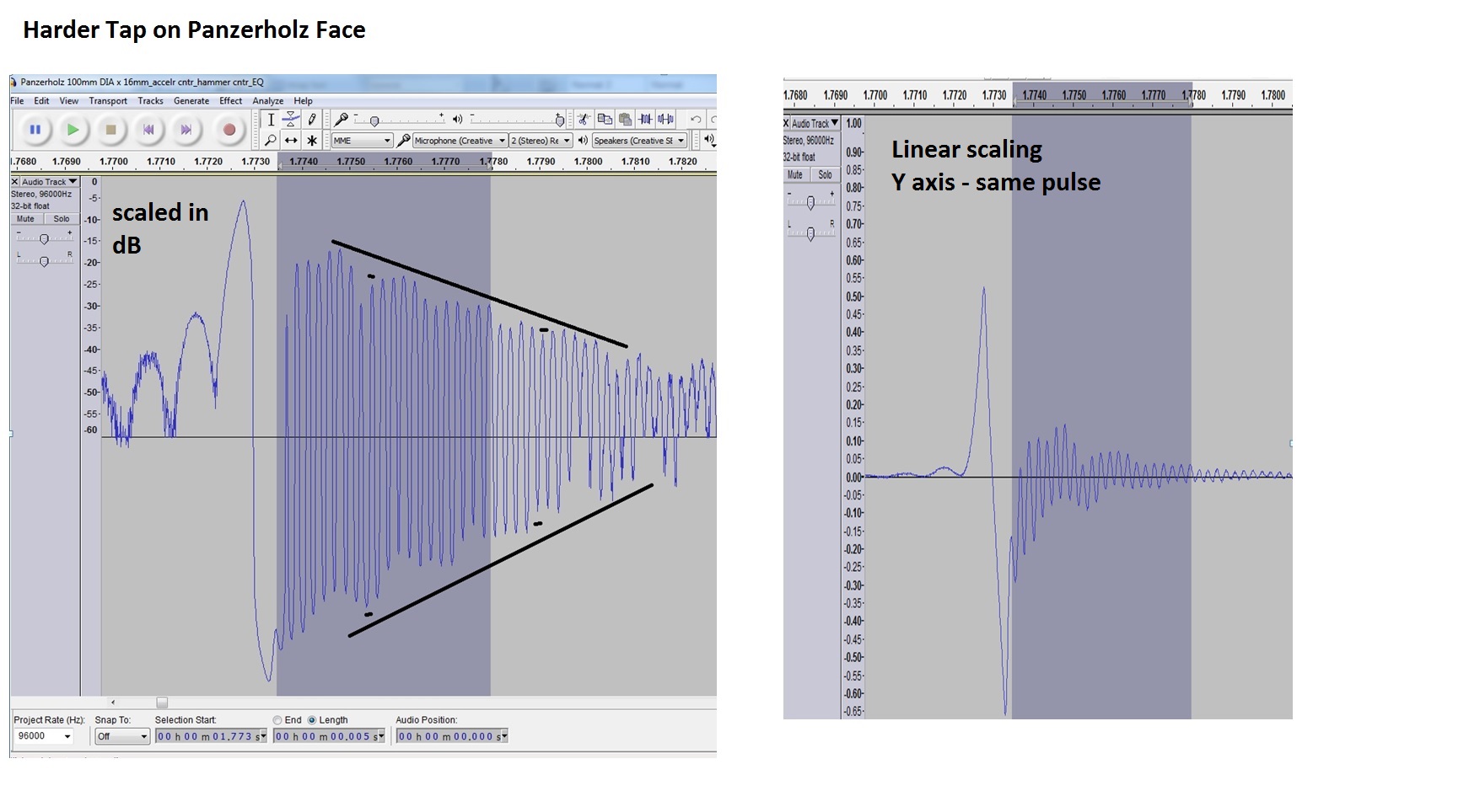

The last shot is a 100mm Diameter x 16mm thick piece of Panzerholz. Is this the waveform I should be looking for? If so, does DF of 0.5 look right?

Regarding the steel panel (plate). There seems to be a lot of noise. Any ideas why? do you do any software filtering? Do you correct for the CR filters on the accelerometer board. Can you post a graph of the filter you use to compensate for the loss of higher frequencies from the CR filters?
There is something wrong with your Panzerholz waveform. What was the resonance frequency?

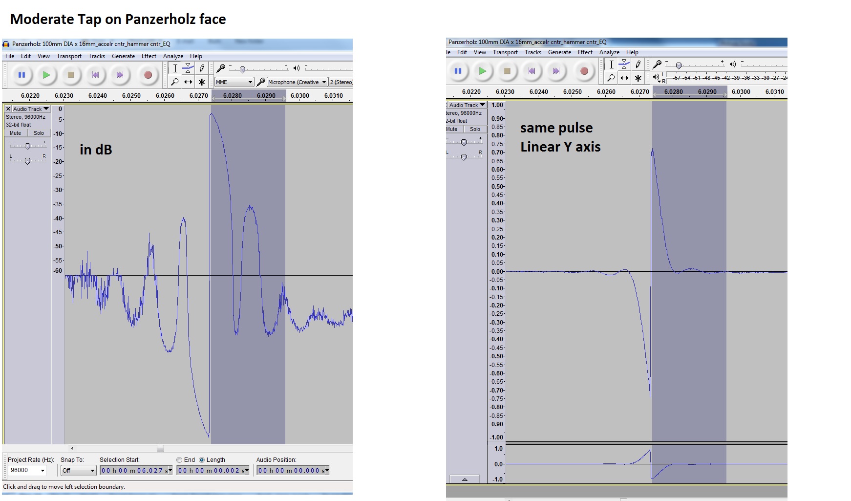

Cats Squirrel,
I'd say the resonance was about 1000 hz. 2 cycles take about 0.002 seconds. Here's another jpeg of that same impact with scaling in db, then linear.
It seems that with a very light tap, I get an even smaller pulse with no ringing at all.
If I go slightly harder, it rings at a higher frequency - 5 khz. I've uploaded an example of this. Is it any good? I get a very, very low DF from this one.
Do you have a good example of typical Panzerholz damping that you could post? It may be easier if I have an idea from that.
Hugh

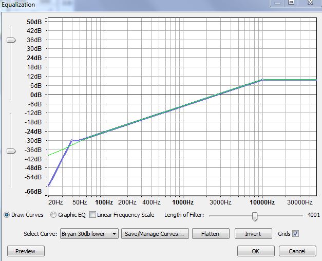

Here's the graphics for the Equalization. It should be 30db less than what you recommended (unless I got sloppy again). I don't think the literature for the two Accelerometer boards I have actually say what's in them for RC filters. I'm just assuming it's the typical 50 hz corner frequency.
I should have posted different levels of zoom for that 5x5" steel piece, so here's another picture with a few extra pastes. Lots of modulation. It was a very thin, light piece. I'm think the mass of the accelerometer was enough to muck up the resonances.
A heavier, round piece gave much cleaner results. Vinyl and Acrylic even better.
Hugh

Hi Hugh,
damping factor is an intrinsic property, as is density. This means that it doesn't matter how much there is of a material, the answer is always the same! So it doesn't matter if we measure a 1 cm cube of steel, or a whole ship, the density will be the same (assuming the same steel, and only steel!).
The problem with using round samples of a material is that of ringing, that is, self reinforcement of resonances.The resonances leave the point of excitement, and travel around the sample in two directions, producing a complex (modulated) waveform. Use a sample of material which is square, or better still, rectangular, and of a mass that is at least 10x that of the accelerometer.
Here is my equalisation graph:
![](https://live.staticflickr.com/65535/51208927953_f272d047f4_z.jpg)
Just remind me why you are using -30dB. My accelerometer feeds into my sound card (M-Audio Audiophile 24/96 Rev B). I still think there is a lot of noise on your traces.
Cats Squirrel,
Earlier on, when I equalized, I got the red clipping marks on some signals. This doesn't seem to be an issue with everything reduced by 30 db. Audacity is in 32 bit mode, so I'm hopefully not loosing any resolution.
If a signal ends up getting too small, the "Amplify" feature does a nice job at bringing it up to a usable level without clipping. Sometimes it's just a few db. Soemtimes as much as 12 dB.
Hugh
