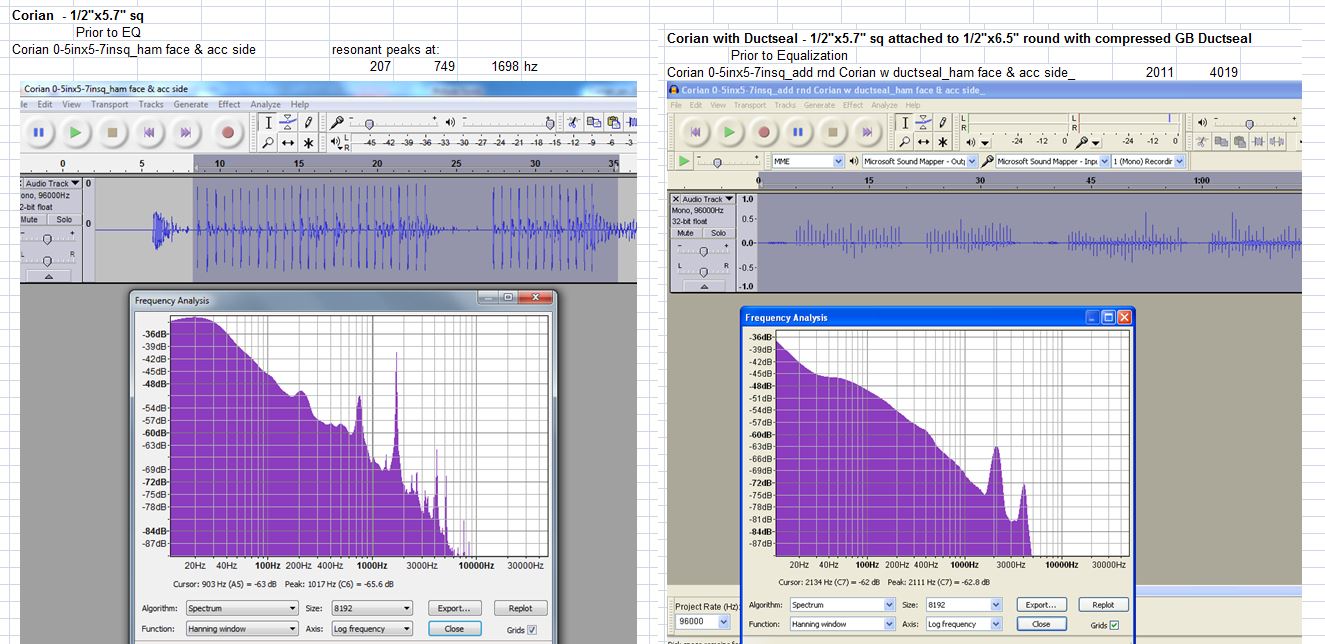

This one shows a 1/2" x 5.7" square piece of Corian on it's own (left side). Note the resonant peaks at 207, 749 and 1698 hz. I'd say the last two will have very low damping.
For the chart on the right, a round piece which I had on hand is compressed via Ductseal to the square one. The added stiffness has raised the resonance (now 2011 and 4019). The more rounded peaks suggest better damping.

Thanks Hugh, i am not familiar with these plots or their interpretation, does it demonstrate that Corian/Avonite might be a good or poor start point please? - how does it compare? - for a while Corian was thought to be a good start point.

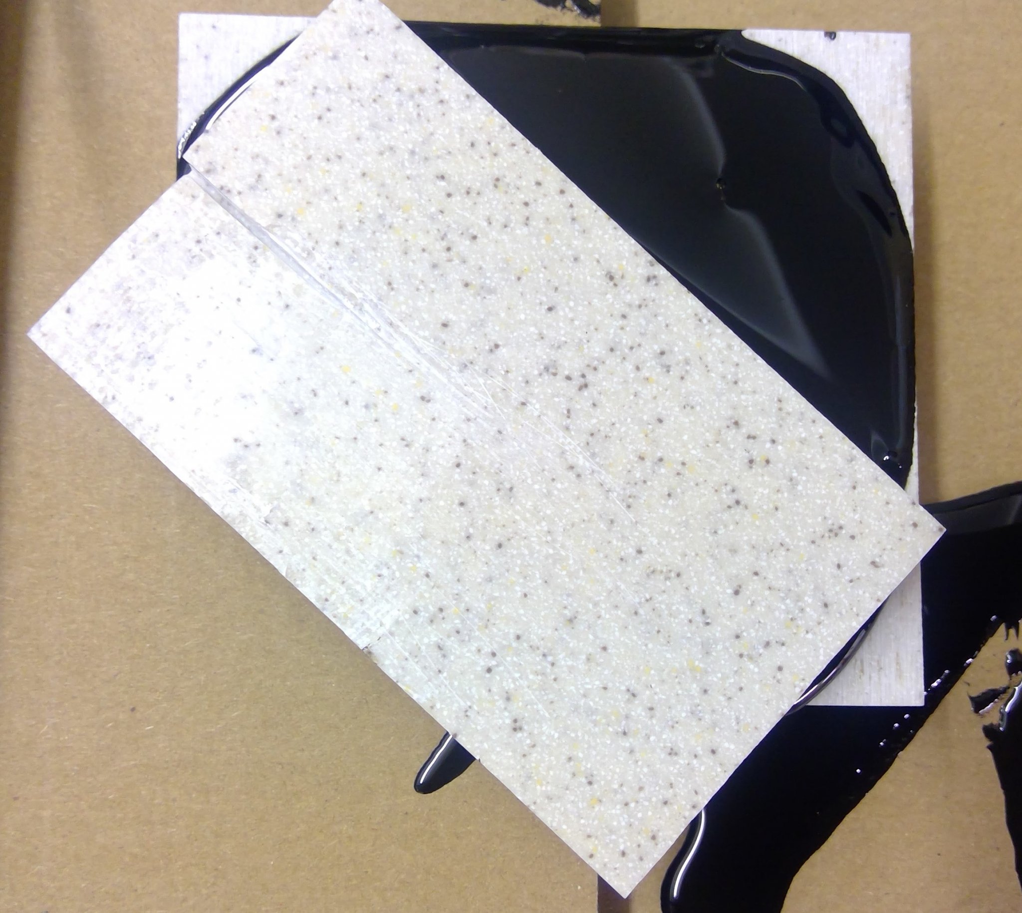

Meanwhile i "dolloped out" some bitumen glue to see what i have, to be honest the smell/volatiles wasn't so bad as the warnings!
It stays liquid a couple of hours and starts to set, question is, is it a V.E. layer at the end, do i aim for a couple of mm? i could fence the edge of the avonite, level it and make a pond before adding the second sheets, i see it as quite practical if its a sound idea!

As a starting point, Acrylic seems better than Corian to me.
I do not know if Bitumen acts as a VE layer. The volatiles may also damage the plastics in your Avion. I managed to soften the rubber surround of an expensive speaker years ago using roofing Bitumen inside the cabinet.
I would guess that Ductseal, Greenglue, modelling clay, etc. definitely have that "lossy" action and some may be considered as VE. Not sure.
Whatever you use, I believe you want a THIN layer in between to optimize the CLD effect.
Hope this helps.
Hugh

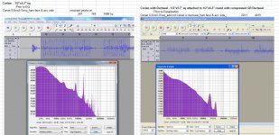

You got me wondering why I never tested any Corian. So I did. It'll be quite a while before I calculate any DF numbers, but these charts show part of the story....
This first one is a large 1/2" (12mm) thick piece of Corian. It's resonant frequencies will differ a little from your big pieces of Avion, but you get the idea.
Hugh

By the way, I posted that chart to show how a panel of Corian resonates. But, I don't know much about what actually arrives at the stylus. I'm sure there's some some way to measure that before and after you damp your Corian.

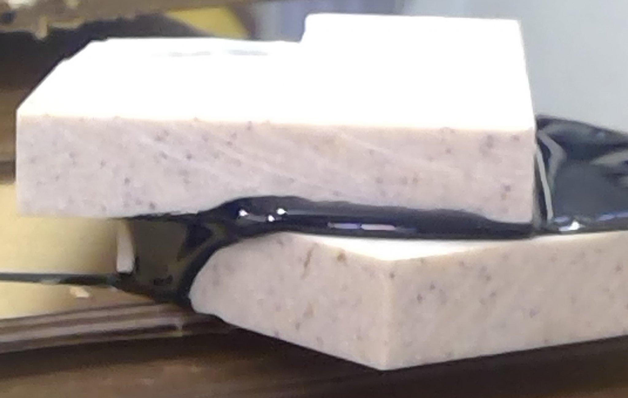

The roofing glue seems to have promise if its visco-elastic, its easy to get a thin coat, more difficult to get it thick, would 0.5mm be suitable?
Which might be best, with the MLV layer or without, i have all the parts, its just decision time!? as you can see it flows out flat fefore it goes off, like self levelling compounds so if i achieve a boundary, then pour it in, leave an hour or so and add the next layer it should do something!
24 hours later we can see whats happened!

Are those test pieces in the photo? I wonder how well the Roofing glue will cure in the middle. I had that trouble with Green glue and Acrylic. I had to drill some through holes to let it cure. It still took a month!
Some combinations seem to do well as 3 layers, some don't. I suspect Avonite/MLV/Avonite won't be any worse than Avonite/Avonite, so I'd be tempted to go with the 3 layers. Except now I'm thinking the Bitumen may damage the MLV.

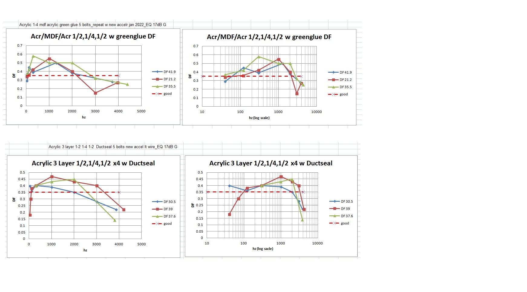

About a month and a half back, I posted some charts indicating that Acrylic/mdf/Acrylic was not damped as well as 3 layers of Acrylic.
Here's an updated comparison. They look similar in the attached. This time, I fussed over which hammer taps I selected. It seems to be harder to get good ones on the Acr/mdf/acr combo.

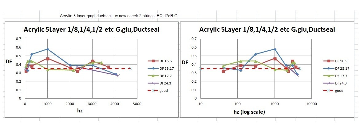

Here's one I like even more than the two above. It's 5 (4"x4") layers of Acrylic, 1/8", 1/4", 1/2", 1/4", 1/8" thick. It's green glue for 3 for the inner elastic layers. It's GB Ductseal for the outer 2 elastic layers.
This combo seems like it extends both the Low frequency and High frequency Damping factor. This may be the combo for the full sized plinth.

Yes, pieces to see how it looks and feels.
i agree, logically it seems the volatiles must need to get out, but roofing felt wont let them out either?
Also, whilst roofing felt is not MLV its a similar substance............
I had better try it and see!

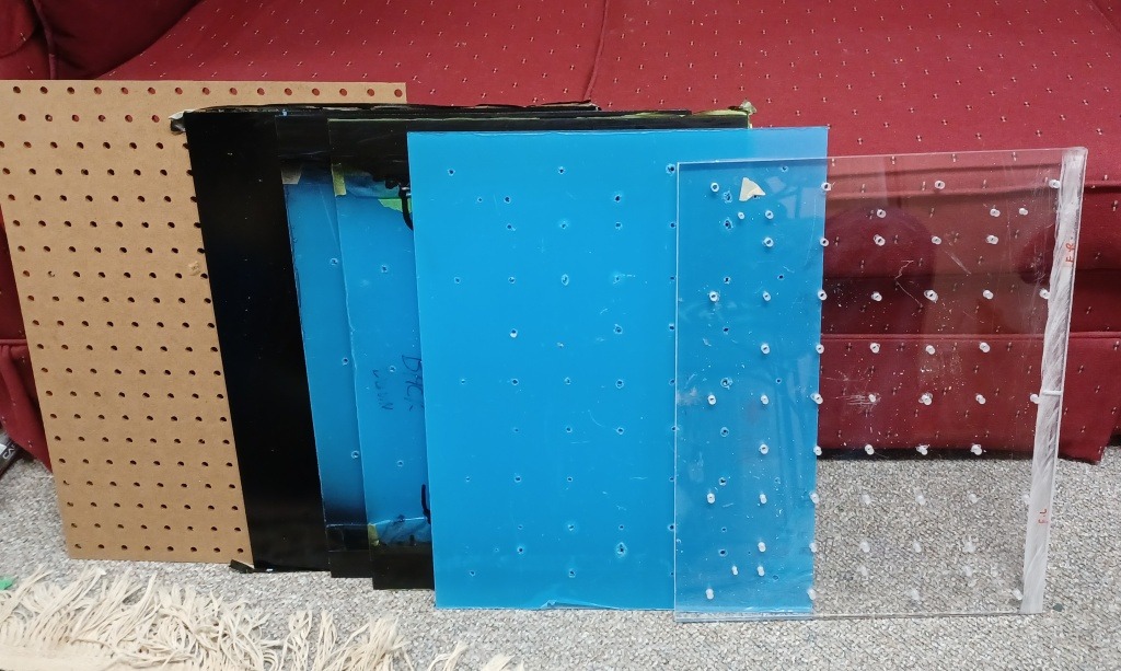

I spent several hours drilling holes in my sheets of Acrylic. Half of them are for Nylon bolts, the other half are to allow the Green Glue to cure. I'm wishing I'd tested other VE materials (see below), but sticking to what I'm sure of.
Paddy1 suggested a 3M tape in post 434 that sounded good, It also seems to be available in 12"x12" sheets from Digikey.
This Butyl tape combined with some contact cement may have had possibilities too.
