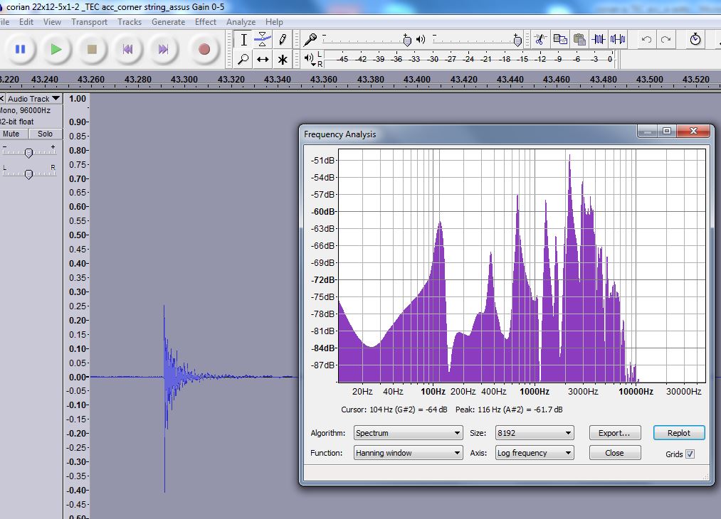

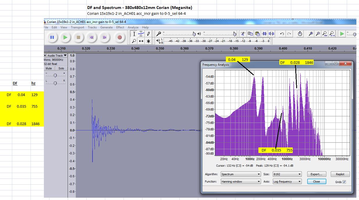

Here's some Corian tests...
The first picture is a Shelf sized piece - 560mm x 320 mm x 12 mm thick. There's a big resonant peak at 100 hz and many others above that. I didn't test, but they will all surely be poorly damped. (If this had been 24mm thick, I expect most of those spikes would be higher in frequency.)

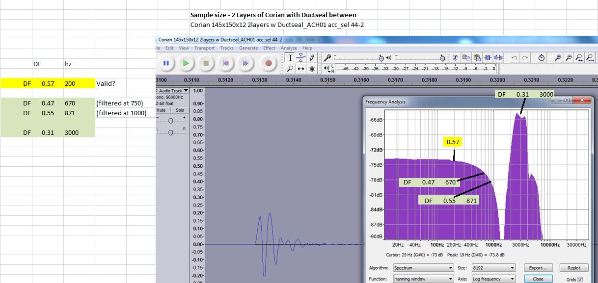

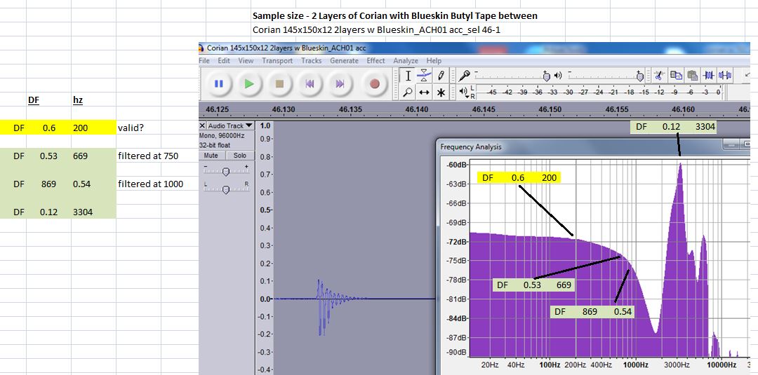

The second pic is a sample sized piece - about 150mm square x 12 mm thick. Much simpler eh? There's a peak at about 750. I measured the DF at 0.27 . Then there's another sharp peak at 1706 hz. 0.028 DF for this one.

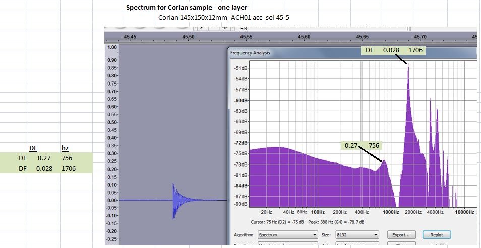

The 3 rd picture is two layers pressed together with GB Ductseal blobs squeezed flat. The sharp peak is now a broader one at 3000 hz. DF is now 0.31. A few spot checks at lower frequencies look very good.
The 4th picture is two layers of Corian with 0.38 mm Butyl tape in between. (Contact cement was used on one side - this is not a double sided tape). The peak is now at 3304 hz. It's DF is now 0.12. The lower frequencies look good.
The Butyl tape was Henry Blueskin Butyl Flashing. It's not as stretchy as I had hoped. I suspect the "mastic" properties of the Ductseal do a better job on the ugly spike around 3000 hz.
I'm guessing a stretchier Butyl tape would have been more like the Ductseal on this 3000 hz peak.
I also think the Ductseal would do a better job than Blueskin on a plinth at cleaning up the multitude of spikes.

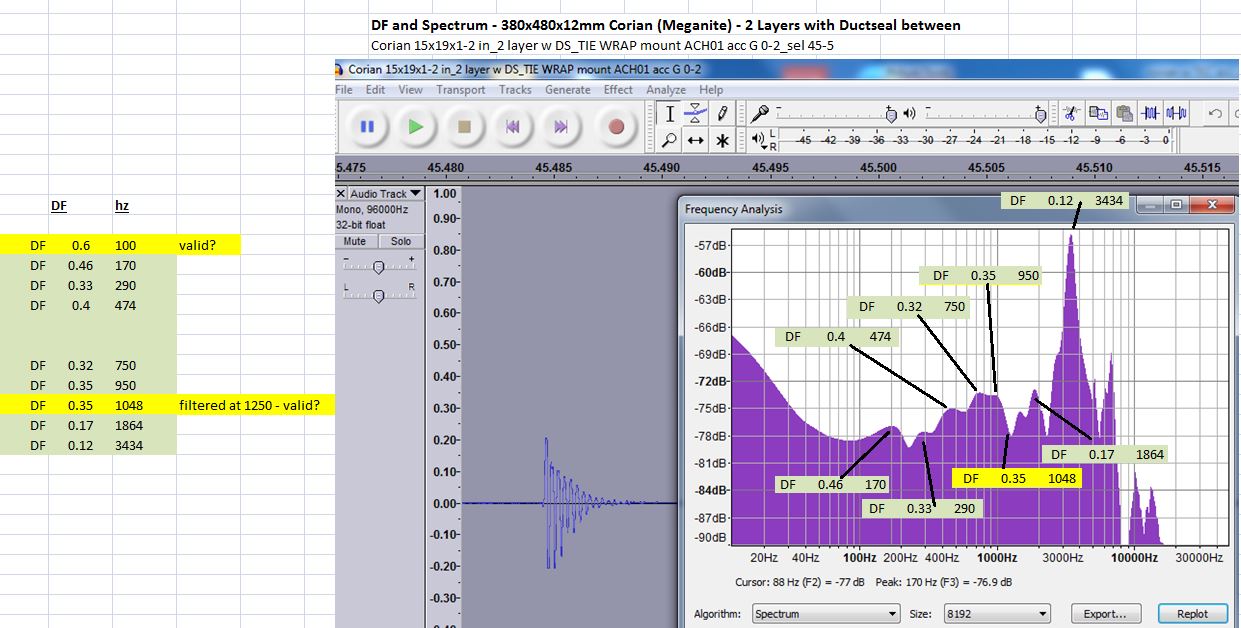

This 1st screen shot is a piece of 12mm Meganite (= Corian by another supplier) cut to plinth size. Note all the resonant spikes with very poor damping.

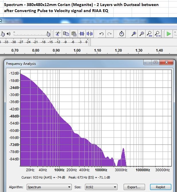

The second shot is a second layer of Meganite Solid Surface pressed to the 1st with Ductseal. Not shabby at all! All the test frequencies up to 1000 hz measure about 0.35 DF or better. (Cats Squirrel seems to like 1000 hz and below as the relevant region on his Audioqualia site).
It's worth noting that Pyramid describes a similar combination of materials in one of his posts. I'd say he was on to something.
The pulse that was selected was a plastic hammer tip tap to the accelerometer side. The taps to the opposite side (or steel tip) may yield different results. Low DF materials seem to be sensitive about how I attach the accelerometer. In this case, it was Silicone grease and a small plastic tiewrap.

That poorly damped peak around 3400 hz looks imposing doesn't it? I don't think the cartridge is likely to pick it up.
The tests were all done by measuring acceleration. But, a MM or MC cartridge output is actually proportional to velocity. Then there's RIAA equalization applied by the Phono stage. I believe this screen shot represents the combined effect. The 3400 hz peak is way down in the mud.
