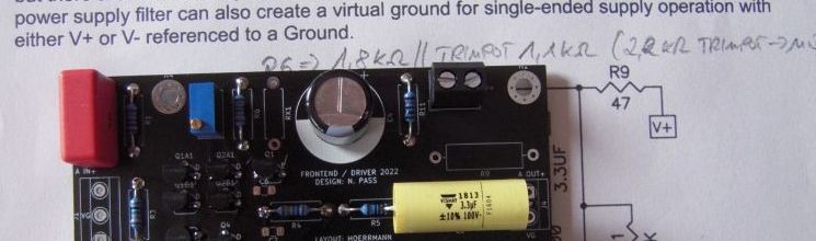

Could you tell us roughlyHello stonegreen,
I had to lower the resistance of R6. And I have doubled J113 at Q1 and Q2 (so 4 JFets).
Cheers
Dirk
Idss J113 you are using, your final R6, R7 and R8 value?
Hello wwwtttwww,
value of R6 is 1.8 kOhm in parallel with trimpot (2,2kOhm) adjusted to an overallresistance of very lowish 54,5 Ohm ( measured in the circuit over R6 with the FLUKE!)
R7 = 330 Ohm ; measured voltage over R7 = 1,053 V (so U/R= I = 0,0032 A or 3,2 mA). I think I should lower R7 to increase the current of the CCS (Q3)?
R8 = 100 Ohm ; measured voltage over R8 = 0,707 V.
I don't remember the Idss. Have to look in those plenty of papers with projects laying around... I only remeber the Vgs off was at -1.59 to -1,61 V for all 8 JFets.
Voltages over R11 = 19,47V and over R12 = 19.5 V.
Cheers
Dirk
Cheers
Dirk

I've told ya
vary R7, leave R6 original
you're keeping OLG, thus NFB, thus CLG where Pa wanted it ....... and having it same for both channels
