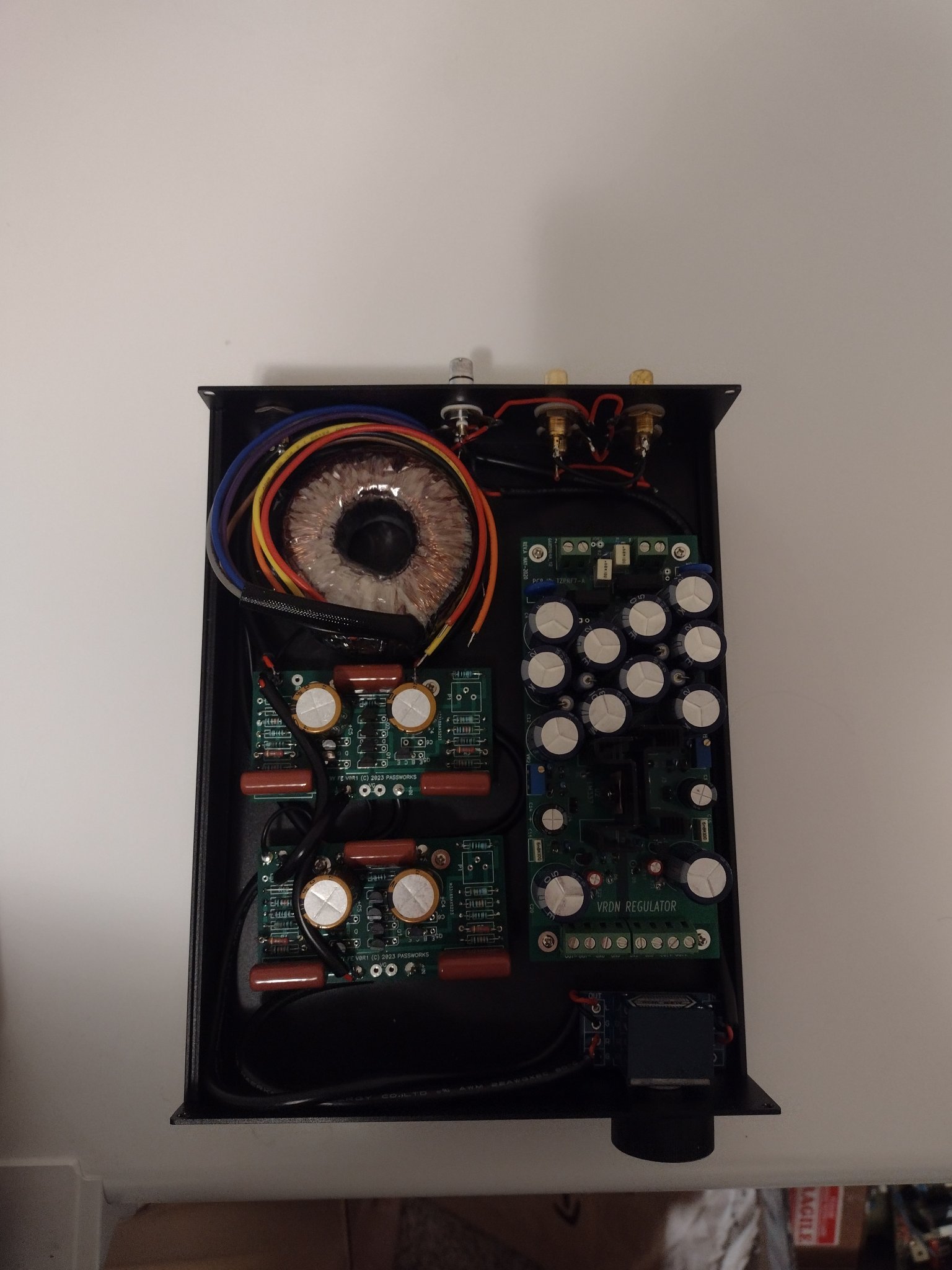

Definitely not a bad idea to experiment with different psu topologies.
But, that layout might be an issue with signal and power wires not playing nicely with each other.
Try that setup with the transformer placed outside the chassis. If you like it, maybe look for a larger chassis for better layout options.
Better layout would have the FE boards on the right side, on the same side as the RCA jacks and pot. Place the PS board and transformer on the left side, with the transformer at the front, far away from the signal wires and jacks. Place the AC/IEC connector at the left side of the back panel.
