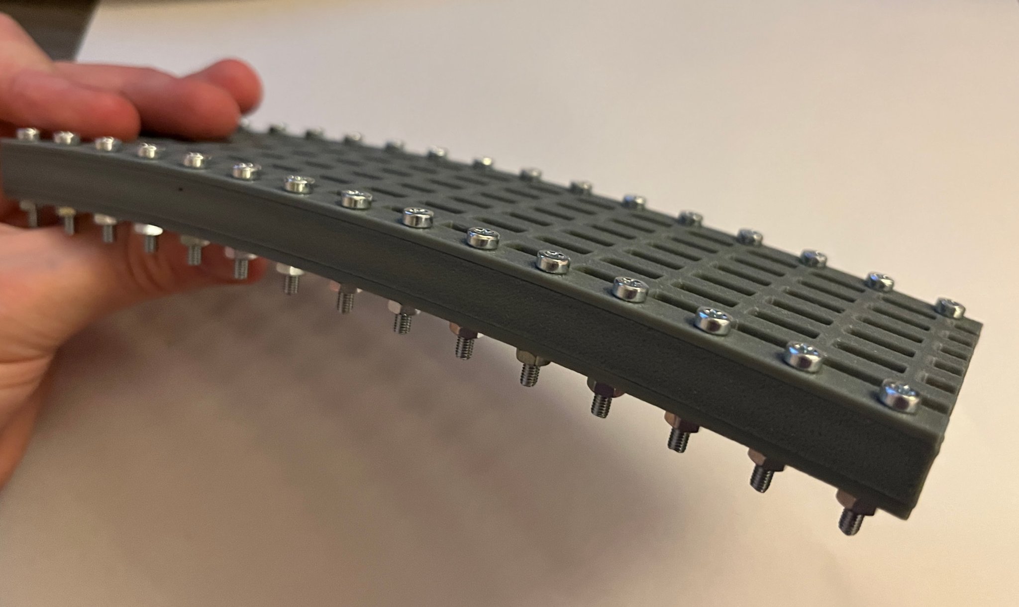

@solhaga s images where he shows that simple foam is of course softer than the corrugations and will give way made me rethink some things.
I think my TPU suspension is an overly complicated starting point. I should start simple, start with what others have already tried and found to be working well enough. Therefore I should start with a simple PU foam suspension. And only when I have a working speaker which performs well enough then I can start playing around with the TPU suspension to see if it improves things or not.
I started browsing the web for suitable soft and porous PU foam which is 5 mm thick, and one of the the top results was the foam for speaker fronts. That got me thinking of one setup which would be cool to try...
Instead of having the suspension at the sides, what if I added foam suspension in between the magnets? With the suspension on the sides and the actual force being applied in the middle the corrugations act as a leaver. There is a change that it would be better if the suspension and the force was exactly aligned, which it would be if the suspension was in between the magnets and thus the membrane coils would all be directly in contact with the suspension. Many manifacturers already add dampening material inside the driver to reduce resonances and this foam will probably do that too. And since the effective disance ctc-distance between suspensions is reduced from 55mm down to 10 mm I could get away with less deep corrugations which would improve linearity.
I will of course still start with a normal side foam setup since I need a benchmark to start with, but it would be cool to try afterwards

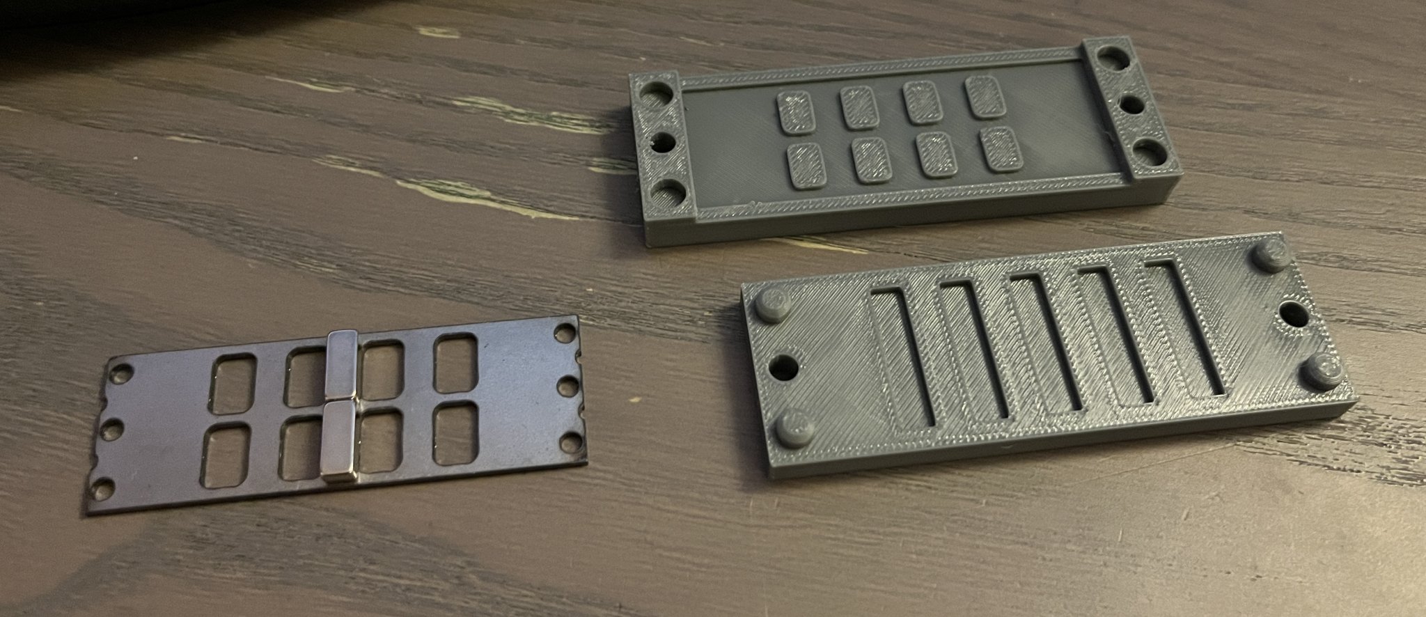

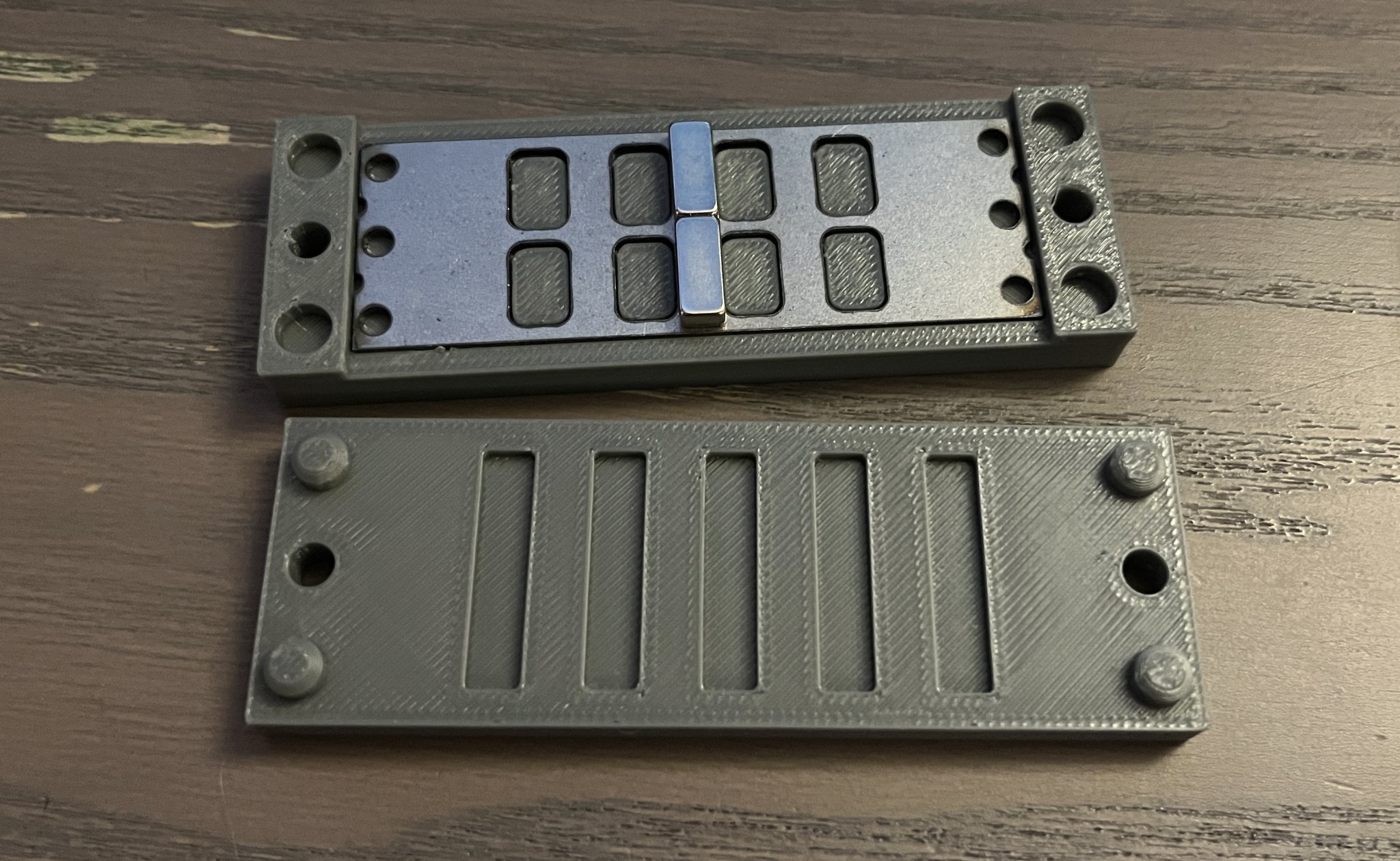

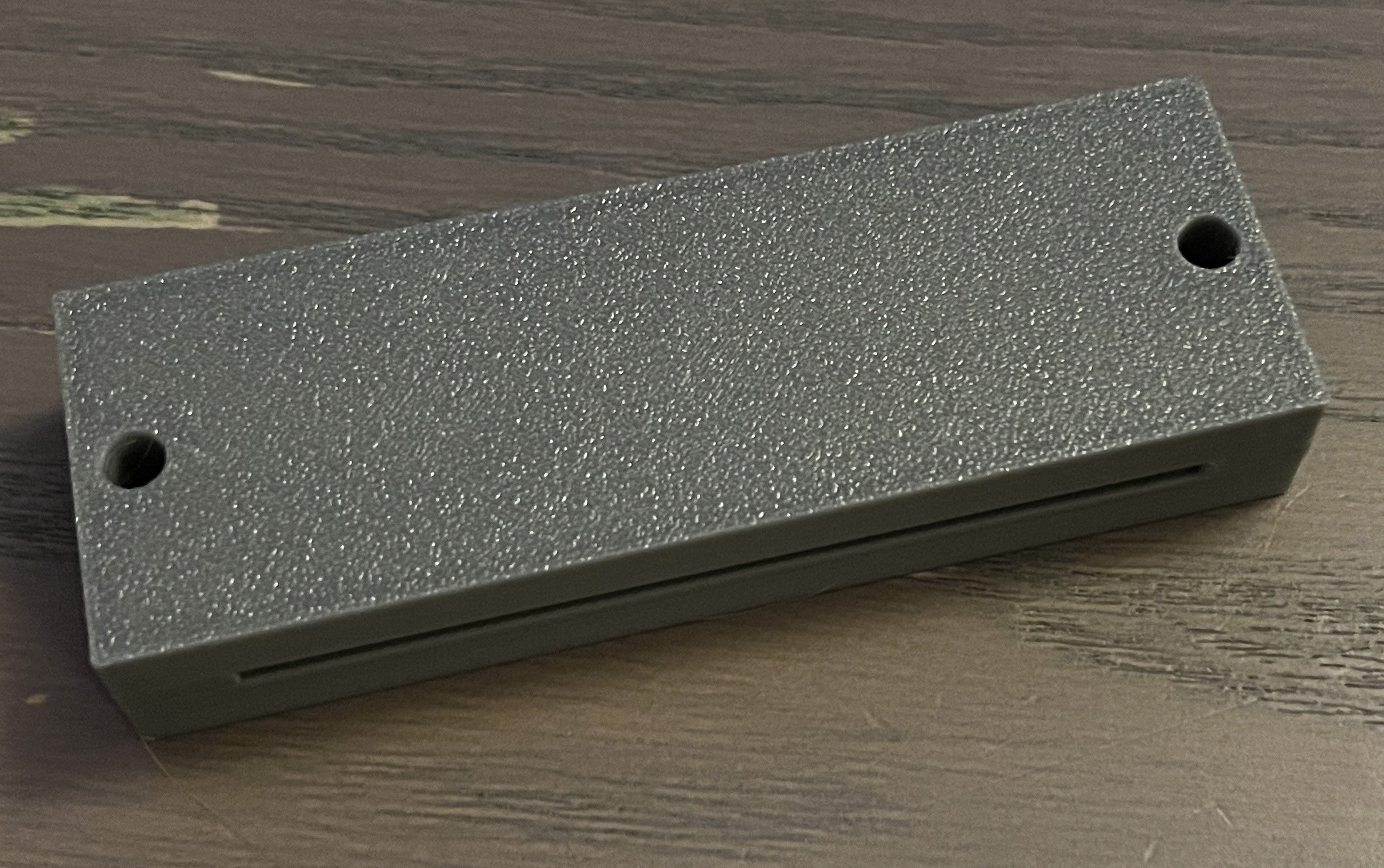

Model for the magnet gluing jig done, now I just need to print 4 more so I can start gluing. I have enough magnets for 18 plates of that size (12x5x3mm).
I'm planning to use 1h epoxy so will glue in batches. And while the glue is drying the plan for the weekend is to start playing around with the Silhouette Cameo 5 and try to cut some aluminum.

Using jigs when gluing with epoxy can be a little tricky; beware of getting epoxy on the jig.

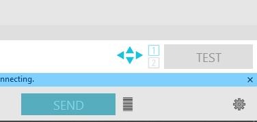

Use the test cut a lot, you can move the test area with the arrows or do it on the machine.
Do you use the autoblade? The knife can be adjusted from 0.1 mm to 1 mm.
The force can be hard to dial in so do a lot of testing.
There's an optimum speed; too fast and the knife will rip the aluminium, too slow and you will fall asleep.

Yup, there is a small gap from where the glue will be and the jig but I might increase that. Also thinking of spraying the jigs with silicone to reduce the risk of accidents.Using jigs when gluing with epoxy can be a little tricky; beware of getting epoxy on the jig.

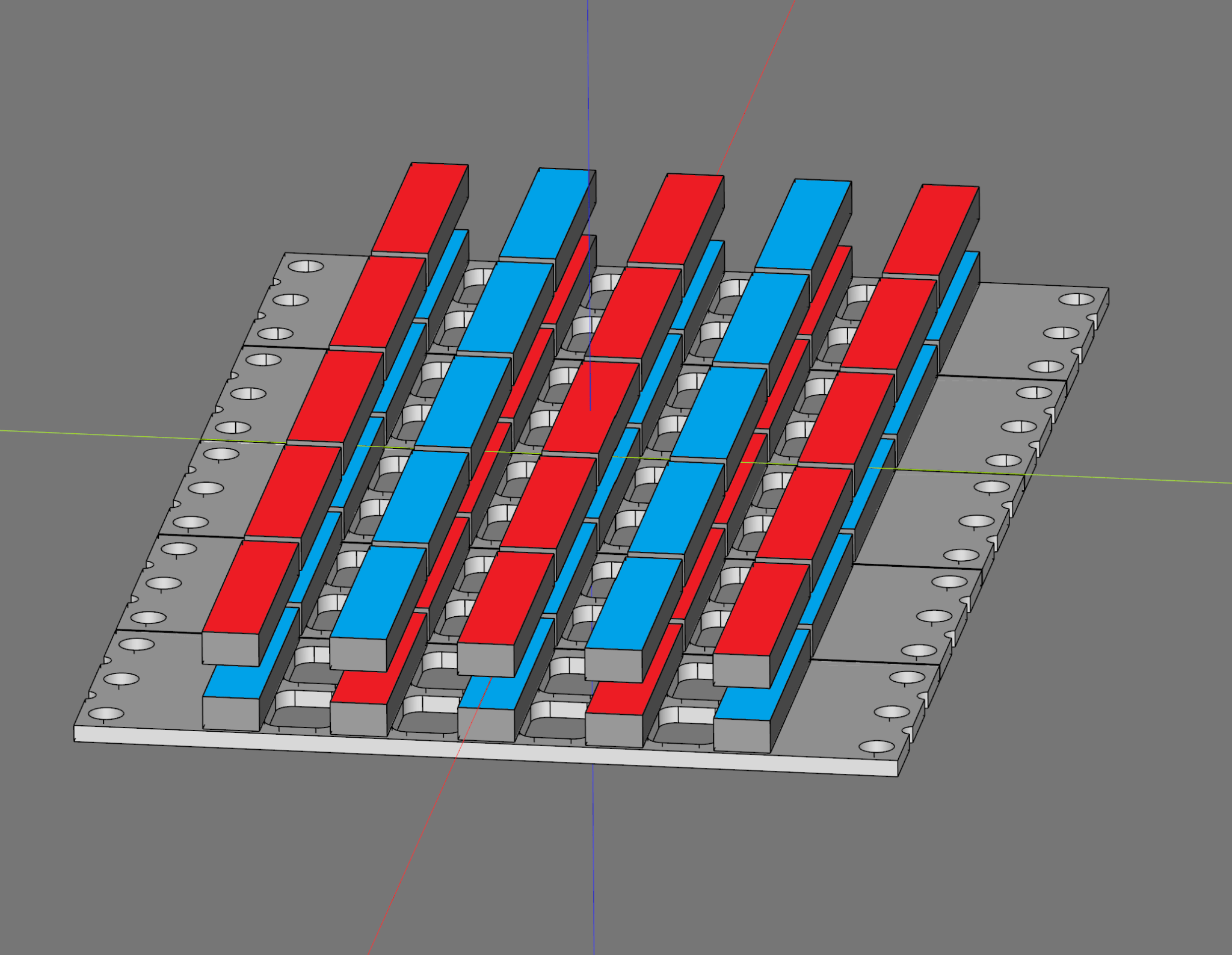

And I will have to put some brakes on the idea on gluing the magnets. I need to validate some things first. I have understood correctly that the polarity should be as per the following image?
Which means that lengthwise the magnets will not stick nicely but rather try to repel each other. When placing them on the steel the magnets are short enough that the attractive force to the steel plate is not enough to overcome the repelling force lengthwise so I will definently need the magnets to stay in the jig when gluing.
Also, I'm a bit scared of messing up the magnet polarity somewhere in the driver so I'm leaning towards painting the exposed side of the magnets. I calculated and if I go 5 rows of 12x5x3mm magnets I need 2600 magnets for 2 160cm tall push-pull drivers. I would definently mess up the polarity at least somewhere so painting would give me some peace of mind and also help as a sanity check to ensure consistency.

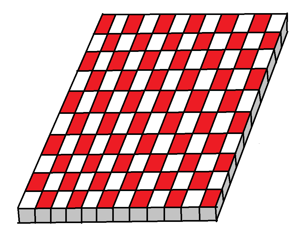

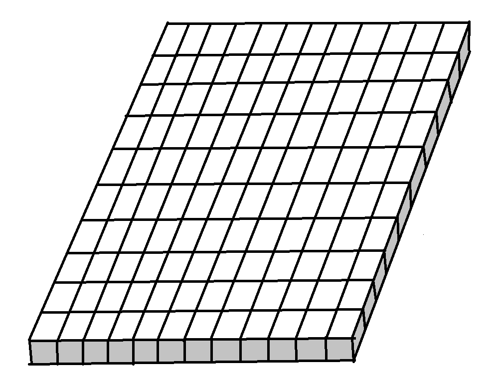

I'm thinking I could first place magnets in a flat 1 layer sheet
Then spray the top with white primer.
And then add a 3d printed jig where every odd hole is covered and spray some red paint.
The bottom would remain unpainted to get the best bond between the steel and the magnets.

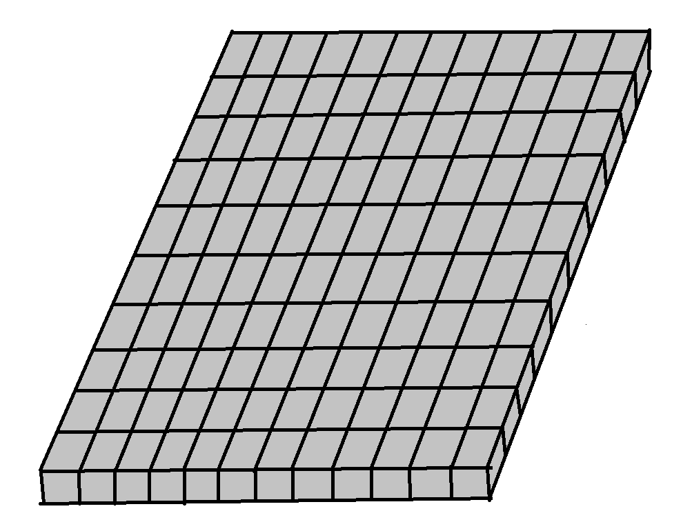

But a problem with painting them in the above pattern is that it is quite fiddly to orient the magnets into a flat sheet since they are much stronger at the poles. It would take a lot of time to do so with 2600 magnets since just takes a little nudge and they will overcome the weaker edge to edge attraction go back to being pole to pole.

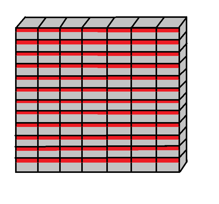

An easier way to paint them that is probably good enough is to just have them in a large block pole to pole but then use masking tape to mask the bottom of each magnet row, + top and sides and then spray a red coat of primer.
A benefit of this way is that they are all the same. With the method in the post above I would get 1:1 of white topped = S, red topped = N magnets but in practice I need 3:2 magnets to be of a certain orientation since I have 3 + 2 rows of each orientation.
Yes.Do you mean that the foil came preapplied on a water soluable backing.
Yes. The plates will have repelling magnets but with the opposite polarity for every other column.I have understood correctly that the polarity should be as per the following image?
When I mount the magnets, I test them in my palm against a reference magnet. I use no paint or marking.
Before I move on to the next column, I double check the polarities.
But I guess that method can get a little problematic with that many and such small magnets.

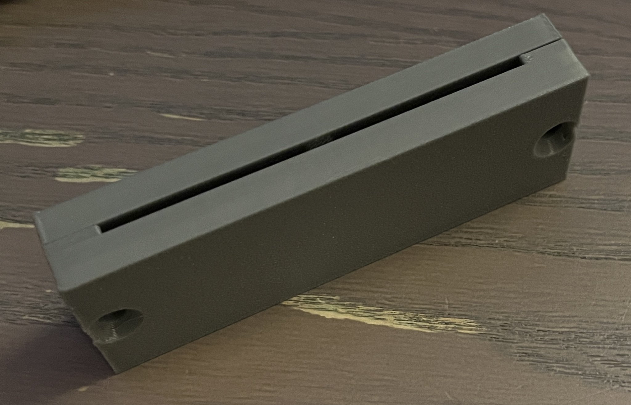

Since the magnets put a spanner in the works I decided to rethink more parts...
With the magnets repelling so strongly I need to redesign the glue jigs and all in all it would be a lot of time to fiddle with the small 25mm tall steel plates so I have decided to ditch them and go on to curved plates. With the curve they will naturally get more stiff too so I don't have to think about solutions for that either.
I have also been inspired by you solhaga, I am leaning towards bumping the steel thickness to 2mm. I printed some samples of the steel plates solid on my printer to validate that all the holes align when they are bent and I printed both 1.5mm and 2mm thick "steel plates" and the 2mm is just so much stiffer.
I have also decided to steal your idea of having the steel supports on an offset to ensure they all don't align and cause noise:
And in case someone is counting rows they might realize that these plates have 5 rows of magnets but 7 holes...
I am planning to order test parts where the outer holes are solid which is the standard in addition to this setup but the thought behind the holes are: Along the edge of the membrane I need to have aluminum to stiffen it in the suspension. And there is still a magnetic field there, although weaker since only magnet on 1 side. And since the magnet field is there, the aluminum is there I might as well see what happens if I drive current through the aluminum. This is basically what the PDR tweeters do, they have 4 rows of traces but only 3 rows of magnets.

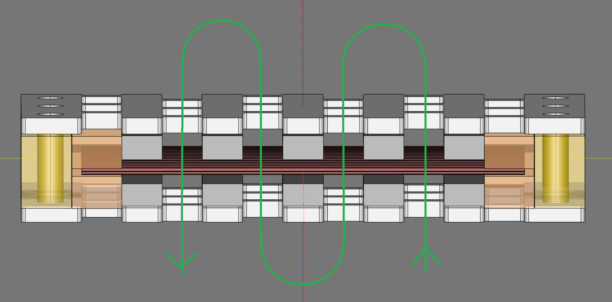

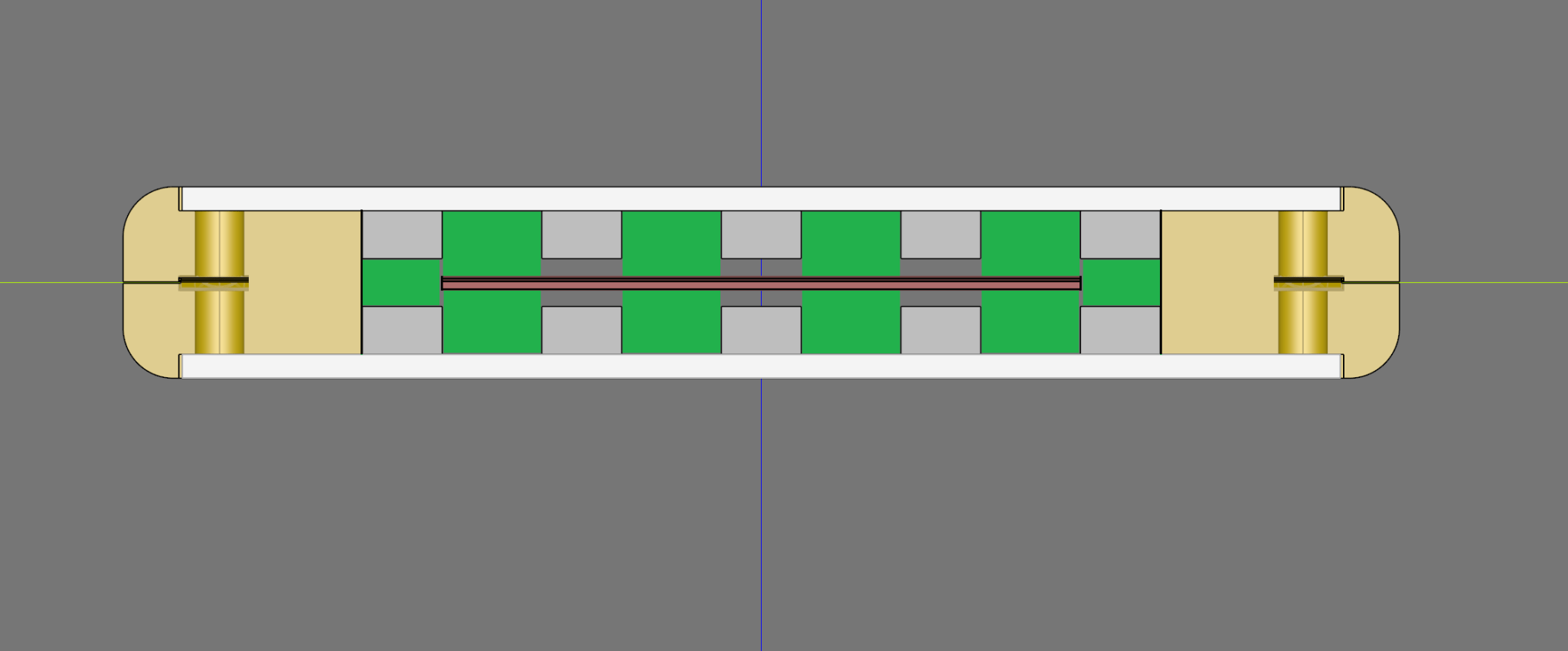

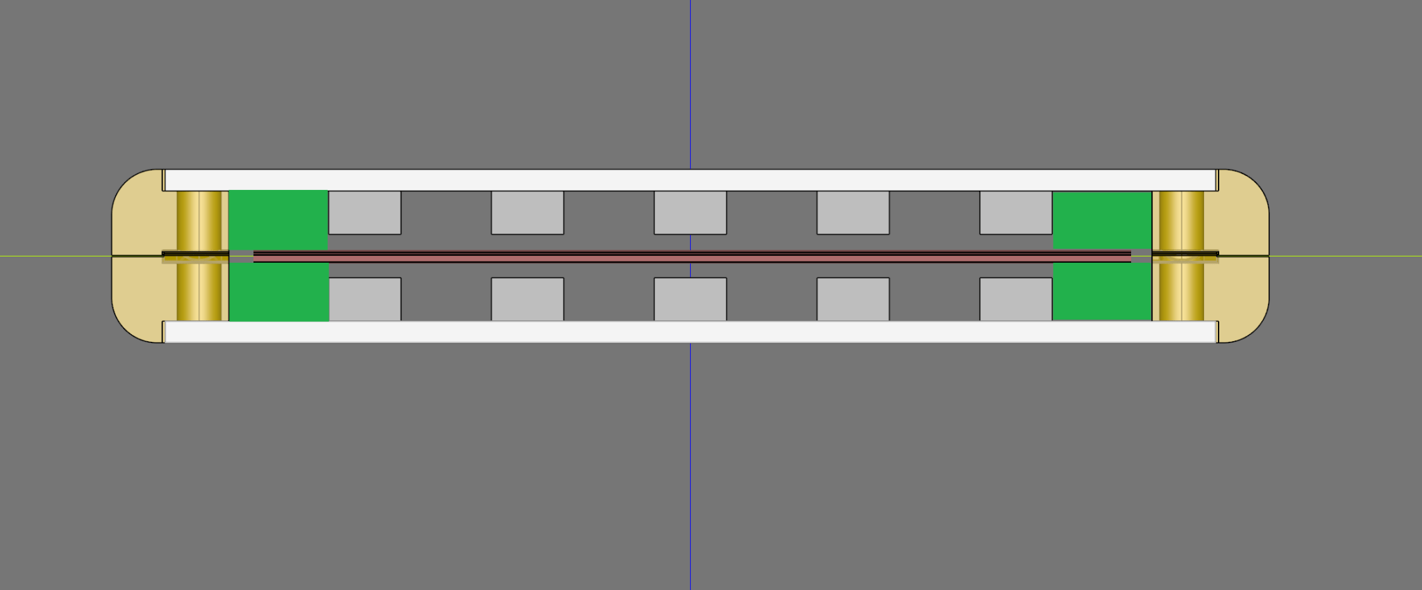

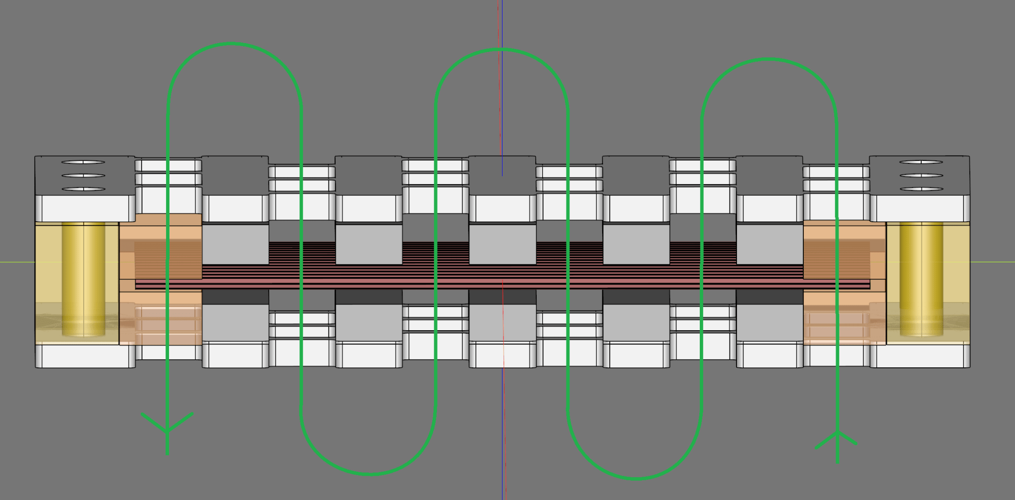

No reason reason other than that I unchecked some to make the image less cluttered like this:Why are there magnets on one side only towards the edge of the membrane?
The plan is of course to go push pull with dual plates. Very similar to yours, except for the curve and 3mm xmax vs 4mm in yours the dimensions are pretty much the same too.
I didn't mean in the picture but this:
oooh, now I get what you mean.I didn't mean in the picture but this:
Mostly because there is only so much room, if I add another row of magnets the driver would need to be wider.

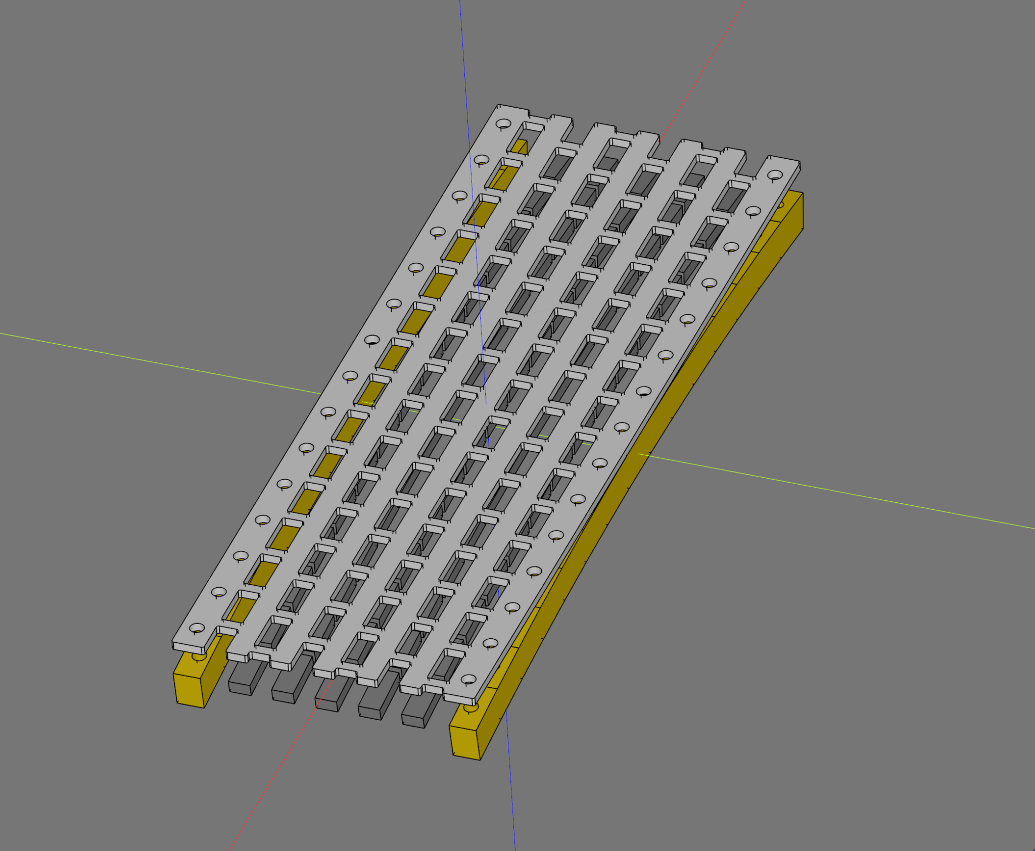

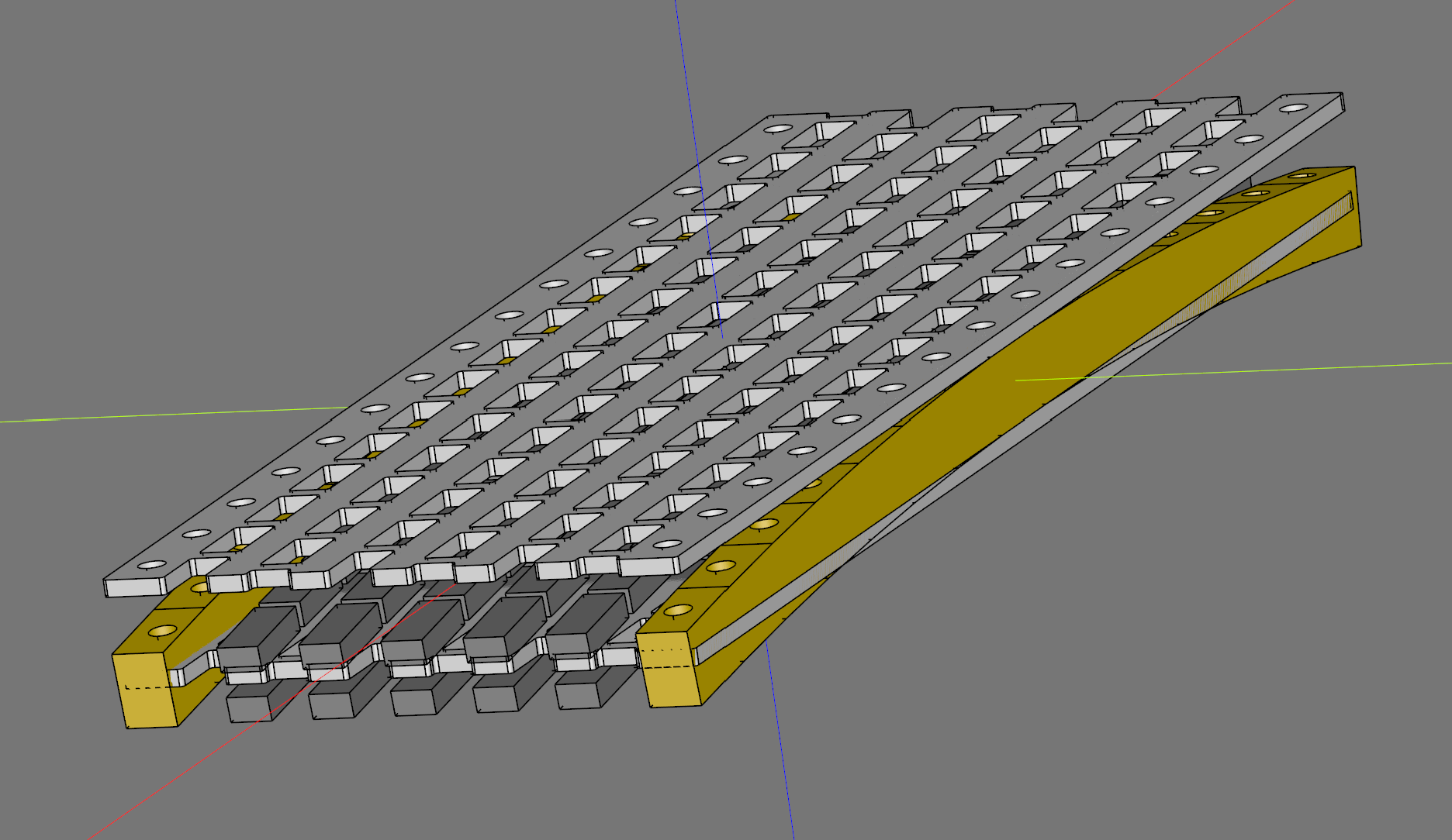

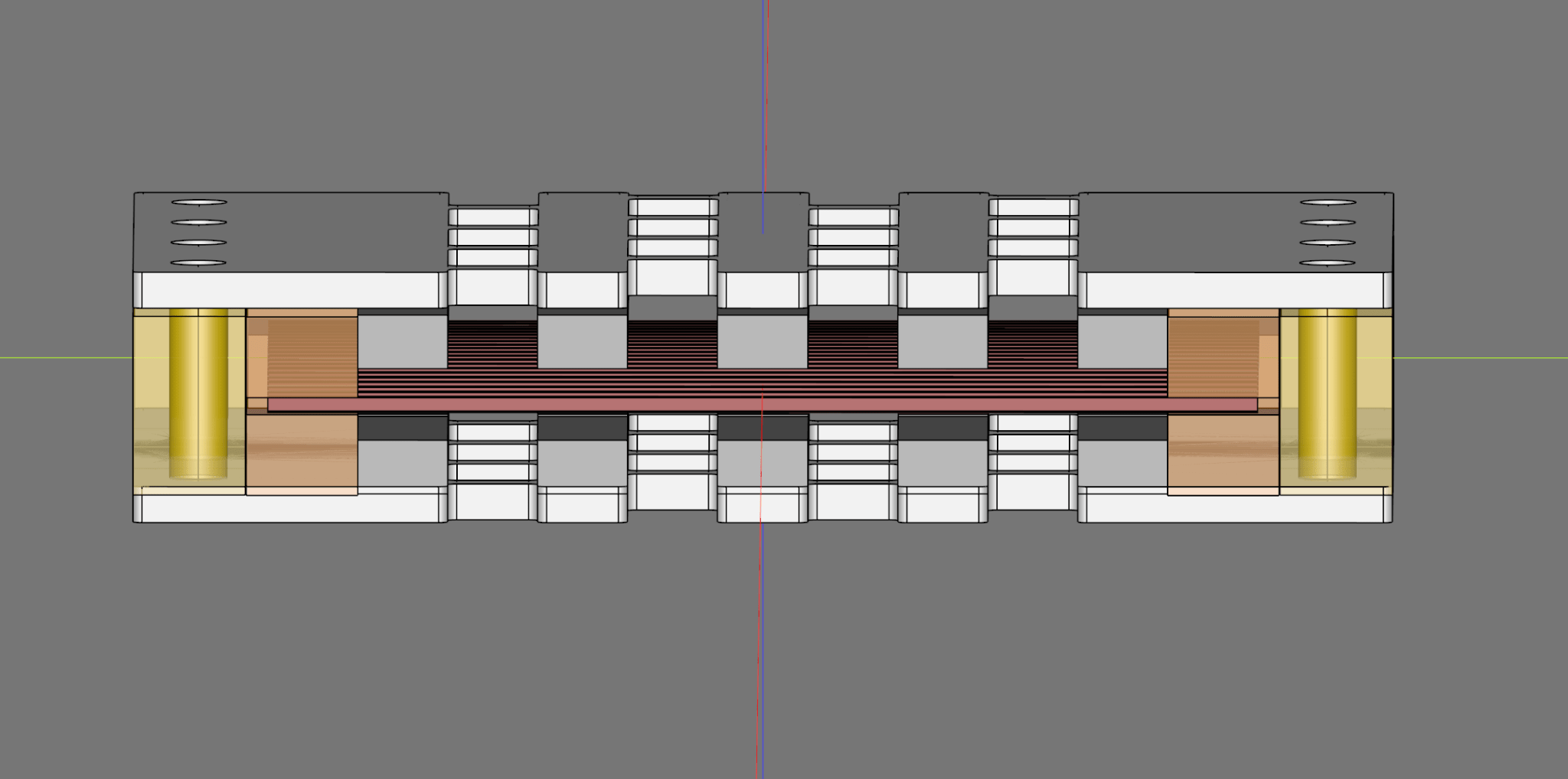

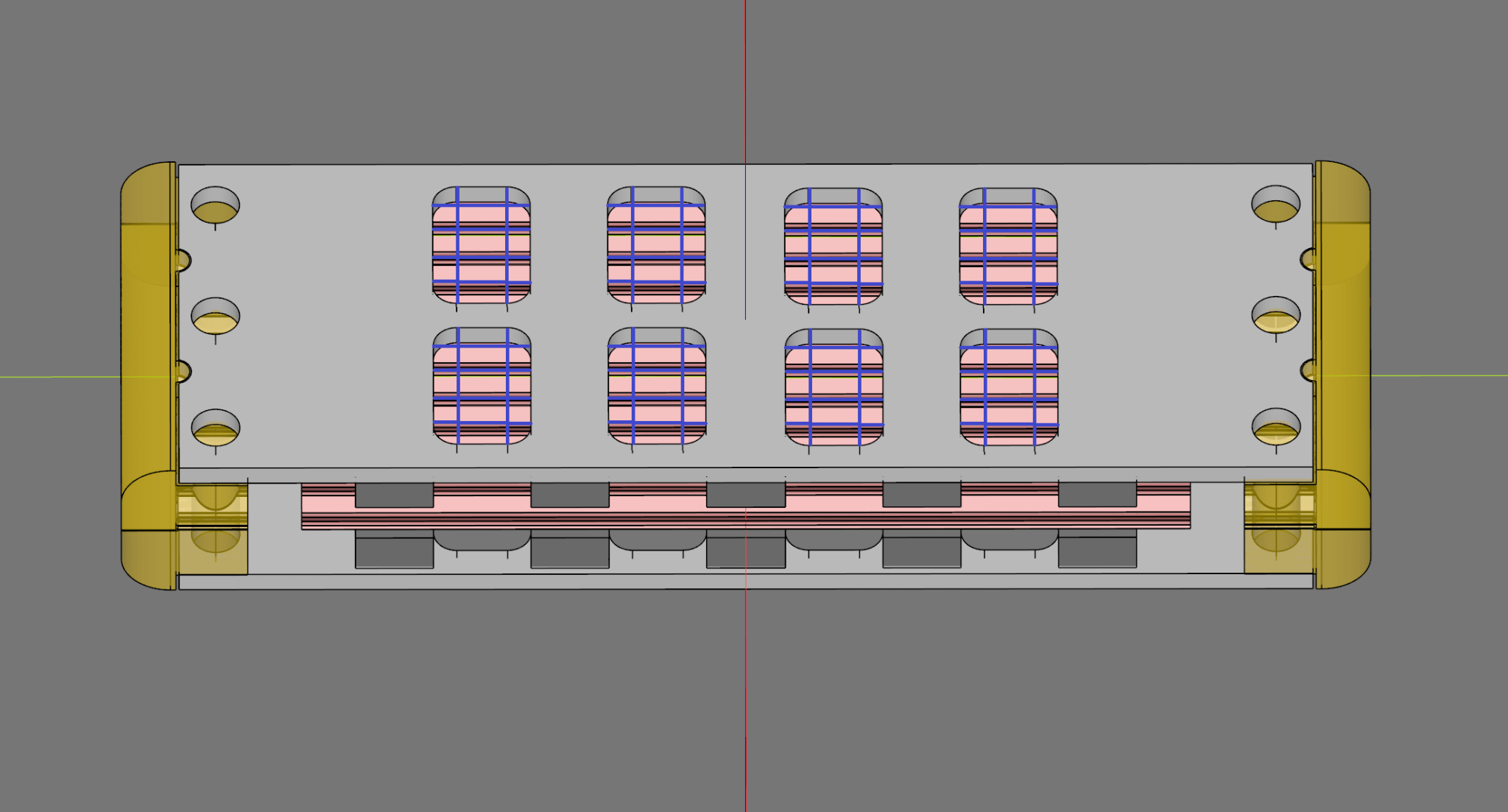

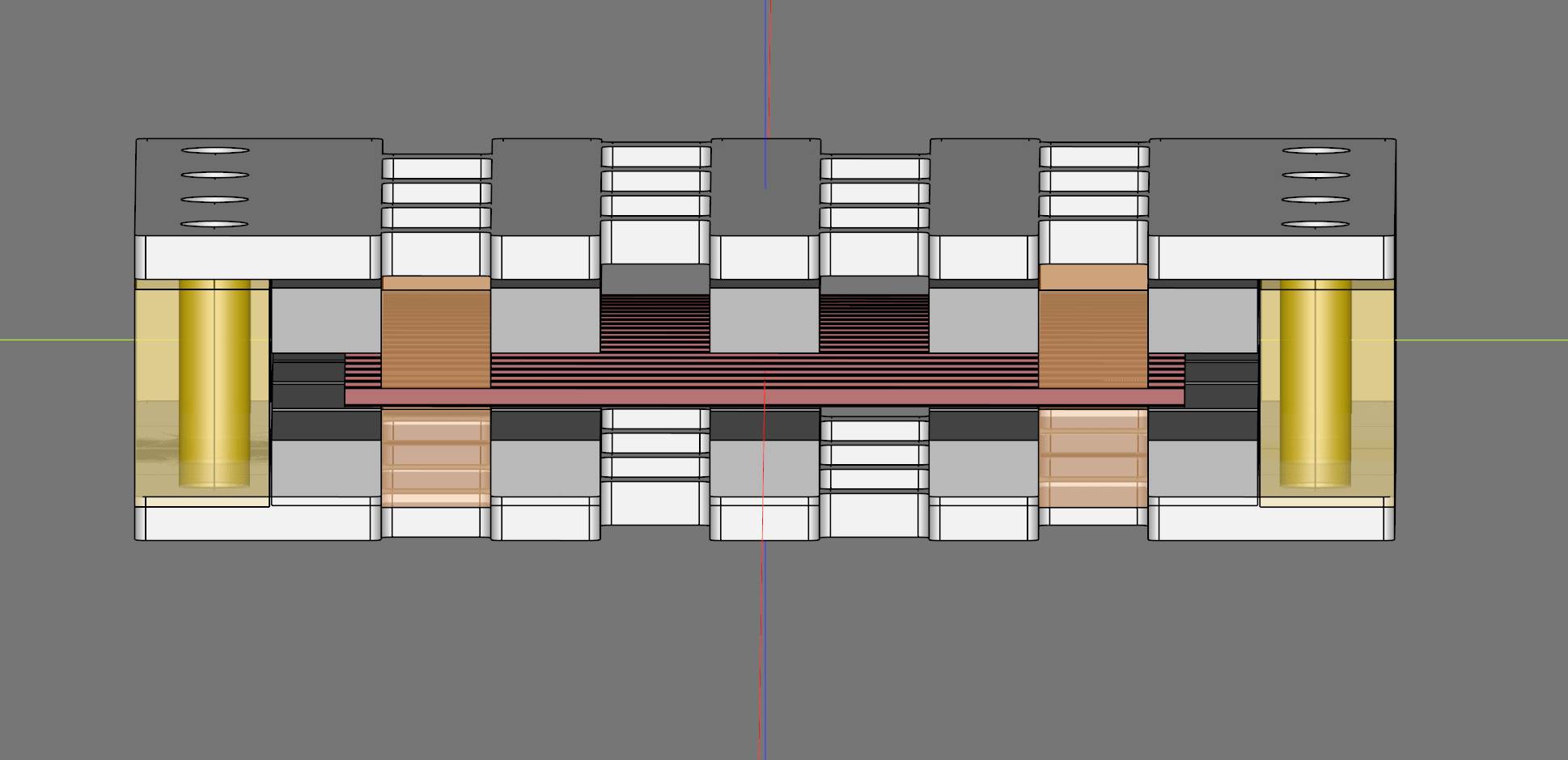

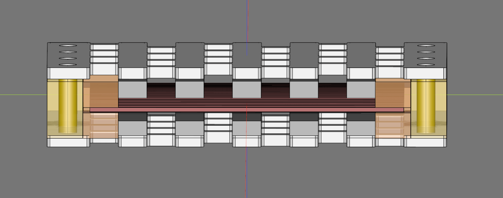

Let us start with the normal setup. The outer holes are normally not open but closed, like they are in your planar.

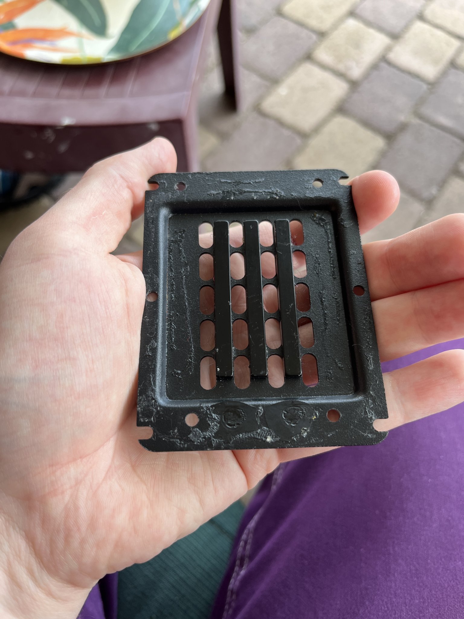

The orange blocks are the foam suspension. Since the screws are in the yellow edge bit there is no room for another row of magnets. But we could, probably while reducing the efficiency somewhat bump the radiating area by instead of just having blocks of foil along the suspension to route traces there too like this:

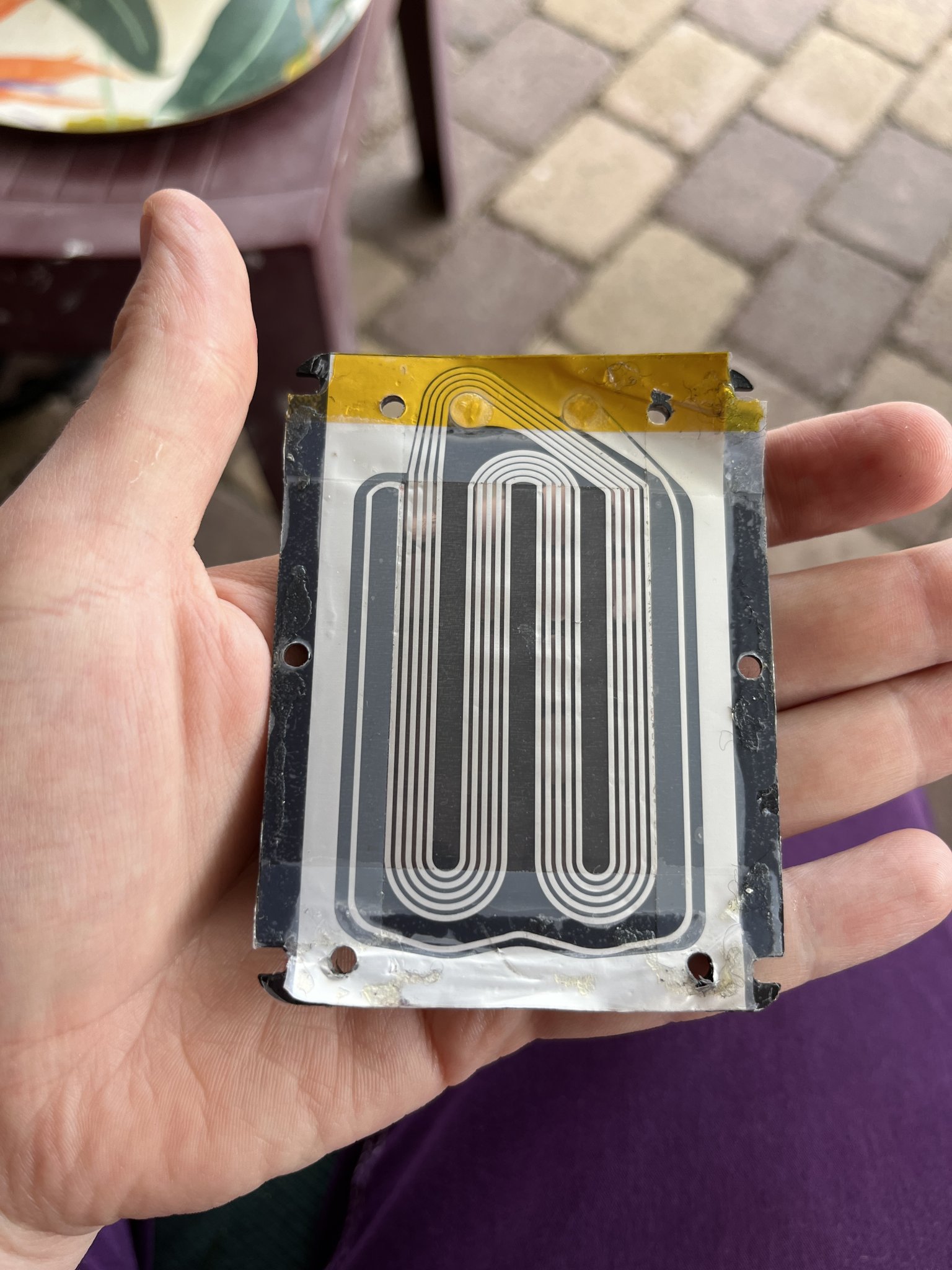

Which is kinda how this Neo3PDR clone works. Although this driver doesn't have the outer holes do double duty as suspension which I want to try. But the suspension should at most act as a lowpass filter methinks.
There are 4 rows of traces but only 3 rows of magnets. The outer rows don't add as much output as if there was magnets on both sides but it does add some output, probably more in our cases since we have a stiffer corrugated membrane. Or at least more on the low end.
Ok. Seems like they don't care about non linearity and compression effects then.
It definently isn't as linear no. The question is just how big the tradeoff is. It might be that the increase in surface area is enough to offset the disadvantages such that the end result is equal-ish sensitivity but less distortion at the same SPL. Would have to be tested!
I'm leaning towards testing the 3 following setups:

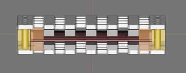

1. First is the standard setup. Almost a carbon copy of yours solhaga but with a thicker membrane and curved. Unless I mess up the curve or something major this is guaranteed to work great for my use cased based on your measurements solhaga.
2. Then the first weird setup. Exposed holes above and below the suspension. Not rendered is that there would need to be a grille in between the steel and the foam to evenly distribute the force on the membrane:
3. And lastly a combination of both. Grille not rendered again. Still radiating audio through the suspension but with magnets on either side. More efficient than the standard setup on the low end since it has less membrane mass? Also less wide which would be nice.
