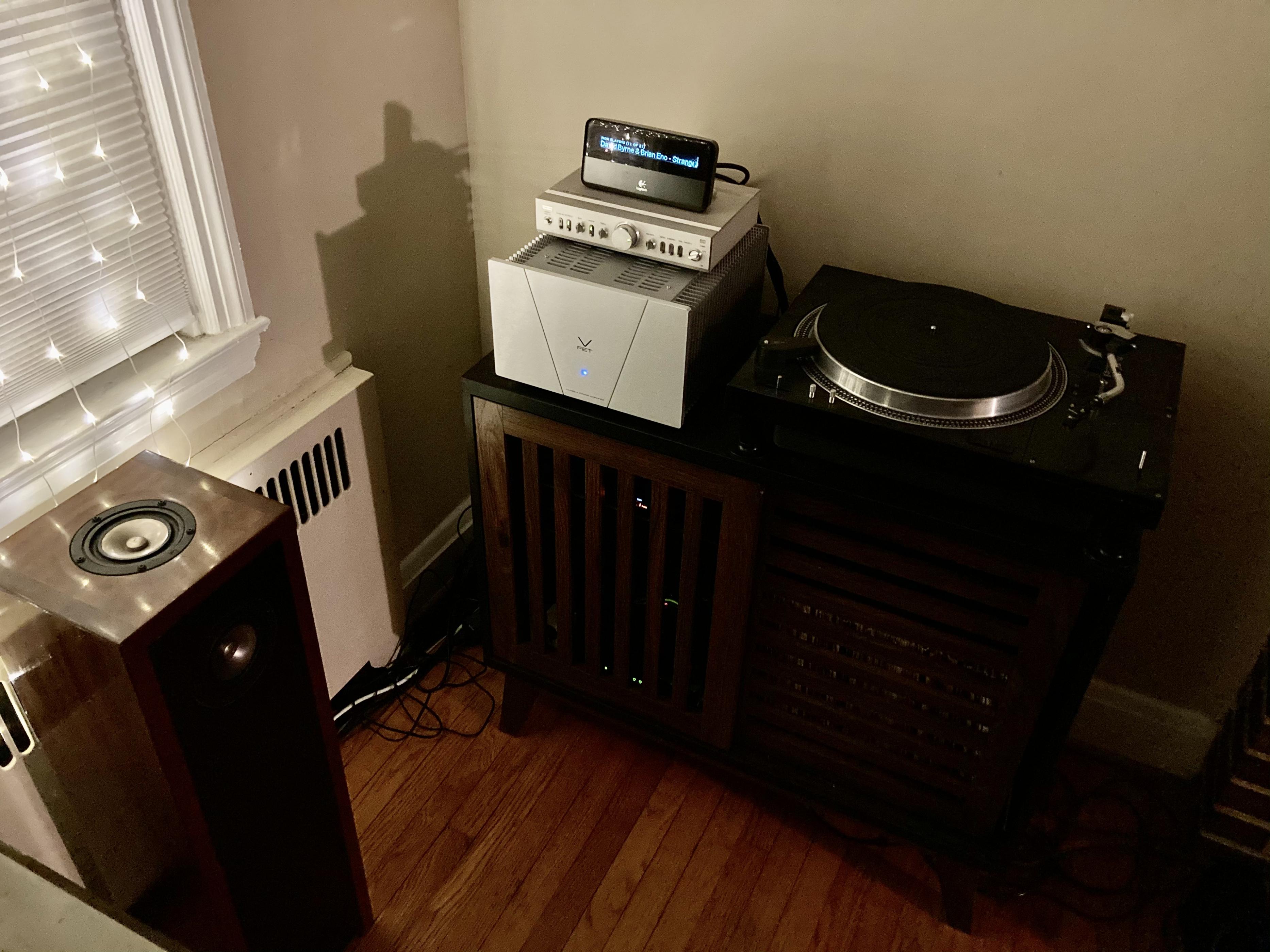

Haha... Who was I kidding? I’m a stubborn lunatic. I checked and reflowed all the input and output connections. The culprit was the D+ and D- connection at the OPS. I think the wires got too hot and were twisted too close together so that the melted insulation led to a short. hifiZen wins 1000 Internets for the correct suggestion! Nailed it!
I fixed it!
Now I can permanently attach the front plate as the bottom is off.
Take two for planting it in the main rig...
Happy Days!

Long overdue listening session underway...
Great news! Looking snazzy next to that turn table...
