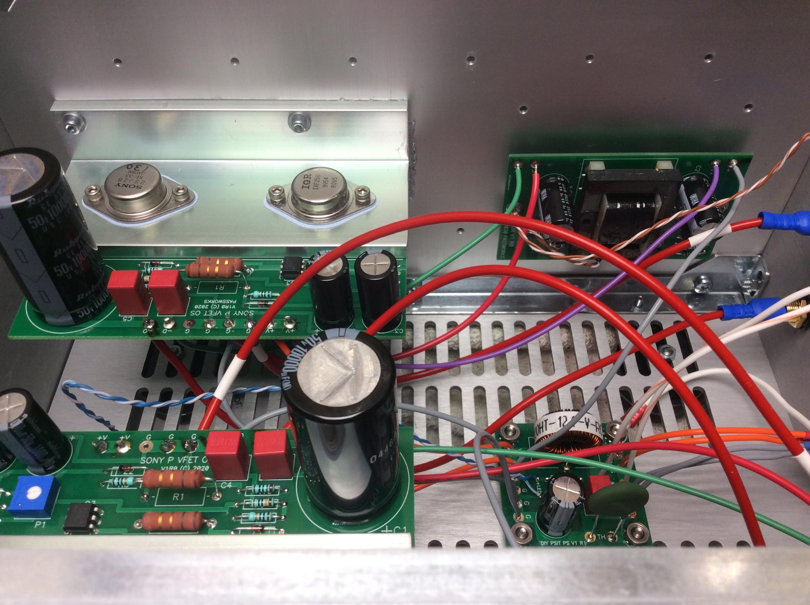

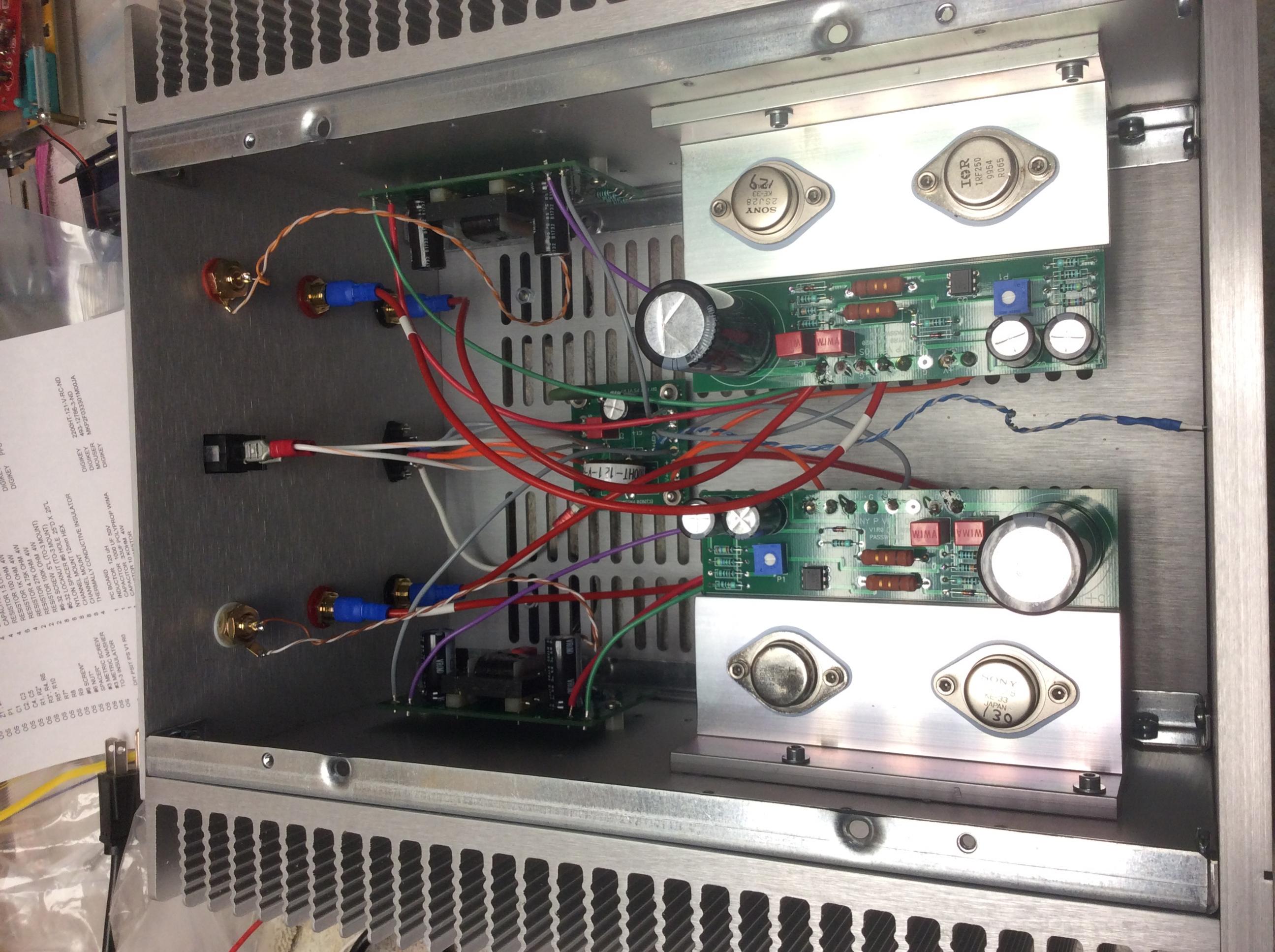

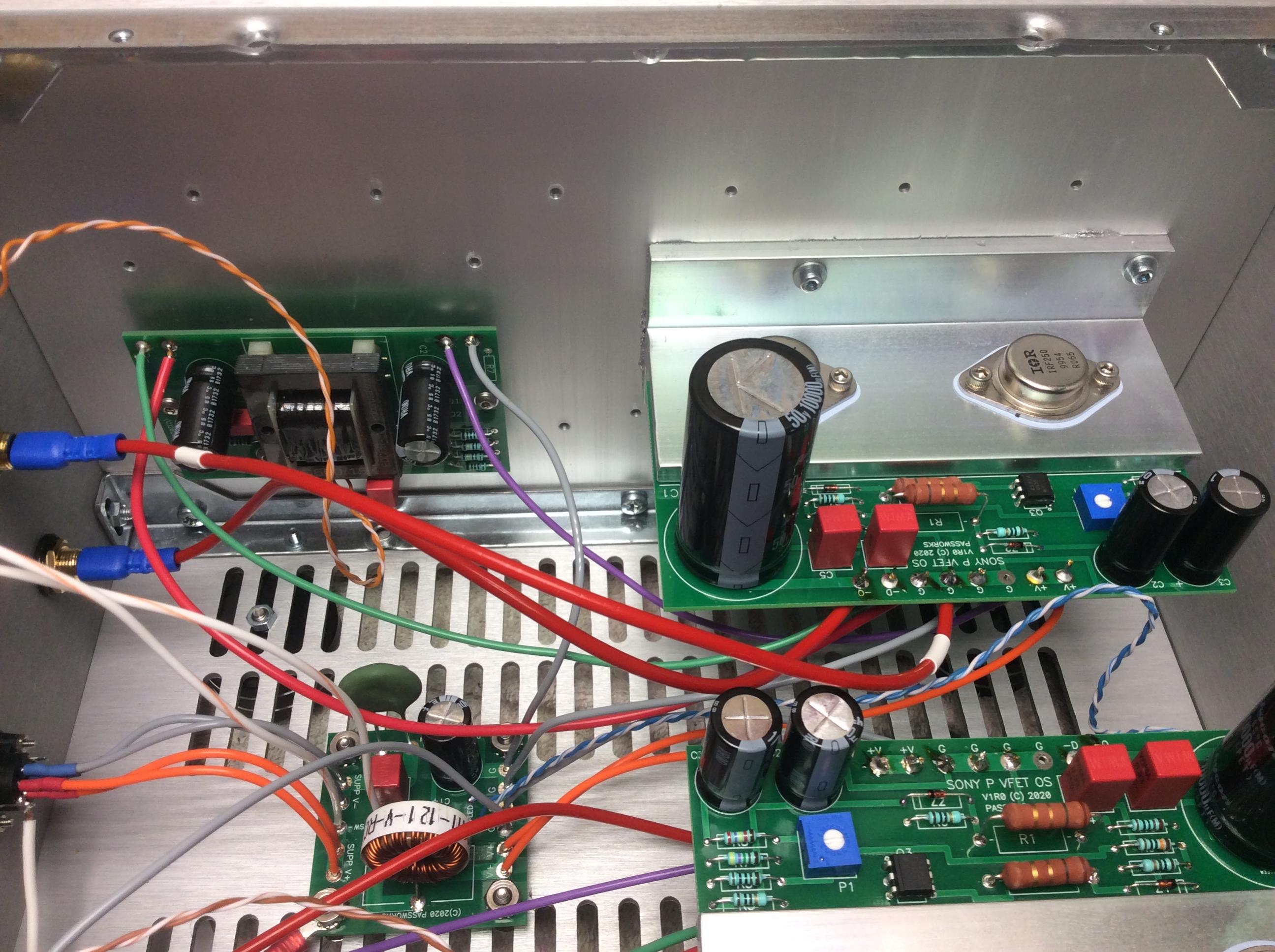

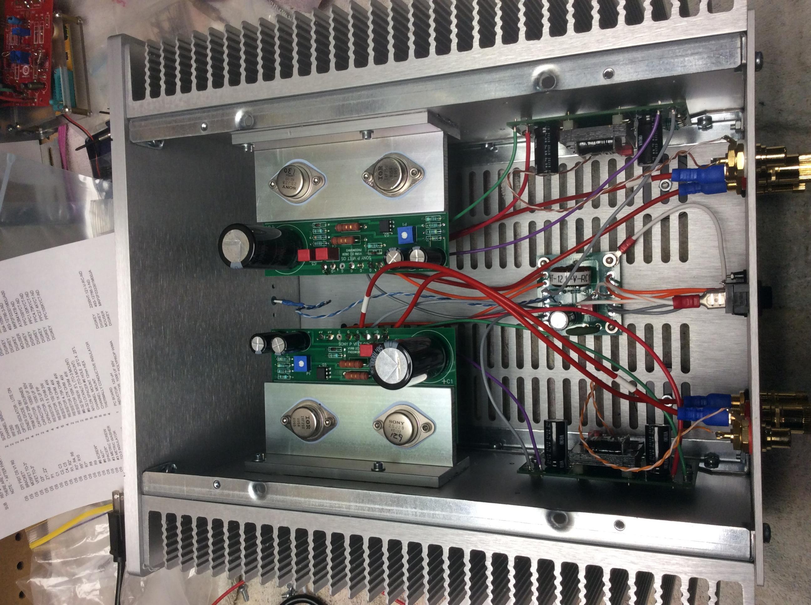

Folks:
As embarrassing as it is to admit this, I need help with my VFET build. Assembly was certainly easy enough, but it isn't working and I'm getting weird voltage readings.
With the switch Off, voltage between the chassis and the live pin on the switch is in the 32.5 to 32.8 VDC range (the voltage is not steady; it bounces around). The LED on the Meanwell brick is a steady, bright blue.
With the switch On, voltage between the chassis and the live pin on the switch is in the 0.5 to 3.3 VDC range (the voltage is not steady; it bounces around very quickly). The LED on the Meanwell brick flashes on and off quickly but is very dim. Not surprisingly, I get the same 0.5 to 3.3 VDC voltage readings between ground and V+ on the two OS boards when the amp is turned on.
My two FE boards differ. One has a via labeled "R7" and the other does not. On the FE board with R7, the via labeled "D-" is next to "D+". On the FE board lacking R7, the via next to "D-" is labeled "G" (and that via is connected as directed in the schematic to a ground via on its OS board). R7 was not installed on either FE board.
Soldering is pretty neat. There are no frayed strands of wire, the wires are all properly run and I am bewildered. I'm frustrated at apparently being the one outlier who's having a problem with his VFET build.
I'm not sure what to look for, so I thought it best to ask before taking the amp apart. Please weigh in.
