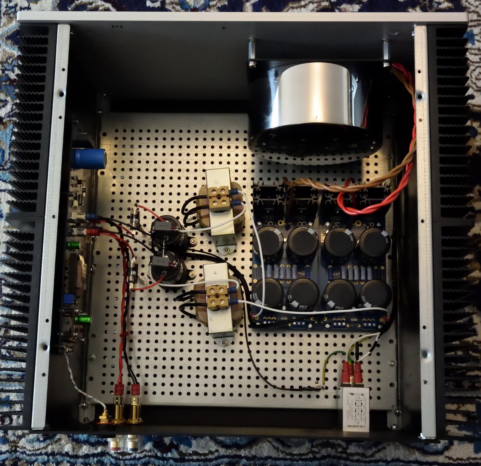

Can see your back panel also bends inwards a bit. On the larger chassis a shim behind the 4 screws (between panel and heatsink) cured it. But don't know if I will disassemble to make this modification. Forgot it to do it from start....
Interesting that the front panel gets as hot as the heatsinks even that there are no paste between heatsink and front panel.
Mine has a little bend as well but barely noticeable. Less than that. Not sure what shims can do though since the panel itself is bent.

I think the back panel is bent a bit by the force when attached. The heatsinks is just a tiny bit longer when the rail is "centered". Then a shim between rail and back panel can fix it. Maybe if rail is adjusted a bit to the rear so back panel just clears the heatsink this will probably fix it also.
The fix worked for the large DeLuxe chassis and was recommended by "Dirk" as far as I remember 🙂

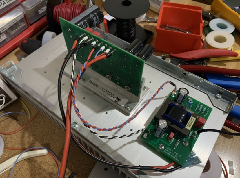

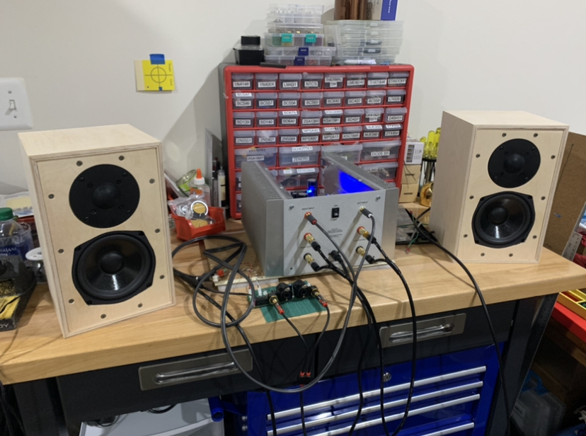

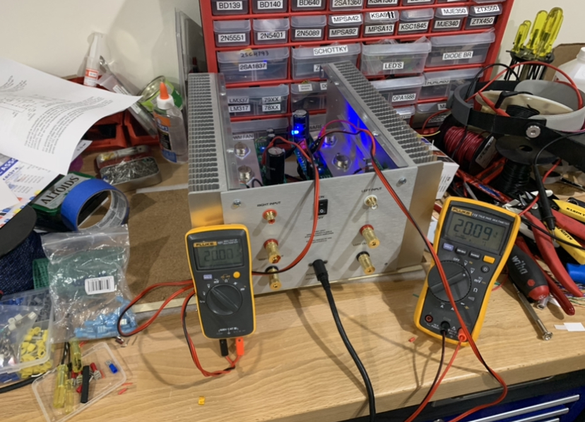

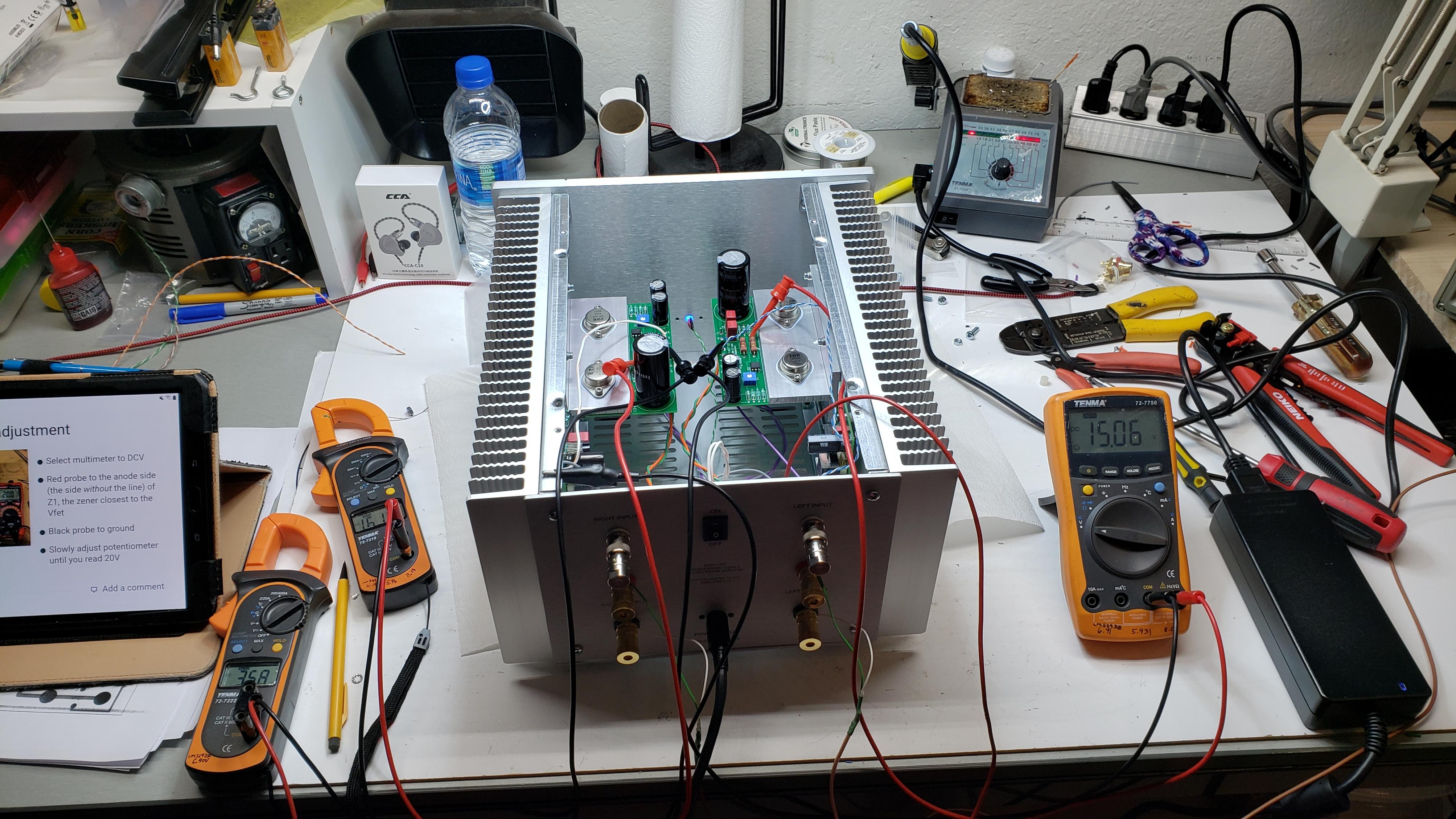

VFET number 010 is now singing! Everything went very smoothly. I used silicone RC race car/quad copter wire (18ga, 16ga, and 28ga). Also used crimped pin connections to solder into boards. 18ga for doubled wires from PSU jack to filter board. 16ga double wire (black and red) from CLC filter to amp and same 16ga silicone wire from amp to speaker outputs. All signal wire is 28ga silicone insulation as well. It turned on around 16v at VFET source pin. Adjustment was easy and stable. Bias current was measured at 1.7A and very stable. I am using my own design balanced/SE buffer with gain set at 14dB for now. I think it could probably use the 20dB setting for overall 30dB which should let my phone as source hit clip levels. Listening to the VFET on my Rockville speakers (LS3/5A homage with about 8-12ohm nominal impedance). The amp sounds wonderful.
Thank you to Mr Pass and the DIYA team that made this amp possible!
Connections to boards:
Adjusting voltage of S pin for VFET to 20v:
https://www.diyaudio.com/forums/attachment.php?attachmentid=948319&stc=1&d=1620027819
Playing music through iPhone (Amazon HD) to buffer as preamp (14dB) and Rockville speakers:

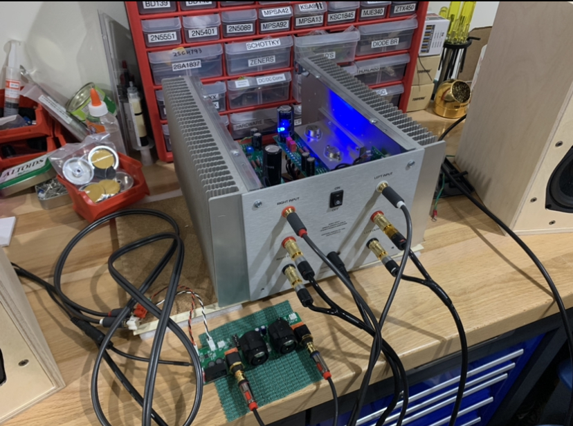

Closer shot with preamp:

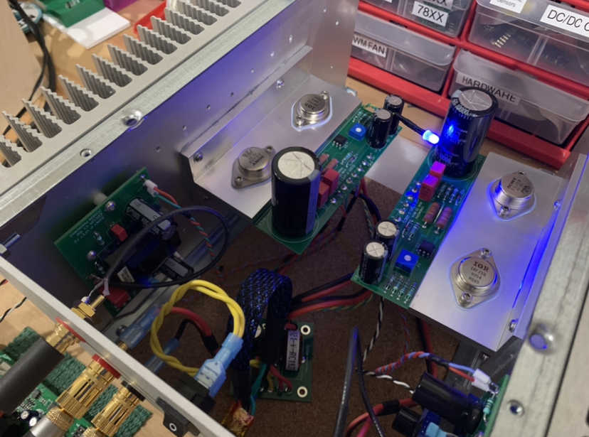

Closer ahot of the inside. I will let let it burn in without the chassis fully built for a few days before buttoning it up with all panels.
Temperature of the thermal spreader is 51C (IR thermometer with Kapton tape surface).

I recall that the M2 would take about 45 seconds to slowly charge up to reach its steady state bias current and did not have a turn on or off thump issue. I was expecting the VFET to behave similarly but the turn on was almost instantaneous as I monitored bias current. I think it’s the RC time constant of R5+R7 and C2. It’s about 4s for the VFET vs about 115s for M2. I wonder if Mr Pass or ZM could suggest a longer setting here or are there other considerations at play? Making C2 3300uF would slow down the thump by 3x.
how big is that thump, speaking in mm movement of bass cone ?
approx 5mm on a 8" Fullrange (Visaton BG20). Does not seem alarming at least in my set..
