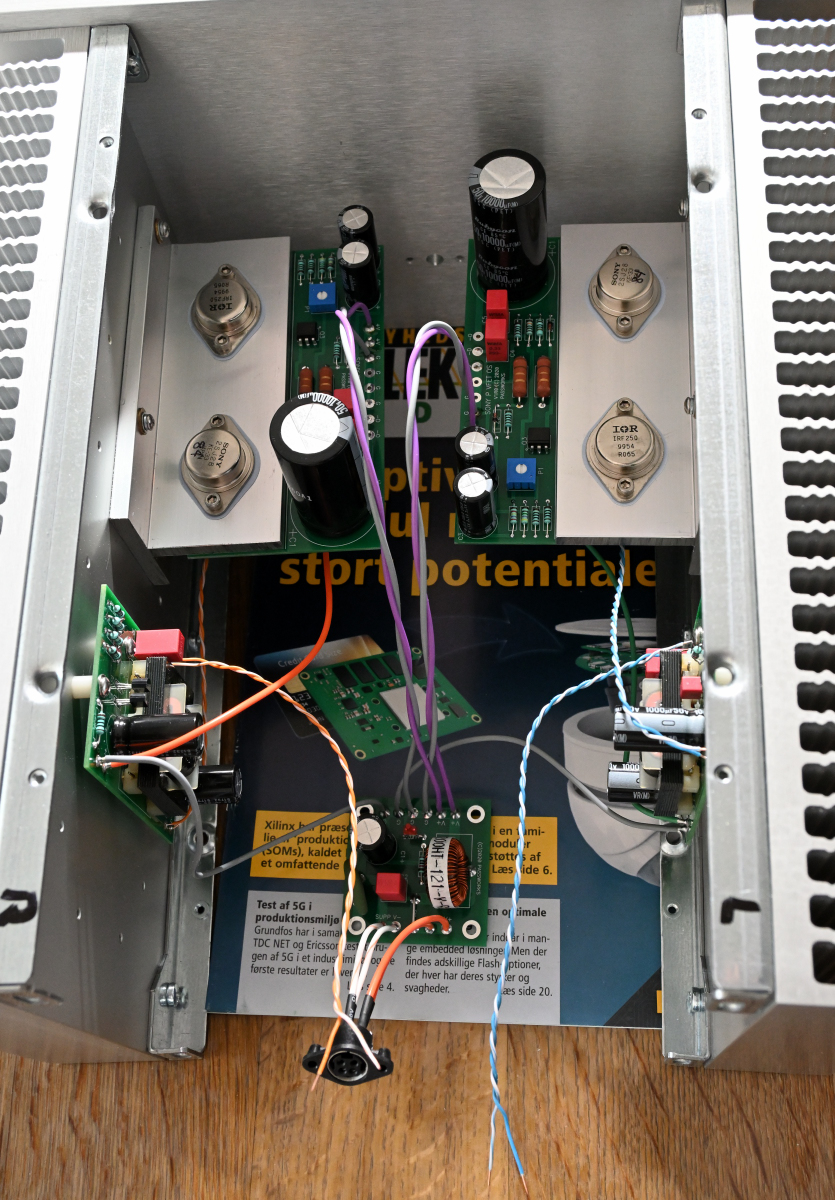

My amp is now in this condition. Will try to bias it up before I do more assembly. Will connect a lab-supply and slowly increase voltage and check if something bad happens. Will also use the current limiter in supply.

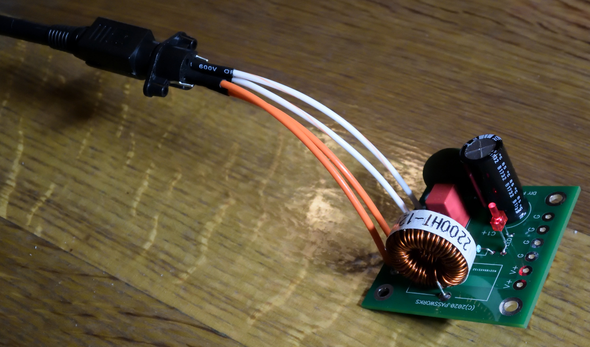

The other picture is the feet I mounted which are solid aluminium + a solid rubber O-ring. Some other member recommended these via a amazon link and I ordered a set. After that I realized that it was maybe a long way to ship these (from USA). But very nice feet.

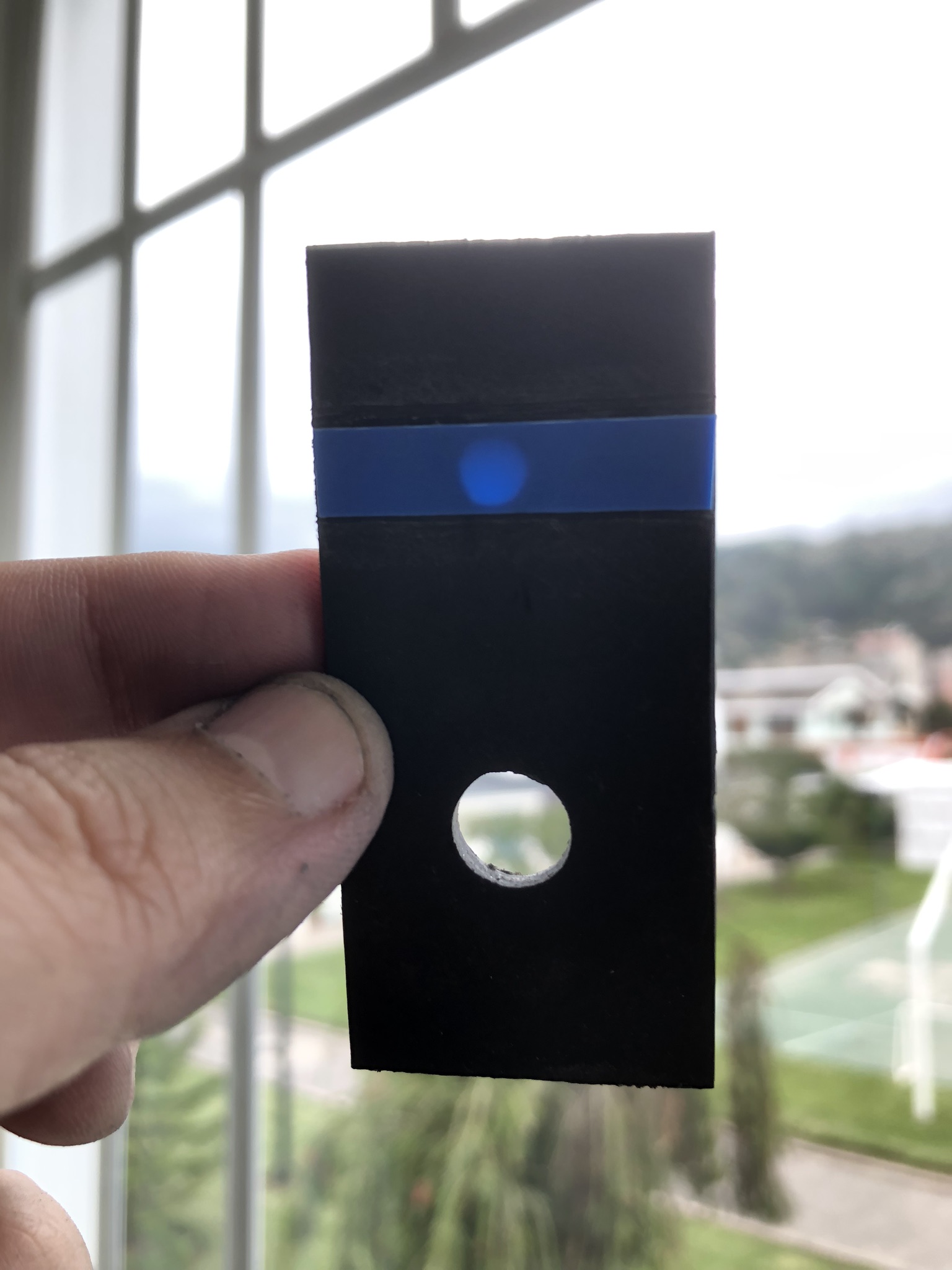

I used a "mechanical" (as opposed to "electrical") approach to tame my LEDs on both the ACA and the WHAMMY. Given the two front holes next to the led hole, I am planning on doing the same here:...I just need to tame that blue LED....![]()
![IMG_0049.jpeg IMG_0049.jpeg](https://www.diyaudio.com/community/data/attachments/851/851624-81cd8dcfea62a77940fd86f8a773343f.jpg)
I put a blue translucent plastic in front of the led. It helps both with toning down the brightness, but also diffusing a bit the 'central hot spot' of the LED.
Maybe it's a route that help others not wanting to fiddle too much with available resistors?
Ama change that to red as soon as I get tired to listen.

Regarding LED I installed it directly on the filter PCB. Then I can look down into the amp if I want to check if power is on. I don't want to look into any bright LEDs in front of me when listening to music......
Did not install them on ACA either. On SSII they are screened a bit by the tube shields but I did consider installing them so they where invisible.

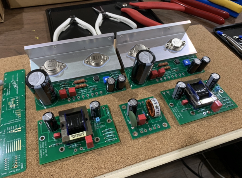

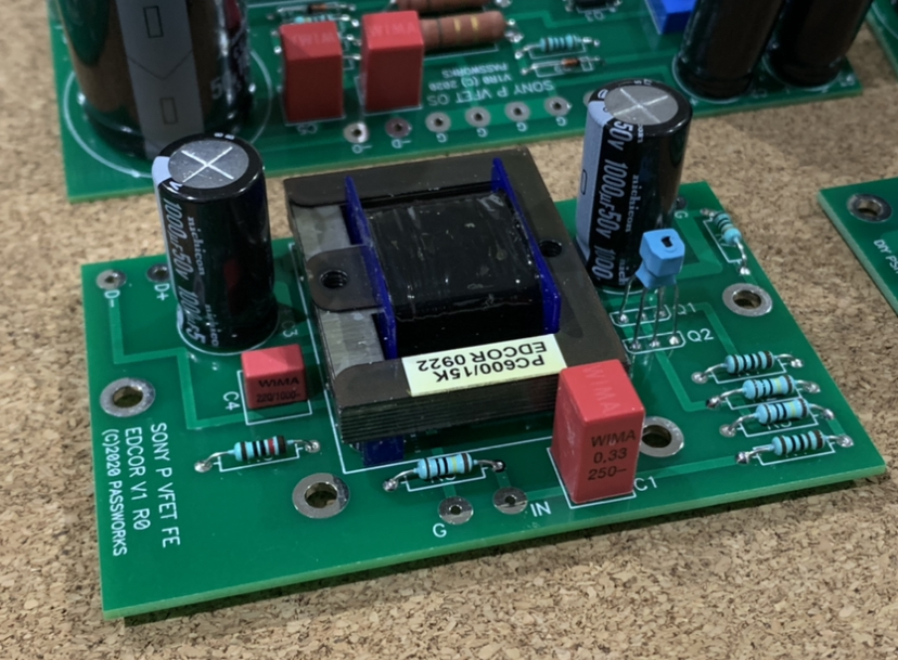

I just finished installing the components onto the boards. Very easy to build PCB and layout. Hearing all the complaints about too bright of a blue LED, I swapped the 10k for 18k resistor to keep the LED current at 2mA. My kit has the Toshiba 2SK370GR and 2SJ108GR and not the LSK170/LSJ74’s. Can I assume that the Toshiba’a are also matched quads?
Chassis installation will be tomorrow.
